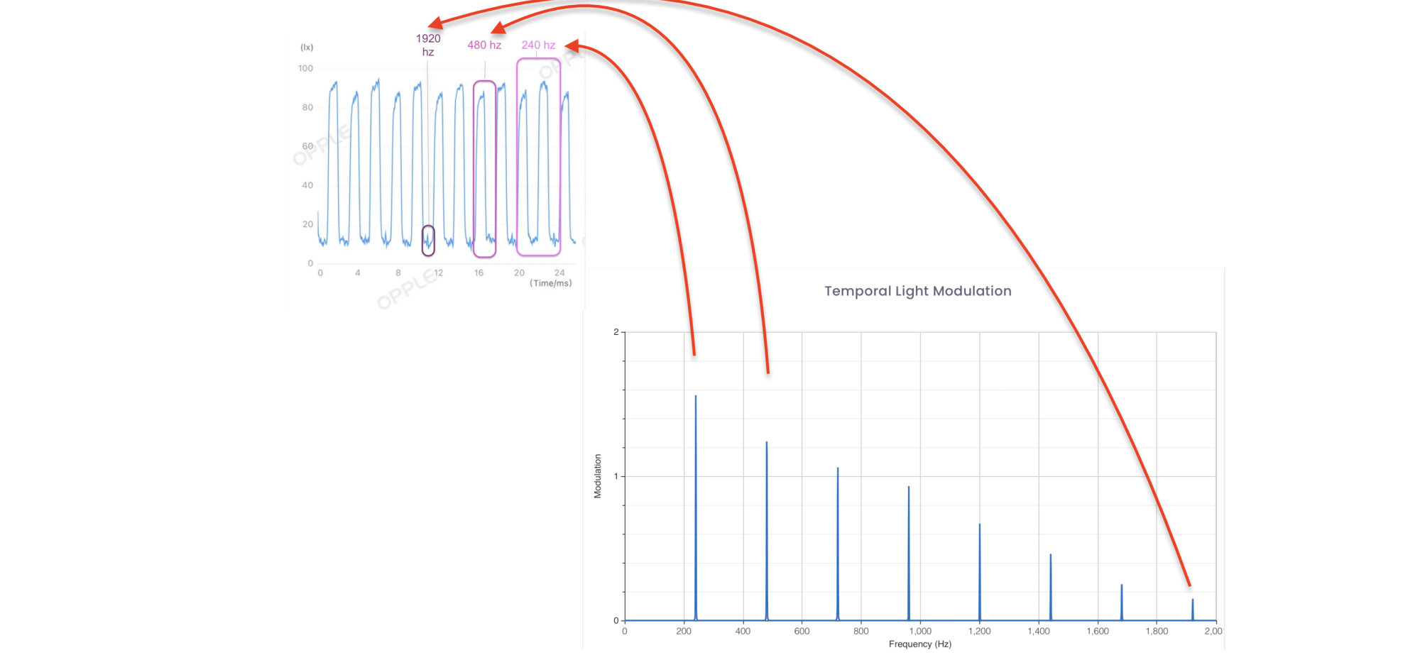

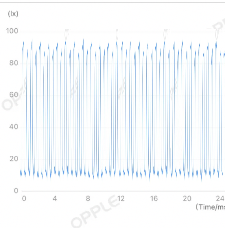

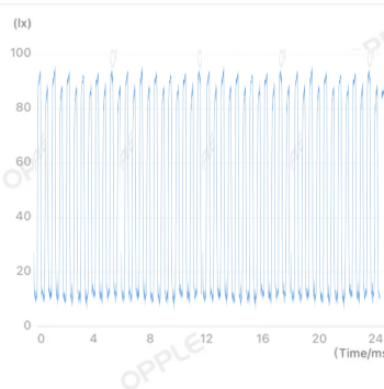

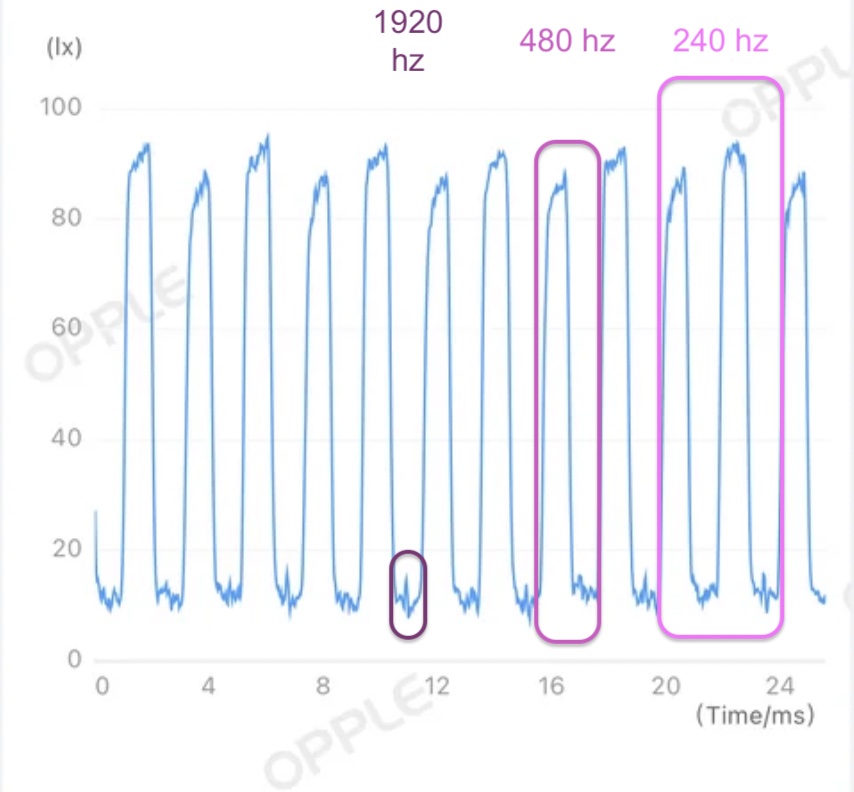

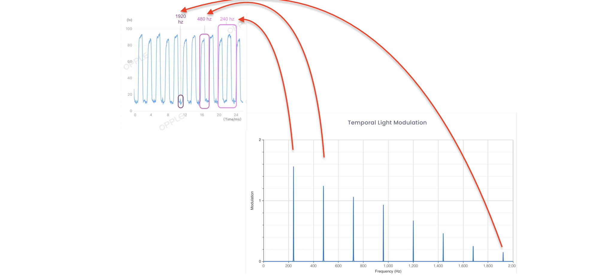

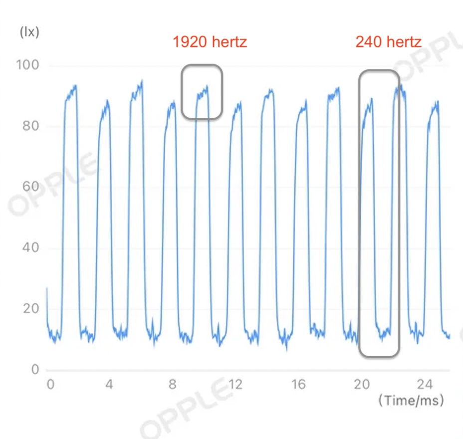

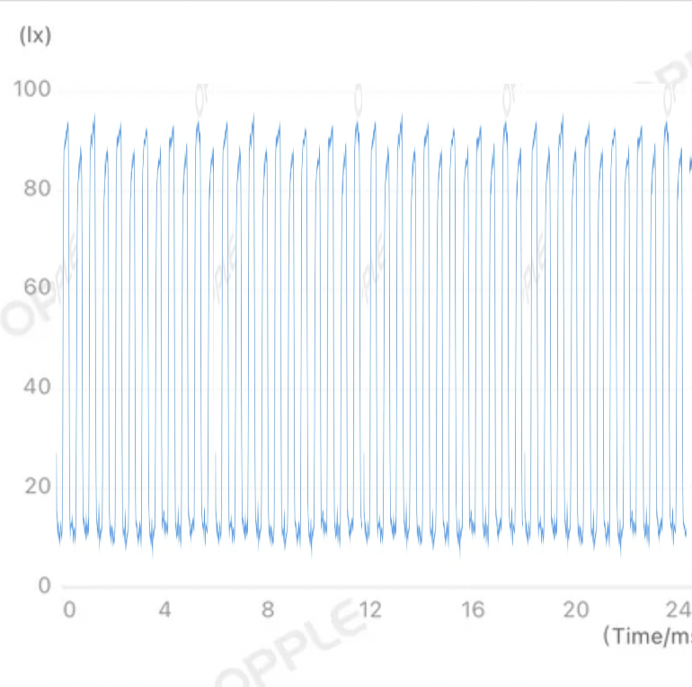

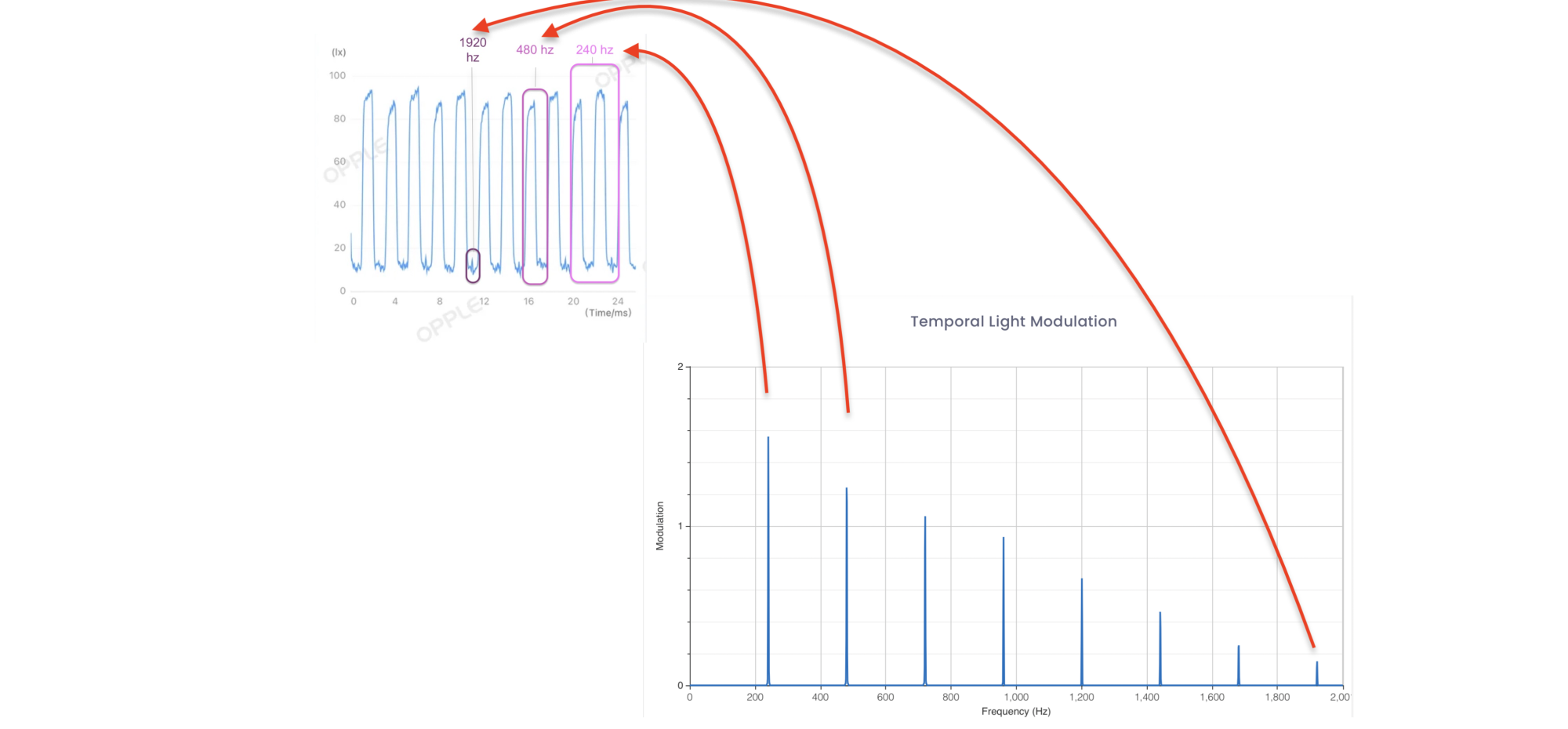

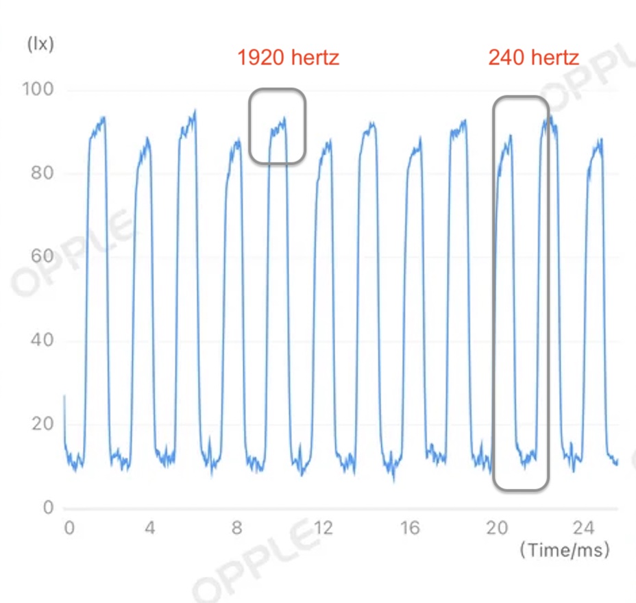

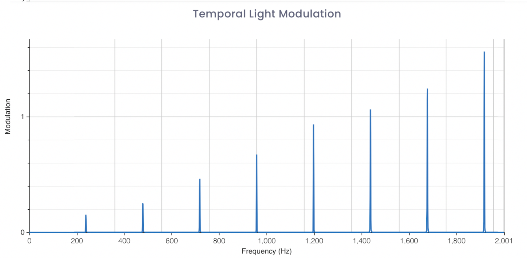

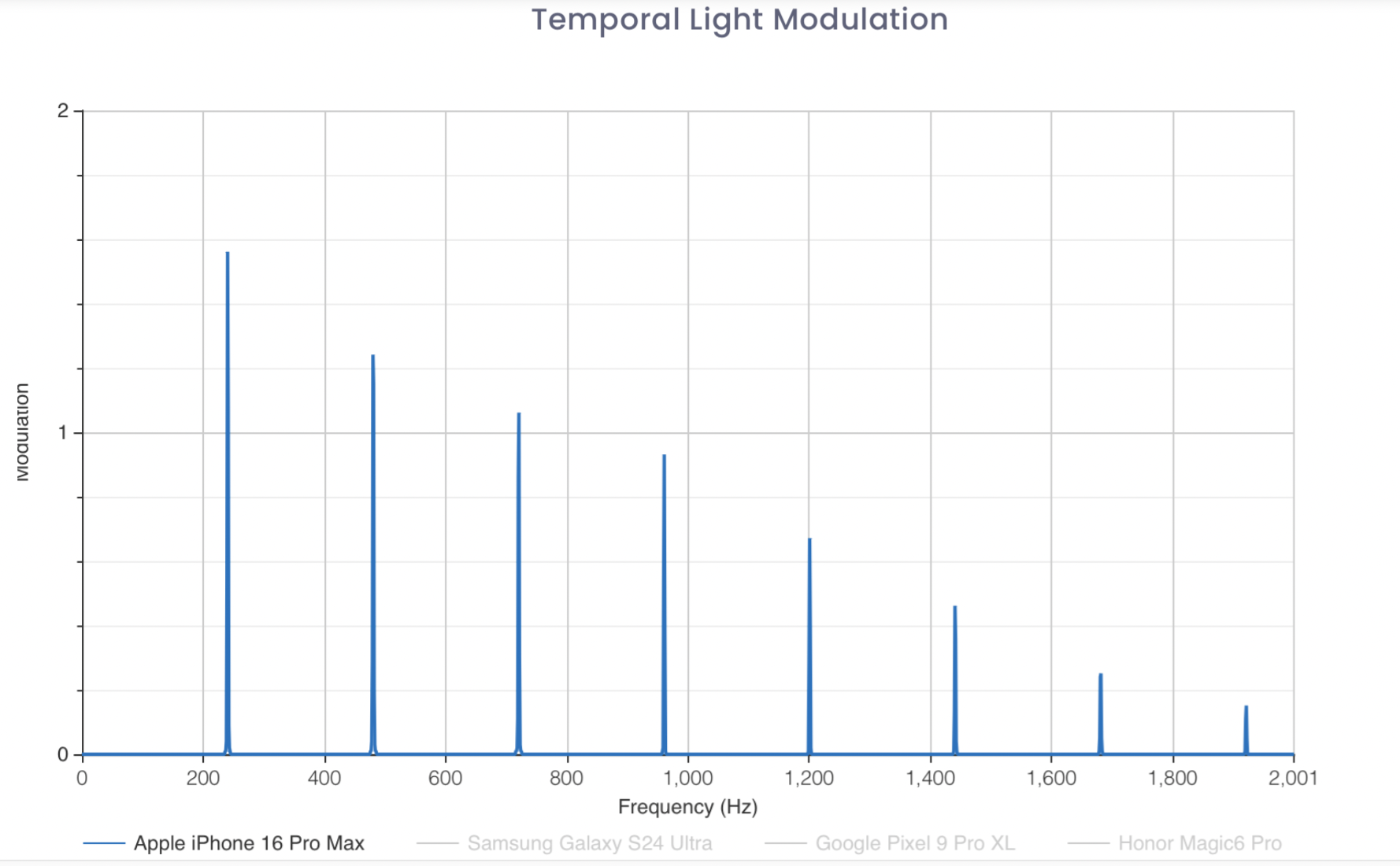

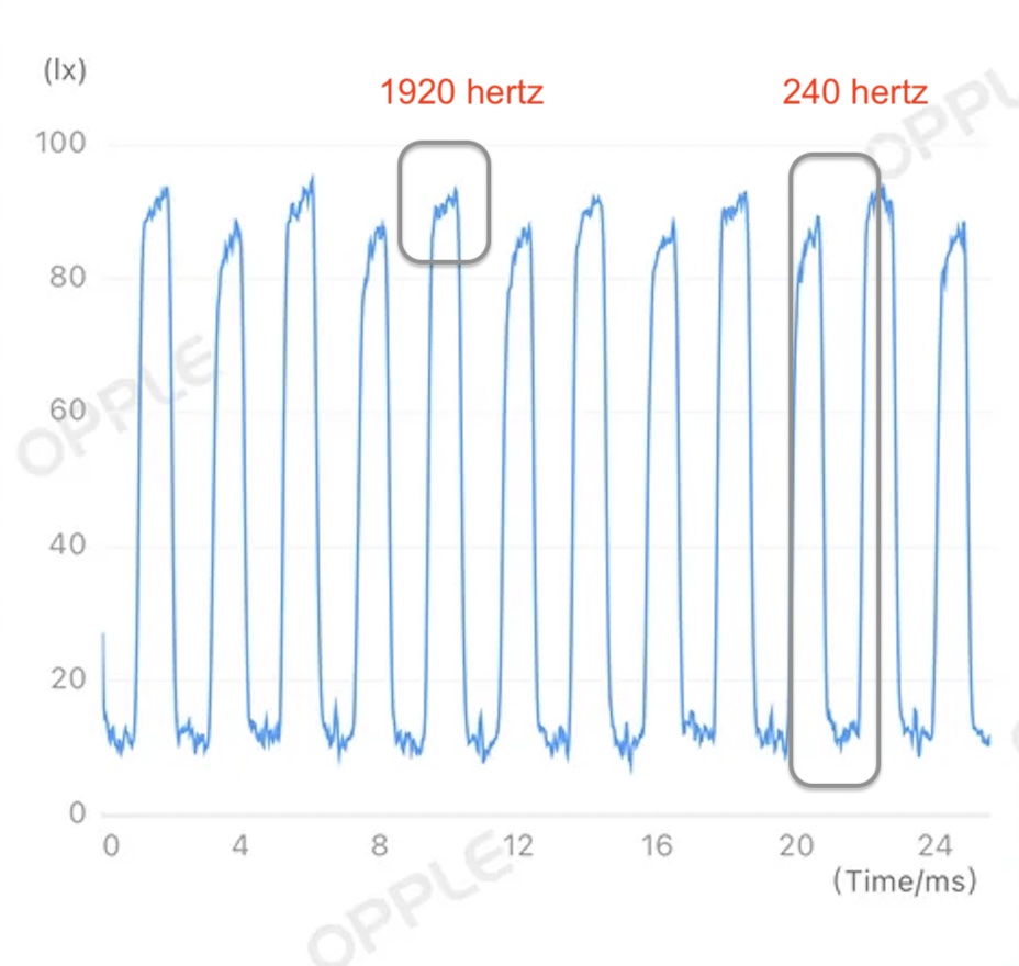

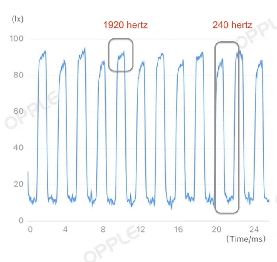

Hey guys, just another quick update on the recent iphones series.
It appears that Apple did ordered PWM 1920 hertz displays for the LTPO Pro models (and 1440 hertz for the regular/plus non-LTPO models).
Unfortunately, While the iphones OLED panels did have support for higher frequencies, Apple have severity limited it potiential.
I will illustrate why with the following.

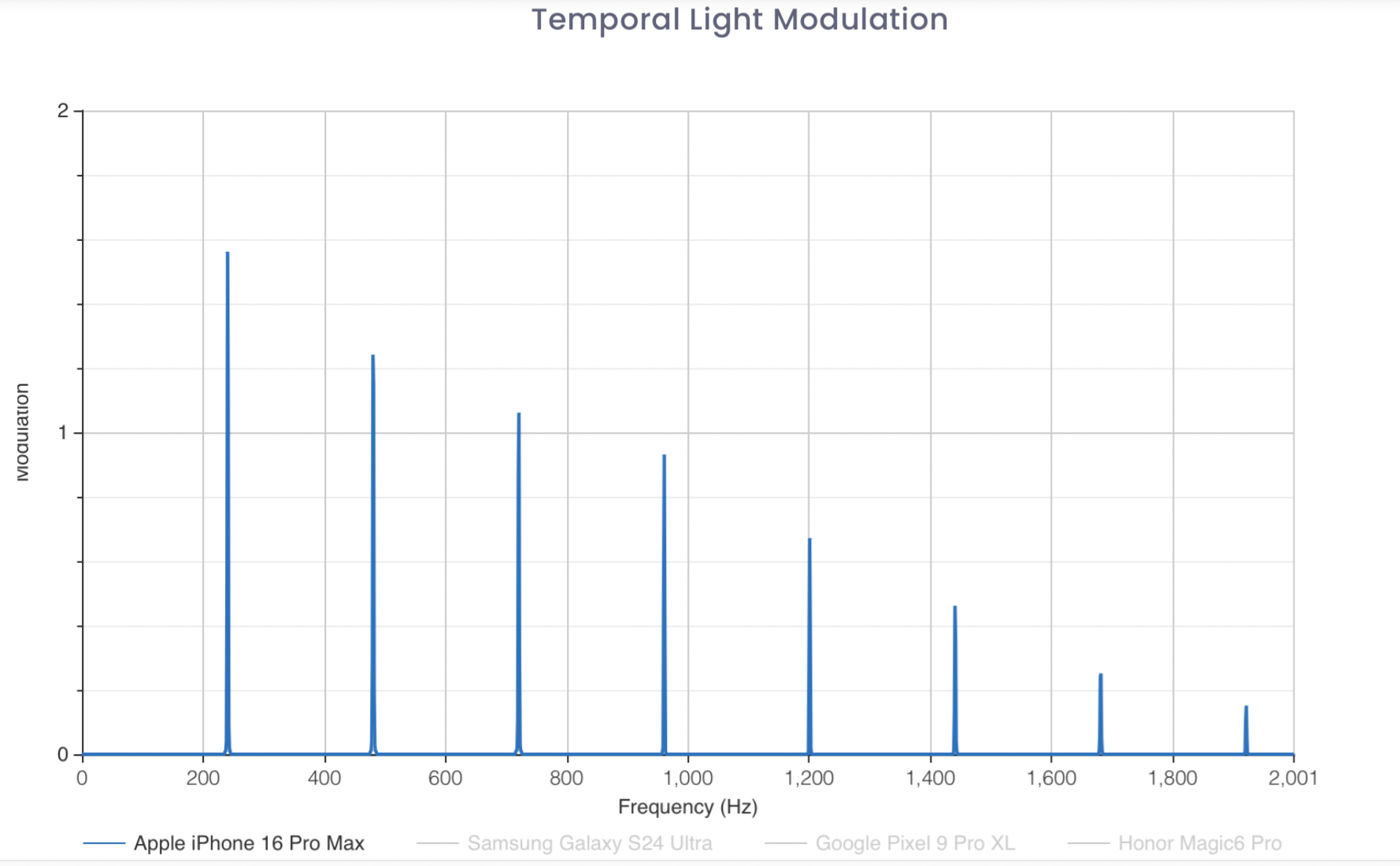

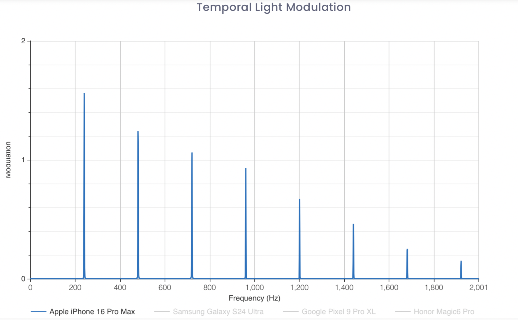

Referring to DXOmark's on their flicker readings:
Iphone 16 pro max
As we can see, the above is like a slope that heads downwards from 240 to 1920 hertz. From here, the pattern suggest it is a 240 hertz quasi-sine wave. (think of it as a fake or a knock-off sine wave). This corresponded to the Opple graph readings we had. (1920 hertz), 480 hertz and 240 hertz respectively.

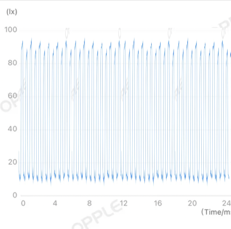

I will illustrate the correspond of iphone 16 pro's again below~

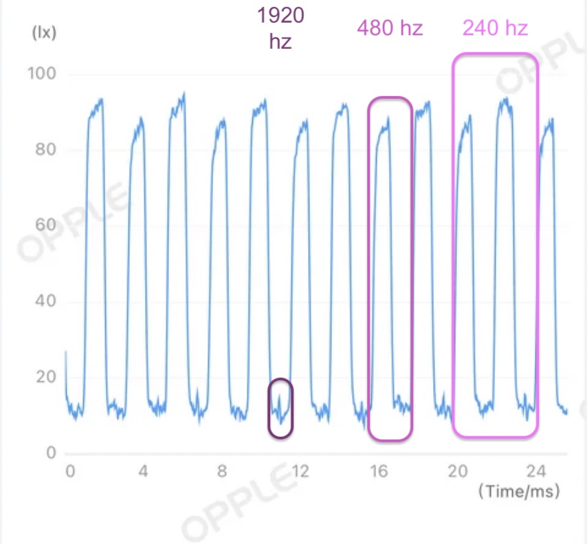

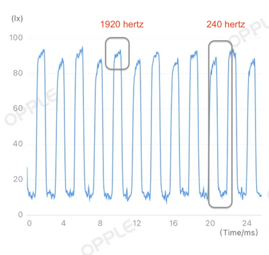

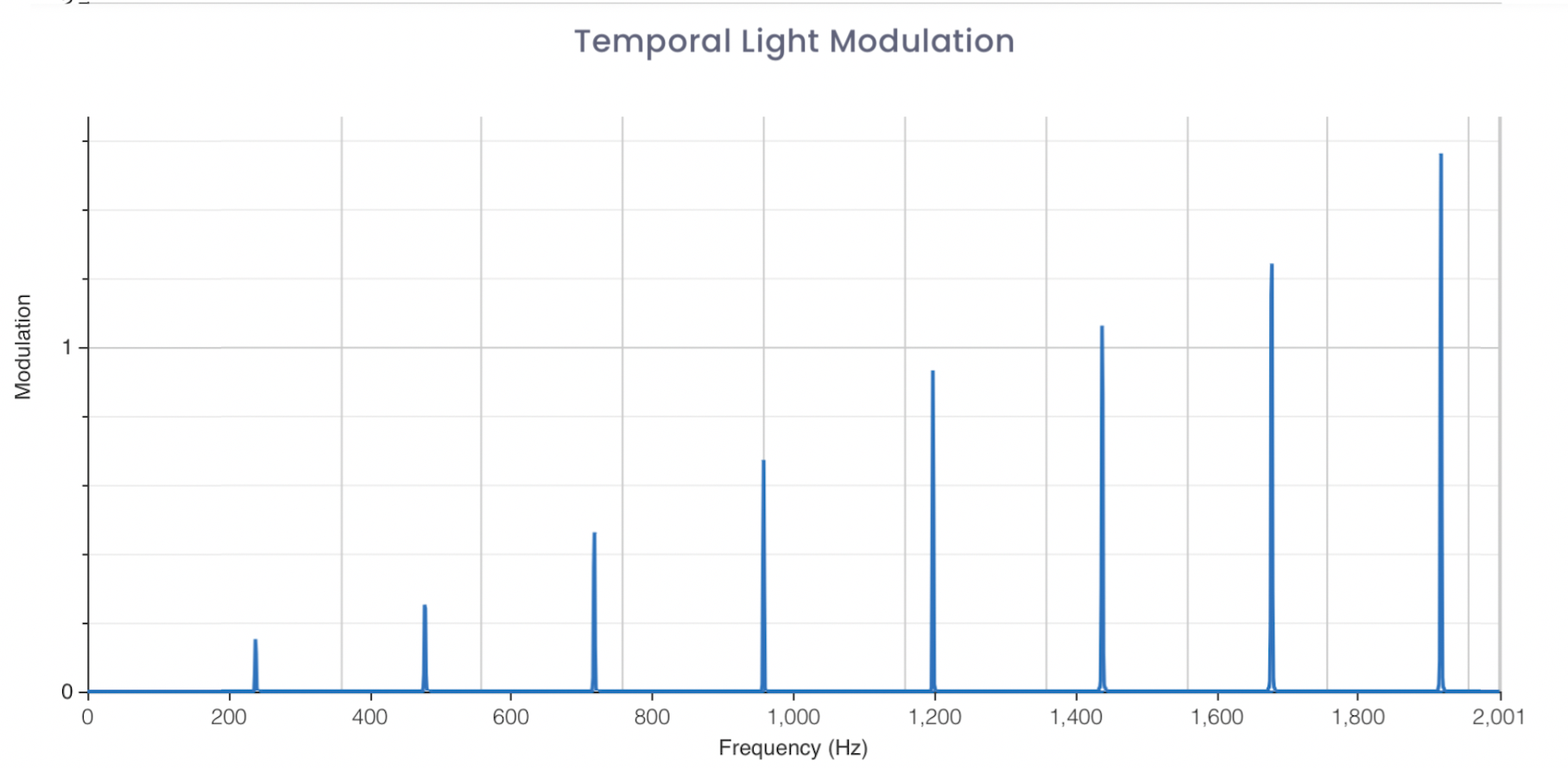

We can observe that the Apple might have decided to take another approach to utilize their supplied 1920 hertz. The 1920 hertz was configured to have extremely low modulation, and the 240 / 480 hertz was made to have high modulation.
I believe their rational behind is to prioritize OLED fragile lifespan over user's prolonged eye exposure (exact duration is subjective to individual).

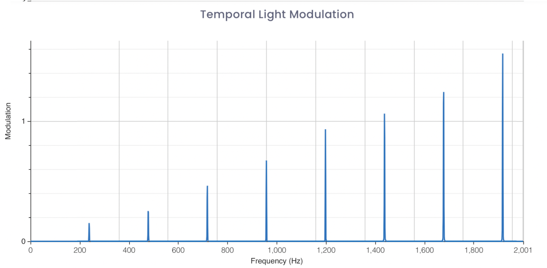

Hypothetically speaking, had Apple decided to prioritize eye concern, they would have limited the higher modulation to 1920 hertz.
It would have been a true 1920 hertz.
Should someday Apple decided to unlock its potiential, our DXOmark's and Opple's graph would have looked like below, as illustrated:
(graph not drawn to scale)
Here is hoping that Apple can finally sort this out someday.
Cheers

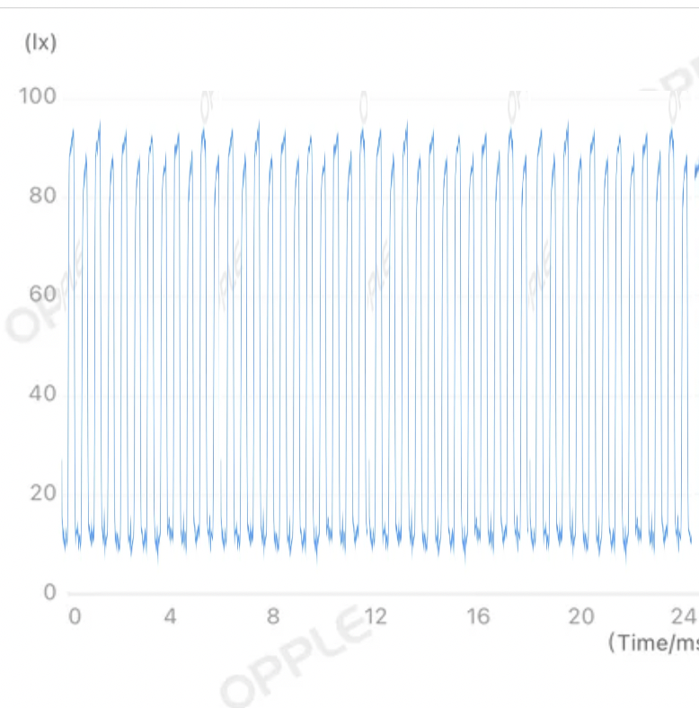

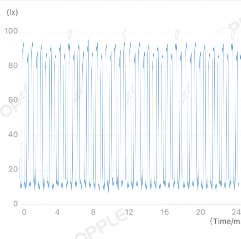

Iphone 16 pro max
Cheers
