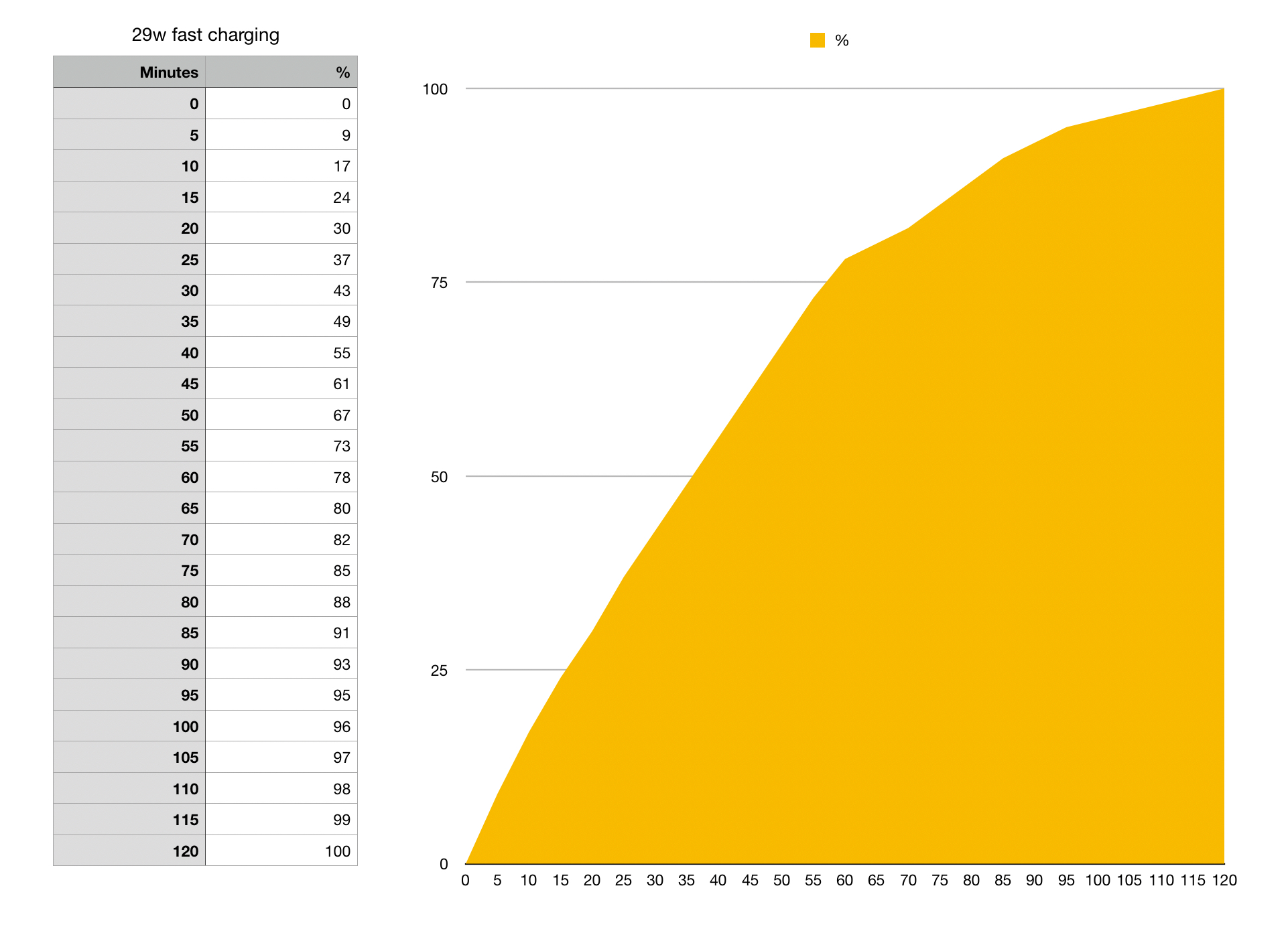

Posted these results in another thread yesterday as I missed this one
This is on the 8 Plus using Apples 29w charger from a powered down state, waking the screen at 5 minute intervals

Holy smokes in English please..haha so I just asked this above but wanted to know from 20%-100% how long will the IP8+ take in actual minutes, the Numbers that matter to us non math guys. And how is that compared to last year models, like the time it takes the 7+?

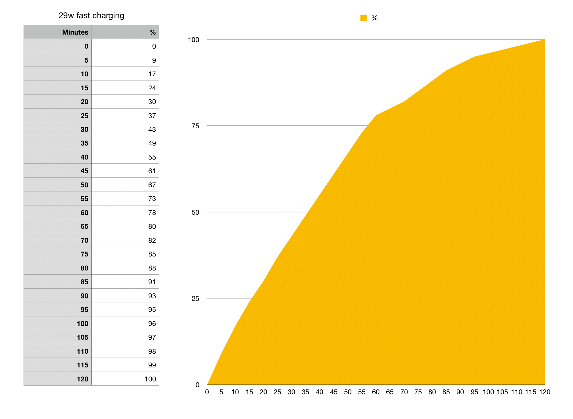

2 freaking hours from 0-100%, so what was last years 7+ do you know? So basically we get 50% in 30 min and the next 50% in 1.5 hours.
Crazy right?! Going to retest with a standard 12w charger and compare the results. Pretty underwhelmed
That’s the last 50% in 1.5 hours.:( they should name it “faster than last model charge” not fast charge. Lol But I get it, it’s for needing enough juice if u r going out when u only have 30 min to charge it.
Thanks, this is really useful information - it looks pretty disappointing. I assume you used Apple’s official USB-C to lightning cable?
It’s very surprising that after 30 minutes it’s only charged to 43%. That’s quite off from Apple’s marketing of 50%. Apple should definitely clarify on this.
Indeed. Didn’t Activate airplane mode as I wanted a ‘real world’ test so suppose this explains some of the difference vs Apple’s own testing. That said, this was several hours after turning on the device and had nothing updating in the background etc
