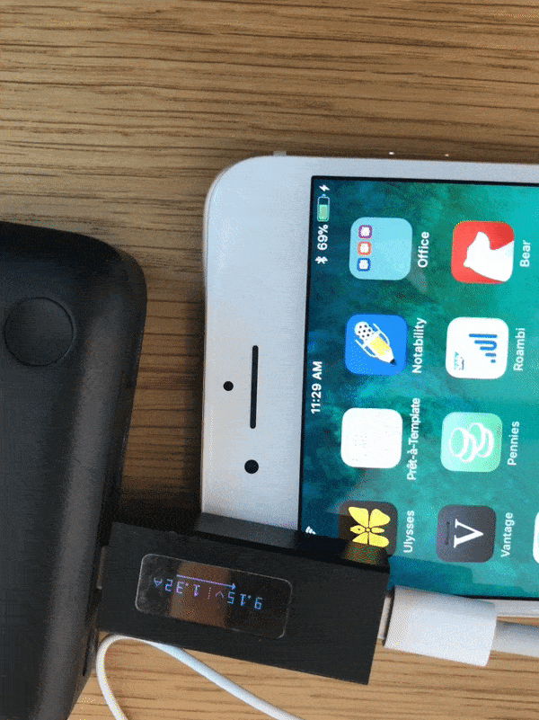

[doublepost=1506139084][/doublepost]On a more interesting note, I got around to connecting a USB-C PD Charger (the RAVPower mentioned earlier in this thread) and a Plugable USB-C Power Meter to test an iPhone 8+ on display in the Apple Store.
It took some doing, but I was able to drain it to about 70% and get some readings. I can confirm that under USB-C PD the iPhone 8+ charges at 9V, and given the current at 70%, it most likely charges at 2A at maximum speed (i.e. 18W when the phone is close to empty).

Heh... a bit awkward, but I was pretty surreptitious about it.
I can't really do a thorough test without draining it completely though - timed tests unfortunately aren't necessarily accurate, because it doesn't show the actual amount of power flowing into the phone. What we really need is someone to measure fast charging the iPhone 8 from 0% to 100% while connected to a power meter with readings.

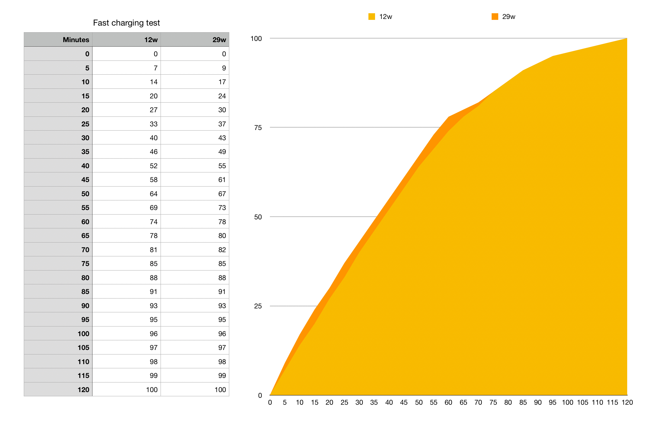

Well... here’s my 12w results. Taken at face value I’d say the outlay for 29w not worth it if you have an iPad charger kicking around. However, I’ve seen a couple of sources showing the phone fast charging to 52% in 30mins in line with Apple’s testing. Suggests something not right with my first test. Bad wiring perhaps? Under the same conditions for both so hopefully a somewhat useful exercise

Yes something seems wrong with the 29W setup. One thing is that the cable is extremely important - no other cable except for Apple's own USB-C to lightning cable will allow for fast charging - any kind of USB-A to USB-C adapter or third party cable from Amazon will not work.
Given how sensitive the cable is, it might be worth trying to get another cable to test it out - your cable may be defective.

Hmmm, well I already bought a 29w, but a third party for $22. But thanks for work and stats! Although these tests don’t really show us real world results. Nobody charges there phone in airplane mode, you know..

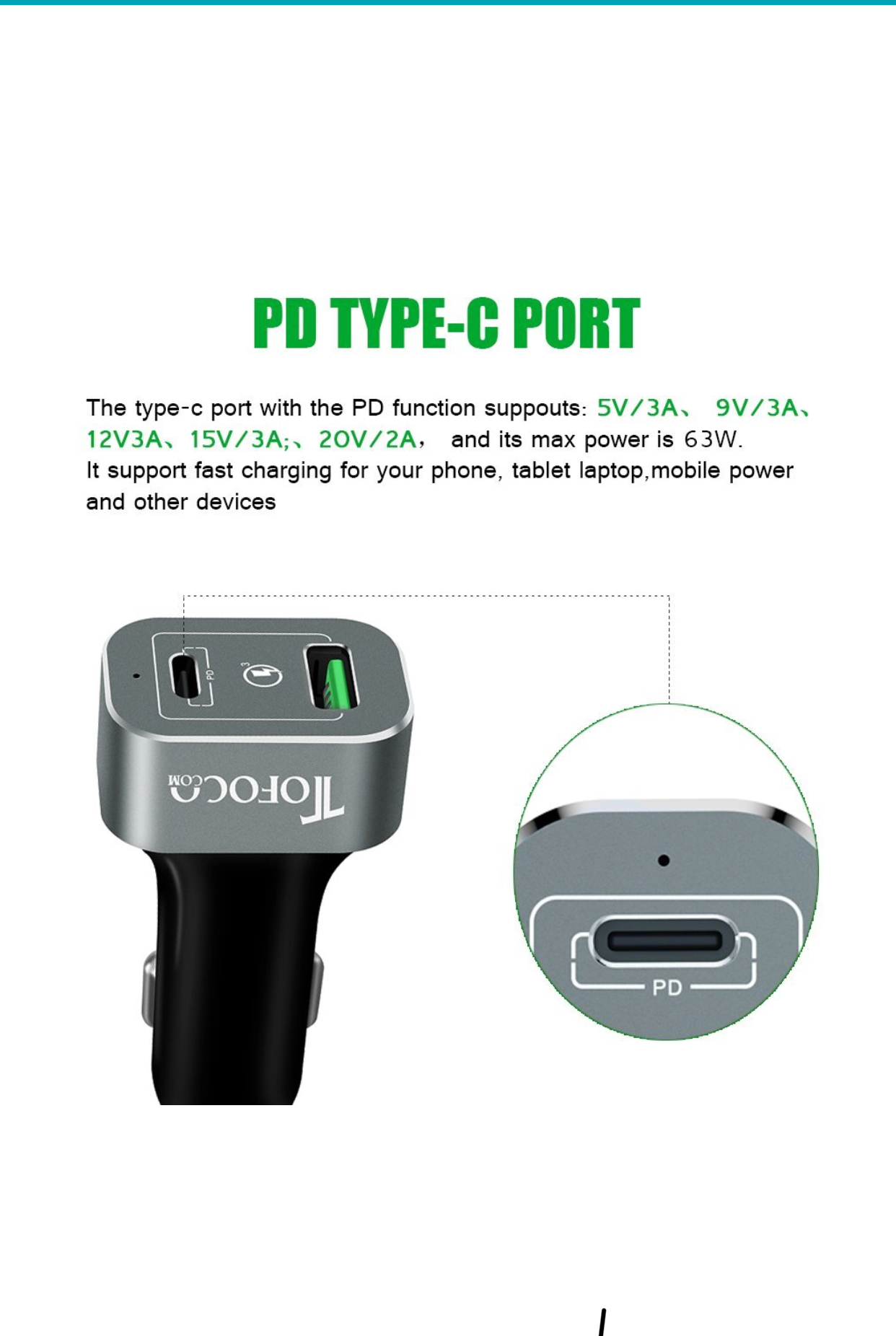

I bought this for $19 for my car, and a 29w for $23 for Home.

No probs. Just to reiterate the curves presented above are indicative of real world (well mine at least ;)) as they weren’t in airplane mode while charging

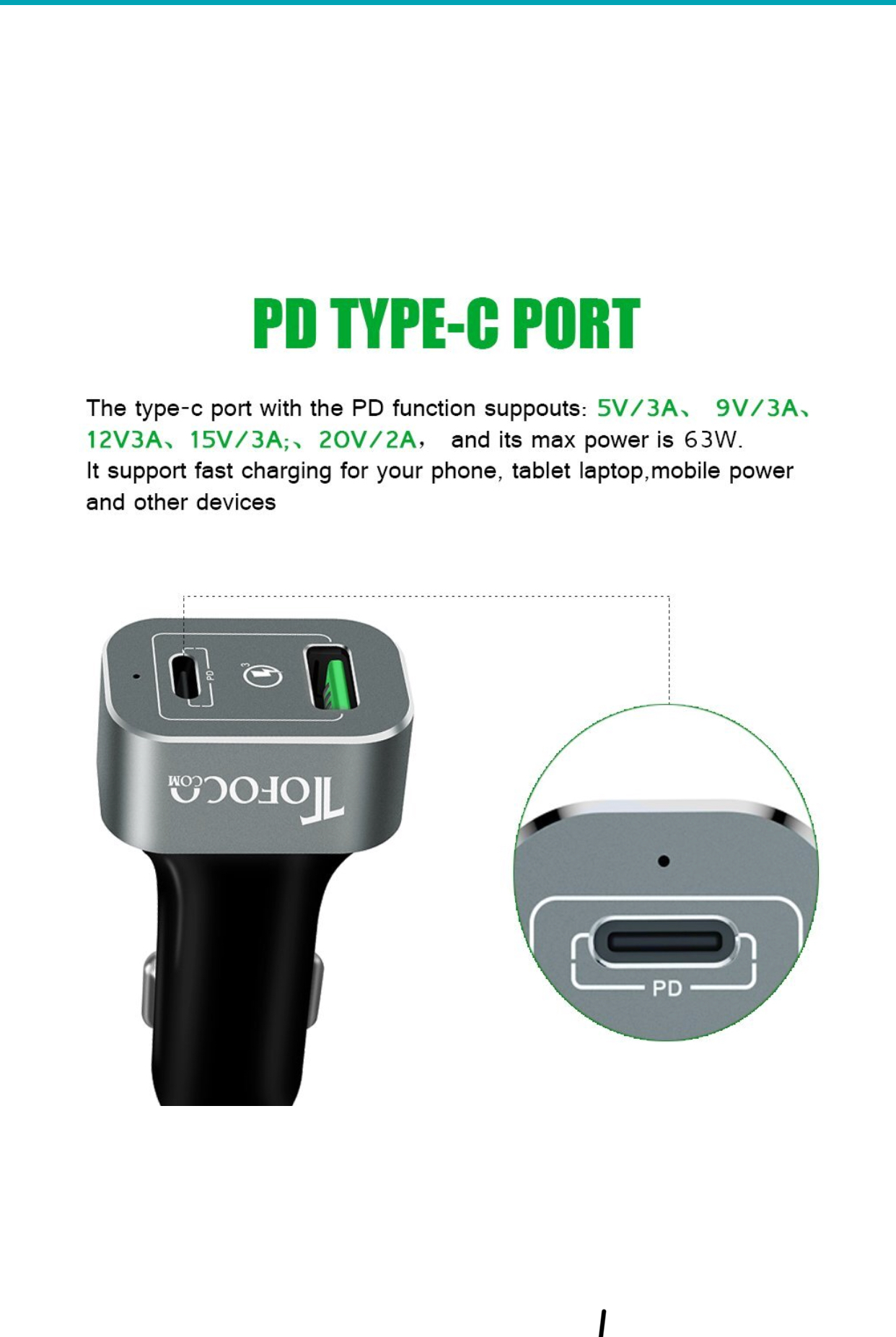

can you provide a link for the car charger? also let us know how it works when you get it

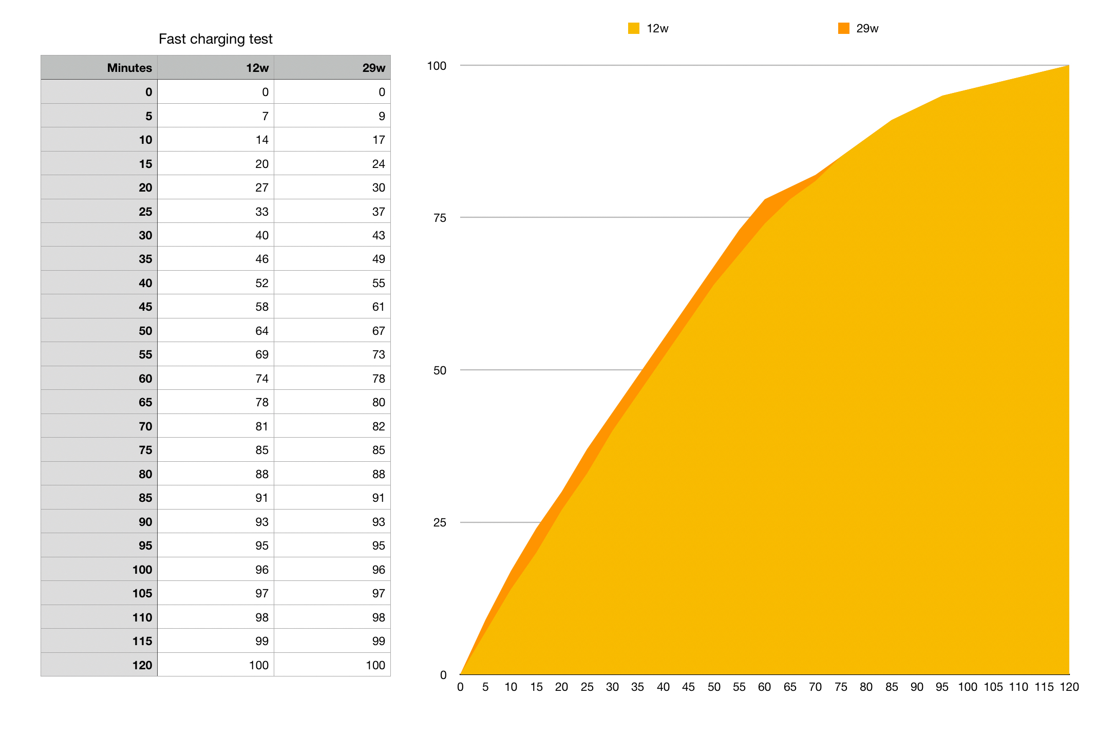

Thank you! These results look quite consistent with what @johnyslats reported. I’m inclined to agree that there’s no advantage over 12W charging. Apple’s marketing is rather confusing then - I’m not sure why they even decided to tout “fast charging” as a feature.
