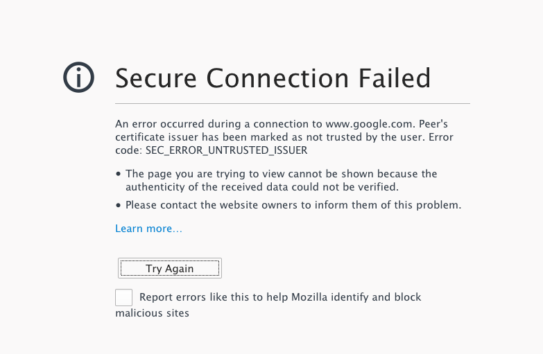

I'm having an issue where leopard webkit can connect to display a website while connected to the squid proxy but Tenfourfox cannot display the website properly. The website tends to crash on webkit so I'd rather use tenfourfox. I have a hunch there is some sort of security that tenfourfox does not support on the website. Is there any way to configure tenfourfox to use the squid proxy as well, or does it not work like that?
It's not the security aspect of it so much. It's the fact that even though WebKit is from 2018 it's still 3 years newer than tenfourfox (Firefox 45 was released in 2015). WebKit has more up to date internal components, which is probably why the site mostly works vs not working with TFF.

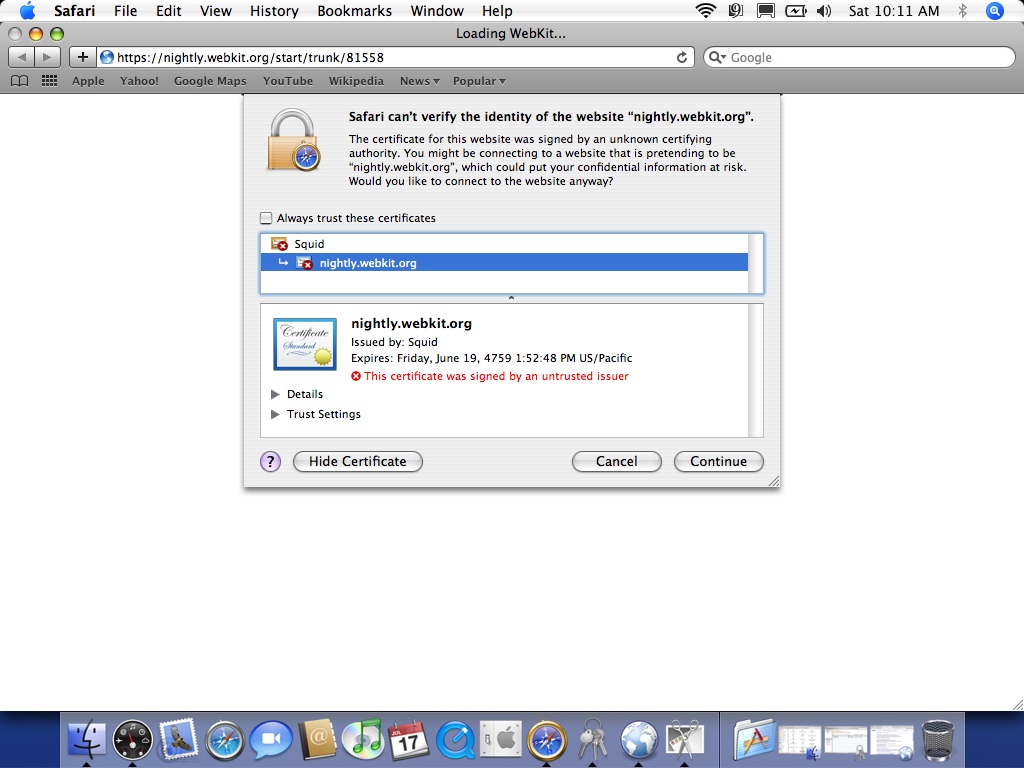

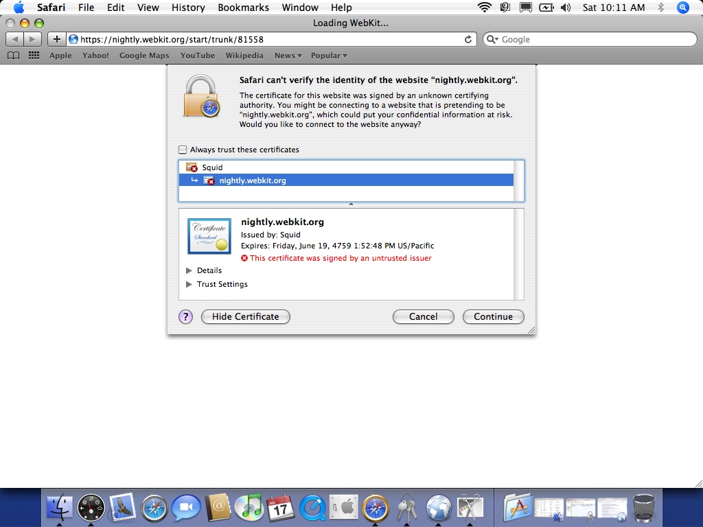

I finally got around to setting this up on my Mac Mini running Snow Leopard server. It seems to have worked for Leopard webkit tested on one of my powerbooks. However, I am not having the same success with Tiger connected to it.

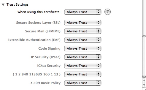

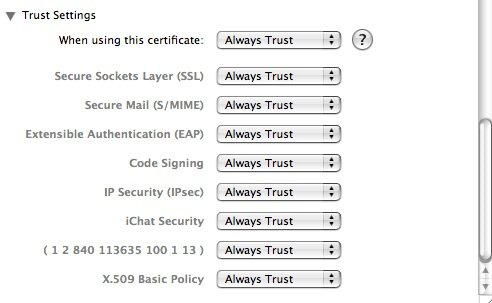

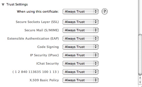

I added the squid cert to Tiger's keychain just like I did in Leopard, but Tiger won't trust it.
Forcing me to press continue every time a page is loaded. I also set all the trust settings to always trust so I'm not sure why it's doing this.
Classilla doesn't seem to recognize it at all.
