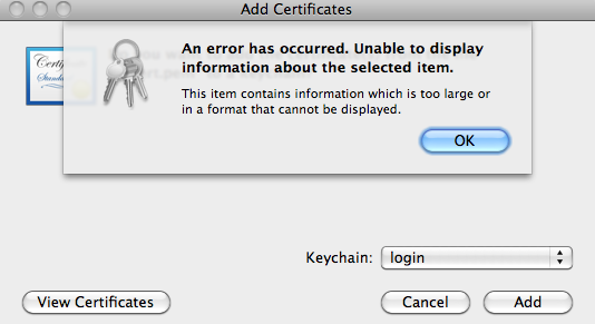

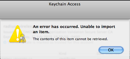

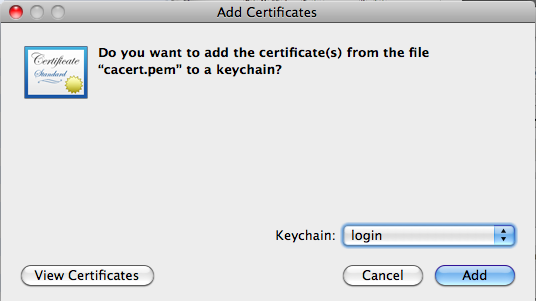

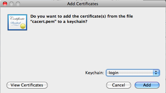

Whether I try to use the version supplied in the @Wowfunhappy installer, or if I grab the latest from here, I run into the following issue:

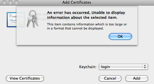

When I click to “View Certificates”, this occurs:

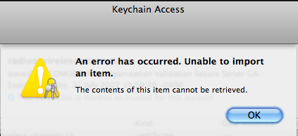

And, ultimately, efforts to add the certificate terminates with this error:
I should add that I’m mostly just testing the add of this certificate on a 10.6.8 system, even though I was hoping to use it on a Leopard Mac.
I did skim through most of this thread, and it’s entirely possible I missed something really basic.

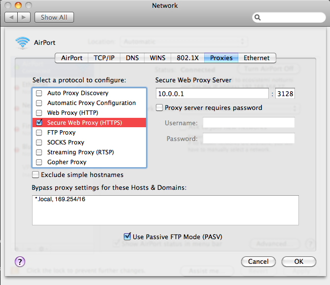

On the client, I checked Network settings once more and I ran a quick curl test:
Code:
sh-4.3# curl -x http://10.0.0.1:3128 -I http://google.com
curl: (28) Failed to connect to 10.0.0.1 port 3128 after 74684 ms: Operation timed out
So something is still hanging me up. I’ll keep working at it. Thanks again.

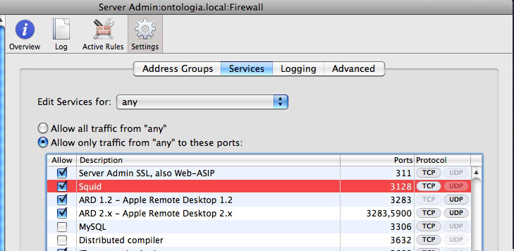

I knew if I walked away from this and then came back, something profusely simple would come to me.
And it did: I forgot to make a rule for squid in my firewall 🤦 :
And lo:
Squid definitly takes up some CPU, but it’s not capping out or anything like that.

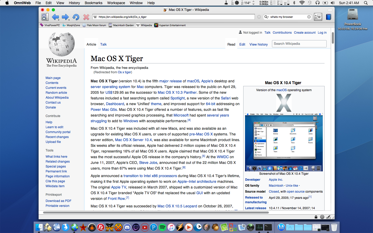

Next up: digging through the other parts of this thread to get Wikipedia working inside Dictionary. :)
Thanks again, @wicknix !

Hi. I didn’t want to resurrect this part of the thread unless I reached an impasse — which I now find myself.
I’ve been following your path of installing squid4 with Macports on the target server where squid will live, and using the squid.conf prepared helpfully by @Wowfunhappy in his all-in-one install for Snow Leopard (I extracted it with Pacifist and copied that over into the config file location, per your steps in the opening post), I’m running into an issue with trying to import the cacert.cae into Keychains.
You’re trying to import the wrong certificate, you want to import “squid.pem”. This certificate is generated when you run the installer so that it’s unique to every machine, which we want for security reasons.
I’m on mobile right now, but take a look at the post install scripts.

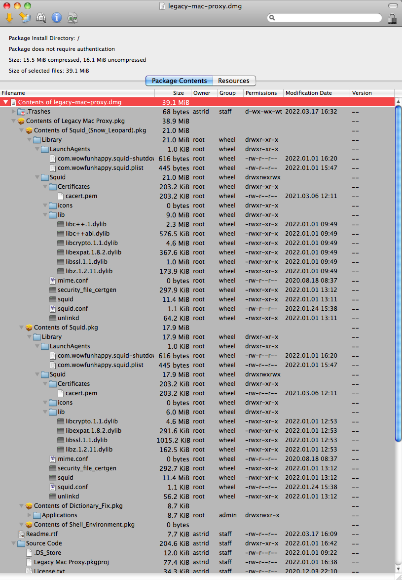

Thanks for the chime-in.
The approach I followed to set up Squid was more in line with what @wicknix supplied in the opening post, and that seemed to do the job.
Also, drawing from a view of the legacy-mac-proxy.dmg in Pacifist (attached), I didn’t see a “squid.pem” — only “cacert.pem”. This was where @wicknix came in with a separate file, Squid4Leopard.zip, which did contain that “squid.pem”.
In any event, Squid is working now. Thanks once more for your work!

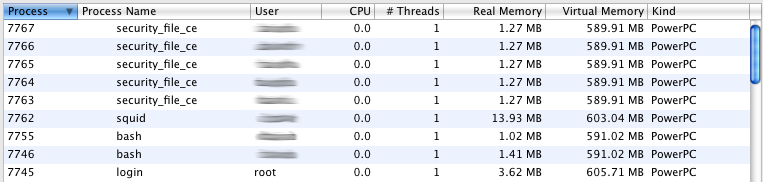

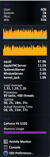

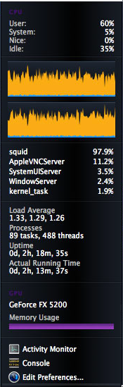

Where in Console are the Squid related errors logged? I checked the system.log at the exact moment that Squid crashes and don't see any new errors.
The Squid process seems to only generate 6 processes (plus login and bash processes for the launch script). I'm not sure how this would overload the OS kernel?
There does appear to be a pattern/consistency as to which websites cause Squid to crash - it is not totally random. I've noticed that if a particular site causes Squid to crash, it usually does so every time. If a particular site manages to load halfway when Squid crashes, killing Squid and generating a new Squid process can sometimes finish up the rest of the loading process (at which point it will usually crash again once the page is fully loaded).
What might be happening is that certain web sites contain a specific type of element that is "too complex/demanding" for the Squid process to handle. I'm not sure what this would be yet, but the fact that sometimes a second Squid process can finish loading up a "demanding" page makes me think there is some limitation within the Squid process itself. Very simple web sites like Wikipedia never seem to cause a crash.
Just sharing my ideas. This is going to be tricky to solve but I'll keep experimenting.
I still poke away at it here and there, but no real progress yet. I think i may know the issue however. After scouring the net it might come down to how many processes the kernel can handle. Sadly 10.4 and 10.5's kernel cant handle all that many. Squid creates quite a few child processes for every site visited and console shows errors with something like "child process died, not enough resources" or something to that effect. So the PPC builds might be fine, but the kernel is just too limited (or old) to handle it.
Well that sucks! I was hoping that MacPorts toolchain/compiler updates might eventually fix this some day!
Do you know the process limit? How did people use OS X for servers and the like back in the day?
...I've always assumed (without explicit testing/evidence) that it was websites which load many connections at once. So, when you browse Wikipedia you're basically only talking to Wikipedia's servers. When you load e.g. MacRumors you're loading content from any number of ad networks and CDNs. The sudden influx crashes Squid.
I think (?) this jives with @wicknix's theory above about processes...
