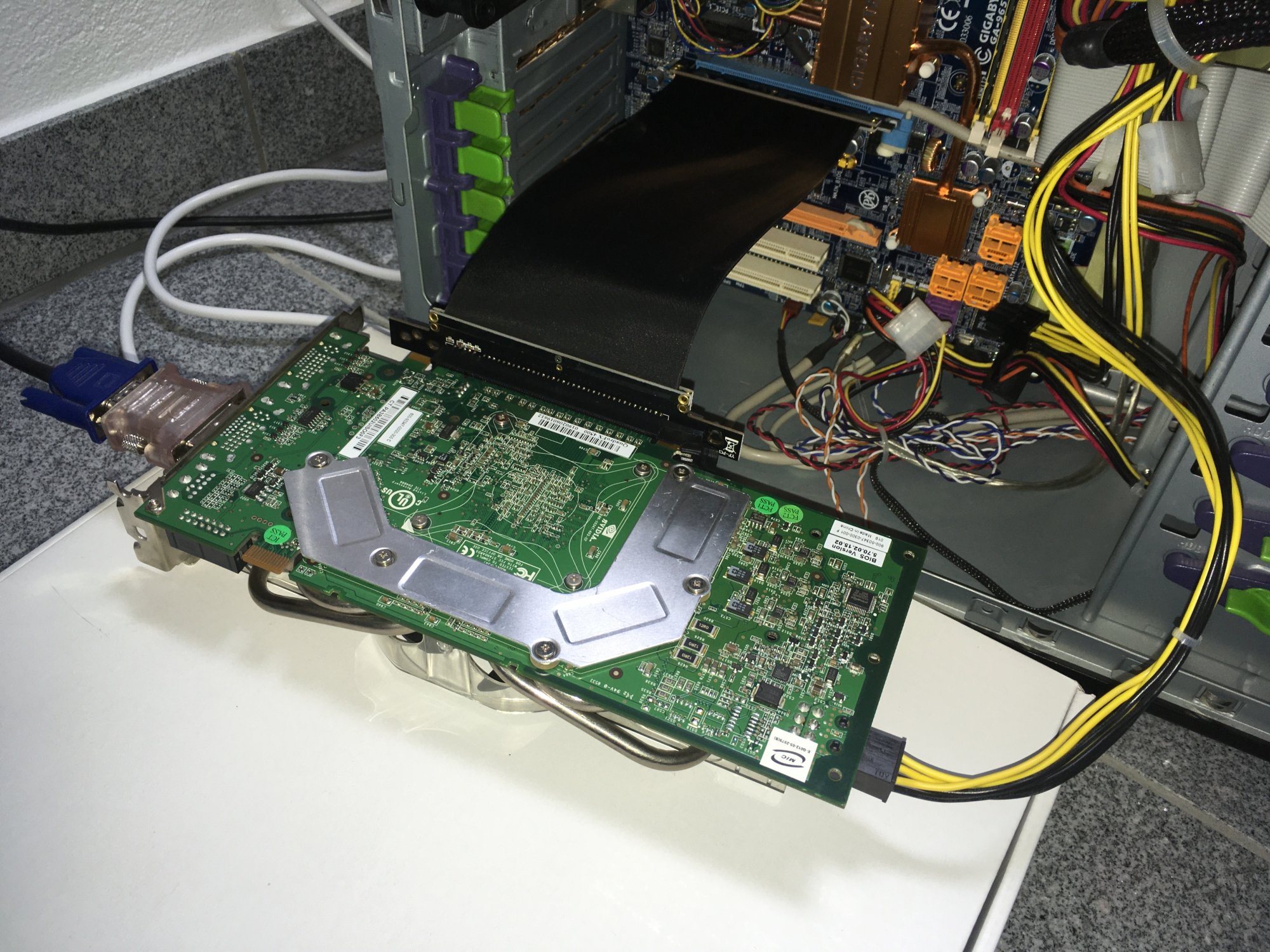

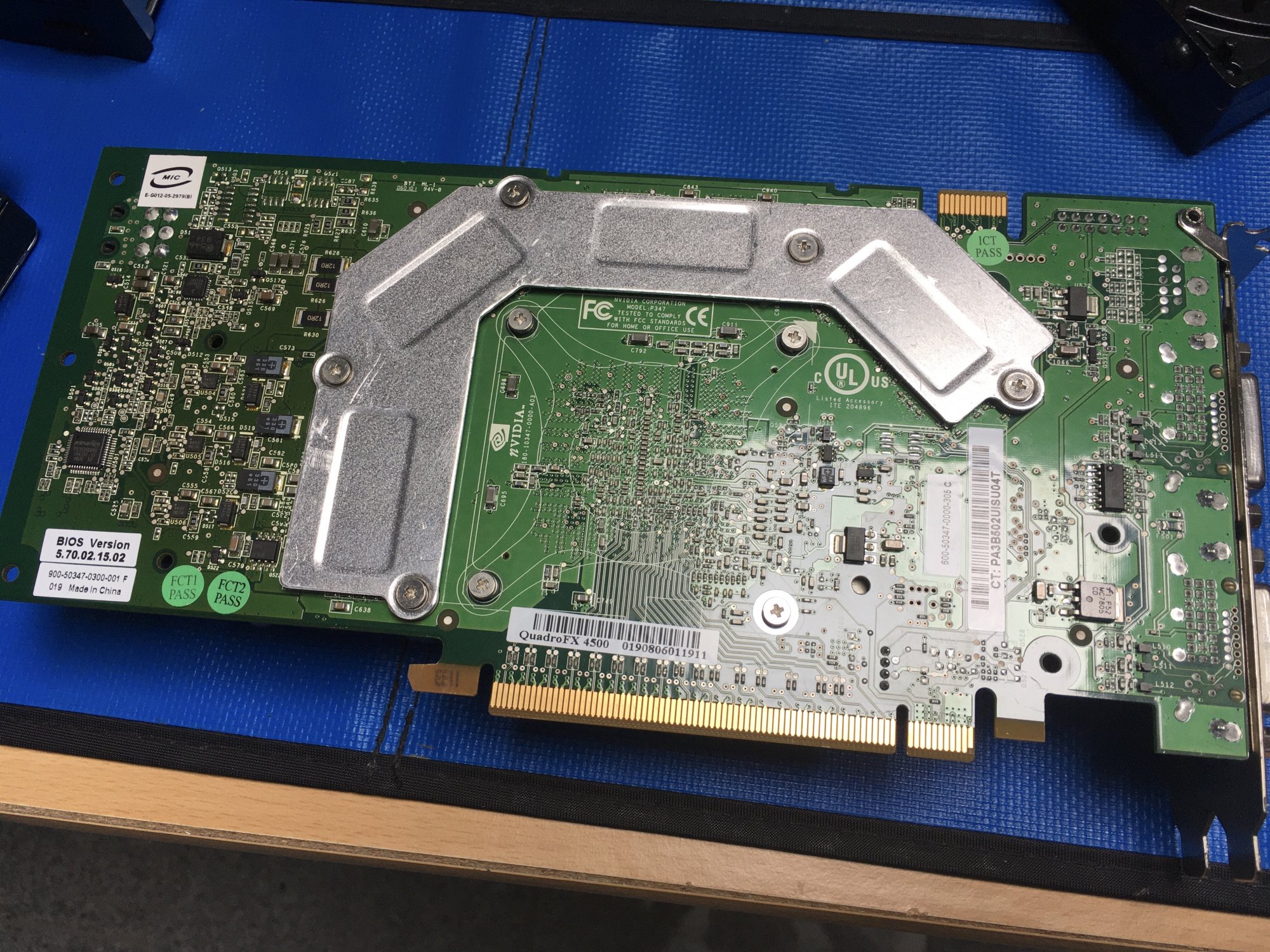

First of all, this is the card I've used for flashing:

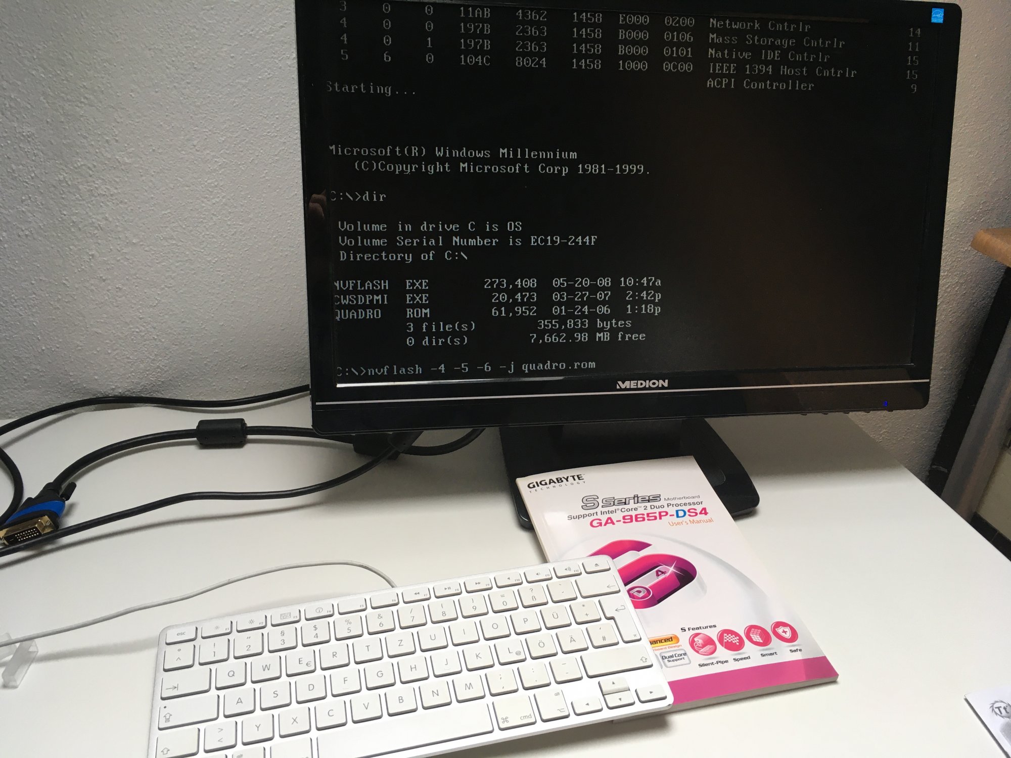

After preparing the USB stick according to the OP's guide, I got my gaming PC from my mid-teens which I haven't been using for the past +10 years. I emptied it pretty much and made sure that the only PCIe card left was the GPU which I attached via a riser cable (out of convenience since said PC will be my "flashing station" from now on):
I had to read the motherboard manual because I couldn't remember how to access the BIOS options (I've been using Macs only for quite some time now ...):

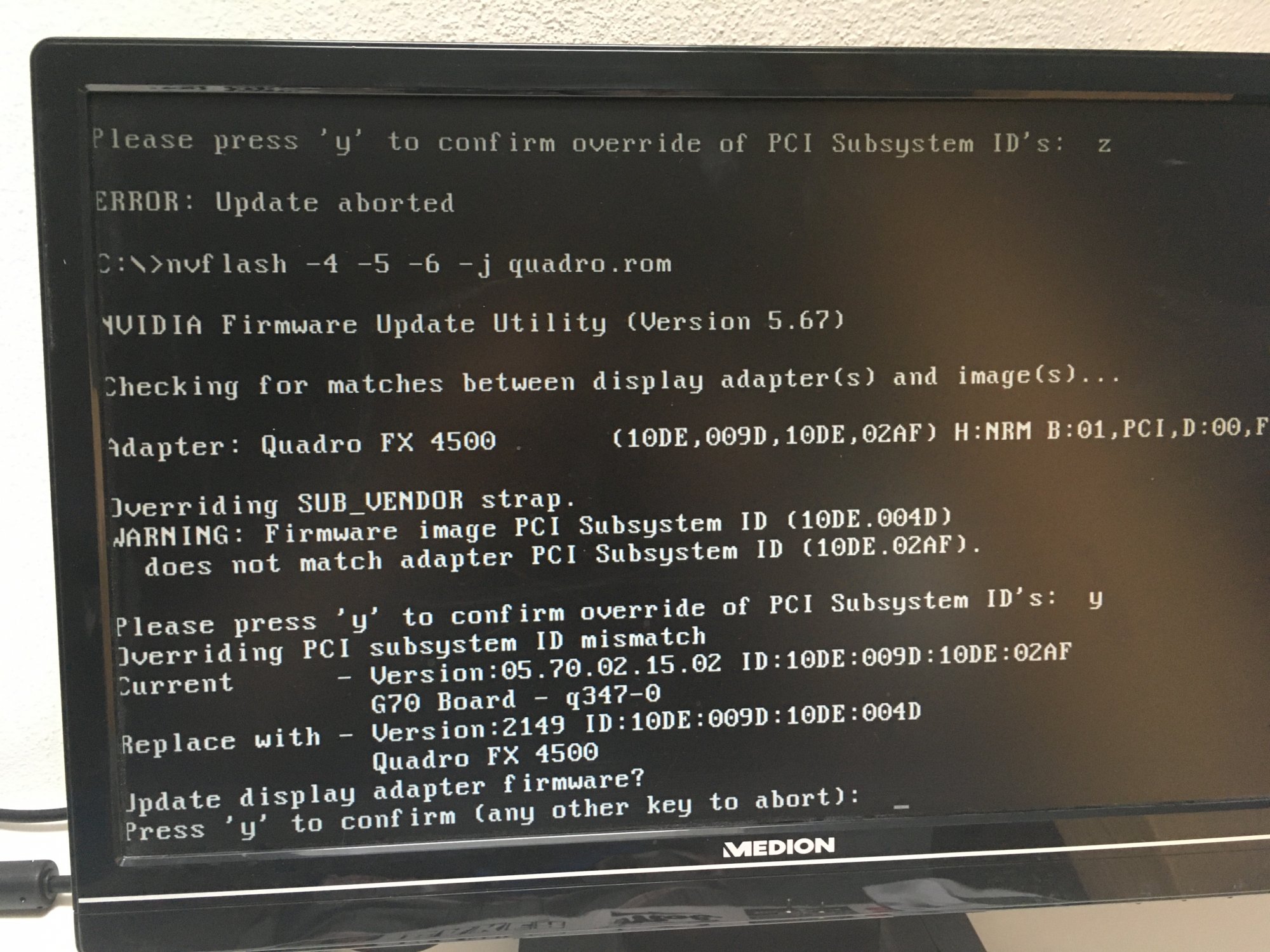

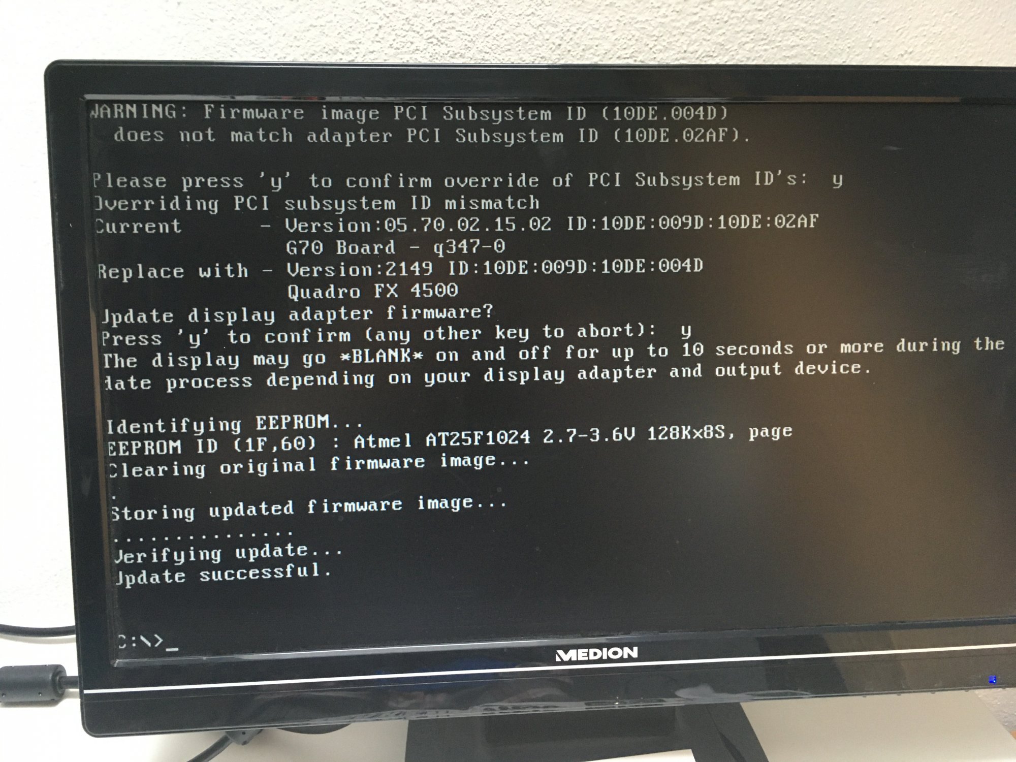

Typing the necessary command:
Confirm all prompts. It actually seems to have worked!

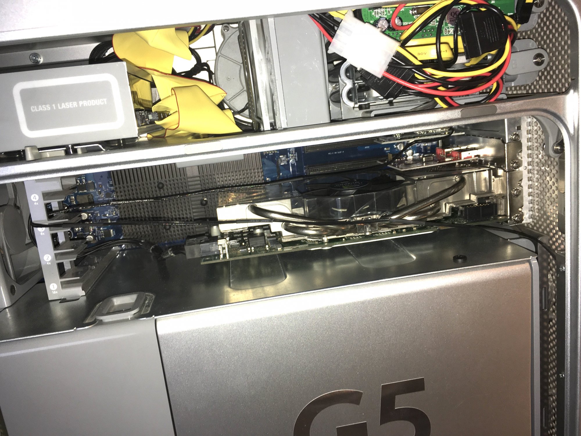

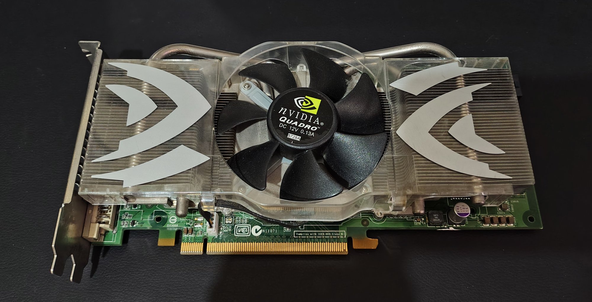

In goes the Quadro FX 4500 (and out goes the GeForce 6600):

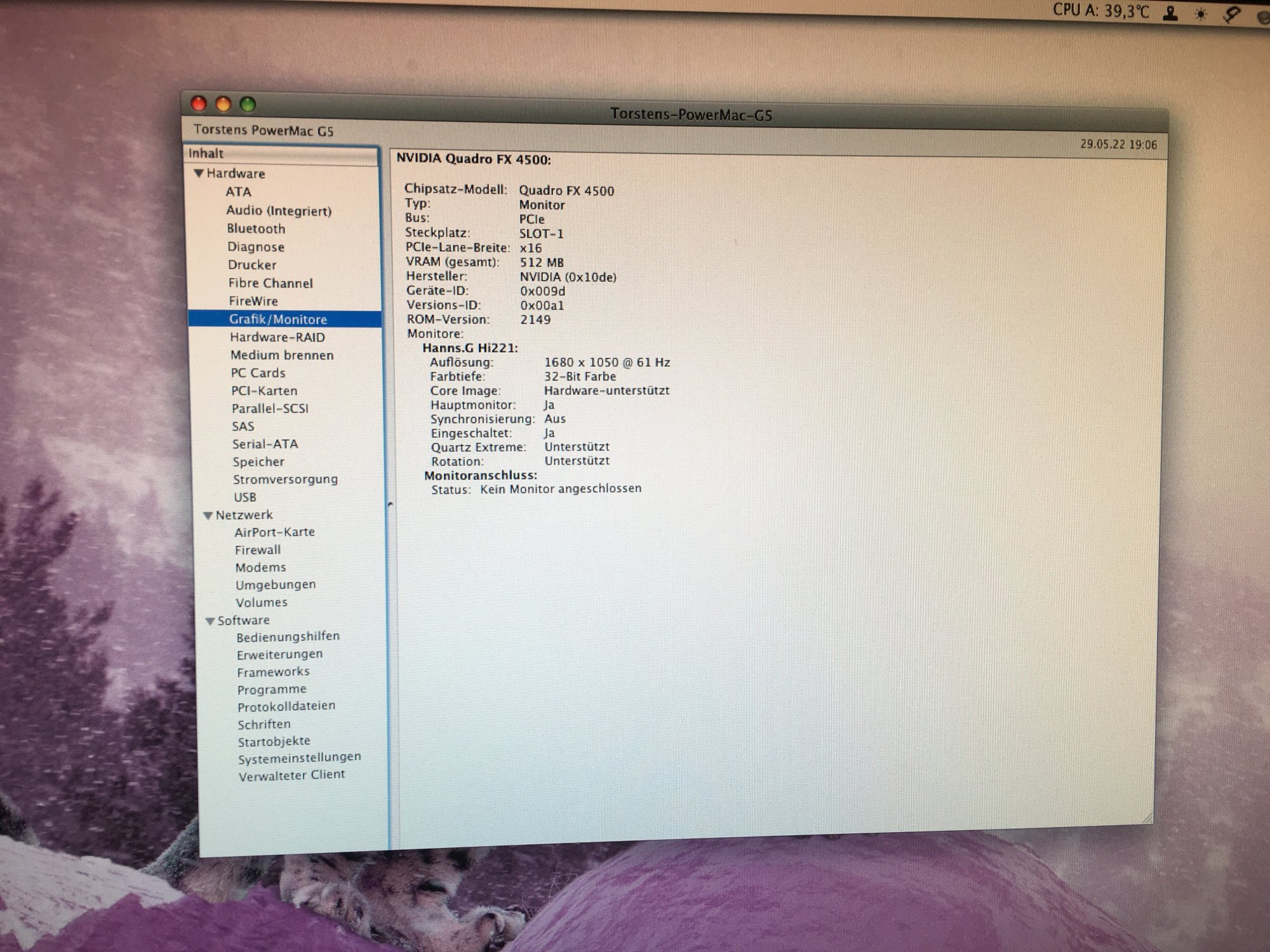

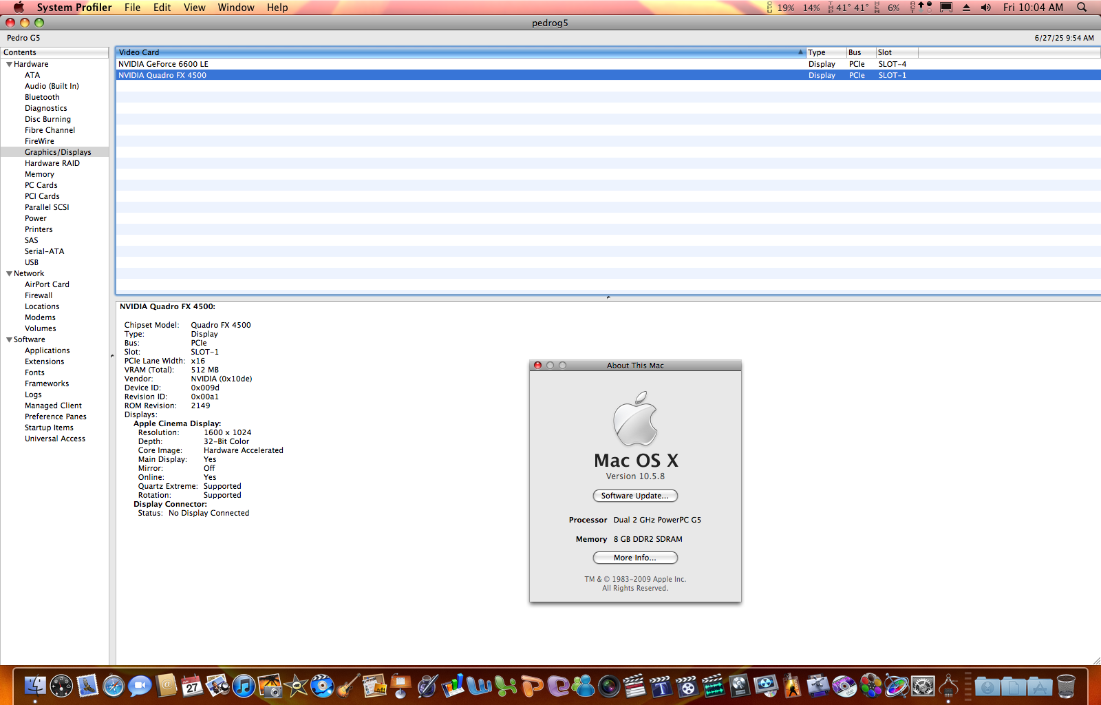

Of course I did everything shown above twice and I can happily report that both cards work in both G5s:
I'm really happy that I'm now in the FX 4500 club but I honestly have to say I do not notice the potential improvements right of the bat. So the next thing to do is to try some benchmarks and games :cool:

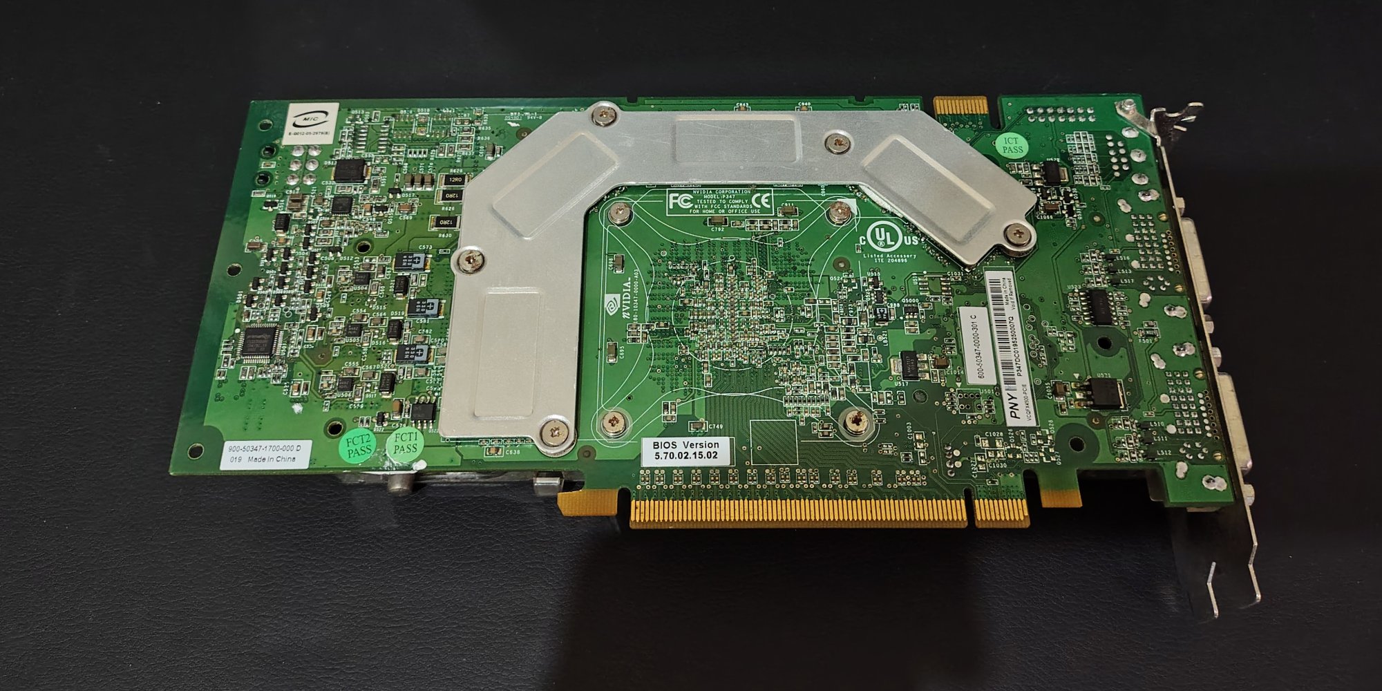

I've now successfully flashed a single-sided card (Unbranded Revision A00, no metal plate on the back) and it's working great in my G5 Quad
Things I've discovered along the way:
1) NVFlash wouldn't work on my system (3770K/Z68) if the boot drive was created with the HP tool - kept crashing with General Protection Faults. Works flawlessly with Rufus/FreeDOS
2) Flashing with the ROM in this thread didn't work with my single-side card - the G5 could clearly recognise it but there was nothing but artifact on the display
3) Flashing with the ROM in another forum (https://68kmla.org/bb/index.php?threads/troubleshooting-quadro-4500-fx-in-g5-quad.40165/), described as being specific for single-sided cards worked great
4) After this first flash, I had the same issue that Aaron111 described - SIGSEGV error and card then identifying as a GO 7800 until reboot. Having run out of things to try, in desperation I rebooted, erased the EEPROM with 'nvflash --eraseeeprom', then immediately flashed with the correct ROM. Fortunately, the gamble paid off - successfully flashed with the single-side bios and it worked in the G5!

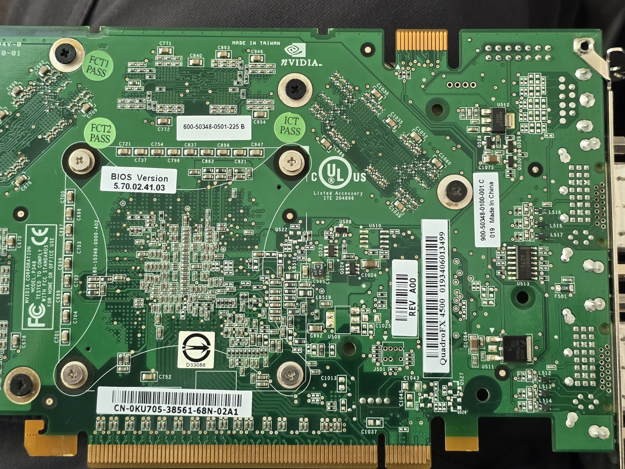

Using this process I successfully flashed two Quadro FX4500 (single sided VRAM). Attaching pictures of the board here for everybody's reference (bought them on ebay, came from a server with a bracket which I removed)

I have an identical card to the poster above and flashing it with the single sided ROM seems to have bricked it :\
I used NVFlash 5.31 on an Intel PC motherboard (using the iGPU) via FreeDOS, a setup I used successfully multiple times with my GeForce 7800 GT for flashing G5 ROMs.
The Flash completed successfully with no errors or alerts. The G5 won’t chime with it in and in the PC board NVFlash no-longer sees it.
EDIT: I realise an error I made now, I missed the -j flag in the nvflash command - would that brick it?
