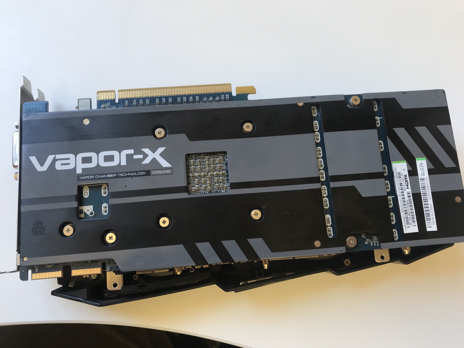

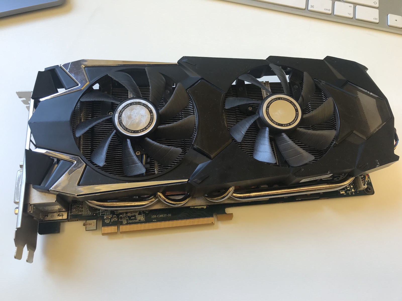

Spend days looking for the right EFI BIOS for my Sapphire R9 280X Vapor-X 3GB card. Pressed the button (LED off), saved the original BIOS, added the EFI headers with the script, flashed the new BIOS but still no boot screen when starting up my Mac Pro.
Does anyone have a working Mac BIOS for my card ?

is your card the blue black one with three fans? can you send your rom i can make your rom for you.
investaparis@gmail.com
Thank you! It's the dual fan version, all black and grey. See pics. The ROM (one with button pressed, other off) are included too, cheers!
