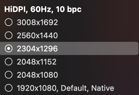

Is this really true? I currently use M1 MacBook Air with LG C2 and I am using HiDPI 2304x1296 res at 60hz (max I can do with my cable).
Can Mac Mini M4 do 120hz HiDPI 2304x1296 with HDMI 2.1 cable on LG C2? I have M4 Mini in order but seriously reconsider if I am forced only to 1080p HiDPI.

I sit about 38 inches away from my LG C2 42” and the 3008x1692 recommended resolution for HiDPI looks great to me. I still get 120Hz and the UI looks fine.
Do you notice a difference in sharpness between 3840x2160 and the resolution you mentioned? The first post also mentioned 3360x1890. Have you tried that?
