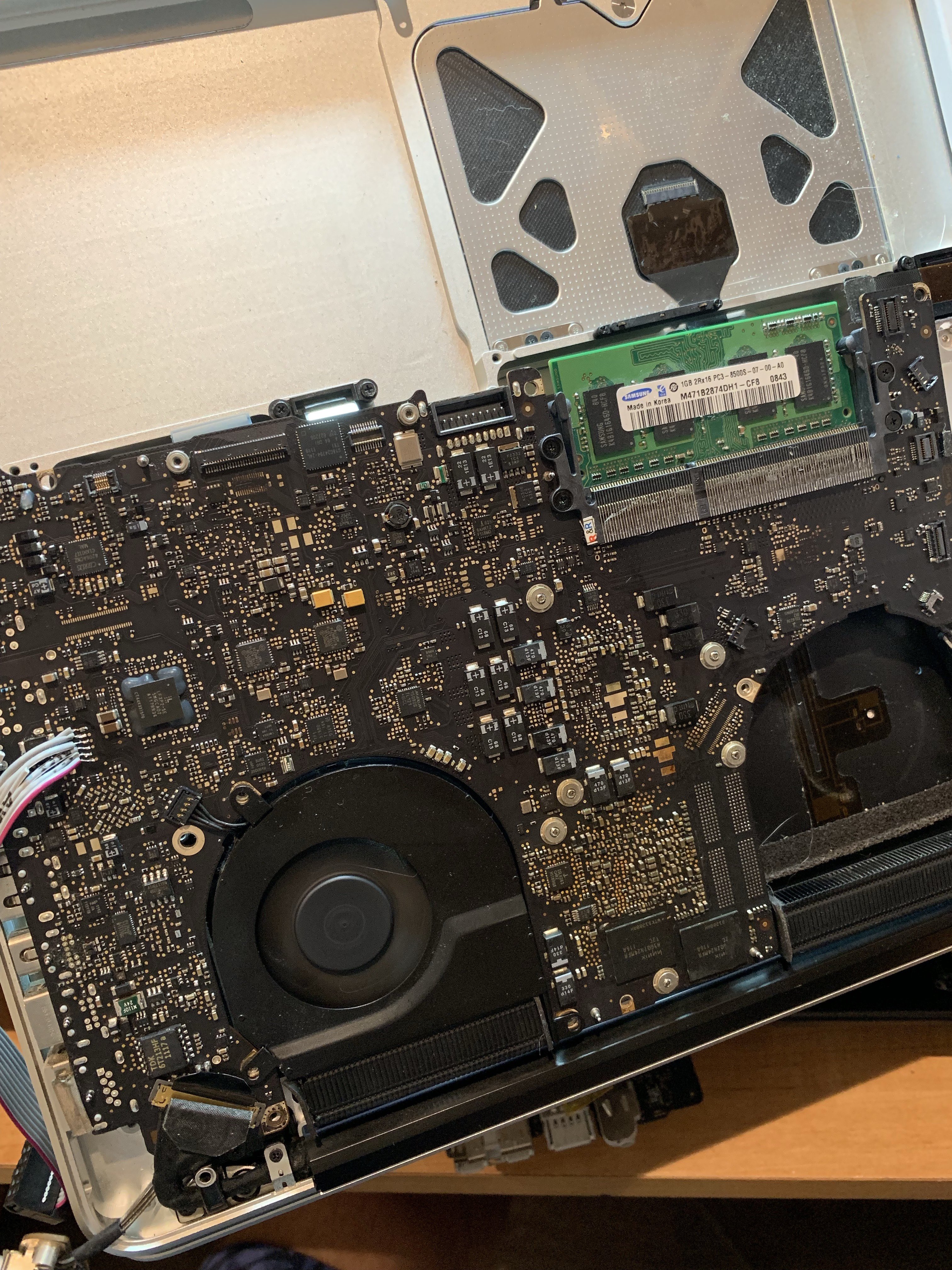

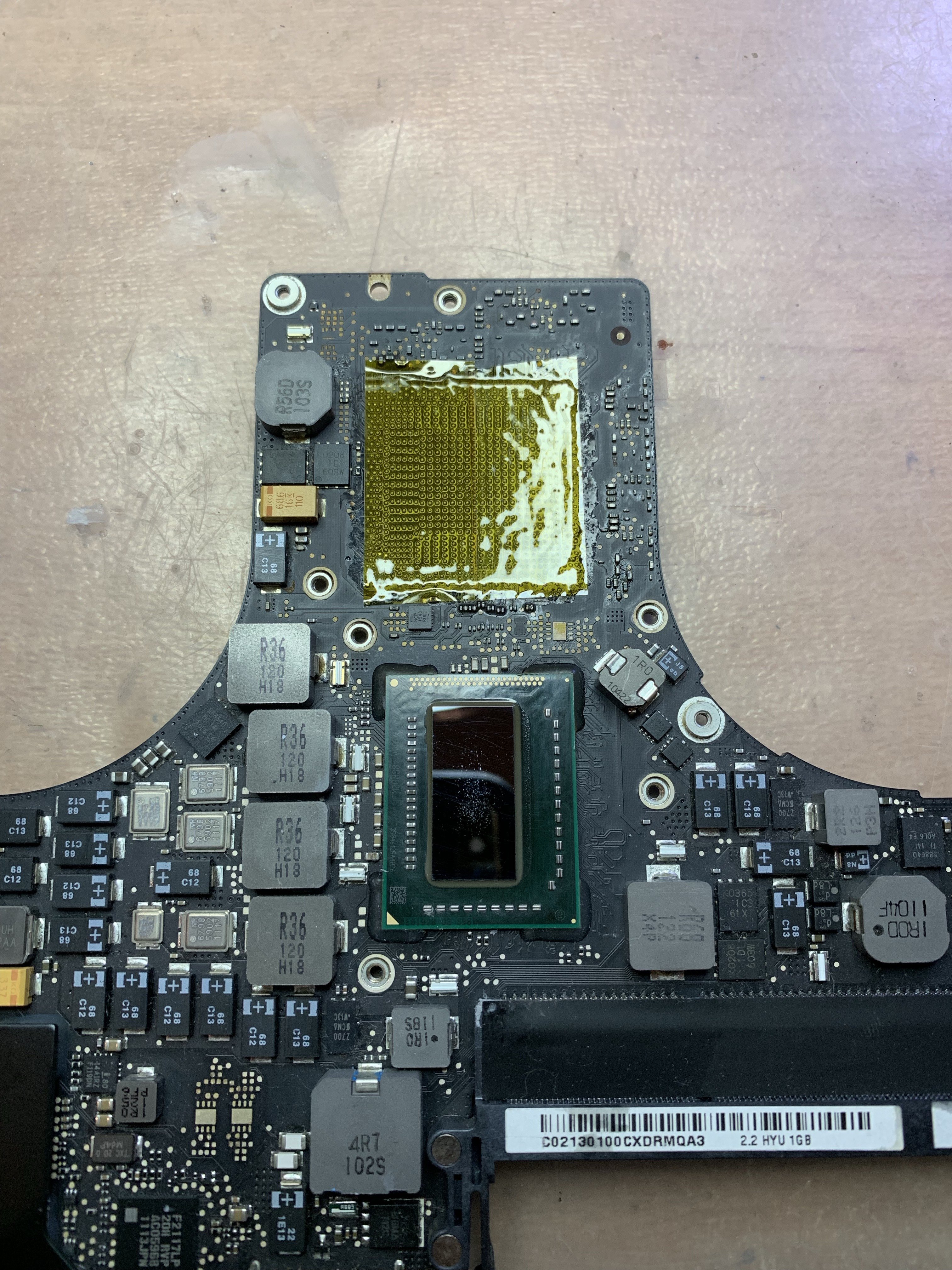

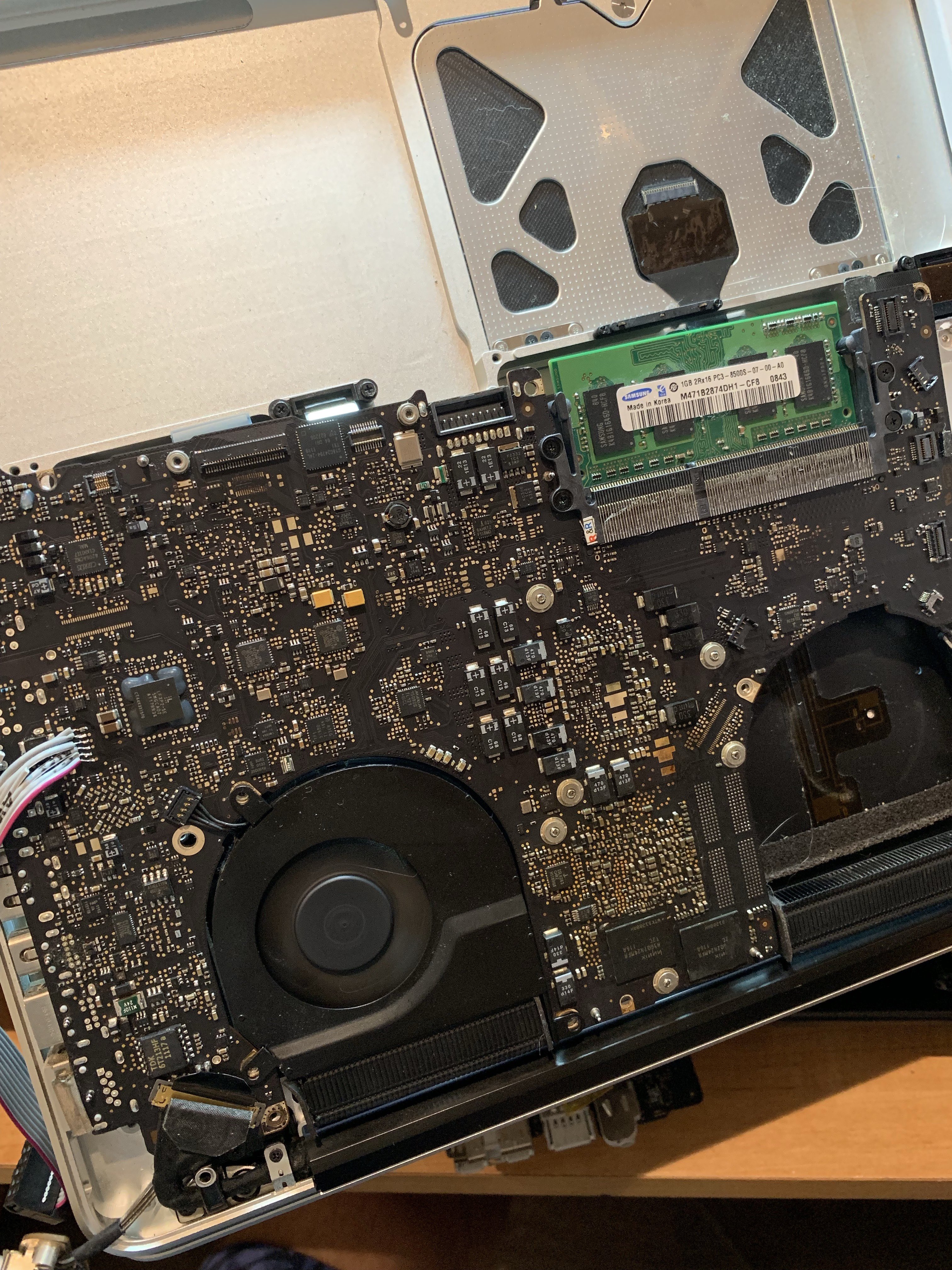

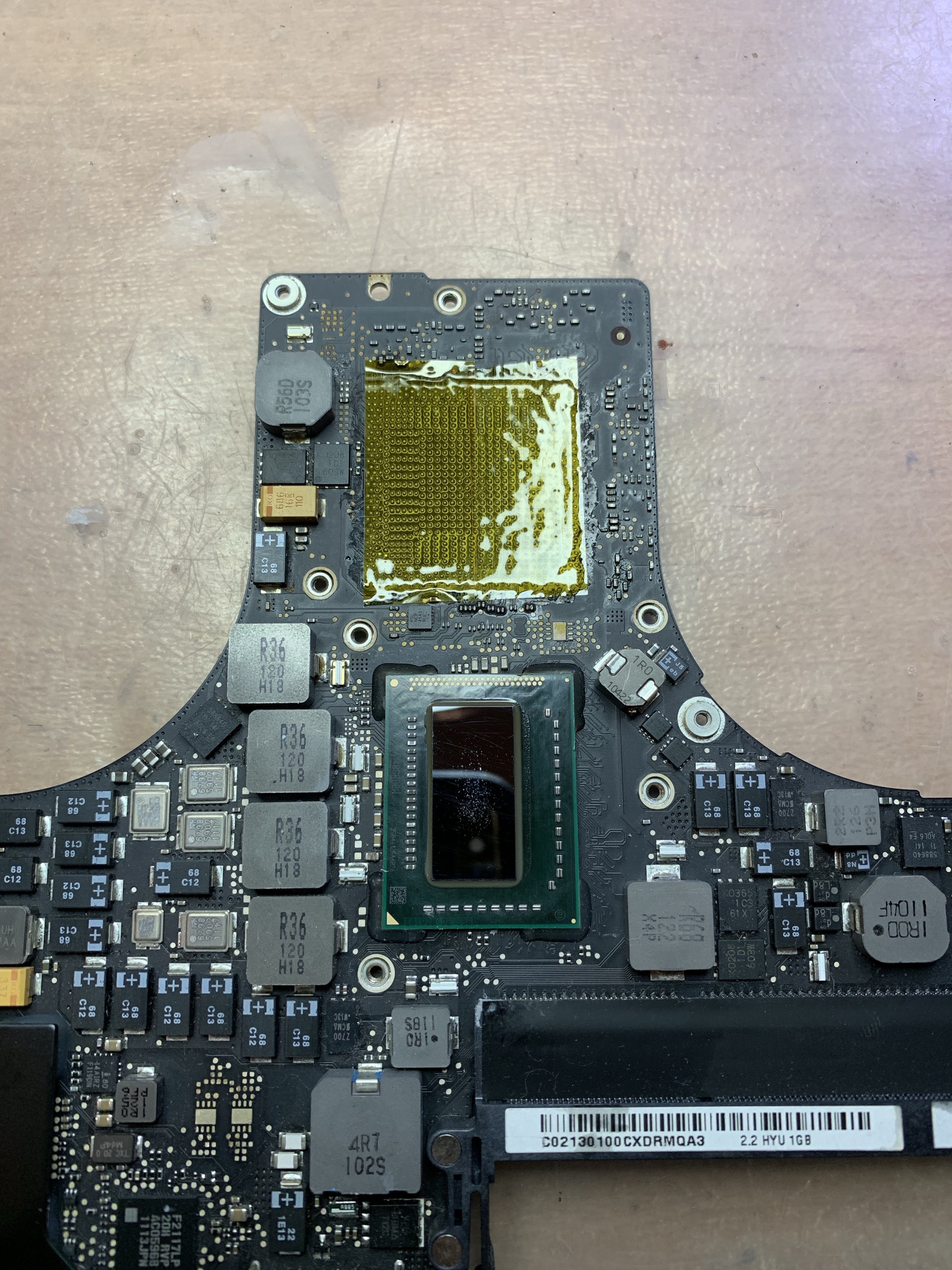

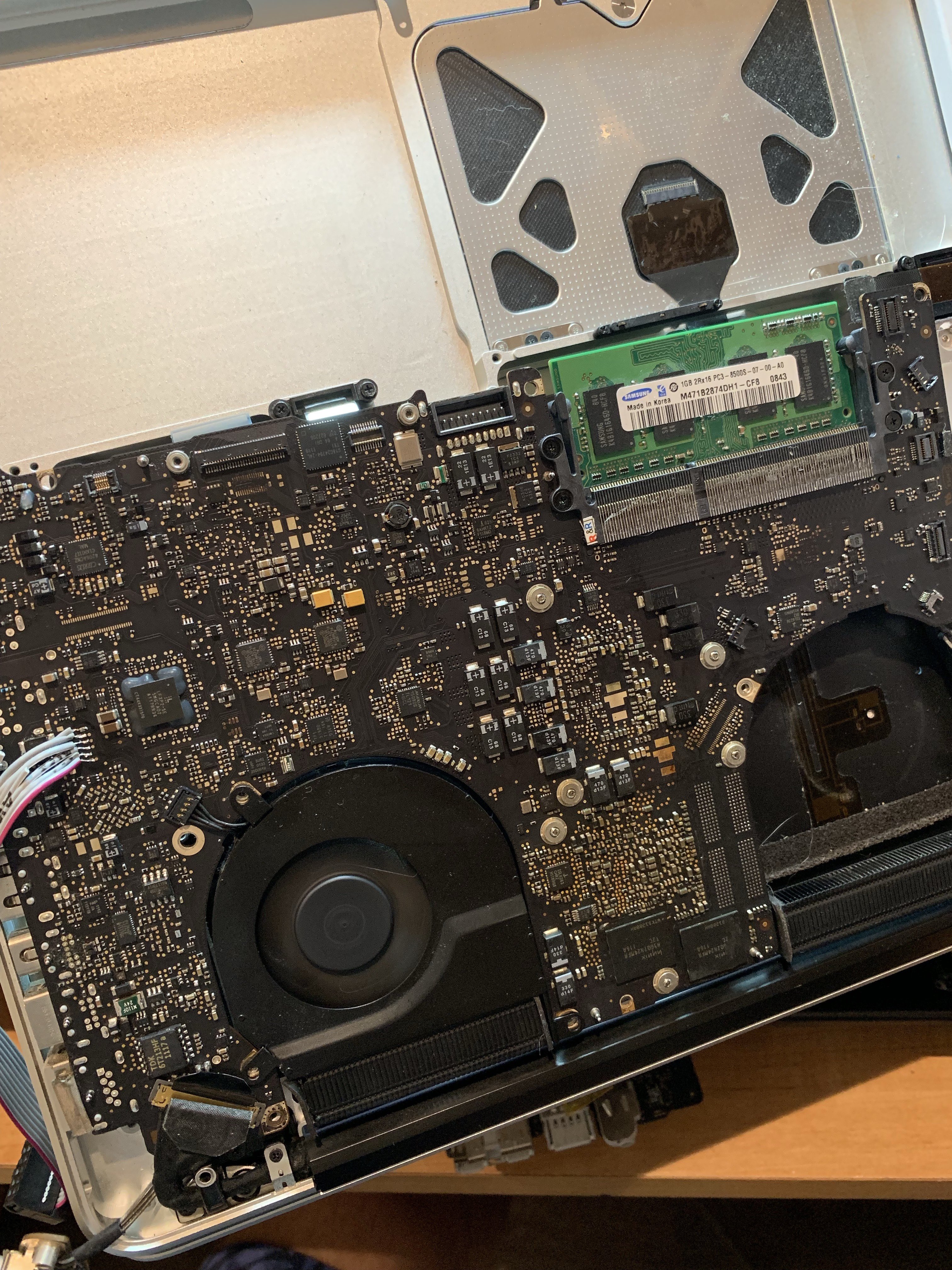

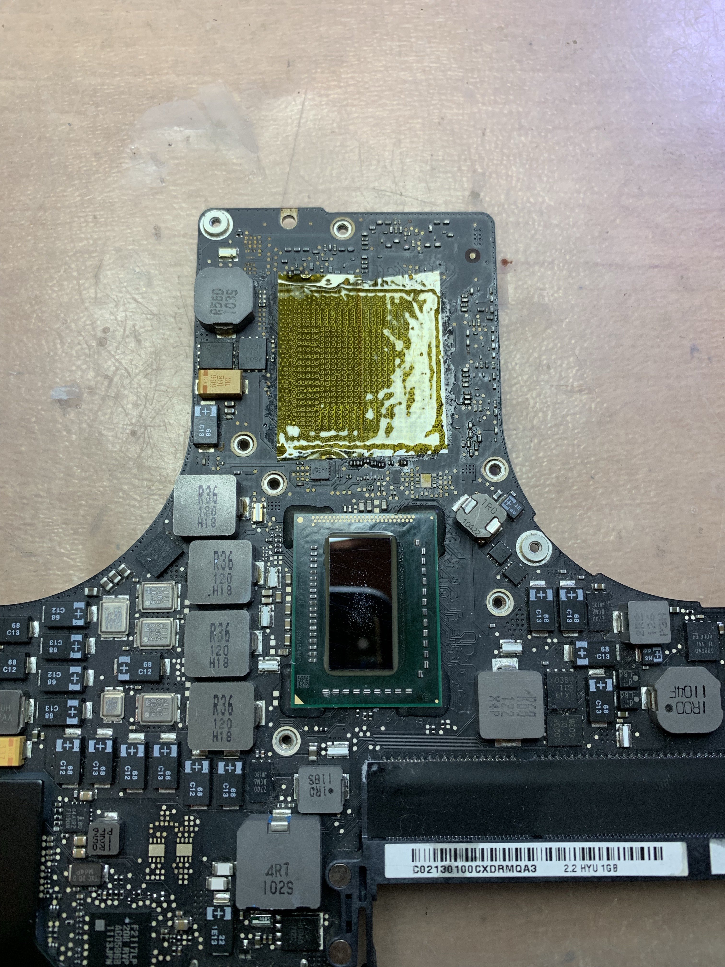

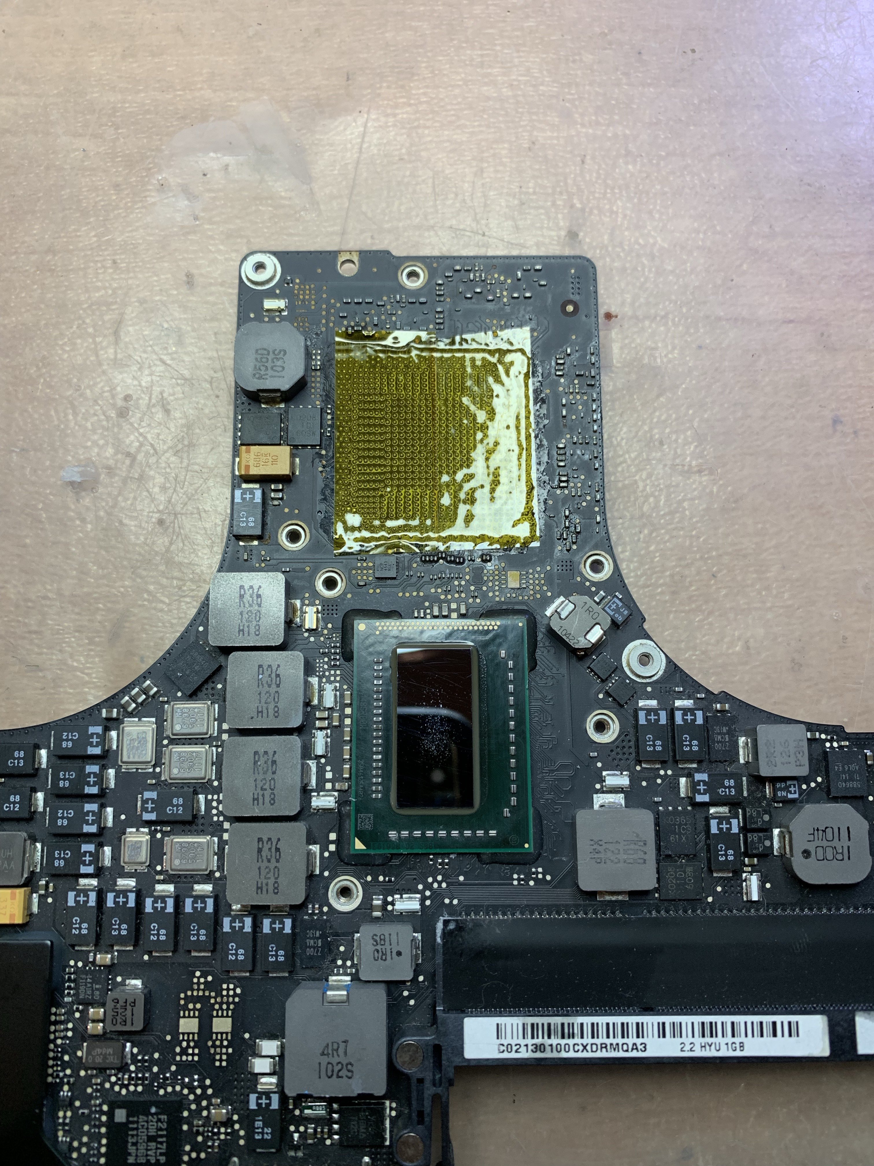

I have a macbook pro 2011 with a problem on the chip. I took it in an electronics to make the exchange but they failed and left the chip off the plate. will it be possible to connect the macbook without the graphics chip? or is it not recommended? Is it possible to function?
dosdude1
macrumors 68030
Feb 16, 2012
2,776
7,409
Yes, but you will have to disable the dedicated GPU via hardware, or by using my custom gMux IC firmware. Somebody actually just did this yesterday with my custom firmware, and it worked great!
https://forums.macrumors.com/thread...-gmux-ic-bypass.2134019/page-15#post-27442622
View attachment 841776 View attachment 841777 View attachment 841778

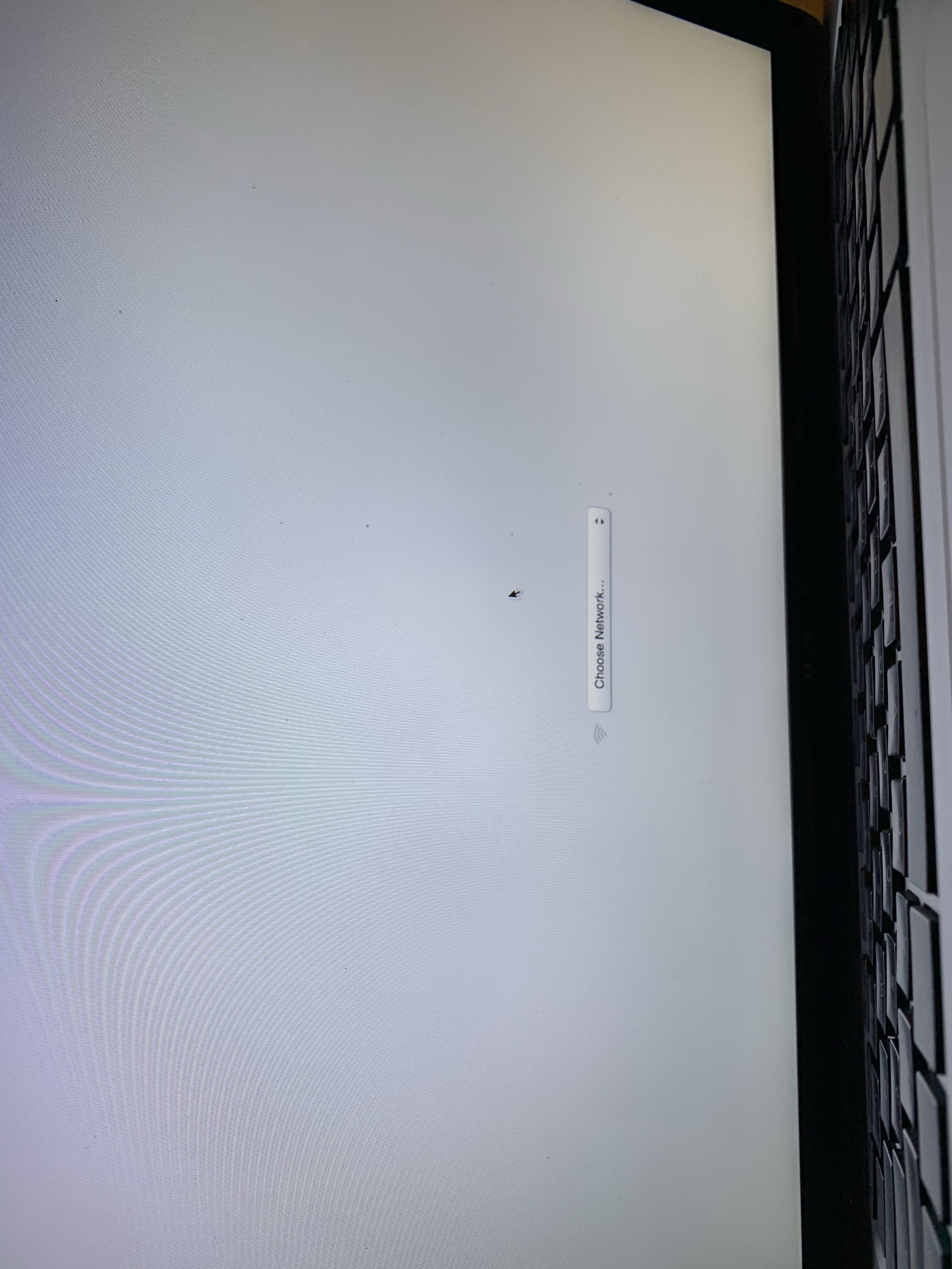

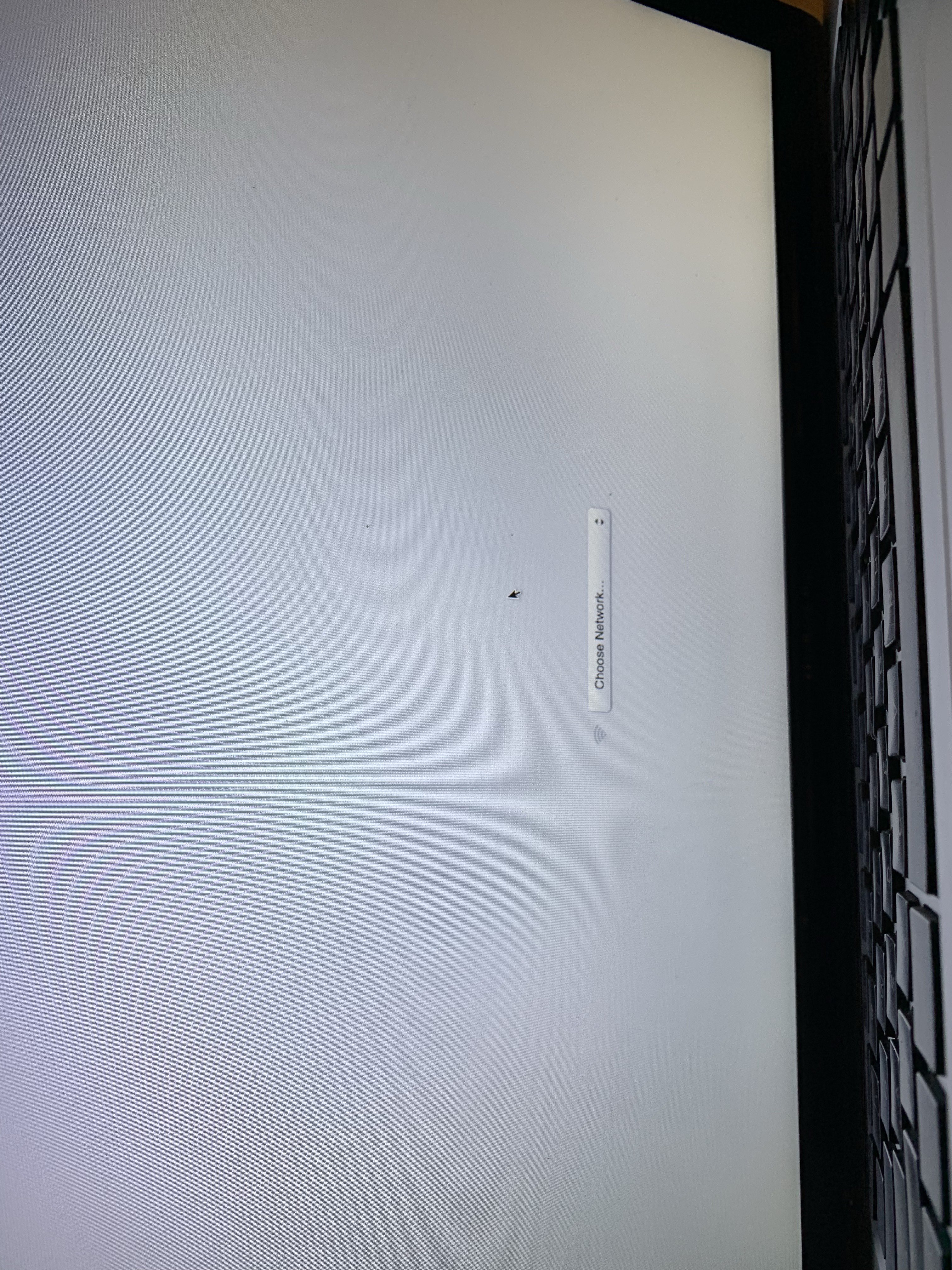

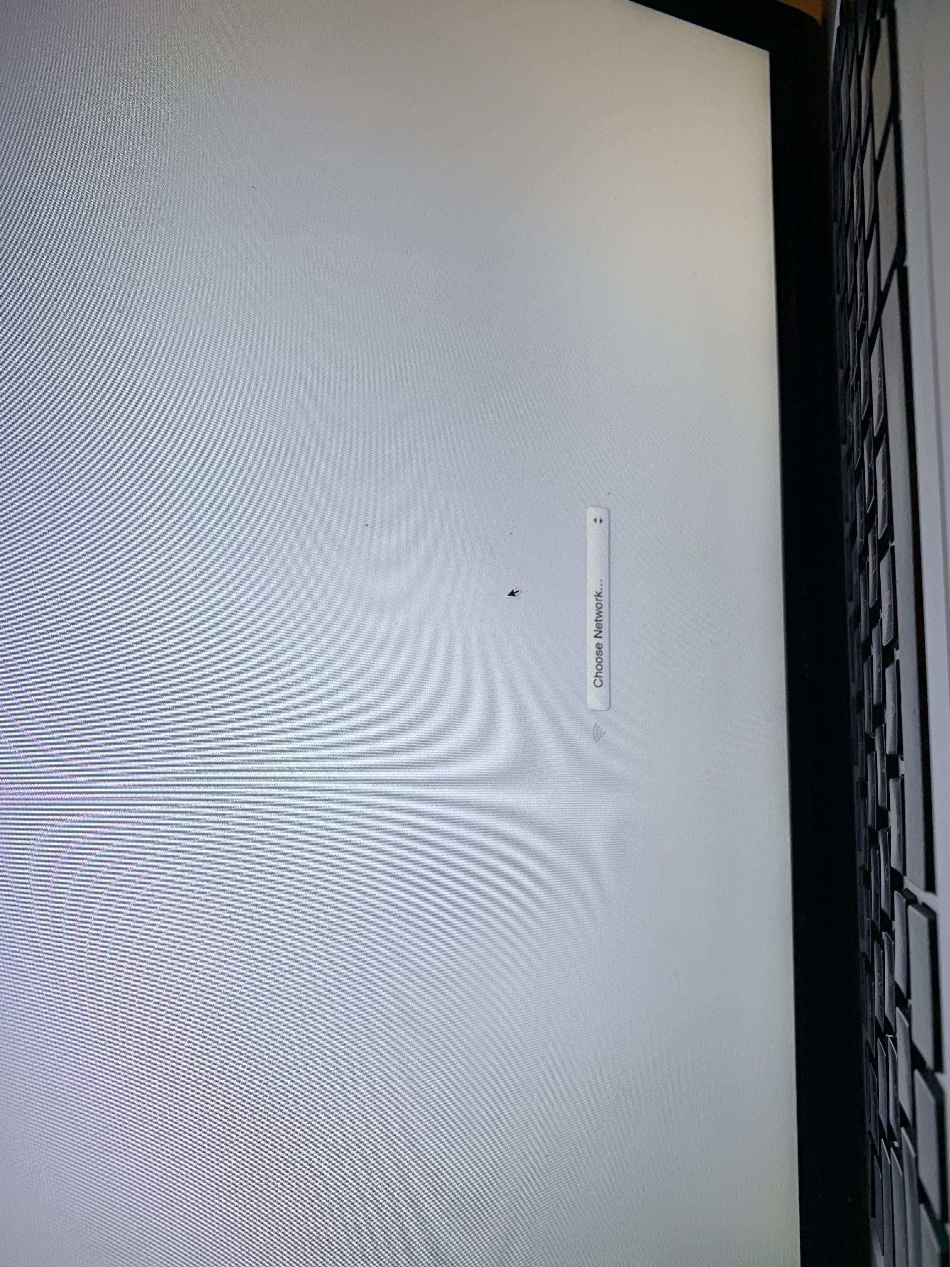

Can you tell me if I can do the recording with this device? I am in Brazil and if you buy Lattice, it takes about 45 days to arrive. I need my laptop urgently !!!!
https://produto.mercadolivre.com.br...i-usb-blaster-cpld-fpga-000102-_JM?quantity=1

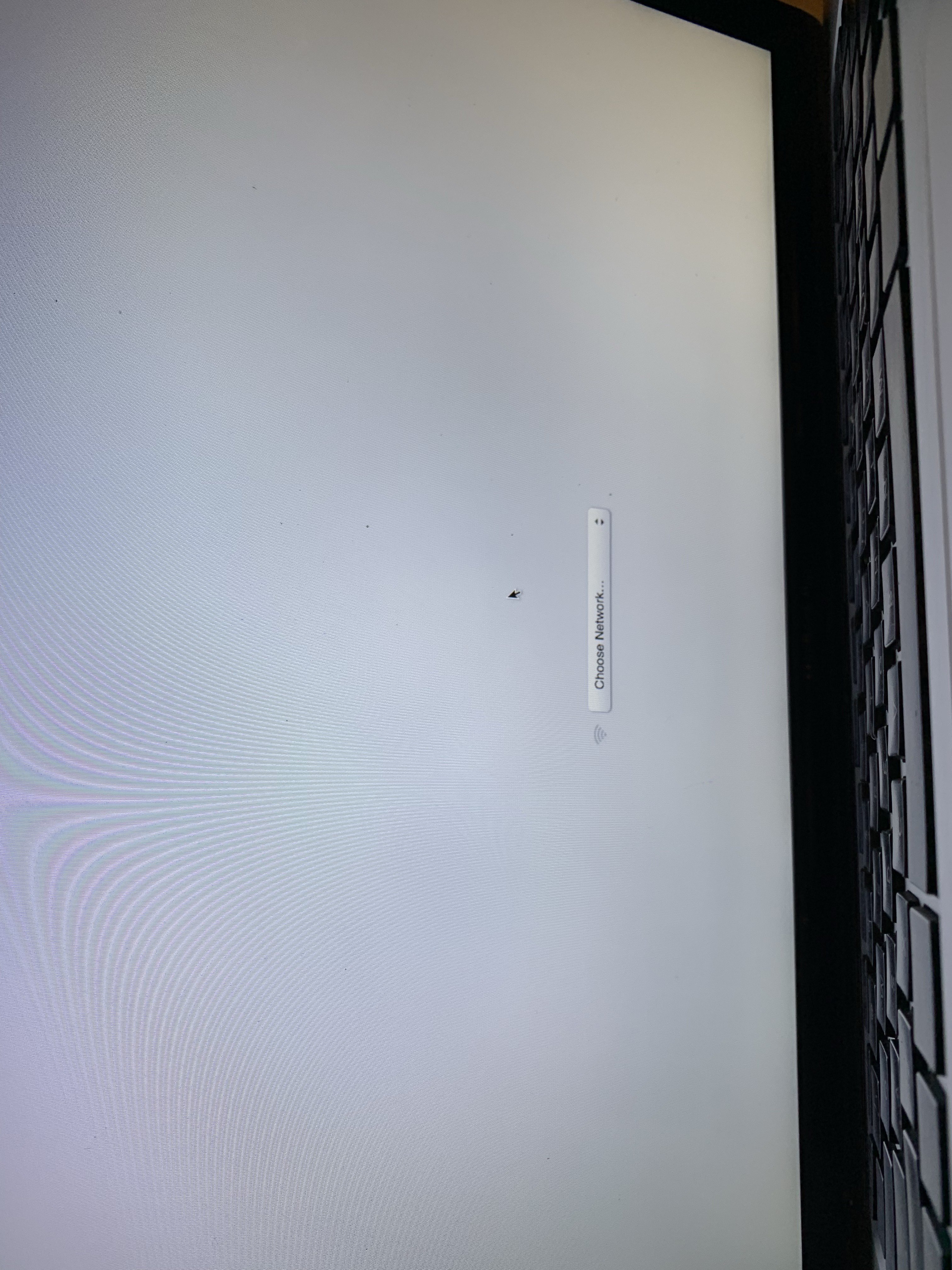

One question to you. If I shutdown my Mac after lets say a month, and after I believe NVRAM variables are resst, it takes mighty long time to start it again. What I mean is, either one of the four things happen.
1. it boots with a chime but with full black screen, I cannot see any apple logo even if I light up the back side of the screen. I have to force shut down again.
2. It boots with repeating chime sound and full black screen, [sound]...1sec....[sound]....1sec....[sound].... and continues till I force shut down again.
3. It boots with distorted screen(sometimes blue/ grey and white distortions) and I cannot see nothing, where I am or can go, so I have to restart it again, then either 1 or 2 of the things above happen again.
Finally after many/too many force restarts and going through 1 and 2 the most of the time and 3 the least, and after letting the mac to overheat for sometime(might be a placebo)
4. a final eye warming boot screen with no distortions appear and I can get into the single user mode, see clear texts, set the NVRAM variable and get into the login screen. Then it works untill I restart.
What do you think is causing the full black screen? Do you recommend doing anything to boot it up in one go?

Maybe you have a problem in EFI chip (inside logic board).
1 - The Macbook Pro 2011 that I do the tests never lost the "nvram gpu-power-prefs". Only when I do the "reset NVRAM/PRAM".
2 - Repeated chime sound may be a problem in one of the memory slots or the RAM module.
If you have two RAM modules then you can leave only one RAM module and see if the problem continues.
If the chime sound continues, then test the RAM module in another slot.
The Macbook Pro 2011 that I do the tests has a problem in one of the RAM slots. My solution was to buy an 8GB RAM module and put it in the Slot that is working properly.
Now I do not have the sound of repeated chime.
3 - EFI chip lost NVRAM gpu-power-prefs to Intel GPU.
Overheat Macbook Pro 2011 does some things on the AMD GPU chip.
In my first tests I had to overheat the Macbook Pro 2011 to be able to get into the Recovery Mode graphical environment.

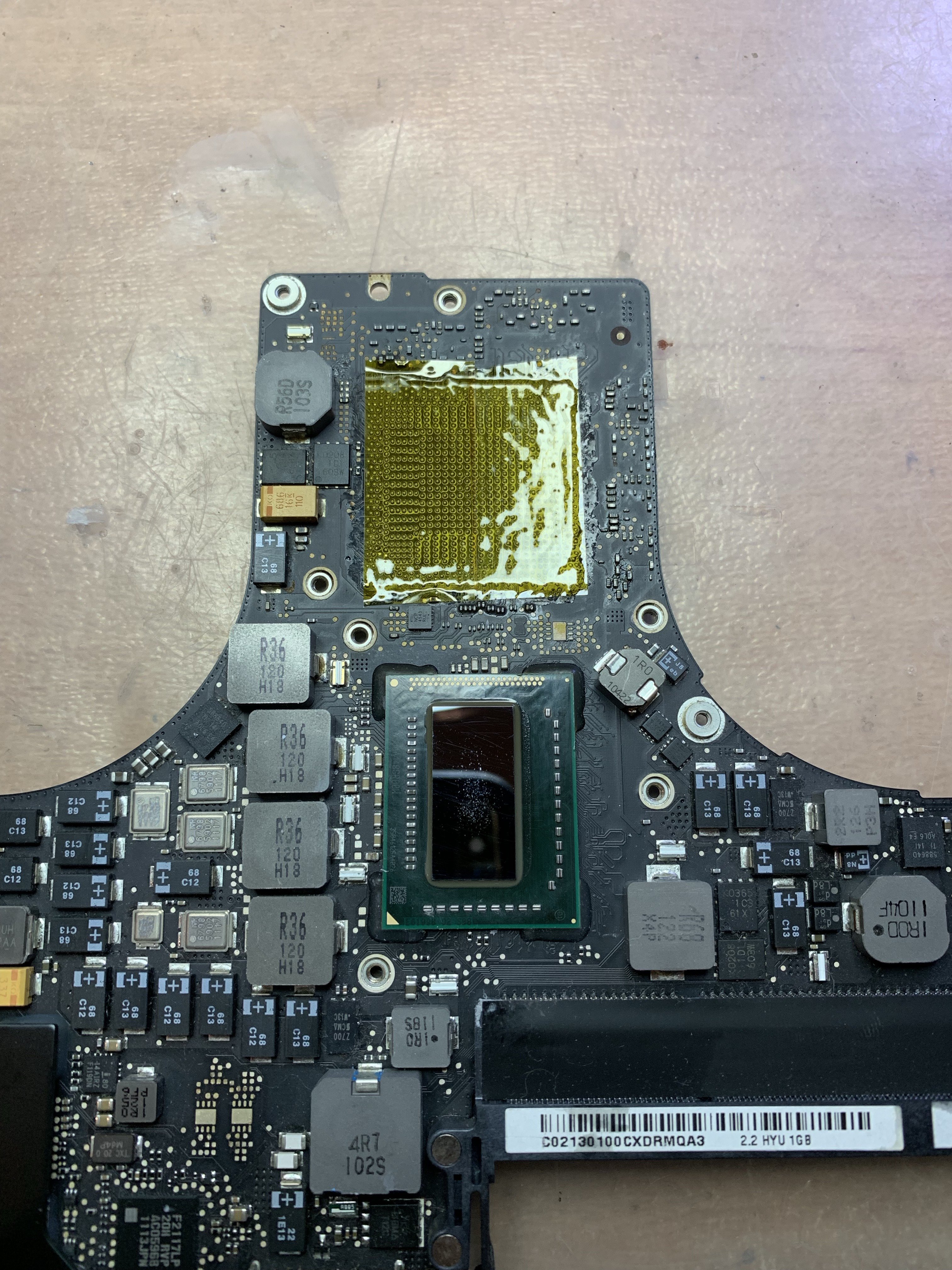

Has anyone tried realising the GPU with a heat gun?
Failing the EFI and reflowing fix, is their anyway the machine is salvageable?
Do the Chinese make working logic board copies?
Can the parts be re build in another machine ?
