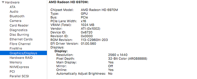

Hi everyone,
I have a 2011 17-inch MBP that I had reballed (yes I watched Rossman's video). It lasted over a year, which I guess is better than average.
I'm now considering permanently bypassing the AMD GPU, BUT - I am concerned about the following:
  1. Brightness control no longer working (this is documented)
  2. External monitor no longer possible (this is documented)
  3. Can no longer use certain apps, namely Parallels Desktop (I'm suspecting this)
I wanted to ask the folks here in this community and on this thread with some experience with this issue if:
  • A) they know of a way to address issue #1 and/or 2 above, and
  • B) they can confirm that indeed, Parallels Desktop cannot run if your Mac can only use the Intel chip)
  • C) if I try the command-only solution (not dosdude's physical chip), can I revert back to how it was before, and if so, is there a guide somewhere on how to revert?
Thanks in advance and if anyone has their MBP only running on the Intel chip, if you could try installing a trial of Parallels Desktop and see if it will run and boot a VM (I think it comes with a free Linux VM), I would be eternally grateful to you.

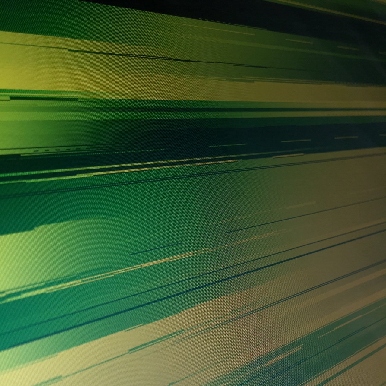

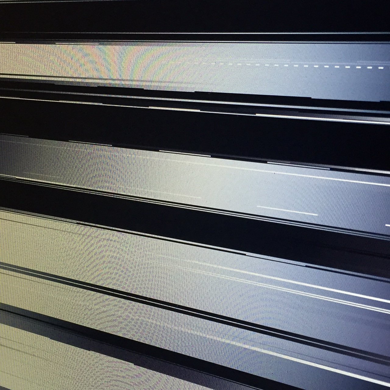

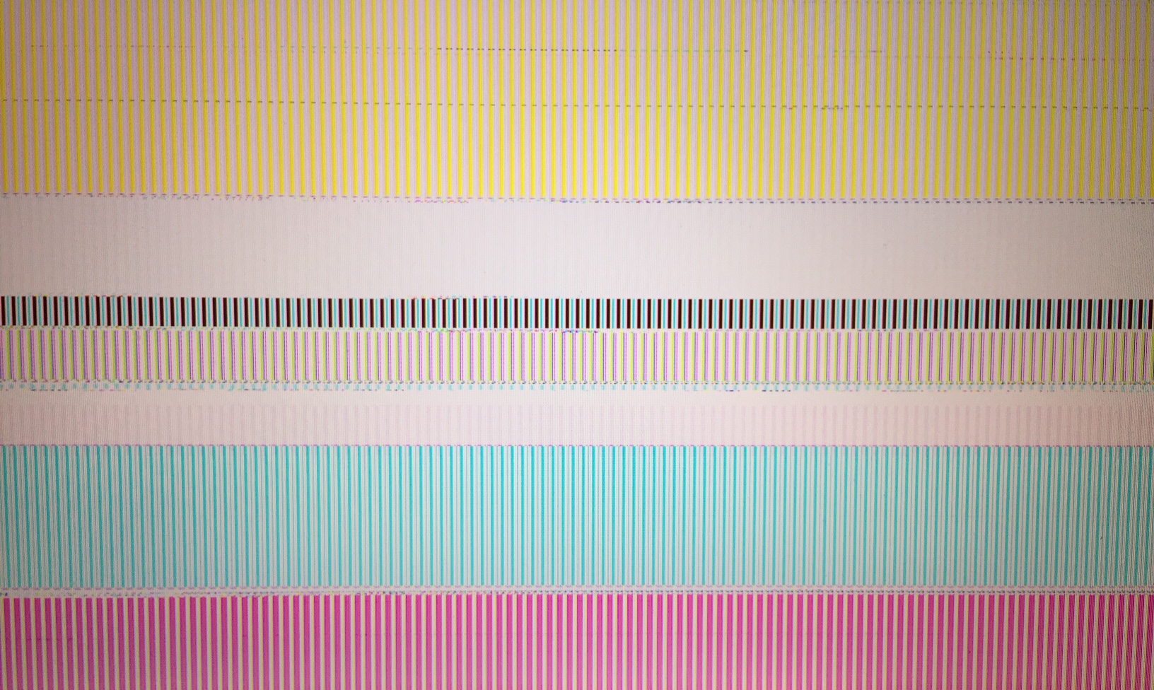

Did the same procedure.
I stay in El Capitan.. no problems so far

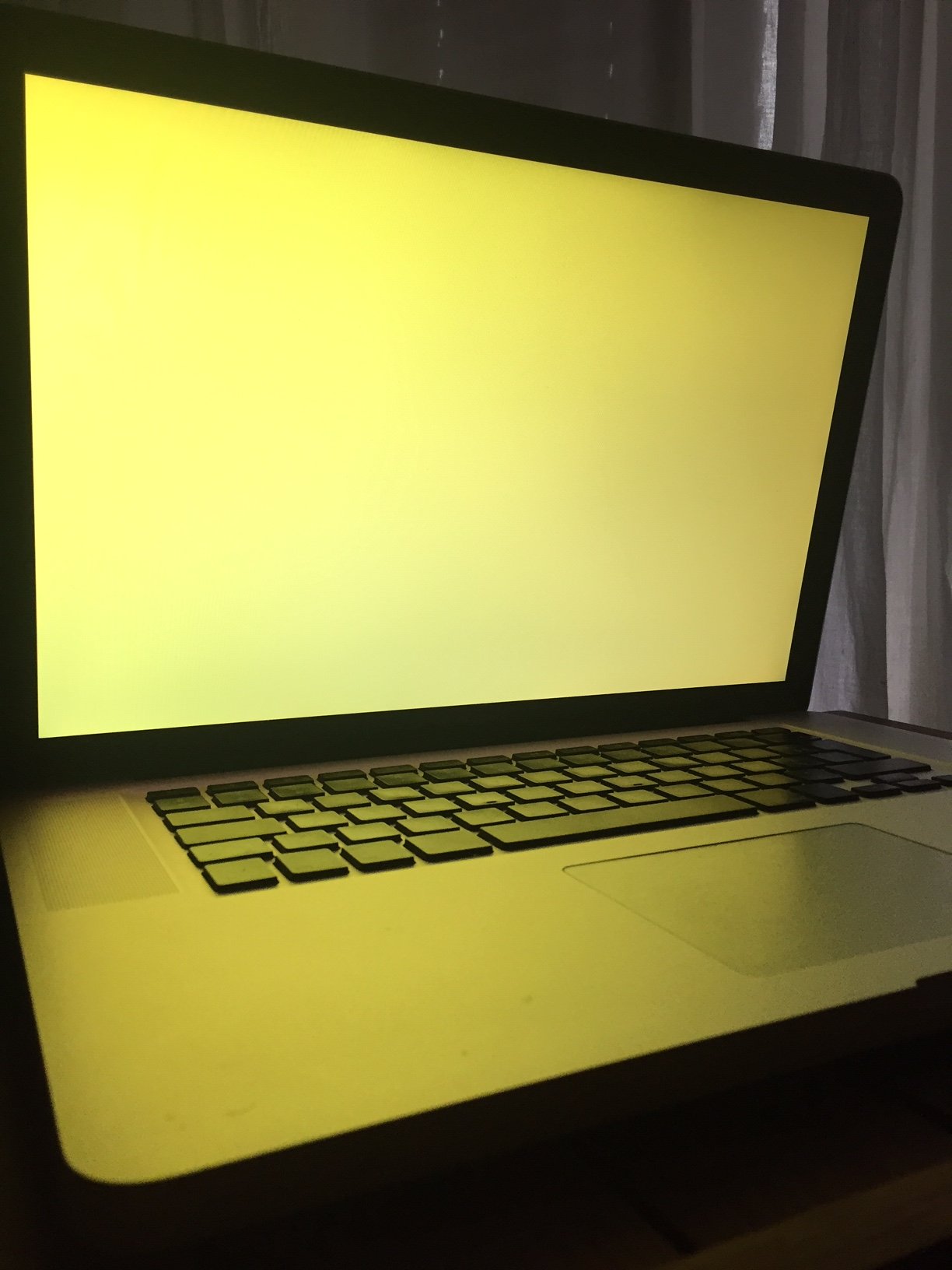

Just tried with one module, I will try tonight with the module of the other macbook
no beep sound, just the chime sound, sometimes a looping chime on booting (with black screen)
thank you for your assistance
edit : I can't try the other module, this ram isn't compatible with this mbpro (2011 and 2012 models)

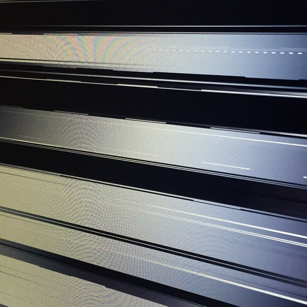

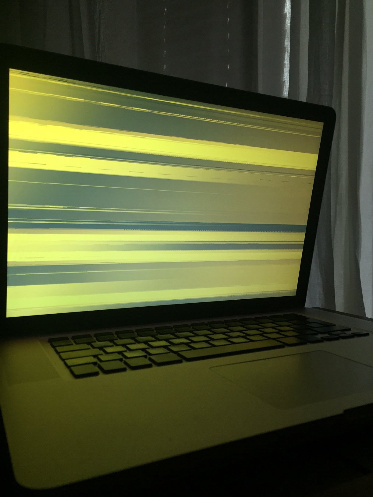

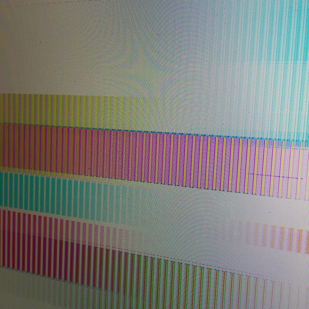

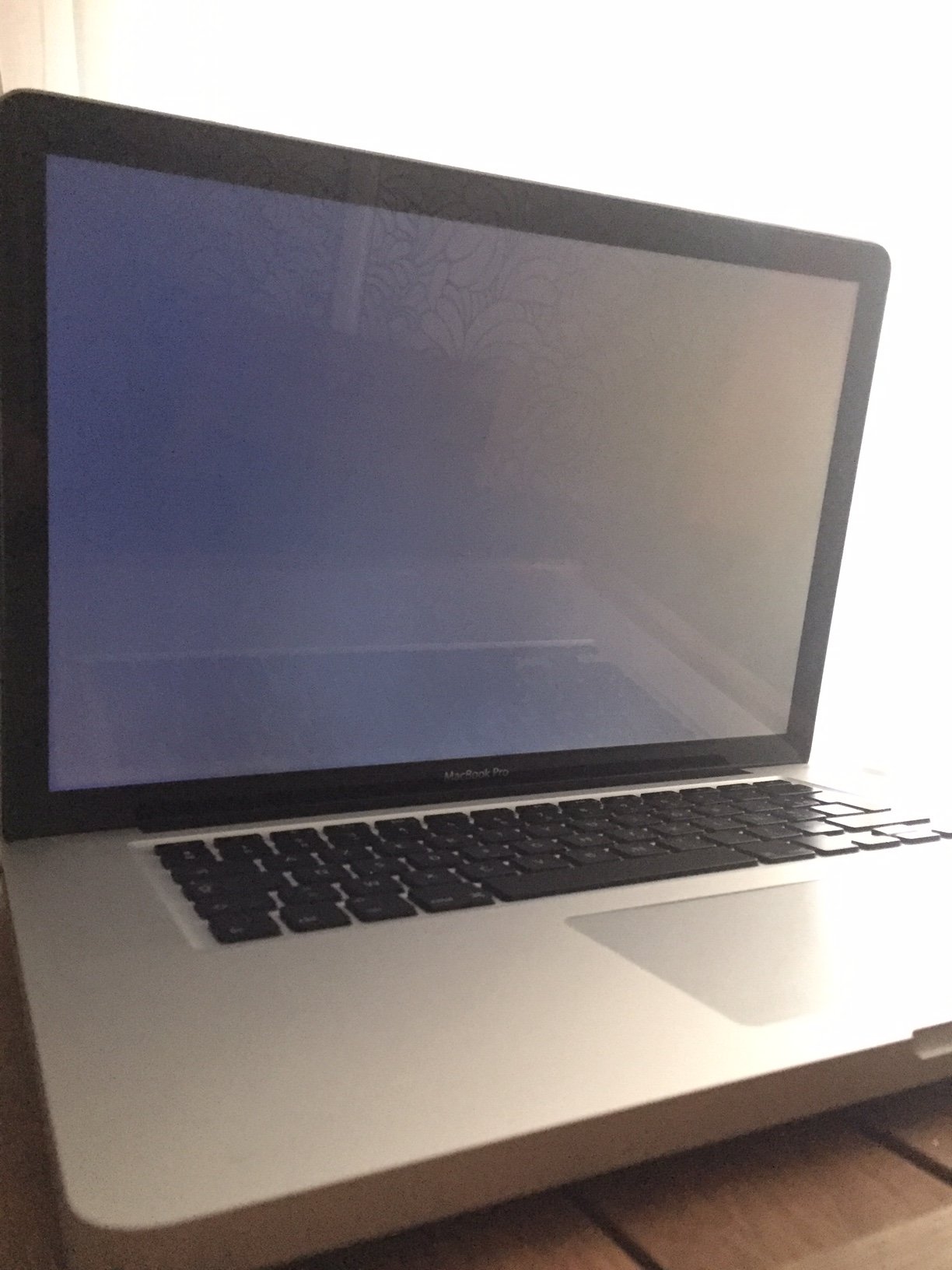

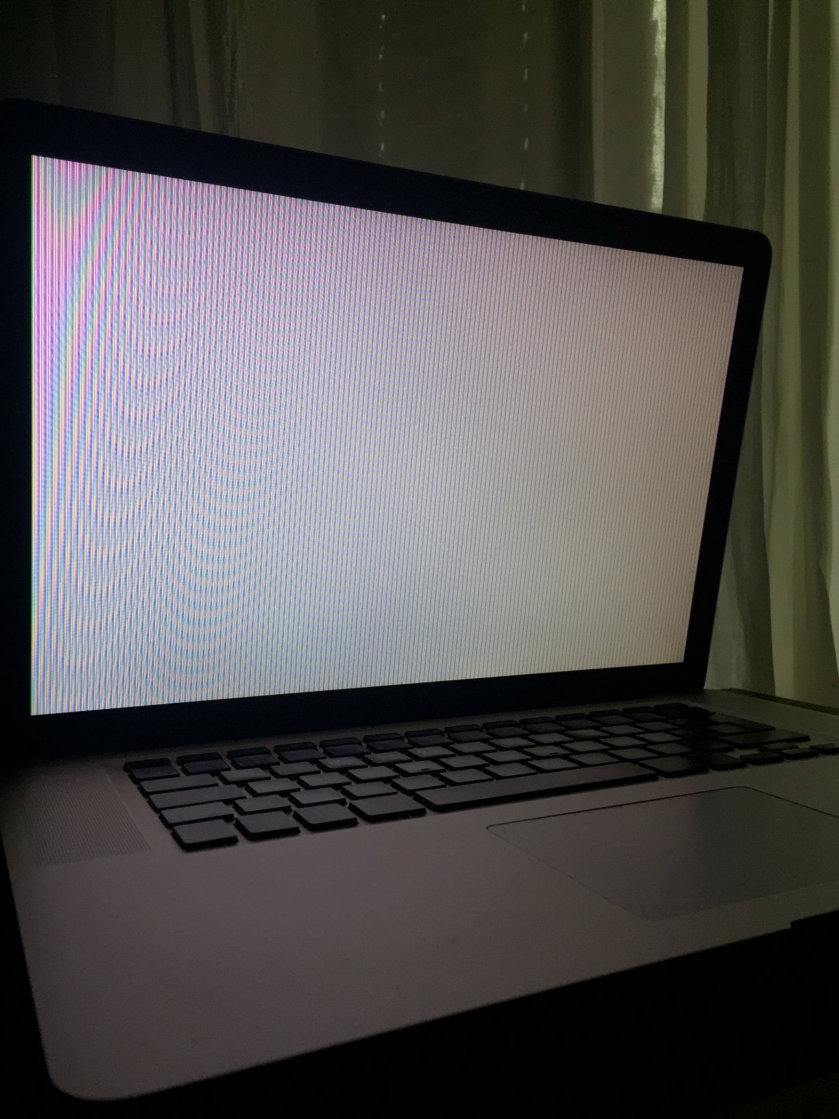

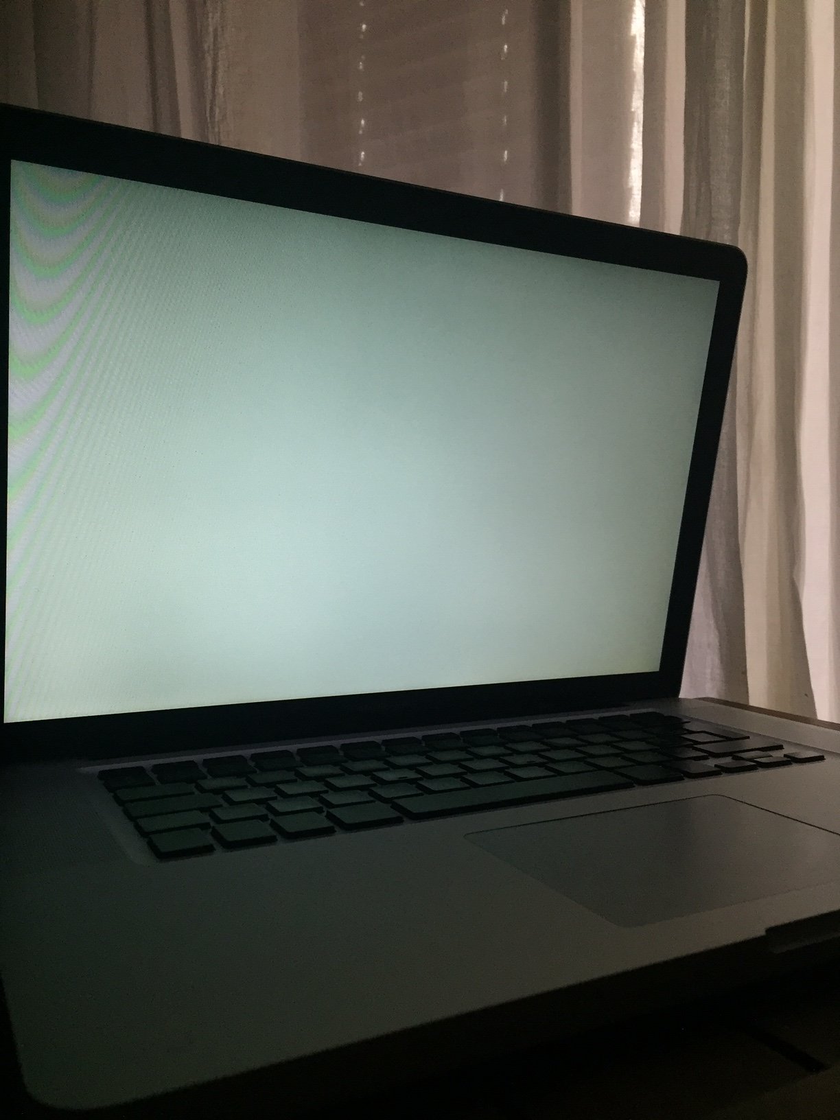

in my opinion, it's a gpu problem, I've always had these screen artifacts but until now I could start in single user mode, it's now impossible

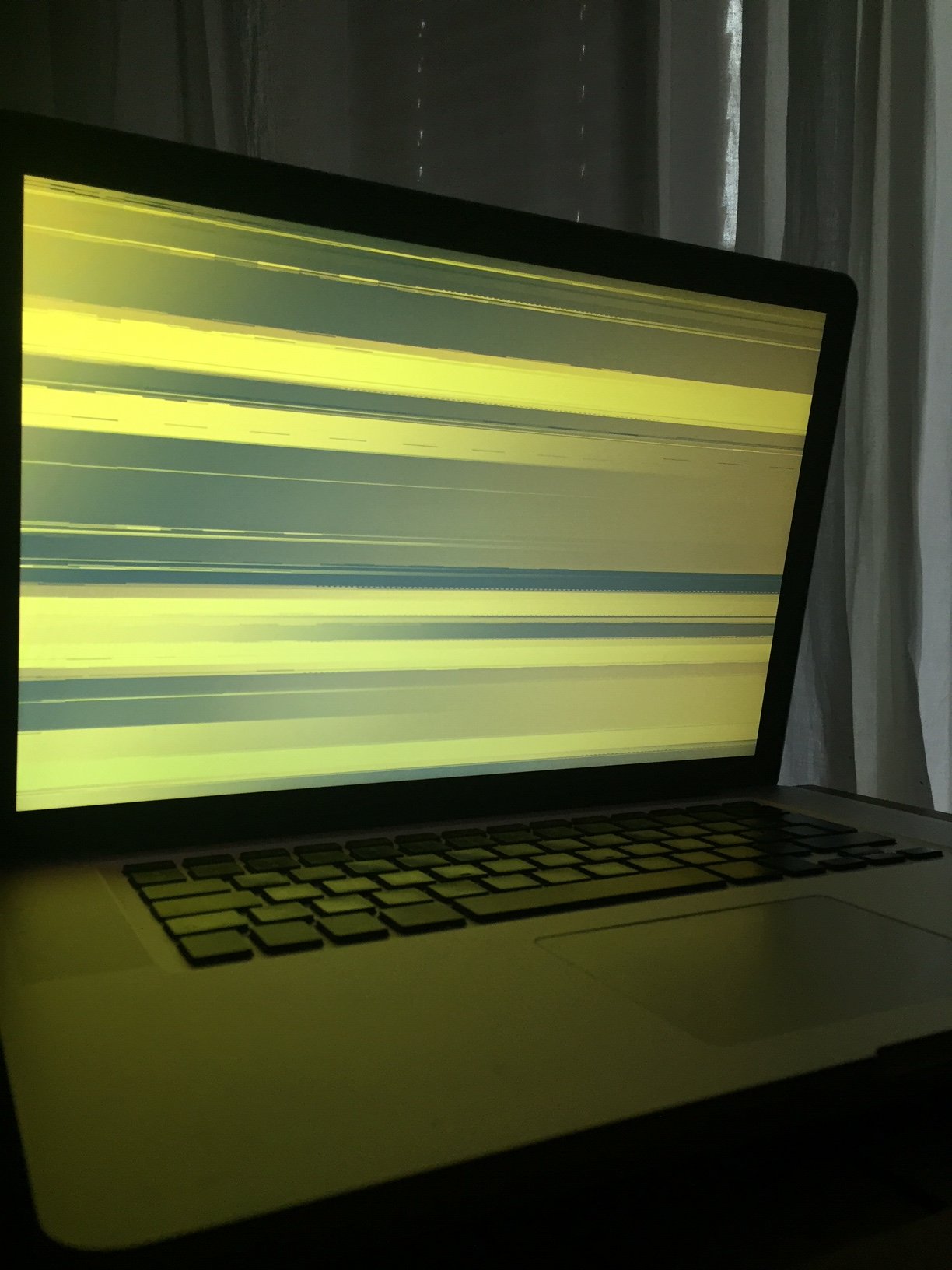

Did you fix it ?
[automerge]1586141944[/automerge]
I used the MikeyN solution and my laptop worked well, only a few black screens at startup (intermittently), but now my mbpro doesn't start anymore, I reset the SMC, PRAM, I disconnected and reconnected the battery, removed and replaced the RAM, the screen shows artifacts, colors, vertical bands etc, I keep the CMD+R+S keys at startup but the single user mode remains inaccessible. I really don't know what to do anymore.
View attachment 798213 View attachment 798214 View attachment 798215 View attachment 798216 View attachment 798217 View attachment 798218 View attachment 798219 View attachment 798220 View attachment 798221 View attachment 798222
Did you fix it ?
My MPB 15" Early-2011 GPU died last Fall, and using info from this thread I got it running again. But I had only just written a shell script to set the nvram parameters to turn off the GPU. That worked initially very well. But I could only have one account logged in at any one time else the machine died, or sometimes it would just die after going into sleep mode. But usually I could keep the machine alive for days at a time with no issues.
Recently however it started to die very often, multiple times per day, and it took a lot of restarts (into single-user mode to apply nvram patch) to finally get it to reboot successfully.
So today I finally tried to do the gitHub hack but I couldn't get into Recovery mode. I finally managed that doing the method here on StackExchange (I'm running 10.13.6) and was able to complete the gitHub hack.
Now it works great! Can shutdown and it will boot right up. Can switch between user accounts and no issue. Sleep works. Brightness works. Happy camper here :)

This time it booted properly, I was able to login and I'm using it right now. Of course the graphics rendering is very slow (animations are slow to render with flickering) but everything else (audio, network) looks fine. I was able to do a Time Machine backup and restarted twice.
Checking the System Report shows that it is still using the AMD Radeon HD 6970M GPU
I thought this should have been disabled by the "nvram fa4ce28d-b62f-4c99-9cc3-6815686e30f9:gpu-power-prefs=%01%00%00%00" command?
Does this mean that the AMD GPU is working? But i moved I already moved all the AMD* kext
Does this iMac also has a integrated gpu like the macbooks discussed in this thread? I can't see it in the system report.
Hope somebody can provide some clarification. Thanks.
