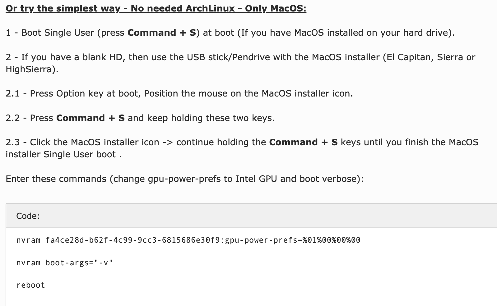

follow this guide: https://apple.stackexchange.com/questions/267581/gpu-problem-boot-hangs-on-grey-screen/295805#295805

I have disabled my gpu mistakenly by entering this
nvram fa4ce28d-b62f-4c99-9cc3-6815686e30f9:gpu-power-prefs=%01%00%00%00
how can i enable back?

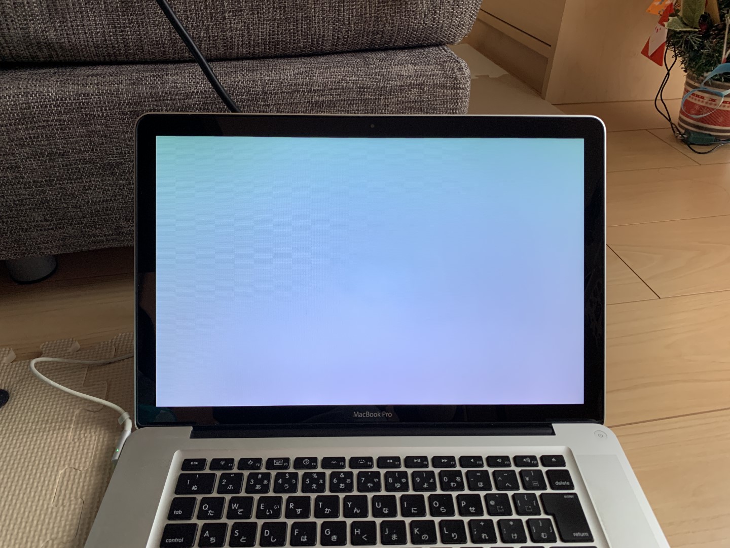

I can't get passed this white screen, have tried SMC and PRAM. Can't boot into single user mode or anything.

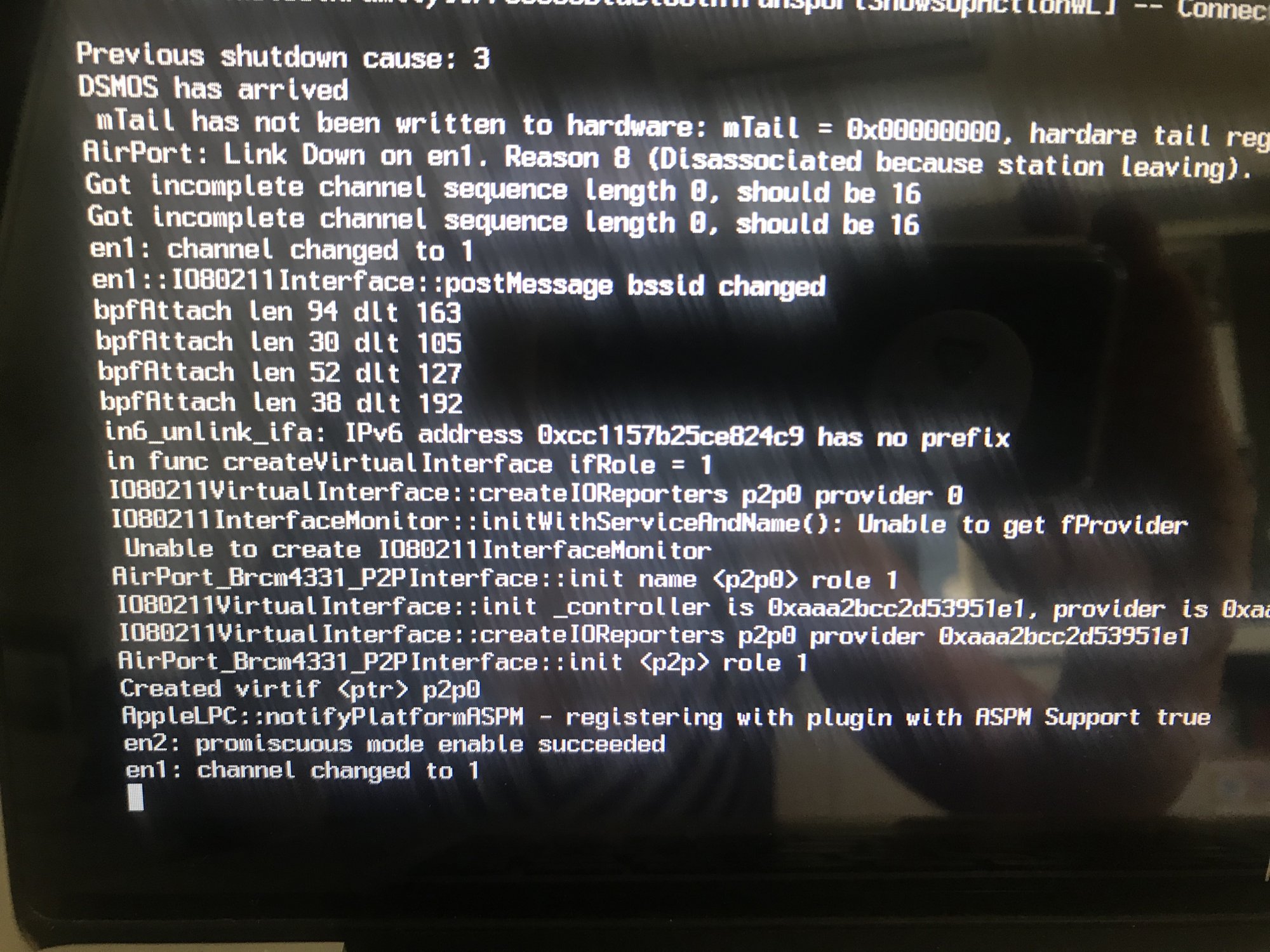

Hi! I have mb 15" 2011, I did this
then re boot, but the MB showme this
what can I do?
Sorry for my english, my language is spanish
Thank you in advance
