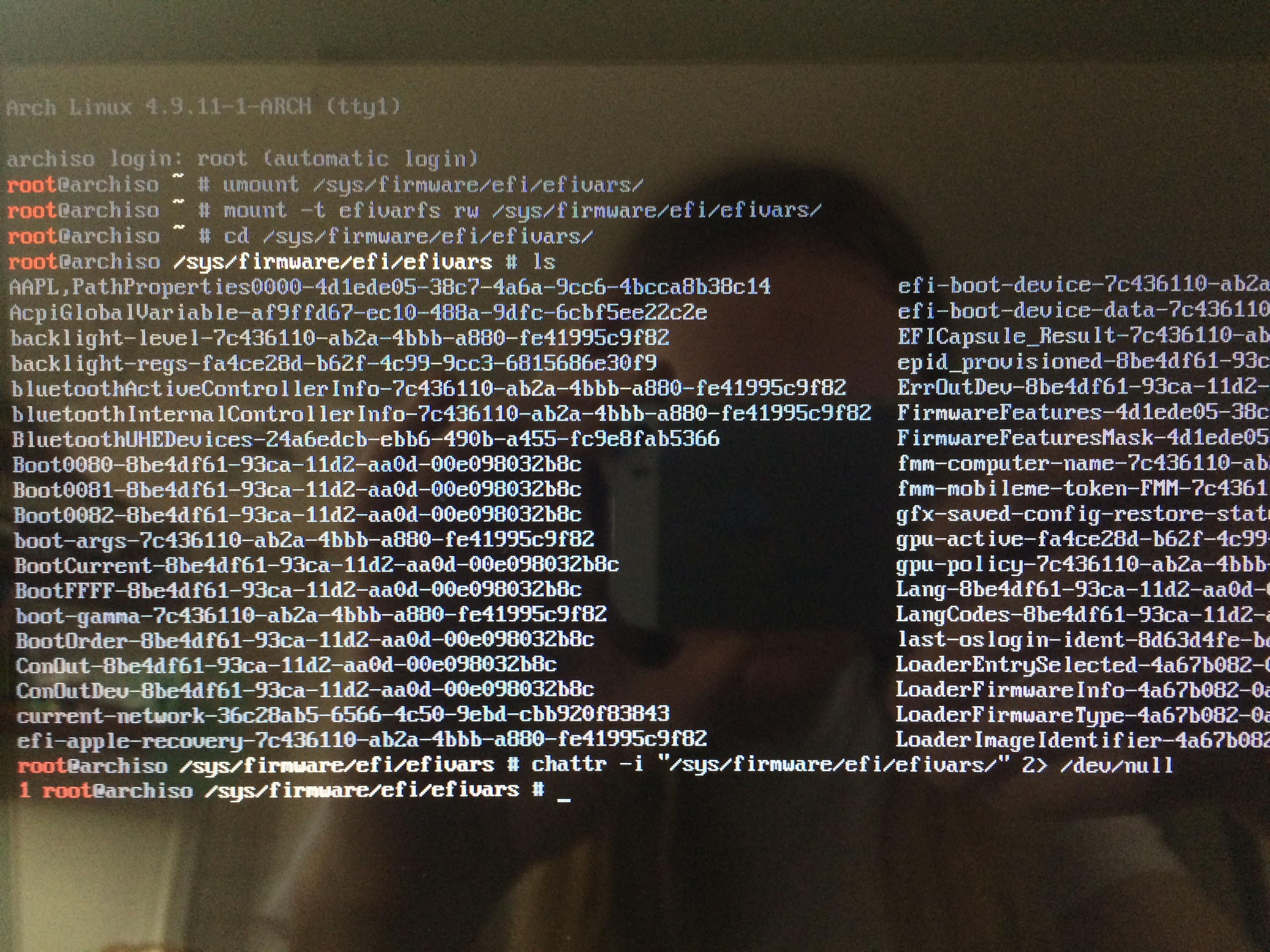

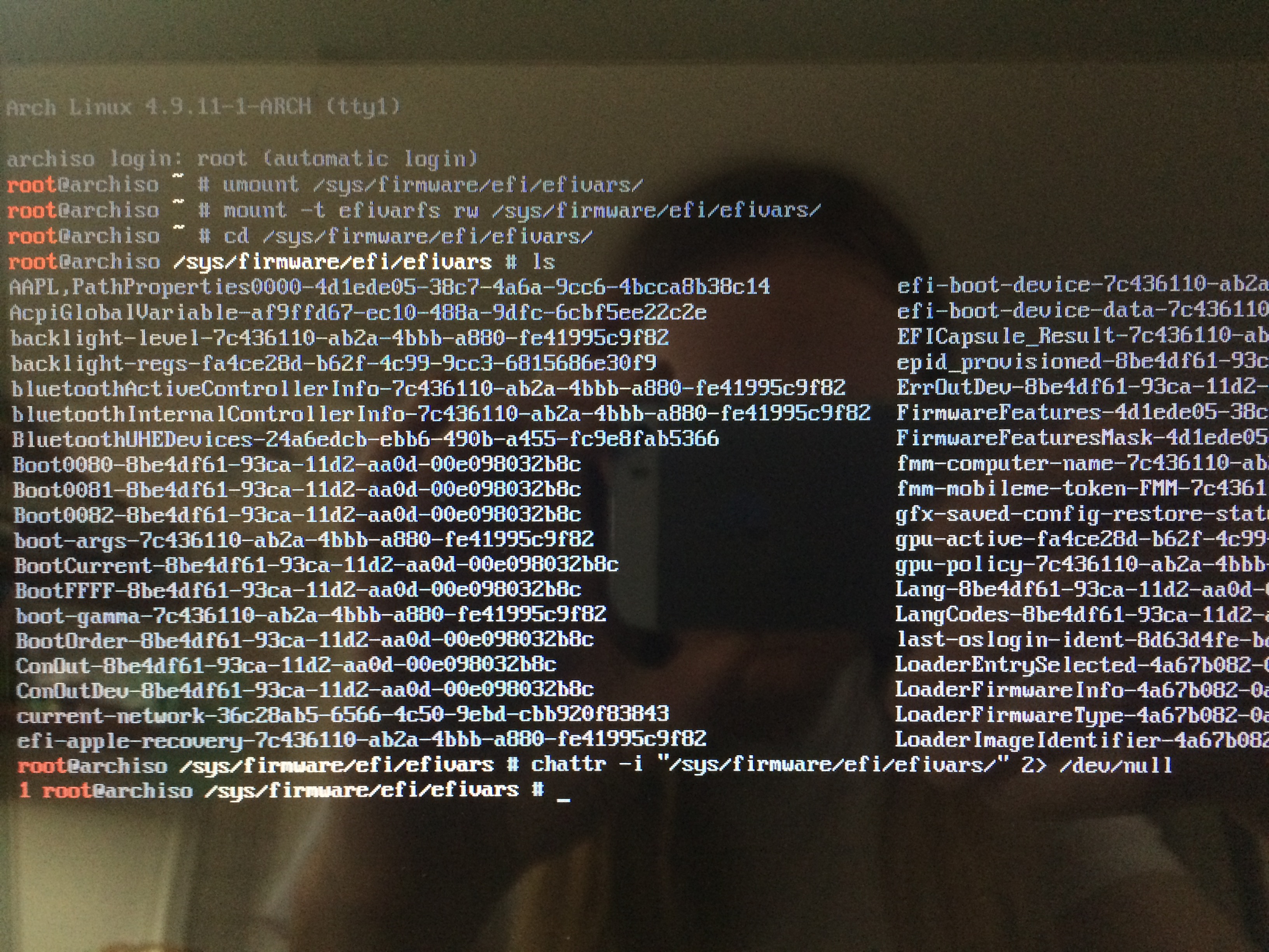

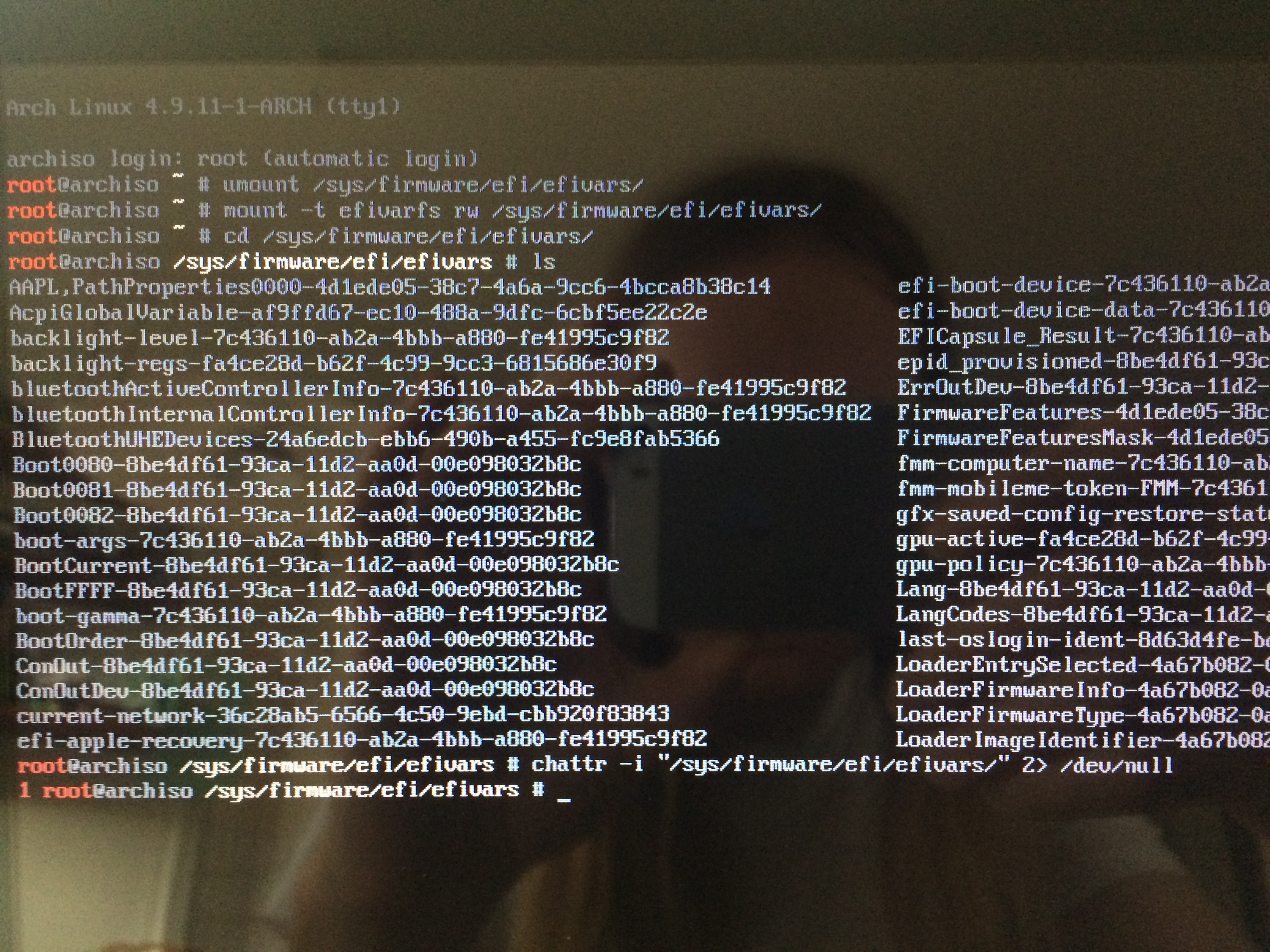

Thank you very much for responding. I've tried this now, but it still gives me the same result = sad smiley just sitting there looking sad.
One thing that crossed my mind is that my quotation marks looks more like the symbol for inch than quotes. I'm using a Swedish keyboard and I had to press nearly every button until I found it, it was located on one of the letters that are unique to the Swedish language while pressing the shift key.
I'm including a picture of it looks. Theres nothing on the right side except for the smiley.
I'm very grateful for your help, I've been looking for exactly this fix since my dGPU failed around two months ago.
Hmmmm.... What will happen if you ignore that sad smiley and try following the next instructions after this command? Maybe I had this sad smiley too but it wasn't visible to me because of a very distorted screen. Please could you try the next steps like everything is OK ?
Make sure that you are using the correct quotes, if you can't obtain them by your mac's internal keyboard, connect the external USB keyboard to input this character. You need a standard ASCII symbol for the quotes, which could be found at US keyboard

Hi AppleMacFinder,
Thanks for your prompt reply. If I leave out the >2 /dev/null I indeed get an error:
chattr: Inappropriate ioctl for device while reading flags on /sys/firmware/efi/efivars
I don't know what this means, but perhaps this is the beast we are looking for ;-)

*) chattr -i “/sys/firmware/efi/efivars/gpu-power-prefs-fa4ce28d-b62f-4c99-9cc3-6815686e30f9"
(or +i to see whether this makes a difference)
*) cd /
*) umount /sys/firmware/efi/efivars/
*) reboot
But no luck :-(

Unfortunately, +i and -i both do not work. Both stuck at the Apple logo...
How this screen with Apple logo looks like - normal gray screen, or a heavily distorted screen that is ruined by a failing discrete GPU ?

No succes. Tried everything, but still a frozen MBP. By the way: I cannot make a hex dump of the file, it gives me "Invalid argument" all the time. On my other Mac this just works, just like xxd or od.
hexdump gpu-power-prefs-....
xxd gpu-power-prefs....
During startup of Linux I get two times the error message : **ERROR* no UMS support in radeon module. But I guess this is due to the fact that you change the gpu-power variable.
The size of the gpu-power-prefs file is "4" (I can see this by doing ls -la)
Another finding: if I do chattr -i (and not +i) and reboot the system the progress bar under the Apple logo moves to about 55%. After 30 seconds, the MBP shuts down by itself. If I do chattr +i, however, the progress bar under the Apple logo goes until say 40%. I am not sure whether this is important, but you never know
Reactions: AppleMacFinder

No success. Tried everything, but still a frozen MBP. By the way: I cannot make a hex dump of the file, it gives me "Invalid argument" all the time. On my other Mac this just works, just like xxd or od.
Maybe you are doing something wrong, because Mac and Linux command lines are different... But here is easy workaround for you:
1) prepare a second USB drive, format it to FAT32 and plug it to your MBP together with a first USB drive (which contains Arch Linux)
2) after booting to Arch Linux, mount this second USB drive to some mount point, for example:
mount -t msdos /dev/sdXN /mnt/
where X is a drive letter, N is a partition number. If have some problems, search in the Internet for tutorials
3) copy gpu-power-prefs-... file to this second USB drive, unmount it, plug it to another PC and view the contents of file with a hexdump
This is a normal message, I have been getting it even on the "not-yet-changed" Mac...
So this error does not indicate that your MBP feels this variable change. There should be some visible changes, like MBP's screen becoming normal again while booting! If there are no visible changes after changing the EFI variable, it means that somehow the EFI variable has not been loaded and we accidentally did something wrong...
By the way you could try completely removing the AMD drivers from your MBP - this is described at my first message. Of course that will not fix a display of your Mac, but at least it will boot every time. And (although unlikely) this may somehow impact your success with EFI variable
