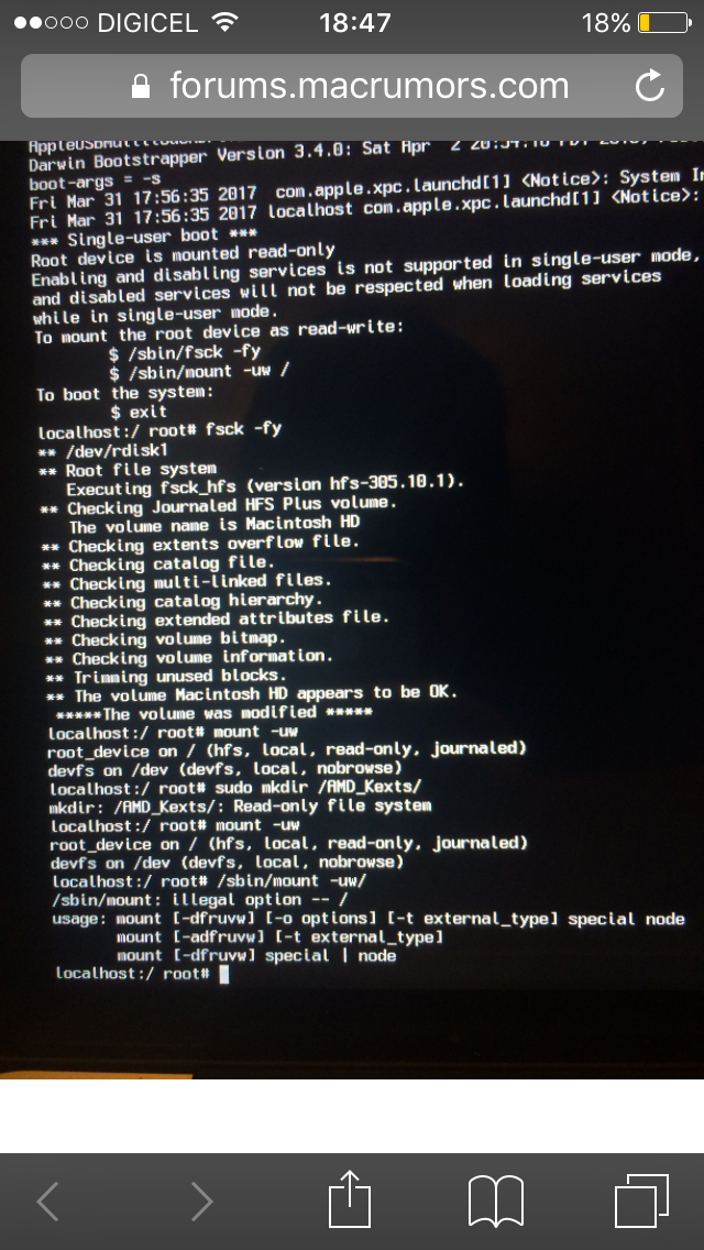

The machine no longer goes to the apple folder on normal restart, it now goes to a folder and "?"
In case the HFS+ filesystem of your MBP got corrupted, you could still try booting in a single user mode and repairing the filesystem; if it does not help, it is possible to repair it under Linux (like I have described at the 1st message) - a bit difficult, but definitely doable
After you'll have more questions, feel free to ask them
You need to follow the instructions at exactly the same order as they are described in my first message of this thread
I tried again, I was just not sure of the linux feedback I was getting I think. It worked this time, the screen is normal!
I cannot boot to single user mode, I get the same grey screen with a "?" on a folder blinking. I am replacing the hard drive in this machine. I assume that's not going to help as this is now a firmware problem. Could you please help me identify which part of the first message contains the next steps I will need to repair this under Linux? I would give it a go on my own, but after reading the first post again 2 times just now, I am not confident I can pick out the proper section to follow.

Maybe you are doing something wrong, because Mac and Linux command lines are different... But here is easy workaround for you:
1) prepare a second USB drive, format it to FAT32 and plug it to your MBP together with a first USB drive (which contains Arch Linux)
2) after booting to Arch Linux, mount this second USB drive to some mount point, for example:
mount -t msdos /dev/sdXN /mnt/
where X is a drive letter, N is a partition number. If have some problems, search in the Internet for tutorials
3) copy gpu-power-prefs-... file to this second USB drive, unmount it, plug it to another PC and view the contents of file with a hexdump
This is a normal message, I have been getting it even on the "not-yet-changed" Mac...
So this error does not indicate that your MBP feels this variable change. There should be some visible changes, like MBP's screen becoming normal again while booting! If there are no visible changes after changing the EFI variable, it means that somehow the EFI variable has not been loaded and we accidentally did something wrong...
By the way you could try completely removing the AMD drivers from your MBP - this is described at my first message. Of course that will not fix a display of your Mac, but at least it will boot every time. And (although unlikely) this may somehow impact your success with EFI variable
[doublepost=1490299287][/doublepost] If you have the problems with terminal, you could just find a PC with windows and use Rufus utility to create Arch Linux bootable USB - https://rufus.akeo.ie/ , https://wiki.archlinux.org/index.php/USB_flash_installation_media#Using_Rufus . It is really straightforward

I cannot boot to single user mode, I get the same grey screen with a "?" on a folder blinking. I am replacing the hard drive in this machine.. Could you please help me identify which part of the first message contains the next steps I will need to repair this under Linux?
You have two options now:
1) If your screen is normal now, that means you can boot to OS X Installation DVD/USB now - and it has Disk Utility, using which it could be possible to repair your filesystem
2) Or, alternatively, you could do these steps:
Remove a hard drive from MacBook Pro and (using a USB to SATA 2.5" adapter) attach it to a computer with Linux, then follow these instructions:
https://superuser.com/questions/961401/mounting-hfs-partition-on-arch-linux (1st answer) - carefully execute a number of commands, calculate a sizelimit for your parition layout, and finally run sudo mount -t hfsplus -o force,rw,sizelimit=YOURNUMBER /dev/sdb2 /mnt to mount this HFS+ partition to /mnt directory in read-write mode. Then you repair a filesystem by running sudo fsck.hfsplus -f /dev/sdb2 before unmounting a partition with sudo umount /mnt and putting a hard drive back to MBP...
But for that you need a spare computer with Linux installed or Linux LiveCD launched (preferably Ubuntu LiveCD, for beginners in the Linux world...) , and as you can see its a bit lengthy process, so hopefully you could avoid it with "1)"

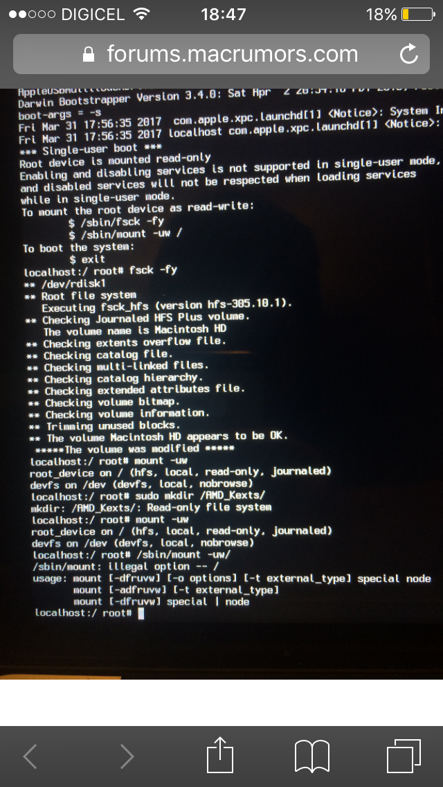

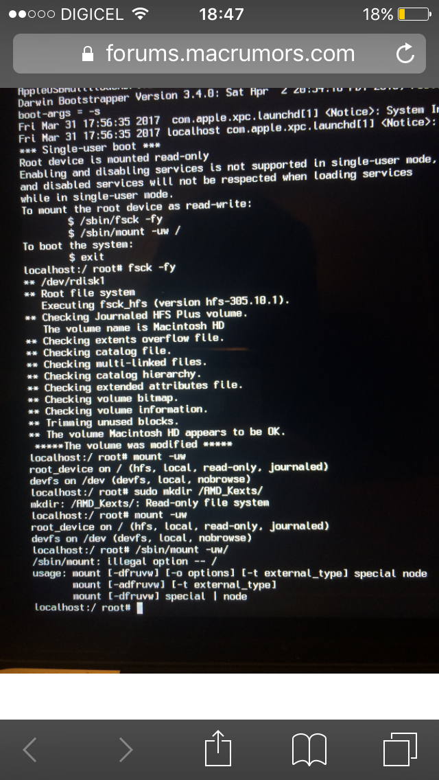

I should note that I don't get any garbled screen or text, but it hangs or turns grey.
What I'm trying to do to get the Mac to bypass the GPU and only use integrated, right?
I tethered booted to another machine and used a program gfx-something to only use the integers GPU but I suspected that wouldn't work.
I found your thread and it seems really useful but in single user mode it won't grant me write privileges, any ideas?
Im not very good at this type of type, and unix is something i know nothing about.

It seems my Mac is fairly bricked, GPU failure on a late Mac 2011.
Apple offered to extend the repair program but once it got to the raptor shop they decided they couldn't help.
I've read that the GPU can be replaced, but the people I've called locally don't seem to think this will fix the problem.

It was good you posted the pic. There is one space missing in the mount command (after uw):
/sbin/mount uw/
Should be:
/sbin/mount uw /
With that you should have read/write privileges, and from there move the kexts etc.
I also see that fsck has modified the volume. It's a good idea to run fsck again until it doesn't give you "the volume was modified" message. It doesn't always pick up every problem the first time it runs.
Most likely that means your HFS+ filesystem is slightly corrupted and that is why no write permissions. Looks like you have to repair your HFS+ filesystem before going forward.
Use fsck -fy command to repair your filesystem, and at your command from screenshot - mount -uw / - you forgot to write a SPACE character before / (you wrote mount -uw/ , should write mount -uw / )
