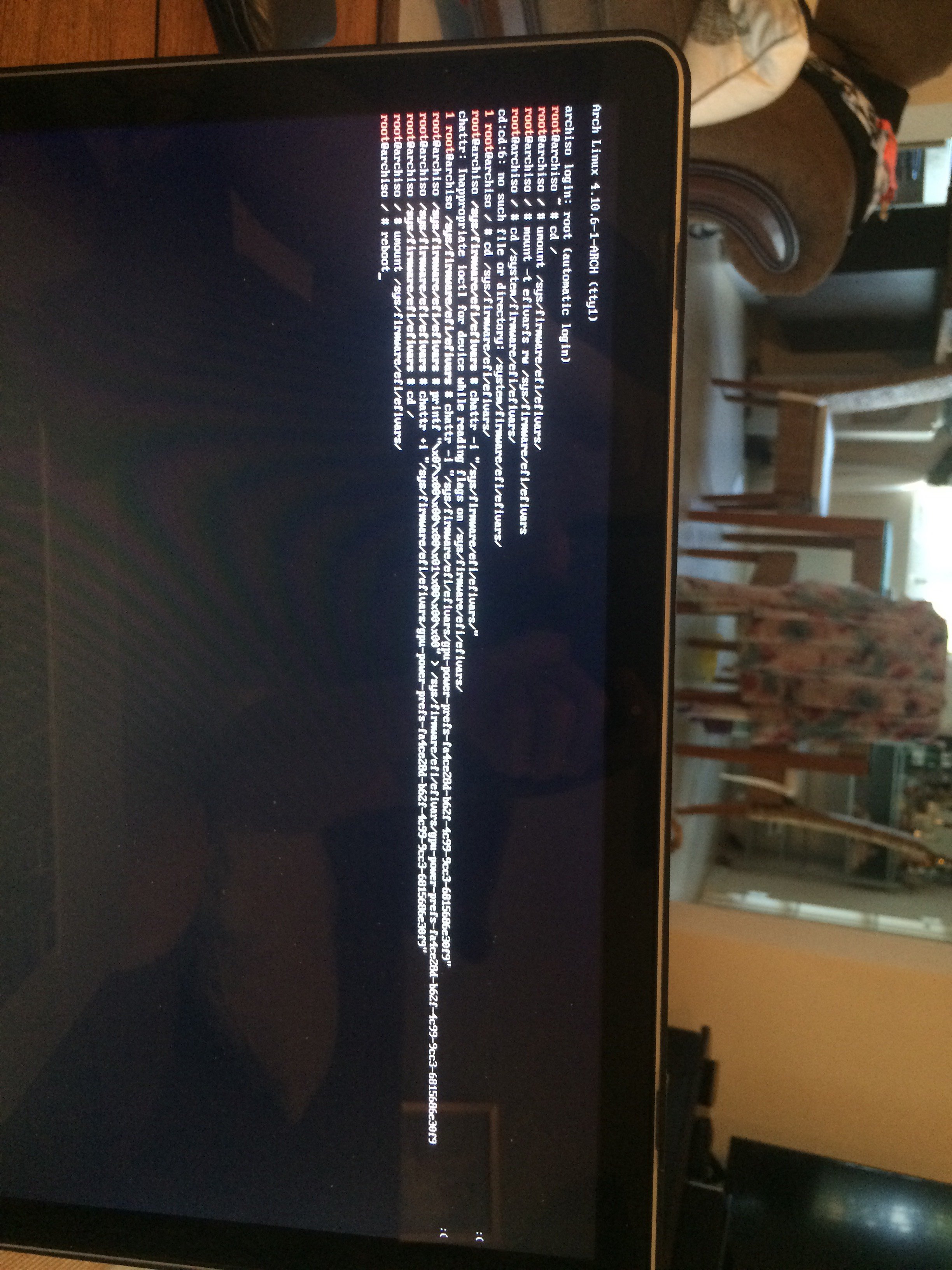

1) Create the Arch Linux LiveCD/LiveUSB :
You need a working computer for that and a spare CD/DVD/USB drive. Download the latest Arch Linux ISO image from this page - https://www.archlinux.org/download/ , at the time of writing it is archlinux-2017.03.01-dual.iso . Then you could either simply burn this ISO to CD/DVD (which later could be either inserted to MBP's SuperDrive or External DVD Drive connected to MBP by two USB cables) or create a bootable USB: use the great detailed instructions from this page, https://wiki.archlinux.org/index.php/USB_flash_installation_media
2) Boot to it: insert this CD/DVD/USB to Macbook Pro, hold Option key while booting, choose "EFI boot" (that is your bootable installation media), press "e" key to edit the GRUB options of the Arch Linux archiso x86_64 UEFI CD menu entry while it is selected at the main screen, add nomodeset to the end of this line and press Enter. If everything is done correctly, you will find yourself at the Linux console!

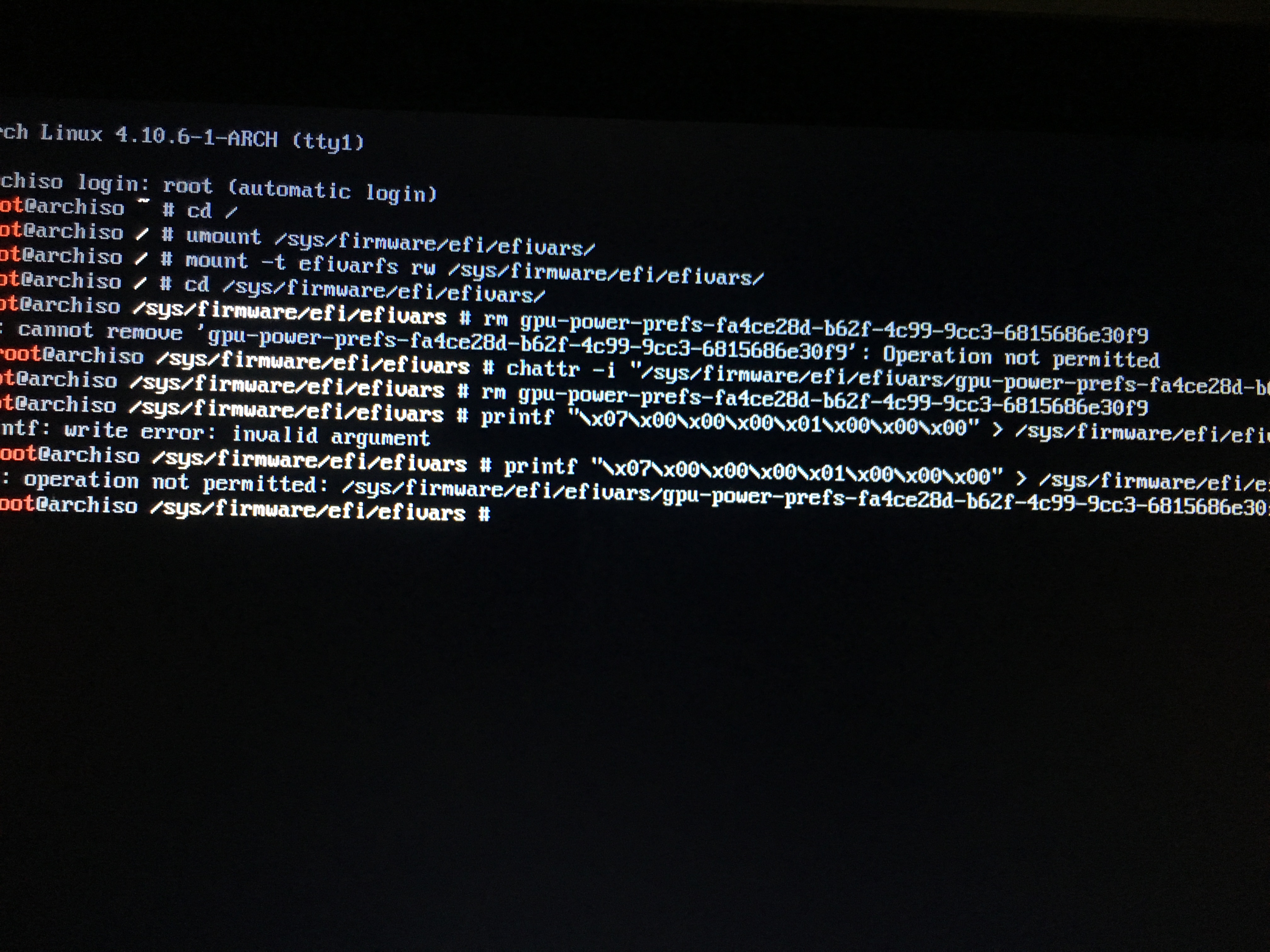

3) Edit EFI vars: looks like efivarfs filesystem is mounted by default! So you can already cd /sys/firmware/efi/efivars and ls to explore this directory and see if there is a "gpu-power-prefs-..." variable (where ... is UUID of this variable). If there is such a variable, its better to remove it with rm. In my case the efivarfs has been mounted by default with read/write permissions, but if you are getting the "operation not permitted" message while attempting to rm, it means that in your case efivarfs has been mounted as read-only and you need to remount it with read-write permissions and try again (credits to totoe_84 for this valuable addition) :
*) cd /
*) umount /sys/firmware/efi/efivars/
*) mount -t efivarfs rw /sys/firmware/efi/efivars/
*) cd /sys/firmware/efi/efivars/
If your screen is so distorted that it is difficult to see the letters, just start typing the rm gpu-power-pre and then press TAB key for autocompletion. In my case there were not such a EFI variable, only "gpu-active-..." and maybe somehow related "gfx-saved-config-restore-status-..." . Then I looked again at that gpu-switch text file (mentioned above, https://github.com/0xbb/gpu-switch/blob/master/gpu-switch),
and entered THESE COMMANDS:
*) chattr -i "/sys/firmware/efi/efivars/" <----- skip this command
Actually a gpu-switch script had "${sysfs_efi_vars}/${efi_gpu}" but I didnt have a "gpu-power-prefs-..." variable - so, partially by mistake, I didn't add that efi_gpu suffix and entered this incomplete path accidentally
printf "\x07\x00\x00\x00\x01\x00\x00\x00" > /sys/firmware/efi/efivars/gpu-power-prefs-fa4ce28d-b62f-4c99-9cc3-6815686e30f9
Did not have a EFI "gpu-power-prefs-" variable so I thought that it will be OK to create a new one with a random UUID - in this case, taken directly from a gpu-switch script
*) chattr +i "/sys/firmware/efi/efivars/gpu-power-prefs-fa4ce28d-b62f-4c99-9cc3-6815686e30f9"
http://www.tecmint.com/chattr-command-examples/ - chattr (Change Attribute) is a command line Linux utility that is used to set/unset certain attributes to a file in Linux system to secure accidental deletion or modification of important files and folders, even though you are logged in as a root user.
Syntax of chattr ---> chattr [operator] [flags] [filename]
A file is set with ‘i‘ attribute (+i as you see in this command) ---> cannot be modified (immutable). Means no renaming, no symbolic link creation, no execution, no writable, only superuser can unset the attribute.
Operator
  1. + : Adds the attribute to the existing attribute of the files.
  2. : Removes the attribute to the existing attribute of the files.
  3. = : Keep the existing attributes that the files have.
This chattr command is supposed to lock a file to make it accessible only by "superuser" - and so that, while booting, your EFI will have no chance to screw up your gpu-power-prefs-... variable under any circumstances
*) cd /
Could not unmount efivars if you are inside this directory, so change to the root directory
Guarantees that your EFI variables are flushed to efivarfs filesystem, please unmount it safely before rebooting)
*) reboot
===> IF YOU DID EVERYTHING CORRECTLY, MOST LIKELY THAT YOUR MACBOOK PRO IS NOW USING INTEGRATED GRAPHICS WHILE BOOTING, AFTER BOOTING, AND IS WORKING GREAT AGAIN ! 😉
In the future maybe you could need to re-apply this solution if you would have to reset your PRAM / NVRAM / SMC because of some other problems, so remember this solution somewhere... Funny thing: now you can't switch to Discrete GPU even using gfxCardStatus, it is forever stuck at Integrated
I spent two working days to discover this solution, and really hope that it will work flawlessly for every MBP owner with a broken discrete GPU. Good luck!

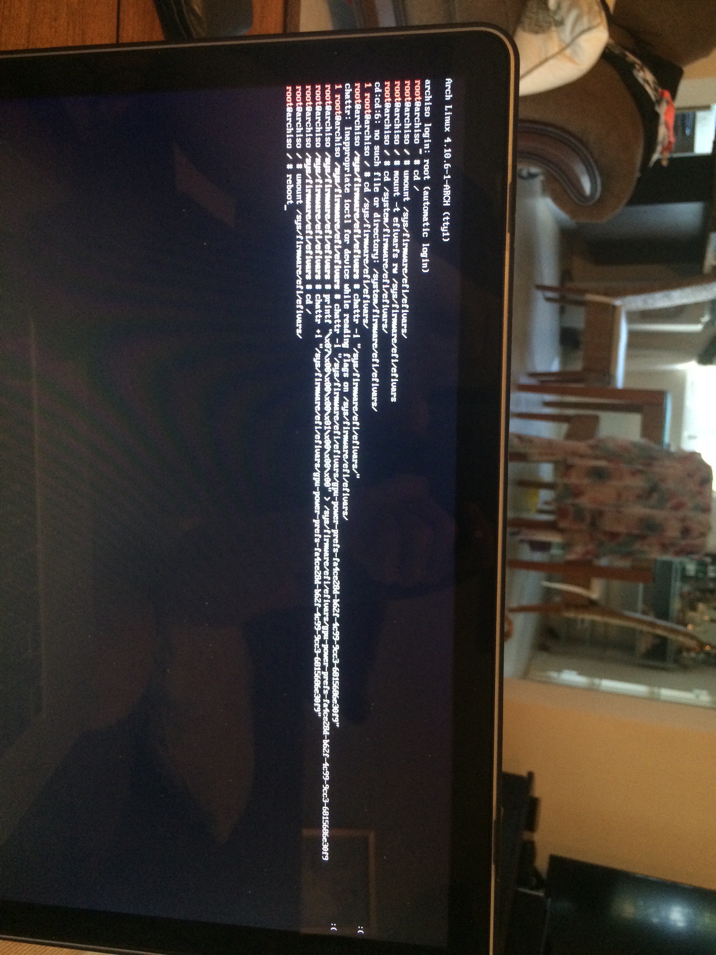

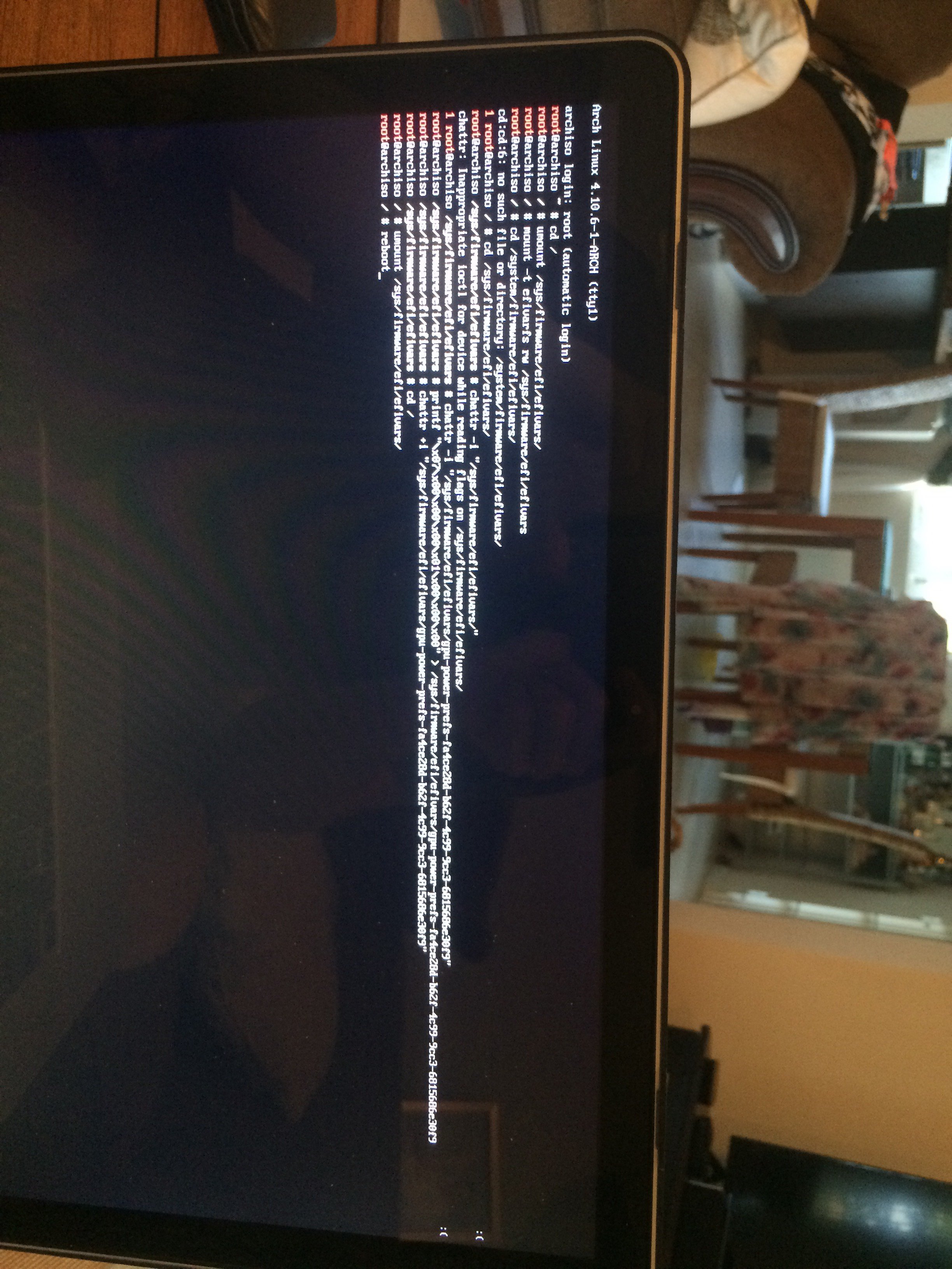

This worked for me! Now I have my Mac back again!
When I started having this problem it was right after I had updated to the latest MacOS beta(10.12.5 I believe). Is it just chance that my GPU failed right after that update or was there a firmware updated that bricked the GPU? I'm having trouble finding what exactly the 10.12.5 update installed. If that's what happened, is there a way to revert to the previous GPU and/or EFI "firmware"? Does that make sense?
This is a little over my head so I may not be using the correct terms.
Reactions: AppleMacFinder
It worked like magic, even in the boot screen, amazing. Thanks AppleMacFinder. Somebody can confirm, that if I remove the created power-pref file and I will do a hardware repair, the dGPU will work again?
I'm running Early 2011 17 inch, MacOS 10.12.4

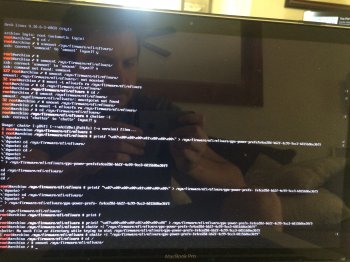

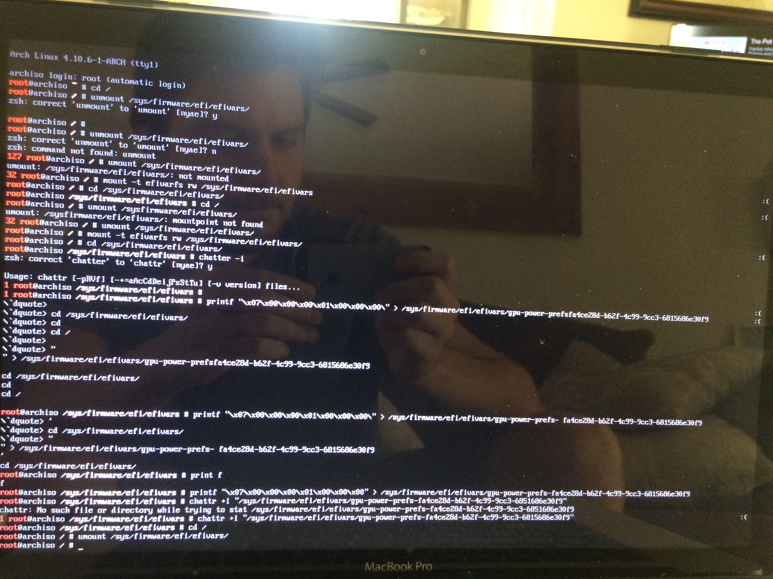

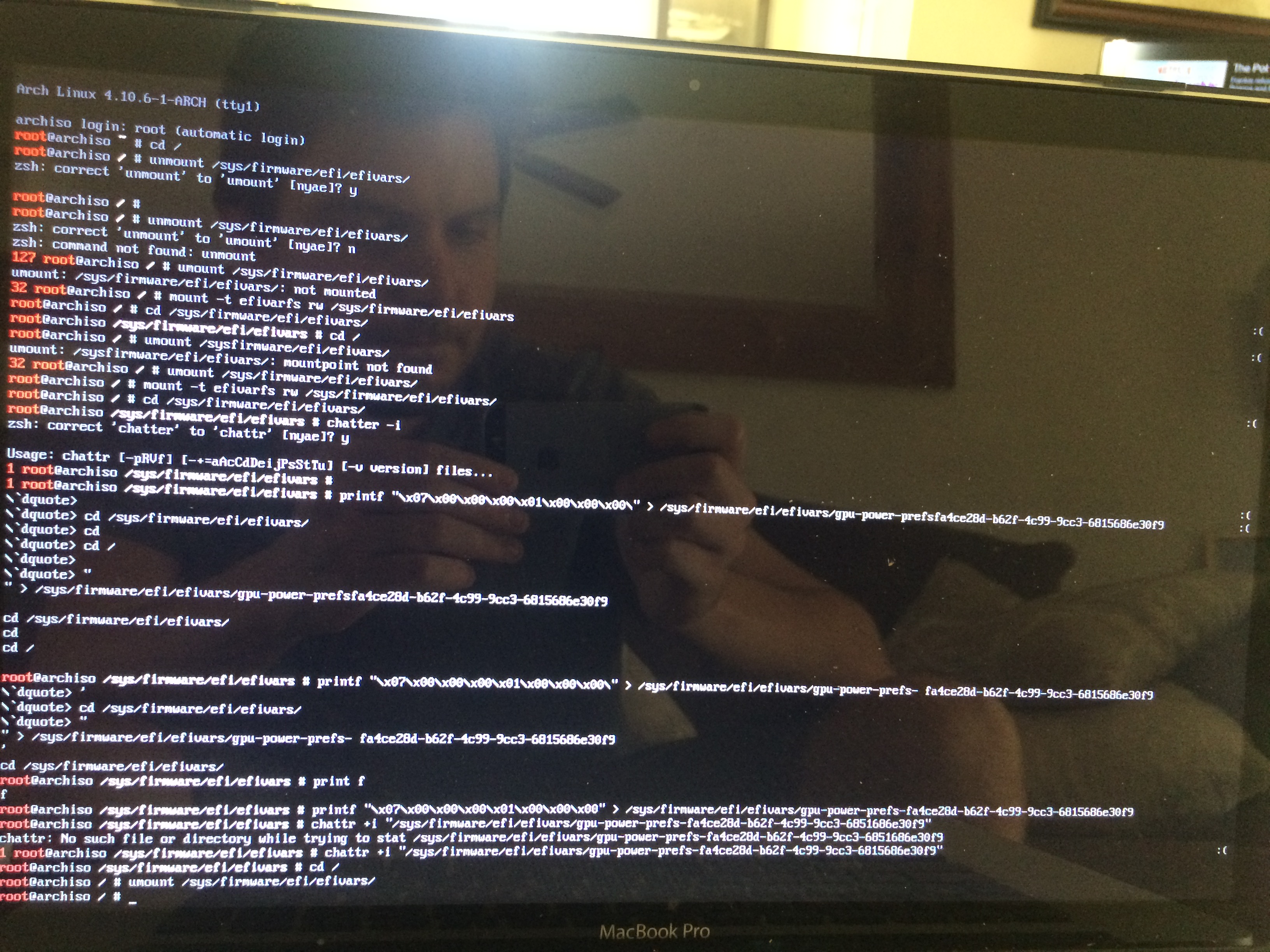

Eventually I succeeded too!!!
I recommend removing the .kext files.
I applied the procedure advised by @AppleMacFinder without removing .kext files but when viewing for example a video the system freezed again (trying to switch to dGPU).
Also on reboot the system freezed again on the gray screen.
When I rebooted to ArchLinux I noticed that the file gnu-power-prefs-..... wasn't anymore there, so some process erased it.
After moving the .kext files, resetting Nvram and SMC and applying the procedure by @AppleMacFinder everything worked perfectly.

Are you doing it from Arch Linux LiveCD ? If you are trying it from OS X or OS X recovery, SIP protection wouldn't let you to allow that. Try with Arch Linux LiveCD and it should work for you
Hi AppleMacFinder
I'm having exactly the same problem. I'm booted from the archlinux live usb as root. I successfully unmount efivarfs and then remounted it - this about the 6th time of trying. But when I try to write the file and what I get id zsh: invalid argument: /sys/firmware/efi/efivars/gpu-power-prefs-fa4ce28d-b62f-4c99-9cc3-6815686e30fg
And I seem to be stuck at this point. I've reset the SMC and zapped the pram but still no luck.
Luckily my screen MBP 8,2 isn't distorted: it's just got the external monitor problem and won't go to sleep. Machine runs a little bit hot. I was hoping that this would enable me to use integrated graphics which would be better than what I have. But it looks like that's not to be.
By the way, last night I had a same file in efivarfs as you last night but after resetting the SMC and zapping thr pram that appeared to have vanished today when I boot into archlinux,

Hi Having posted that I was having problems on Friday - I managed to use the above fix perfectly when I realised the last character in the printf file name was a 9 not a g.
It worked and I'm working on integrated graphics and not really noticing any performance deficit compared with the AMD Radion graphics. Both Photoshop and graphics intensive games work perfectly without problems.
Kudos AppleMacFinder. I thought there must away to enforce this I didn't realize it would be so far down at the machine level. Thank you very much

Hi Team,
Hopefully someone can give me a couple of pointers.
I made the boot USB from windows using TransMac or MacTrans, it was an .iso image.
Booted to Linux successfully.
Think I followed the codes correct (made a couple of mistakes along the way)
Reboot brings me Recovery mode, which I take as a great sign as my machine wasn't previously able to access recovery.
I select boot from HD, restart,
Now it's hanging on Apple logo with half a progress bar.
Whereas before it would wait till I sign in to show the progress bar and hang.
Any ideas are most welcome!
Just did the process again because i saw the 🙁 which operation not permitted.
went through better, there was no confirmation after each line, just skips straight down to the next terminal without confirmation. seemed like it worked though.
I also disabled SIP and moved amd.kexts
For some reason I can access Recovery mode and safe mode now when i couldn't before but its still not loading regularly

I made the boot USB from windows using TransMac or MacTrans, it was an .iso image. Booted to Linux successfully.
Under Windows, the Rufus utility is recommended for making the Linux bootable USBs, but maybe TransMac could be used too...
Problem with this EFI variable fix is that even a small mistake - like, typing g instead of 9 as the last character in the printf command - makes it fail to work
Looks like you somehow booted to Recovery with AMD kexts disabled, but after rebooting they got loaded again...
Seems like you are close to a target, but something is preventing you to achieve a full success. Are you sure that you have properly removed the AMD kexts, and that the kexts cache has been rebuilt as well? Maybe the kext cache still contains the AMD kexts, so you need to force rebuilding this cache to finalize their removal
Please try again this part of my 1st message:
1) fsck -fy (to check a disk)
2) mount -uw / (mount a root filesystem with read/write permissions)
3) sudo mkdir /AMD_Kexts/ (make a directory to store the AMD drivers in case you'll need them in future)
4) sudo mv /System/Library/Extensions/AMD*.* /AMD_Kexts/ (move the AMD drivers)
5) sudo rm -rf /System/Library/Caches/com.apple.kext.caches/ (remove the AMD drivers cache)
6) sudo mkdir /System/Library/Caches/com.apple.kext.caches/ (just in case OS X will be dumb and will not recreate this directory, I am creating it for OS X)
7) sudo touch /System/Library/Extensions/ (to update the timestamps so that new driver caches - without AMD drivers - will be definitely rebuilt)
8) sudo umount / (umount a partition to guarantee that your changes are flushed to it)
9) sudo reboot

I think from memory when applying the EFI fix I wasn't able to remove GPU-power-pref even though I attempted to load rw permissions.
I was also a little confused by the first chattr -I line where is says skip this command.
I attempted it, and also attempted another one someone wrote on the forum where I'd started chattr -i and ended in GPU-power......
Unsure of what went wrong :/

Thanks AppleMacFinder. After a full day of troubleshooting and researching I finally found your post. I'm sure I'm getting close to resolving this.
Just struck one hitch with the process. When I issue the CHATTR command is comes back with NOT FOUND. It's like the command is not available on the Linux Distro, neither does the LSATTR work.
I pushed on with the process but when I tried to reinstall the OSX instead of going to a whitescreen like previously it freezes now with the Apple logo and a frozen spinning wheel.

1.Hello. Pls help me. When i do command printf have issue: write effor : invalid argument
Pls see a attach picture and help me
2. Nomodeset with space before or no?
Thank
