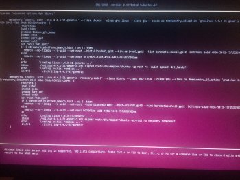

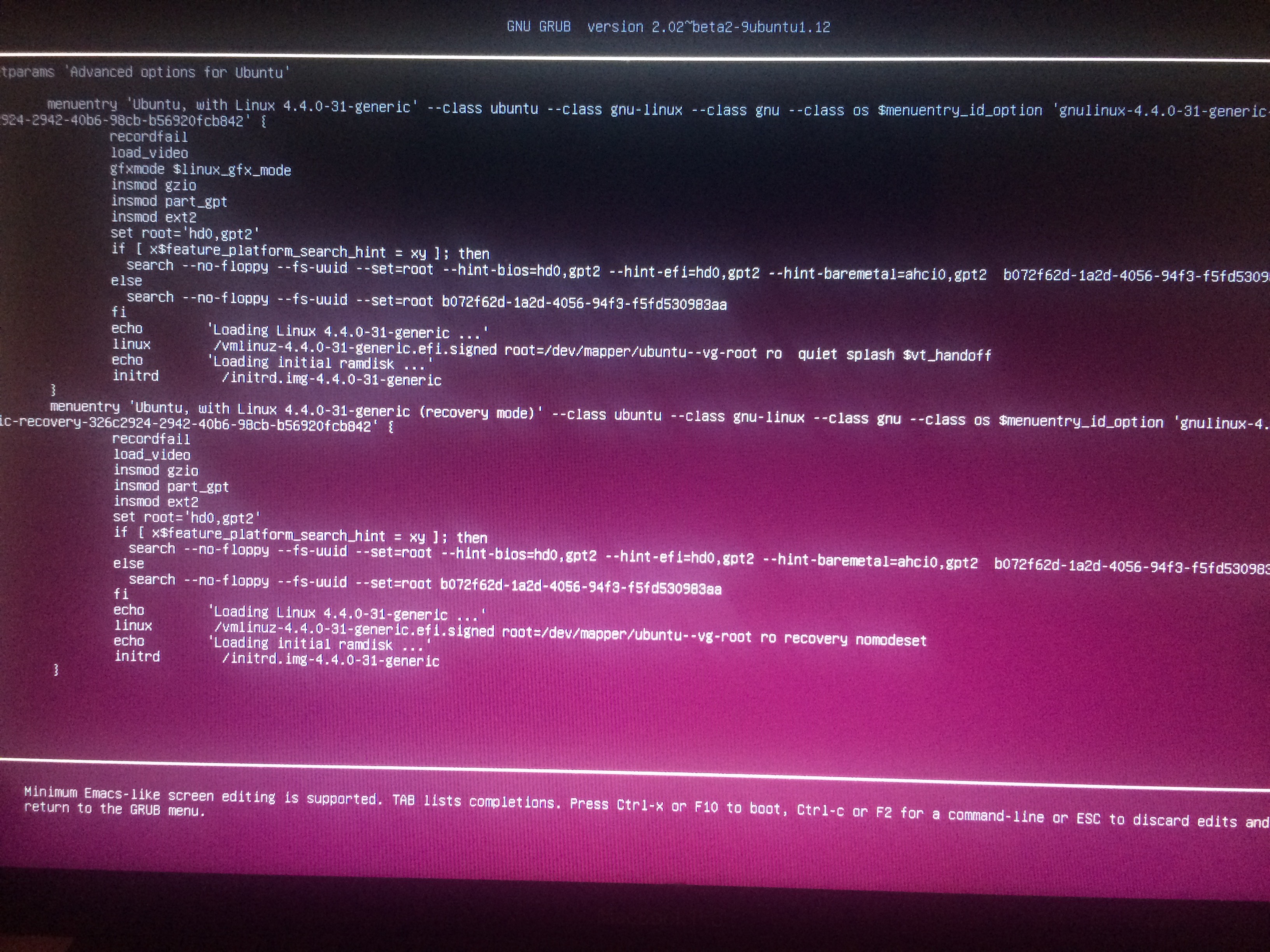

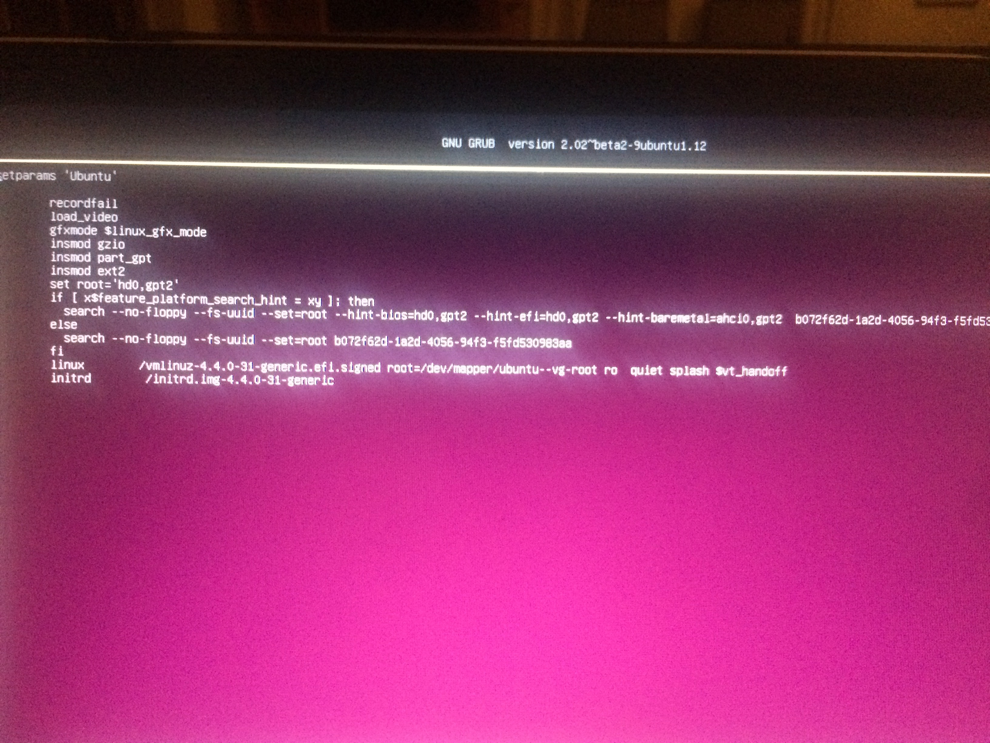

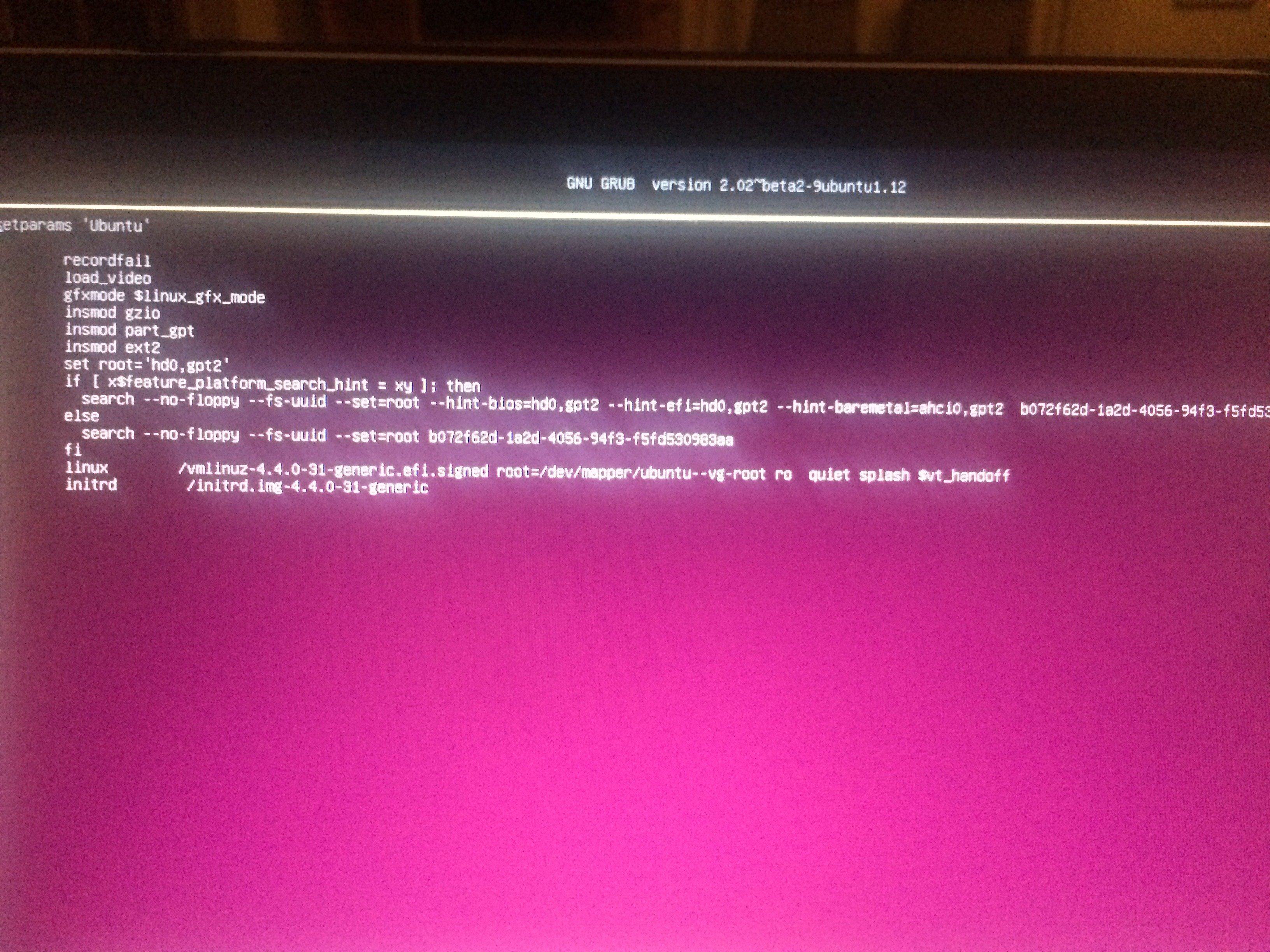

So i fresh installed ubuntu without any bootmanager (im think i did this succesfully before)
Using this forum, this https://ubuntuforums.org/showthread.php?t=2157775
and this https://orville.thebennettproject.com/articles/installing-ubuntu-14-04-lts-on-a-2011-macbook-pro/
I get it installed, im sure the codes "outb" and "i915.lvds" work to disable the gpu on boot however for the fix to work grub needs to load on restart after installation. This is not happening here, it just tries to load ubuntu normally and i think its hanging because of the gpu.

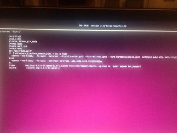

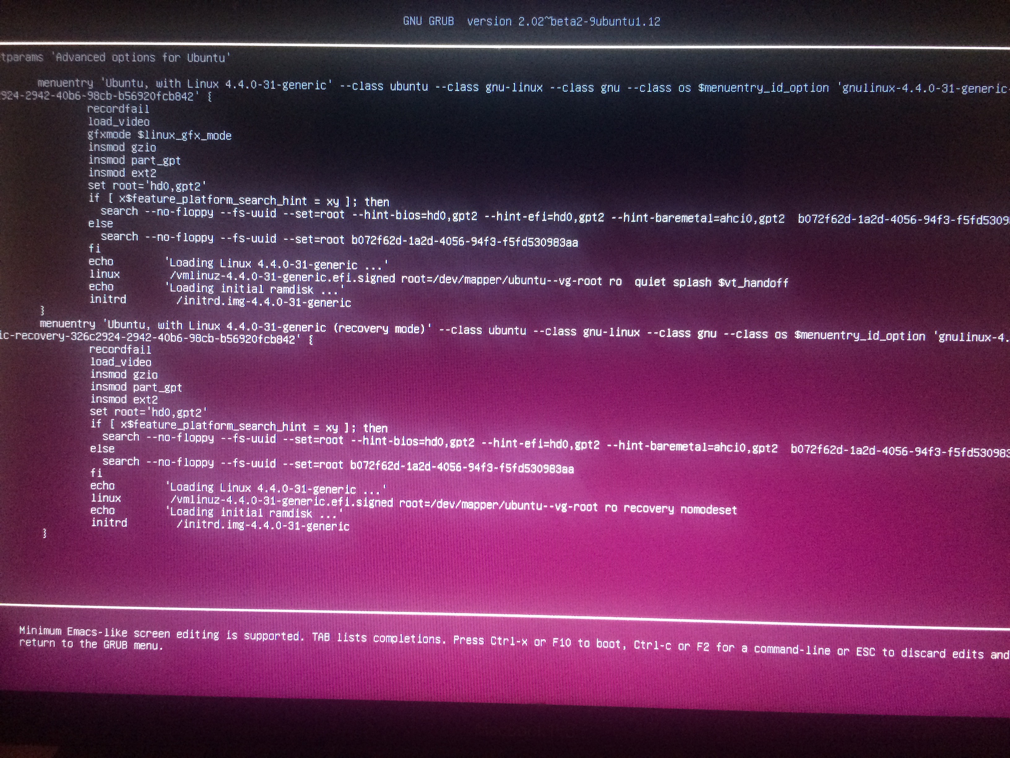

I got grub to load by pressing esc on boot, its brings me to page where im supposed to enter "outb" and "i915" again this will allow me to enter ubunto and disable gpu from there.
The grub page that it brings me to is different though and I dont see setgfxpayload=keep, see pics attached
One possible workaround would be to load the live cd again, enter "i915" ect, from there and with terminal and mounting the install i can manually edit the grub.cfg and the 10_linux files found under /ect/default/ folder. easy. But how the hell do i then update the grub from root? It should be located
I did find recovery mode which gave me the option to update grub bootloader but that didnt work, restart, still hangs on load. I also tried fail safe graphics which just brings me to a black screen.
All and any ideas welcome!

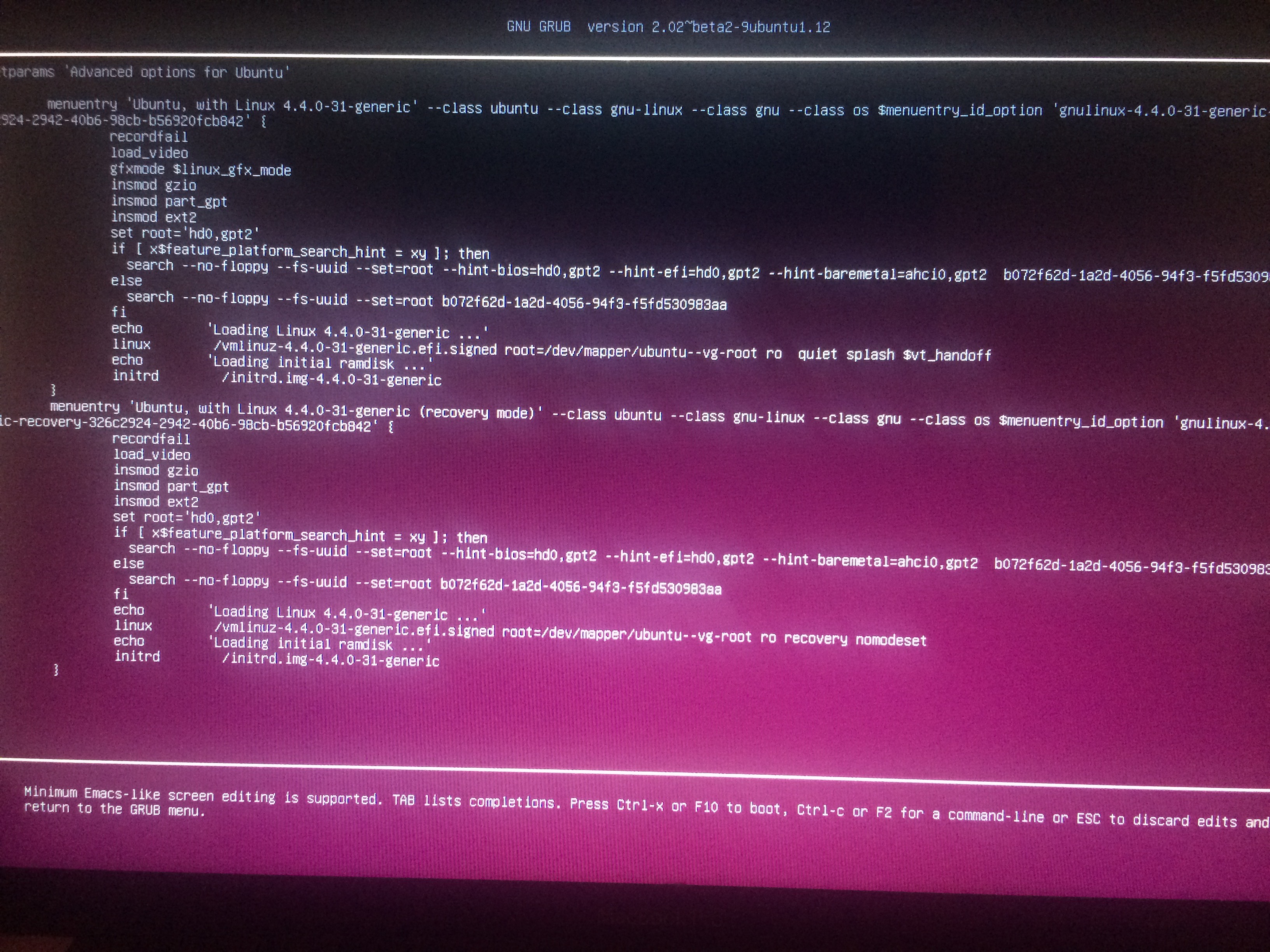

Quick summary of question:
How do i get into the same grub file from livecd on regular boot?
Seeing as failsafe graphics mode didnt work, could there be an issue with the install? I used all express settings.
After editing grub.cfg and 10_linux that were mounted in /ect/ on main partition how to i update main grub file?
I find this a bit strange, when i open the largest partition on the drive i go to the boot folder its empty...
[doublepost=1494388984][/doublepost]Oh snap!
I answered my own question, there was two folders for /ect/!
I just modified the 10-Linux and grub.cfg fro the other folder, went back to recovery mode and updated grub boot loader and viola!

I don't think there should be any significant specifics about Ubuntu. both Arch and Ubuntu are Linux distros, and this EFI fix is universal - means, once you do it successfully, it should be working for any OS
Using a LiveCD you could modify the files at the HD's filesystems, including grub configuration files. Also you could try using some helpful utilities like Boot Repair - https://help.ubuntu.com/community/Boot-Repair (when the manual edits are not needed) and Grub Customizer (perfect for manual edits and changes in boot priorities) - http://ubuntuhandbook.org/index.php/2016/04/install-grub-customizer-ubuntu-16-04-lts/ . These tools will help to simplify the configuration process and make it more user friendly
But how the hell do i then update the grub from root? ... How do i get into the same grub file from livecd on regular boot?
There are some helpful articles about how to update the grub from LiveCD - http://howtoubuntu.org/how-to-repair-restore-reinstall-grub-2-with-a-ubuntu-live-cd <---- you could additionally edit the grub configuration file before running update-grub command, which is supposed to apply the changes you have made

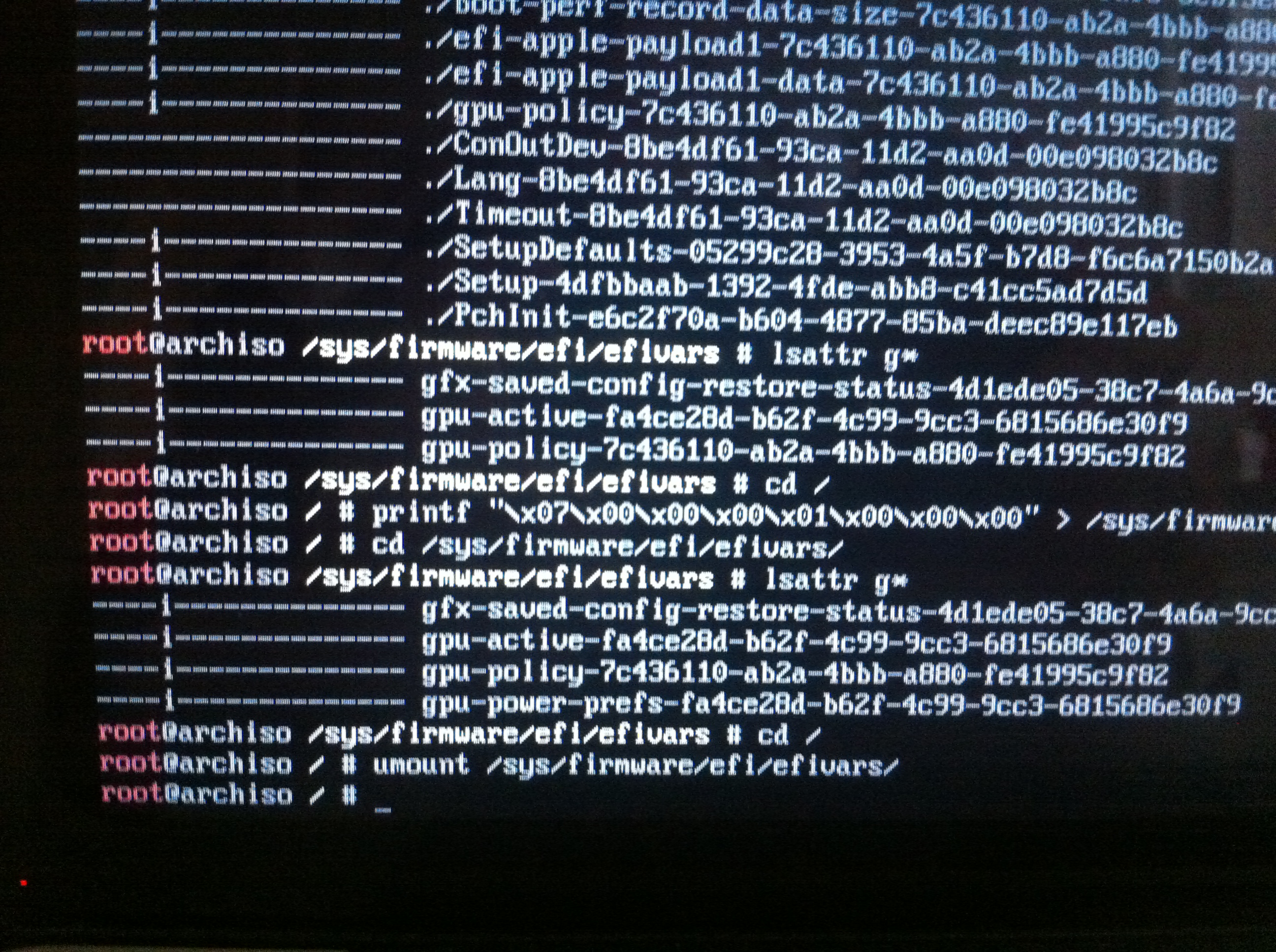

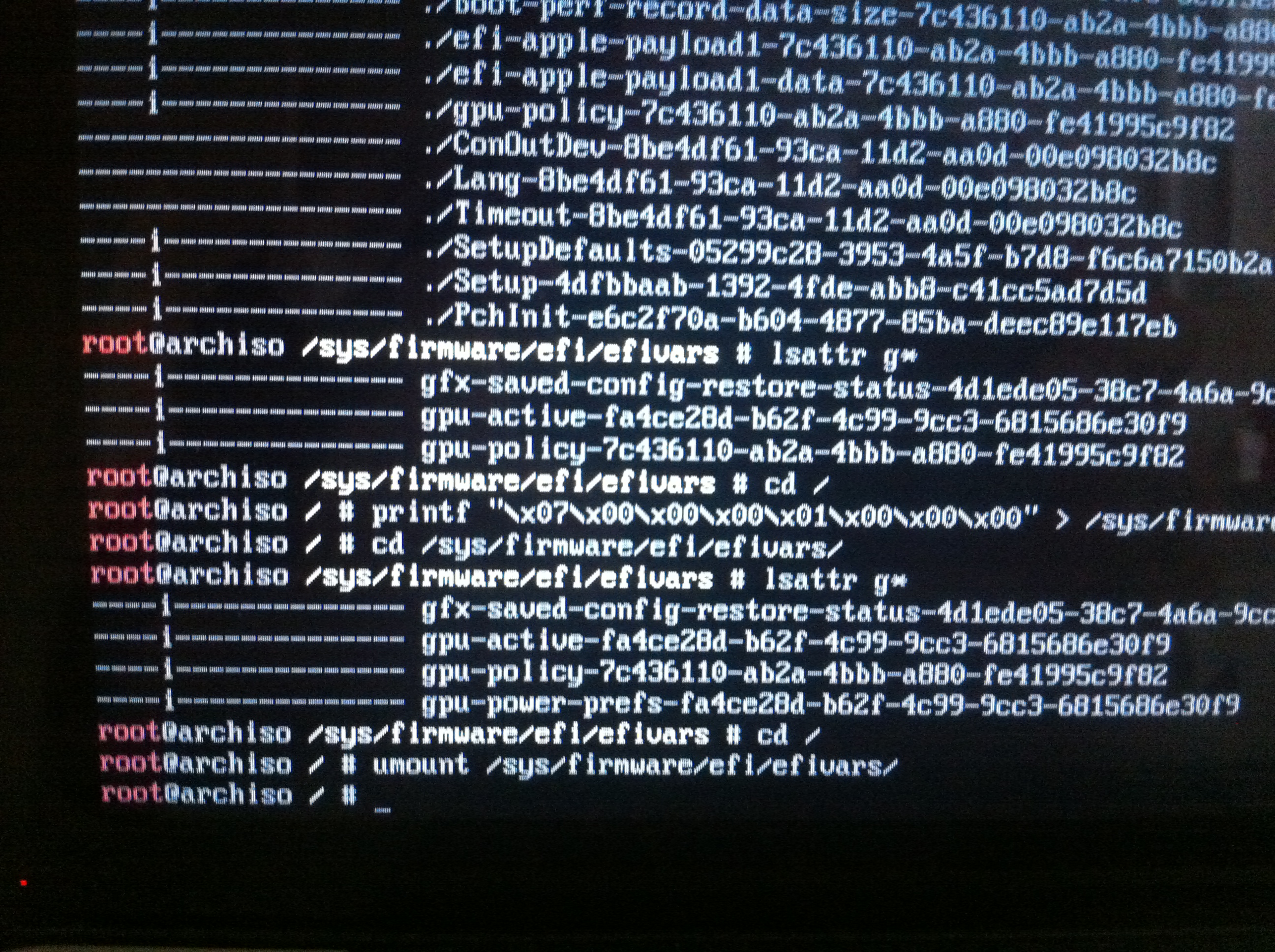

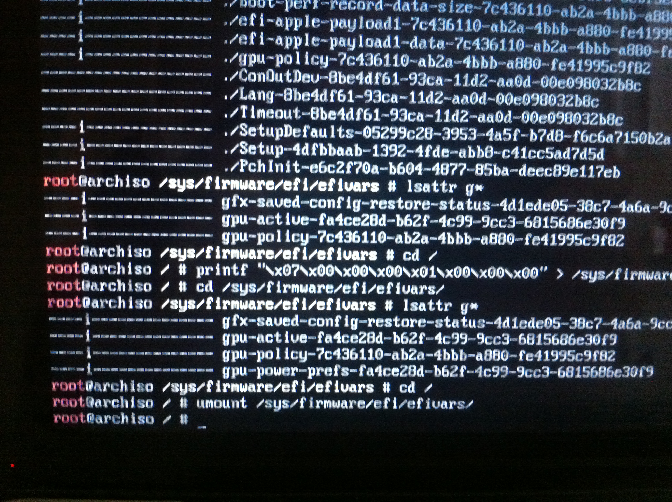

=== 100% WORKING SOLUTION
=== Force your MBP to ALWAYS use Intel integrated GPU (EFI variable fix)
=== to make it great again ! 😉
1) Create the Arch Linux LiveCD/LiveUSB :
You need a working computer for that and a spare CD/DVD/USB drive. Download the latest Arch Linux ISO image from this page - https://www.archlinux.org/download/ , at the time of writing it is archlinux-2017.03.01-dual.iso . Then you could either simply burn this ISO to CD/DVD (which later could be either inserted to MBP's SuperDrive or External DVD Drive connected to MBP by two USB cables) or create a bootable USB: use the great detailed instructions from this page, https://wiki.archlinux.org/index.php/USB_flash_installation_media
2) Boot to it: insert this CD/DVD/USB to Macbook Pro, hold Option key while booting, choose "EFI boot" (that is your bootable installation media), press "e" key to edit the GRUB options of the Arch Linux archiso x86_64 UEFI CD menu entry while it is selected at the main screen, add nomodeset to the end of this line and press Enter. If everything is done correctly, you will find yourself at the Linux console!
3) Edit EFI vars: looks like efivarfs filesystem is mounted by default! So you can already cd /sys/firmware/efi/efivars and ls to explore this directory and see if there is a "gpu-power-prefs-..." variable (where ... is UUID of this variable). If there is such a variable, its better to remove it with rm. In my case the efivarfs has been mounted by default with read/write permissions, but if you are getting the "operation not permitted" message while attempting to rm, it means that in your case efivarfs has been mounted as read-only and you need to remount it with read-write permissions and try again (credits to totoe_84 for this valuable addition) :
*) cd /
*) umount /sys/firmware/efi/efivars/
*) mount -t efivarfs rw /sys/firmware/efi/efivars/
*) cd /sys/firmware/efi/efivars/
If your screen is so distorted that it is difficult to see the letters, just start typing the rm gpu-power-pre and then press TAB key for autocompletion. In my case there were not such a EFI variable, only "gpu-active-..." and maybe somehow related "gfx-saved-config-restore-status-..." . Then I looked again at that gpu-switch text file (mentioned above, https://github.com/0xbb/gpu-switch/blob/master/gpu-switch),
and entered THESE COMMANDS:
*) chattr -i "/sys/firmware/efi/efivars/" <----- skip this command
Actually a gpu-switch script had "${sysfs_efi_vars}/${efi_gpu}" but I didnt have a "gpu-power-prefs-..." variable - so, partially by mistake, I didn't add that efi_gpu suffix and entered this incomplete path accidentally
printf "\x07\x00\x00\x00\x01\x00\x00\x00" > /sys/firmware/efi/efivars/gpu-power-prefs-fa4ce28d-b62f-4c99-9cc3-6815686e30f9
Did not have a EFI "gpu-power-prefs-" variable so I thought that it will be OK to create a new one with a random UUID - in this case, taken directly from a gpu-switch script
*) chattr +i "/sys/firmware/efi/efivars/gpu-power-prefs-fa4ce28d-b62f-4c99-9cc3-6815686e30f9"

  3. = : Keep the existing attributes that the files have.
This chattr command is supposed to lock a file to make it accessible only by "superuser" - and so that, while booting, your EFI will have no chance to screw up your gpu-power-prefs-... variable under any circumstances
*) cd /
Could not unmount efivars if you are inside this directory, so change to the root directory
Guarantees that your EFI variables are flushed to efivarfs filesystem, please unmount it safely before rebooting)
*) reboot
===> IF YOU DID EVERYTHING CORRECTLY, MOST LIKELY THAT YOUR MACBOOK PRO IS NOW USING INTEGRATED GRAPHICS WHILE BOOTING, AFTER BOOTING, AND IS WORKING GREAT AGAIN ! 😉
In the future maybe you could need to re-apply this solution if you would have to reset your PRAM / NVRAM / SMC because of some other problems, so remember this solution somewhere... Funny thing: now you can't switch to Discrete GPU even using gfxCardStatus, it is forever stuck at Integrated
I spent two working days to discover this solution, and really hope that it will work flawlessly for every MBP owner with a broken discrete GPU. Good luck!
Thank you very much!! Really, you saved my macbook pro early 2011! I had bought it, second hand, few weeks ago. The seller didn't told me for the GPU default. I am new to Mac (always got PC and I am moderatly advance on this platform). I had always dream to possessed a mac, but never had enough money to buy one. So, I had this deal on this mac and I had choose this model for is possibility to be easily upgradable in ram and in drive. My dream became a nightmare. But, I done my homework and found your post!! When you read about how useless is to repair the hardware of those machines, you realise there is no good solution. But YOU have the best solution ever!!!! I was on Mac Sierra 10.12.4 but after some search, I realized it was better to downgrade on Yosemite (found on the net) to avoid the SIP easily (I only need to run Ableton on this machine. Yosemit is sufficient). I had to change the date (set 2015) to be able to install it. After that, I followed your step, clearly explained. And you saved my computer!!! Thank you, thank you!!! (After this adventure, I have lost my thrust for this company. Apple with is planned obsolescence)
(sorry if my english is not good, it isn't my first language)
AppleMacFinder said in response to Stuffa...
Yes, of course this model is supported - actually I have exactly the same model ; this fix is working perfectly for me since the first attempt and I never had to reapply this fix yet... - and that is why my experience with this fix is somewhat limited. Probably this fix could work for any MBP with integrated+discrete GPU combination.
After looking at your screen photo I am sure that you did everything correctly, but there is some another problem that is a reason of failure. Maybe this is a fault of some other EFI variables that are GPU related: gpu-active-... and gpu-policy-... , maybe you need to research about them and for example try to remove them if nothing else helps. Then you could repeat the same advice as given to Dimitris R above:
1) Make sure that the AMD kexts are removed
2) Clear PRAM / NVRAM / SMC - to return them to their default state
3) Try repeating the "fix" instruction from the beginning to end

Hi all. I followed the steps listed and it WORKED for me. My late 2011 15 inch MacBook Pro is back in working order, minus the AMD GPU. Now, of course since I fixed on Sunday, a new macOS Sierra update has come out. I assume I know the answer to my question, but I will ask it anyway...
I assume if I install the update, it will revert my now working MacBook Pro back to a non-working state. Wondering if anyone can confirm. Sadly, I think the answer is YES, it will revert my MacBook Pro back into a non-working, red screen machine.
Reactions: AppleMacFinder

I signed up an account just to say THANK YOU! to AppleMacFinder and FGuarini.
  • 15" MacBook Pro 2011
  • replaced the mother board using Apple's repair extension program https://www.apple.com/support/macbookpro-videoissues
  • replaced mother board worked for a year
  • after Sierra update, my graphic card is gone, always stuck at gray screen
  • brought to Apple Authorized Repair center. They rejected me and said no spare parts available.
  • brought to a local repair shop. They charged me $250 to replace the mother board. But it did not work. The shop refunded me $250.
Today I found this forum post and followed the instructions step by step.
Force 2011 MacBook Pro 8,2 with failed AMD GPU to ALWAYS use Intel integrated GPU (EFI variable fix)
My MacBook Pro is working perfectly now.
Successfully able to use
  • reboot with Integrated graphic
  • normal web browsing
  • XCode
  • Smooth desktop switching, etc.
Fail
  • MacBook Pro hangs everytime I tried to open Photos app
But still it is much better than having $2000 piece of brick. 🙂
Thanks so much!
First I want to thank AppleMacFinder and FGuarini (install ArchLinux Pendrive) for this tutorial.
It worked for me.
The Macbook Pro Early 2011 had the red screen and white stripes.
If all goes well, restarting Macbook Pro (reboot in ArchLinux) will return the screen to working correctly (no red background screen and white stripes).
I tested on a :
- Macbook Pro 15 Early 2011 - A1286 - MacBookPro8,2 - 2.2 GHz
- Intel HD Graphics 3000 (512 MB) - AMD Radeon HD 6750M (1024 MB)
In the Macbook Pro Early 2011 that I tested had the same UUID (Before changing the gpu-power-prefs).
What is the probability of having the same UUID (this tutorial)? I suppose it's not a random UUID.
This UUID numbering would not be pre-configured? If you use a different UUID may not work (Macbook Pro Early 2011).
Has anyone tested with a different UUID numbering and worked (Macbook Pro Early 2011)?

Hello there !
I'm trying to revive a mid-2010 15" MacBook Pro (MacBookPro 6,2), that definitely suffers a hardware failure (neither RAM nor HDD related). It can be another motherboard issue, but it's worth trying this fix given the GPU history with Apple laptops...
I carefully followed the procedure using Arch Linux, made sure efivars was rw mounted, removed immutability flag with chattr then successfully deleted gpu-power-prefs-... yet I'm stuck with the printf error some people reported :
printf: write error: invalid argument
It does create a new gpu-power-prefs-... file though, but an empty one (0B).
I rebooted, triple checked efivars was read&write, to no avail.
I tried the printf command, but to write the file in the home directory instead (/root), and it successfully created a non empty file. Yet, trying to move it to /sys/firmware/efi/efivars folder also leads to an error :
mv: error writing ’/sys/firmware/efi/efivars/gpu-power-prefs-fa4ce28d-b62f-4c99-9cc3-6815686e30f9’: invalid argument
That write error along with invalid argument is puzzling... Something seems to prevent properly writing to /sys/firmware/efi/efivars/ but I'm clueless here.
Any idea ?
