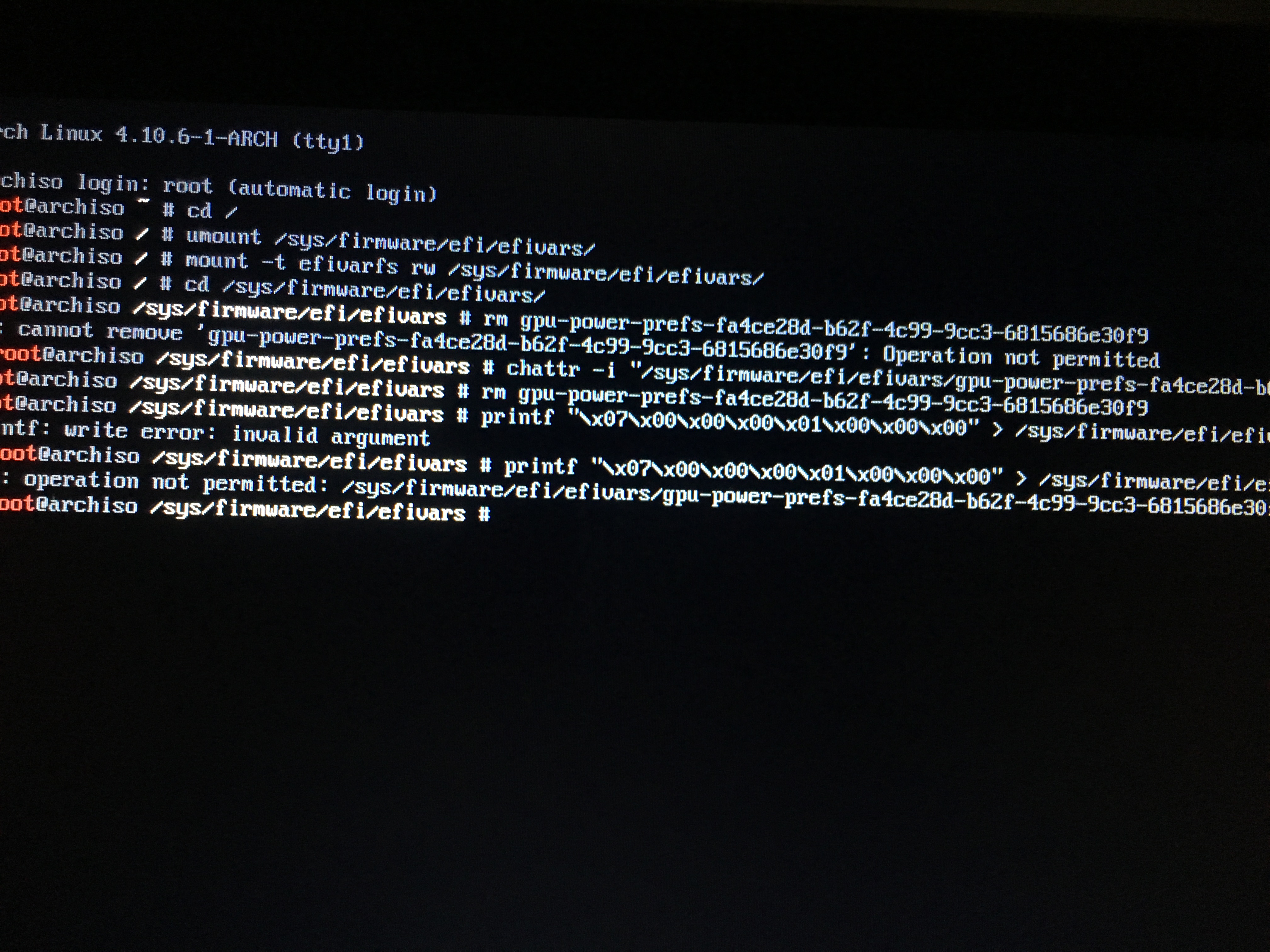

When I issue the CHATTR command is comes back with NOT FOUND. It's like the command is not available on the Linux Distro, neither does the LSATTR work ... Do I need to add those commands to the Arch Linux Boot image?
No, these commands are present at Arch Linux boot image by default. I don't know why it tells you that these commands are "not found", maybe there is a problem with your USB Arch Linux boot media - either on software or hardware level. Verify the checksums of your .iso file before writing it to USB, try another USB drive, etc. chattr executable file is probably located at /bin/chattr or /usr/bin/chattr , you could try running this executable file by writing its' full system path if you are afraid that your PATH variable became corrupted
1.When i do command printf have issue: write effor : invalid argument
2. Nomodeset with space before or no?
Thank
[doublepost=1493793919][/doublepost]View attachment 698307
1. operation not permitted / invalid argument - First of all, please check that you have successfully removed the previous variable with rm command. Write ls command and check if this previous variable has been removed. Then you could try again
Next time, please try to show a full photo of your screen. For example, I cannot see what is happening at the left edge of the screen, e.g. why "root@archiso" shifted 2 characters to the right. It could be that your EFI variables partition became unmounted because of some error, or that it became read-only somehow, and that is why you can't write a correct value to this variable using printf
Please try again from the beginning, hopefully it will work for you at the next time
These instructions already worked for many people - even if not at the first try
2. nomodeset - of course with a space before, and with all the lower case letters: nomodeset - OK , Nomodeset - FAIL
Thanks, you were spot on. I recreated the USB Boot Media and all the commands were there. Unfortunately I'm still getting a freeze up on screen with the Apple Logo and the spinning wheel stops spinning when booting from the OSX DVD Installer. I'm sure it's the GPU because I've installed Mint 17.2 without an issue.

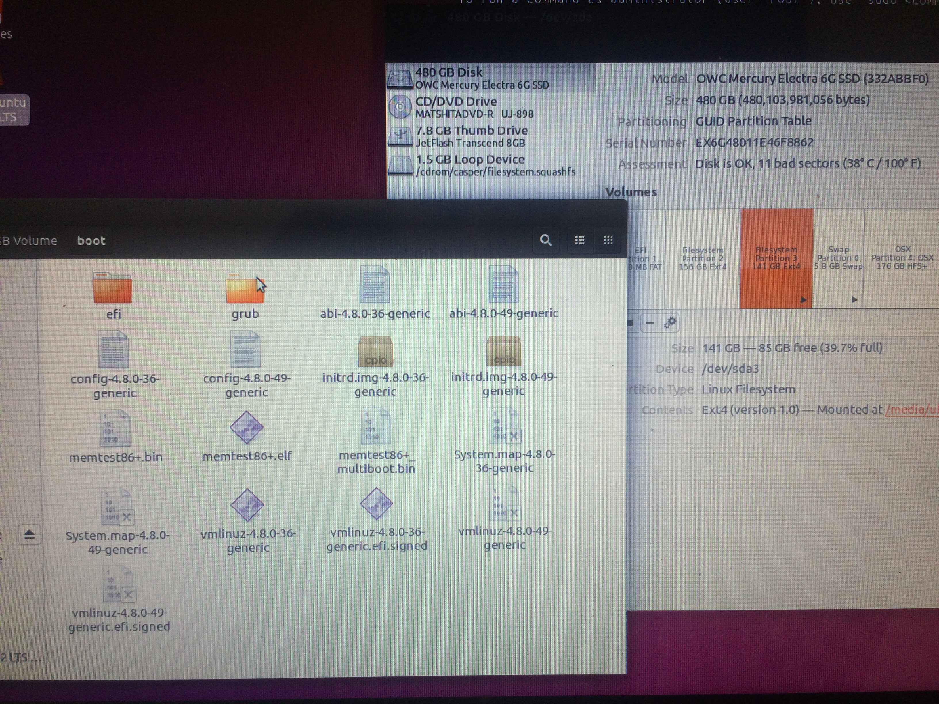

I made two partitions, one for OS X(which will not load at all) and one larger one for ubuntu, from ubuntu I installed VMware windows machine.
Was working fine yesterday, ubunto didn't detect any GPU and VMware gives you option of disabling accelerated graphics.
Not an ideal setup but working!
Issue is I reset my pram yesterday and it tries to natively boot to OS X now, So I put it the ubuntu boot USB.
None of the options will load ubunto unless I edit the startup with "e" and type in code for disabling GPU.
Found here.
https://orville.thebennettproject.com/articles/installing-ubuntu-14-04-lts-on-a-2011-macbook-pro/
So it is booting to ubuntu but the swap partition.
It's the dev/sda3 where everything is installed
Can I use terminal to set boot priority? Internet seems not to be working but I may be able to get that working.
Any help would be amazing, I'm so close!!!!
Edit, I don't have access to grub, I don't think
Edit again, I can virtually mount the partition I'd like to boot normally from disk manager. And it seems to have grub and efi folders if that helps, see pic

I had it working yesterday but I reset my pram so I may need some assistance getting it back up and going again
Very good, you are almost there! Too bad I am not effective at helping, most of my advices are about trying again... 😛
Found here.
Have you tried the instructions for booting Ubuntu from the 1st message of our thread?
If by boot priority you mean choosing which OS loads by default - Ubuntu or OS X - you may try rEFInd
Please clarify what are you trying to achieve by that, I am a bit confused 😕
