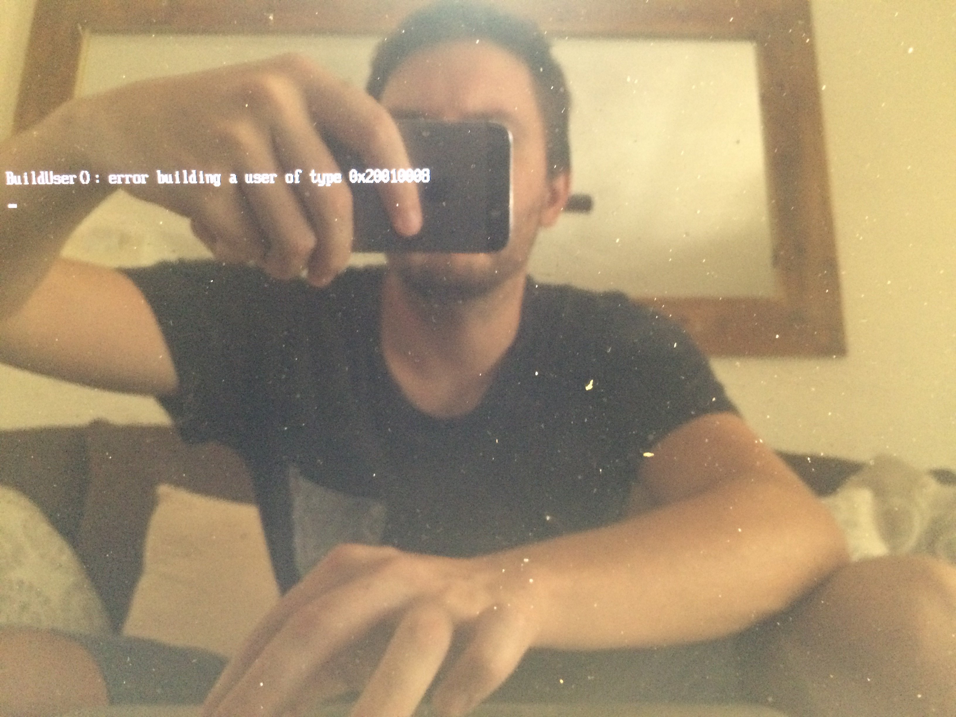

Hi guys, thanks for the updates.
I've attempted the gfxcardstatus 2.0 fix, doesn't seem to work for me.
Right now if I try to log into single user mode I get a line a code it skips past real quick, see attached image.
When I attempt to log into cmd r to disable SIP the Mac hangs.
Question, if I remove my hard drive and put it in an enclosure, then USB boot from another Mac how do I to gain access to single user and repair modes?
Thanks in advance!

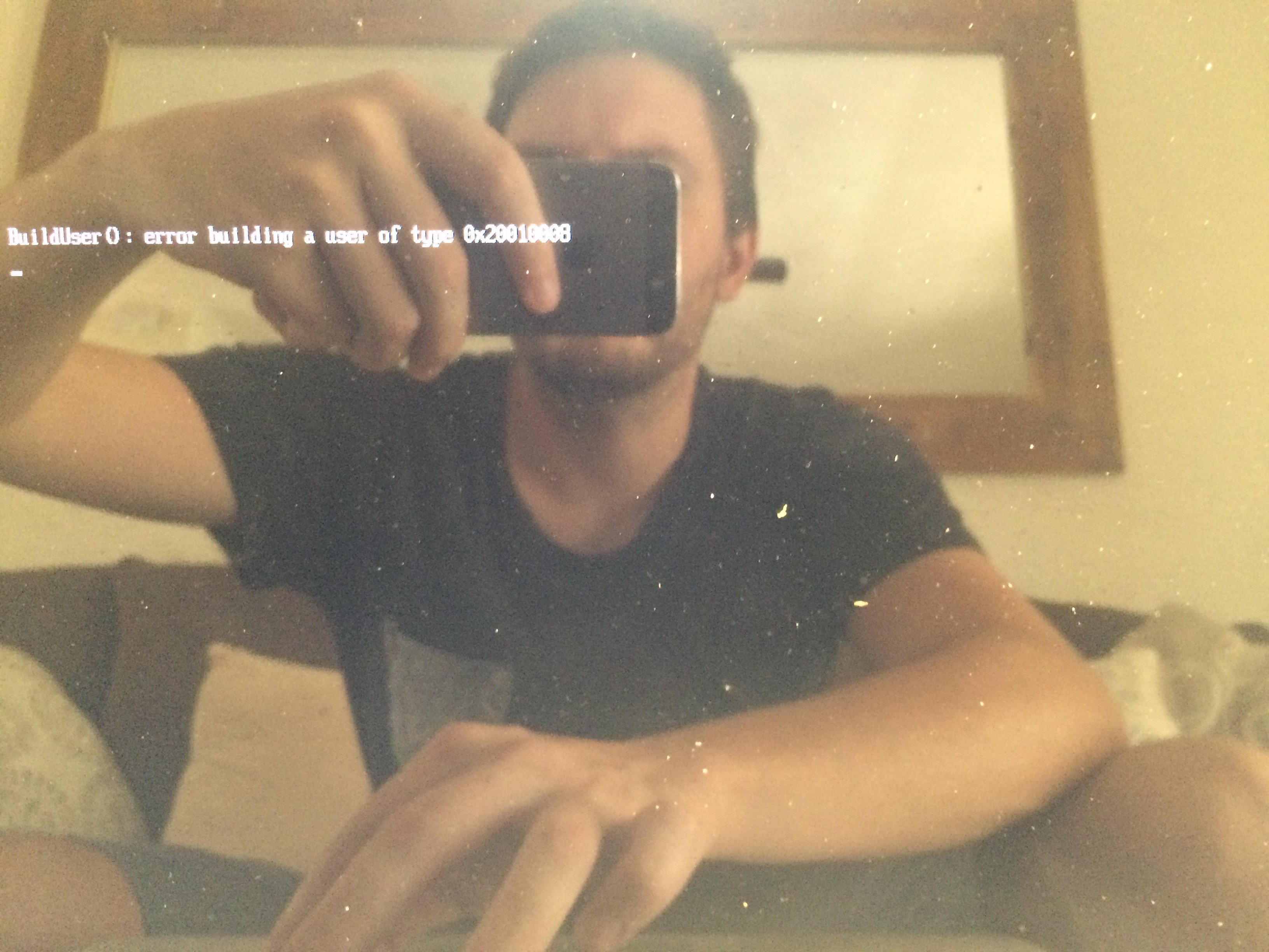

Error says
builduser 0 : error building a user of type 0x20010008
Update;
Seems that strange code is due to HDD being encrypted by FileVault.
So that's resolved.
I still can't boot cmd R to disable SIP, ideas?
Can I disable Sip without revivers terminal?
Or can I boot to recovery terminal with my HDD in an enclosure and USB boot to another Mac?
Thanks

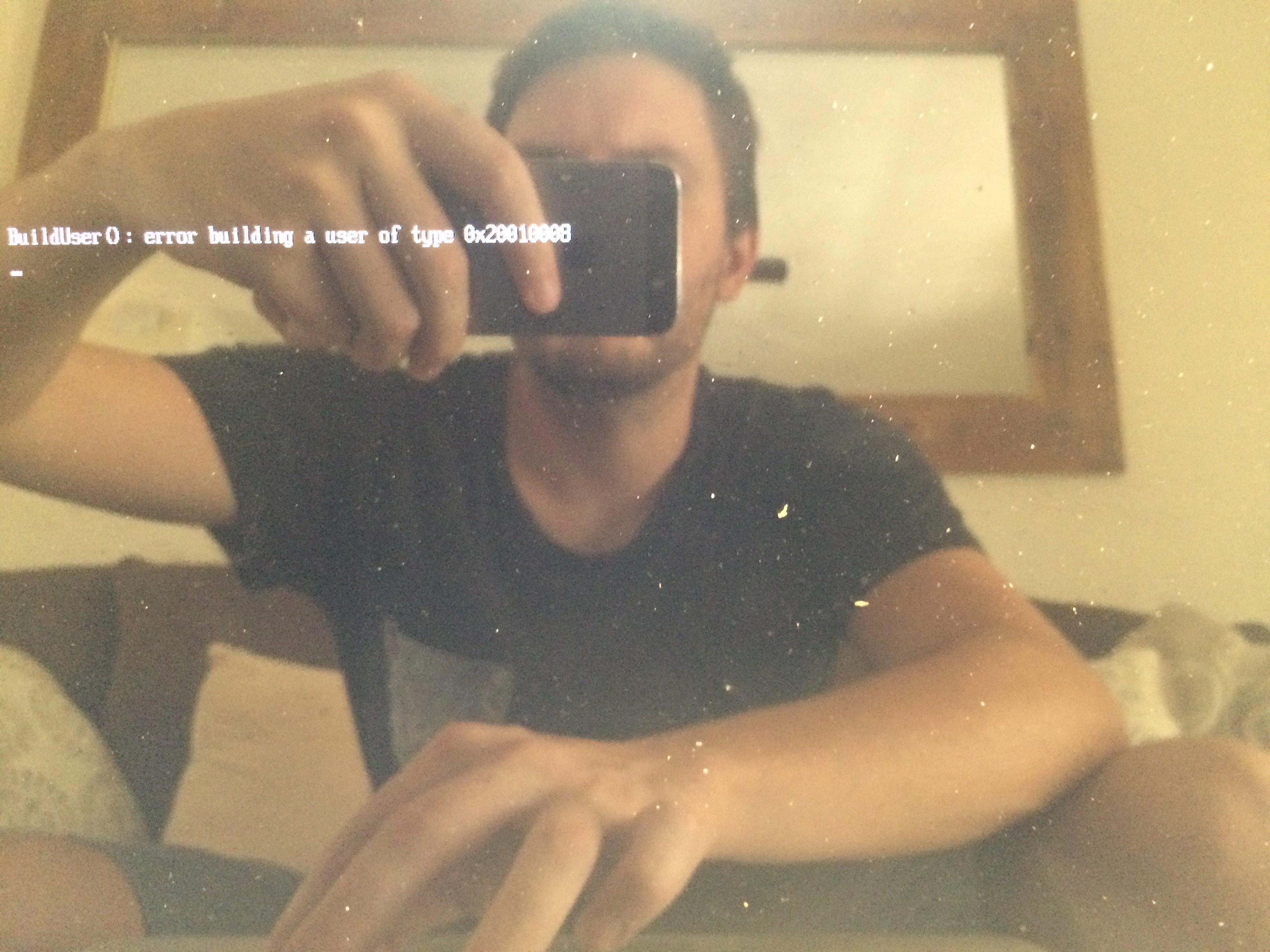

Thanks in advance!
Error says
Update;
So that's resolved.
Thanks

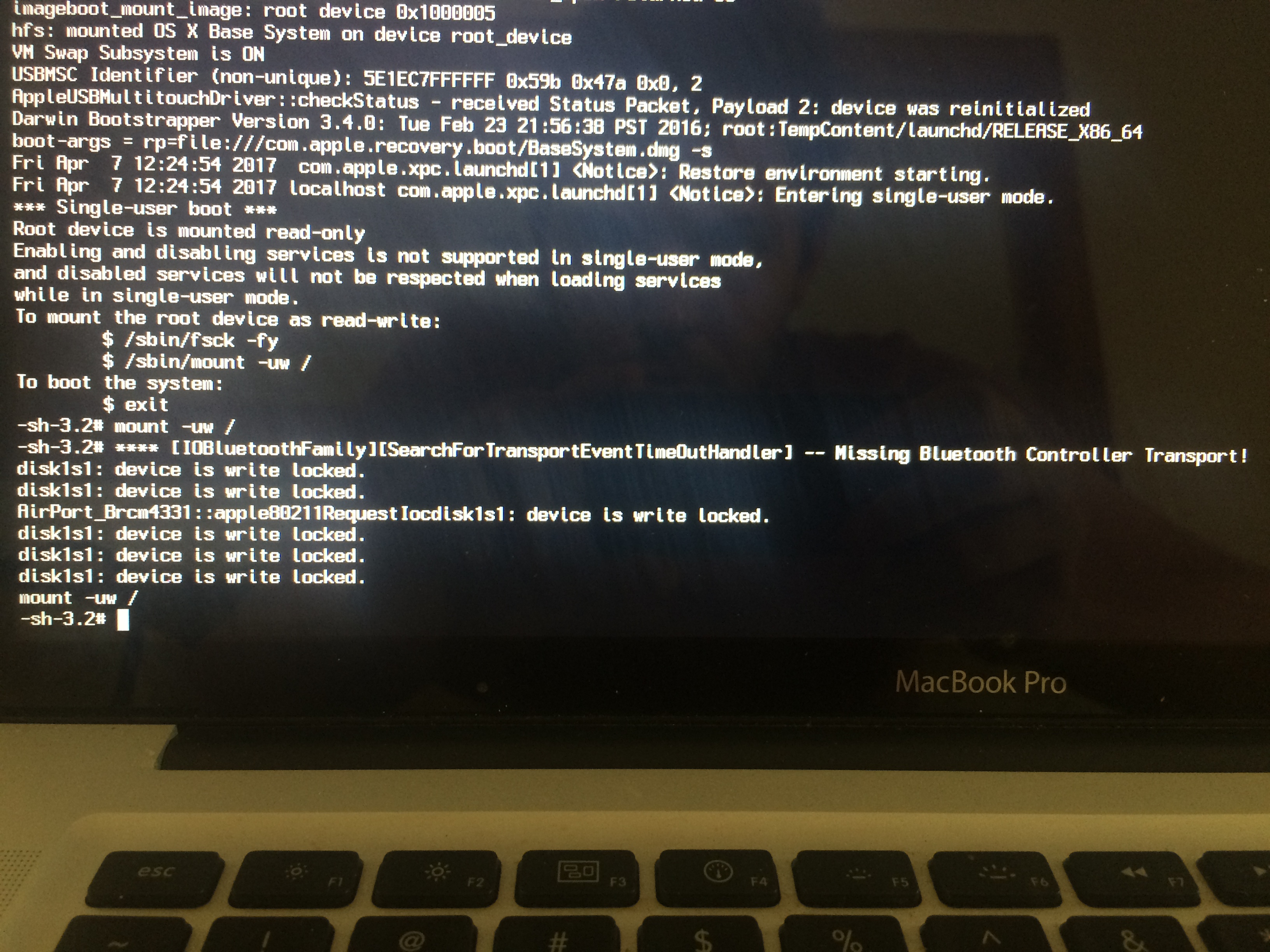

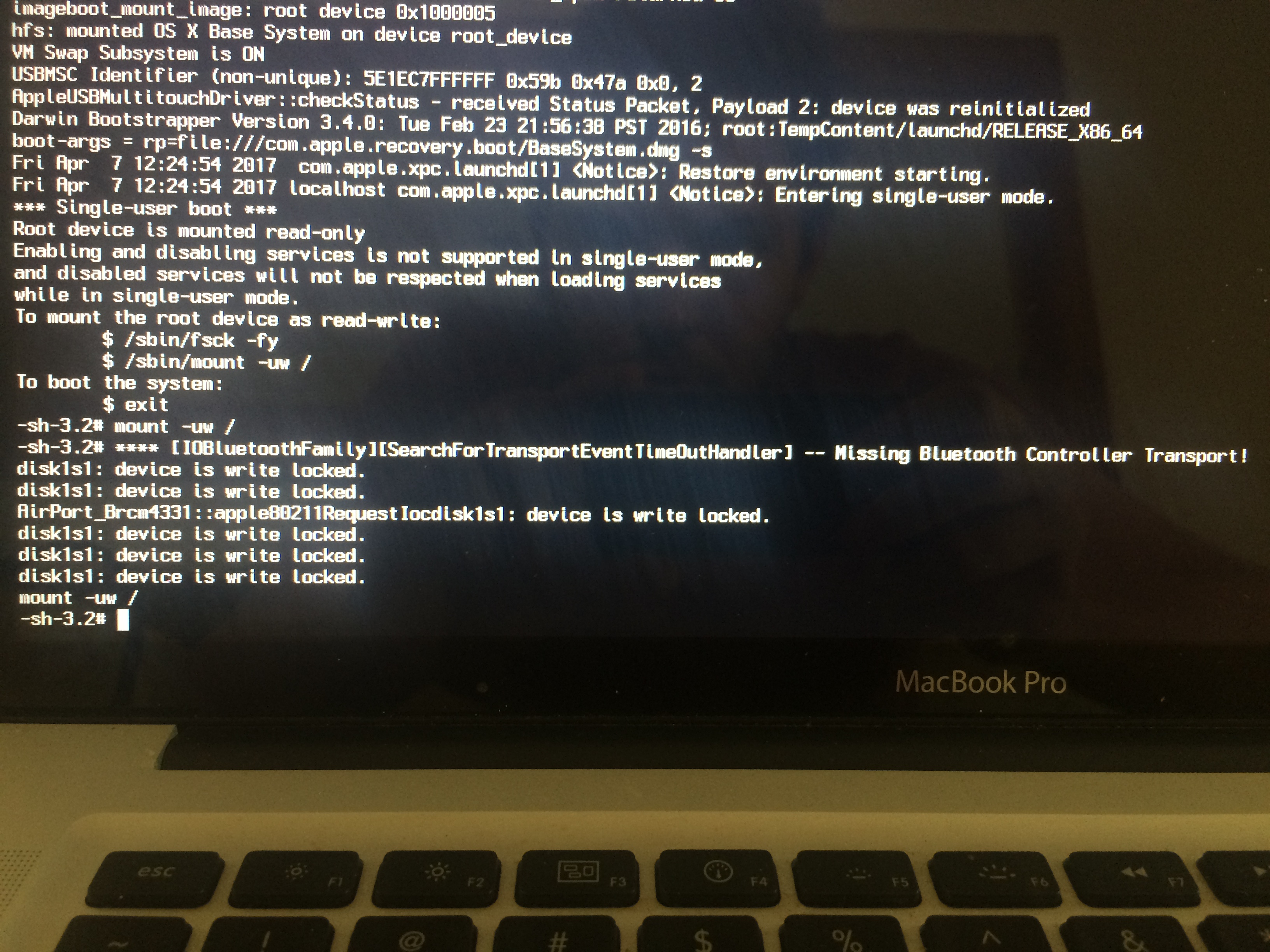

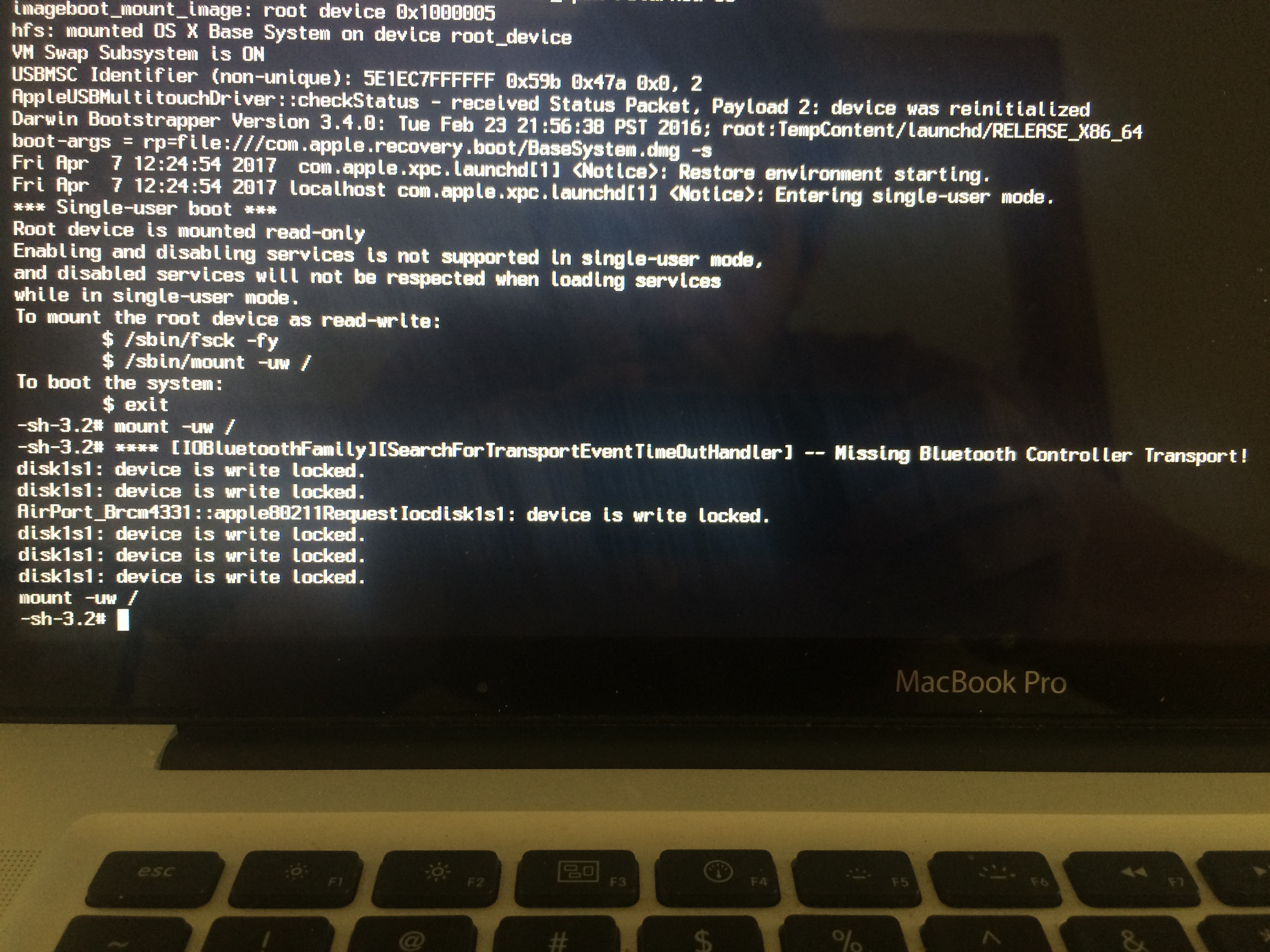

Now this
****[IObluetoothfamily][searchfortransporteventtimeouthandler] -- missing Bluetooth controller transport!
Disk1s1: device is write locked.
Airport_brcm4331::apple80211requestIocdisk1s1: device is write locked.
I think your main problem right now is corrupted HFS+ file system, corruption happened because of too many emergency shutdowns and filesystem became read-only. To repair your HFS+ filesystem you should either use another Mac or another computer with Linux (more tricky, described at the 1st post of this thread). After you repair it, you will get the write permissions
By the way, you could perform these removal operations instantly after repairing a filesystem, while your MBP's HDD is still inside the enclosure and is connected to another computer. Because, while HDD's OS X is shutdown, SIP is not blocking you! In short: while your MBP's HDD is connected to another computer, on this HDD there is no active SIP, and after the filesystem's repair - anything on this HDD should become writeable and removable
