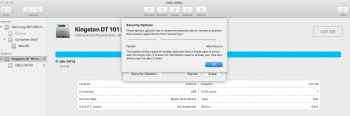

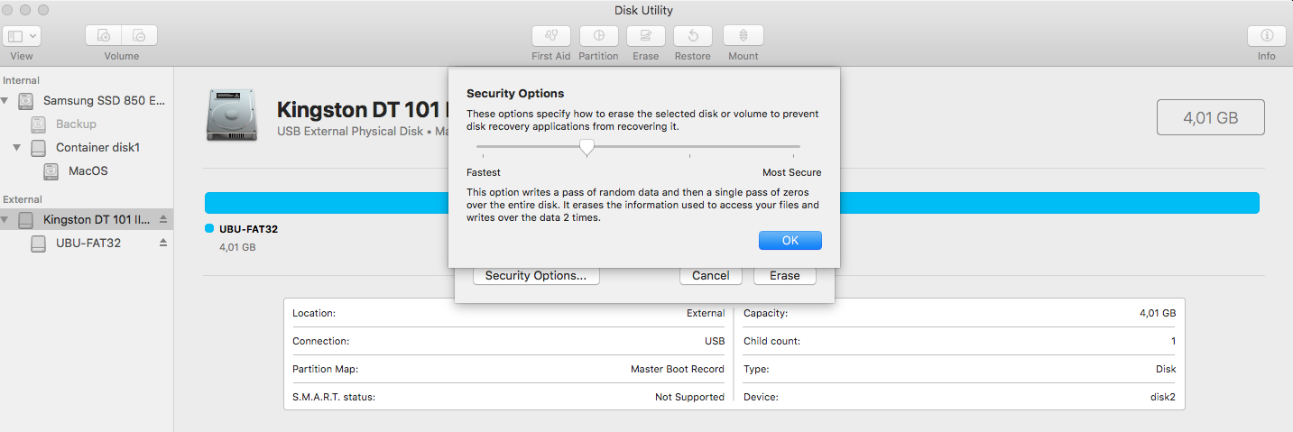

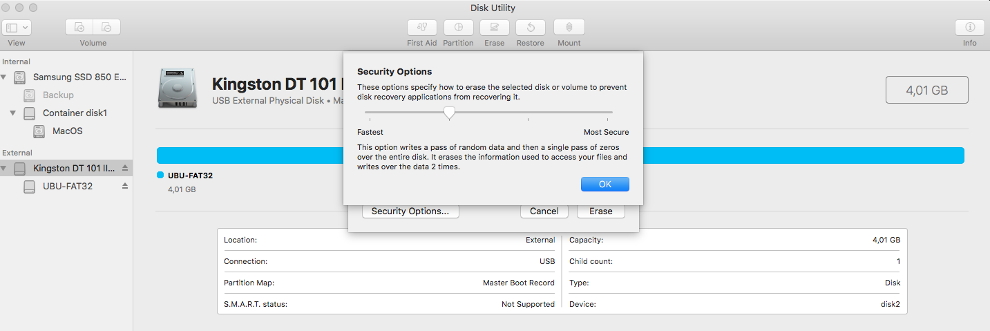

You have an I/O Error. Two alternatives:
1 - Problem with the SATA cable that connects the Hard Disk to the logic board. There are several cases where the problem was solved by replacing a new SATA cable.
2 - Hard disk problem. I lost a HDD due to several force shutdown. I had to replace it with an SSD (no mechanical parts).
You may have a problem with the HDD called "bad block". This can be solved by formatting the HDD "zeroing out".
I/O error may be that there is information (data) that the system is trying to read but as this part is corrupted, then Mac OS can not read this information.
I confirmed this information from Apple. SSDs can not be "zeroing out" by the Disk Utility of the Mac OS installer.
"Note: With a solid-state drive (SSD), secure erase options are not available in Disk Utility. For more security, consider turning on FileVault encryption when you start using your SSD drive.".
http://hivelogic.com/articles/how-to-securely-erase-storage-media-in-mac-os-x/
You only need to select after Fastest.
Boot Mac OS Installer (gpu-power-prefs = Intel) -> Disk Utility -> select View -> Show All Devices -> Select All HDD (not partition) -> Erase -> Security Options -> Move to the next "mark" after Fastest.
It will take 1 hour or more to complete the entire process. The higher the HDD size, the longer it takes to finish.
In the photo is an example with a USB stick / Pendrive. I do not have an HDD installed.
The normal "Fastest" formatting only deletes the table with the names of the files, etc. That's why a bad block remains. That is a possibility. There are bad blocks that remain and only switching to a new HDD / SSD.
