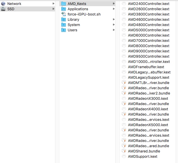

Step 3 should be within the "Or try the simplest way - No needed ArchLinux - Only MacOS".
If you do reboot after gpu-power-prefs -> Intel, then next step is to move AMDRadeonX3000.kext to not freeze the Macbook.

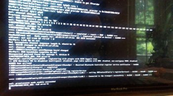

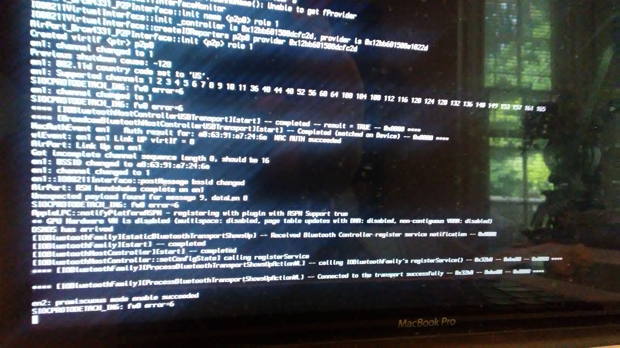

I'm trying to make a video capture simulation in Virtualbox with the alternative of ArchLinux and also MacOS.
I tried to record screen Macbook Pro with the mobile phone but the quality and the angle were not very good.
The problem is that Virtualbox 5.2.10 crashes when trying to make the Video Capture (1280x720). Old problem in the Virtualbox forum. I'll try with version 5.2.12 now.
Recording the screen with Quicktime has to then convert the .mov file (upload video website) and also make screen adjustments.
Video Capture resource inside Virtualbox have very good quality.

3 - Follow the MikeyN Guide - page 35 - #875 - to move the AMDRadeonX3000.kext from the /System/Library/Extensions directory and do not freeze Macbook Pro (at 75% progress bar or "IOConsoleUsers: gIOScreenLockState 3" message).

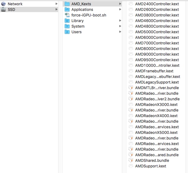

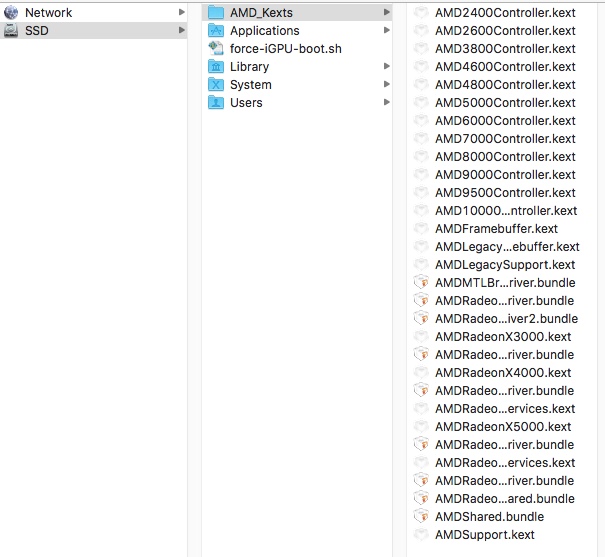

First of all, it is possible to successfully boot a MBP to OS X while still using the failed GPU, after you remove the AMD drivers by booting in command line mode (CMD+S) and entering these commands:
1) fsck -fy (to check a disk)
2) mount -uw / (mount a root filesystem with read/write permissions)
3) sudo mkdir /AMD_Kexts/ (make a directory to store the AMD drivers in case you'll need them in future)
4) sudo mv /System/Library/Extensions/AMD*.* /AMD_Kexts/ (move the AMD drivers)
5) sudo rm -rf /System/Library/Caches/com.apple.kext.caches/ (remove the AMD drivers cache)
6) sudo mkdir /System/Library/Caches/com.apple.kext.caches/ (just in case OS X will be dumb and will not recreate this directory, I am creating it for OS X)
7) sudo touch /System/Library/Extensions/ (to update the timestamps so that new driver caches - without AMD drivers - will be definitely rebuilt)
8) sudo umount / (umount a partition to guarantee that your changes are flushed to it)
9) sudo reboot
The degree of your inconvenience while doing these steps - strongly depends on how heavily a screen's image is distorted in your case. In my case it was even more difficult because the OS X partition became a "read-only" partition (because of too many emergency shutdowns I did while desperately trying to boot OS X with a failed GPU) so I had to remove a hard drive from MacBook Pro and (using a USB to SATA 2.5" adapter taken from my portable HDD) attached it to a computer with Linux, then followed these instructions:
https://superuser.com/questions/961401/mounting-hfs-partition-on-arch-linux (1st answer) - carefully executed a number of commands, calculated a sizelimit for my parition layout, and finally ran sudo mount -t hfsplus -o force,rw,sizelimit=YOURNUMBER /dev/sdb2 /mnt to mount this HFS+ partition to /mnt directory in read-write mode. Then I performed these "1)-7)" steps you see above, and also repaired a filesystem by running sudo fsck.hfsplus -f /dev/sdb2 before unmounting a partition with sudo umount /mnt and putting a hard drive back to MBP...
This gave me a MBP which could boot to OS X although STILL using a broken AMD GPU: so it screen's image is very distorted (could browse the Internet but quite inconvenient to read a text), Launchpad is super laggy, and you can't switch to Integrated GPU using gfxCardStatus because: without AMD drivers (which we had to remove to successfully boot to OS X) Macbook Pro thinks its' internal screen is External Display and gfxCardStatus tells it is impossible to switch because External Display is using AMD GPU. Somewhere I found a suggestion that it is possible to rebuild a gfxCardStatus from the source code - https://github.com/codykrieger/gfxCardStatus - with removed or commented out 156-166 lines in the ./gfxCardStatus/Classes/GSProcess.m to make it to ignore the external display:

Looking for help and clarification. I've read this thread up to page 54 so far and thank you to all the great minds that has shared and help.
I did one of the fixes, I don't remember which one, but after the Early 2011 Macbook Pro was up I continued with the LoginHook. The Macbook's video is back and stable. The fix holds after every reboot.
I think that I made a mistake where I directed the storage of the AMD_Kexts. They are at the "root" level (forgive me if that is the wrong language) of my SSHD. I do remember typing in "Extensions-off" when following the instructions but that folder is not in my Library.
Besides this mistake, the Macbook will not sleep. Tried setting pmset for hibernate mode of 25 and won't hibernate. I reset the pmset to normal and used DeepSleep, it appears to hibernate and I wait until the keyboard backlighting goes off to close the lid but I found it was not correctly hibernating with lid closed and getting hot. Had to force power down and restart.
It looks like "the fix" now addresses the sleep issues so I want to start from the beginning and reset Pram, etc to get Kexts back to their standard location. Since the Kexts aren't where they should be, I need instructions on how to do that along with any advice you can share.
Also in the photo, these are the commands that are in the "force-IGPU-boot.sh. Is this correct and in the correct location?
Thanks for everything.

You made a Frankenstein Guide. Or you follow AppleMacFinder guide or you follow the MikeyN guide.
Clear NVRAM/PRAM -> do not move your kexts back to /System/Library/Extensions.
Command mv with verbose (-v) -> move your kexts back to /System/Library/Extensions
Verbose mode shows the result of the operation. You're sure where the kext was moved or directory created.
mv -v /Source_directory_Kext_with_Name_Kext /Destination_directory_Kext
SIP Disable -> then boot Single User Mode -> mount "/" with Read and Write permission:
Example:
Code:
mv -v /AMD_Kexts/AMD6000Controller.kext /System/Library/Extensions/
mv -v /AMD_Kexts/AMDSupport.kext /System/Library/Extensions/
mv -v /AMD_Kexts/AMDLegacySupport.kext /System/Library/Extensions/
mv -v /AMD_Kexts/AMDLegacyFramebuffer.kext /System/Library/Extensions/
mv -v /AMD_Kexts/AMDFramebuffer.kext /System/Library/Extensions/
Create directory with mkdir command with verbose (-v) and move AMDRadeonX3000.kext:
Code:
mkdir -v /System/Library/Extensions-off
mv -v /AMD_Kexts/AMDRadeonX3000.kext /System/Library/Extensions-off/
AMDSupport.kext
AMDFramebuffer.kext
AMDRadeonX3000.kext
Verify that the LoginHook (MikeyN Guide) is set to /System/Library/Extensions-off/AMDRadeonX3000.kext.
Follow this Guides:
MikeyN Guide deacrese AMD GPU - System temperature - Page 35 - #875
Rename old AMDRadeonX3000.kext - move new AMDRadeonX3000.kext after update - Page 57 - #1425
Shutdown or Restart Macbook -> black screen - Page 57 - #1425
Close Lid - Sleep - Wake - Pages 43-50 - #1066 #1243
Update MacOS, then MacOS put back new /System/Library/Extensions/AMDRadeonX3000.kext -> no freeze Macbook Pro? - Page 70 - #1747

So I followed this entire process and now my computer is going infinite reboot. The infinite rebooting started after
"– wait for the kextcache process to finish
then
reboot
Reboot normally:"
Anyone now how I can restart?
Also, when I tried to do this "sudo defaults write com.apple.loginwindow LoginHook /Library/LoginHook/LoadX3000.sh " It said I could not go to the website com.apple.loginwindow
Did anyone get this issue too?
Okay, i redid Mikey N's guide and now my computer won't even boot up. instead it's always freezes at this point.
SICPROTODETACH_IM6: Fw8 error-6
I included a screen shot. Anyone know what to do?
