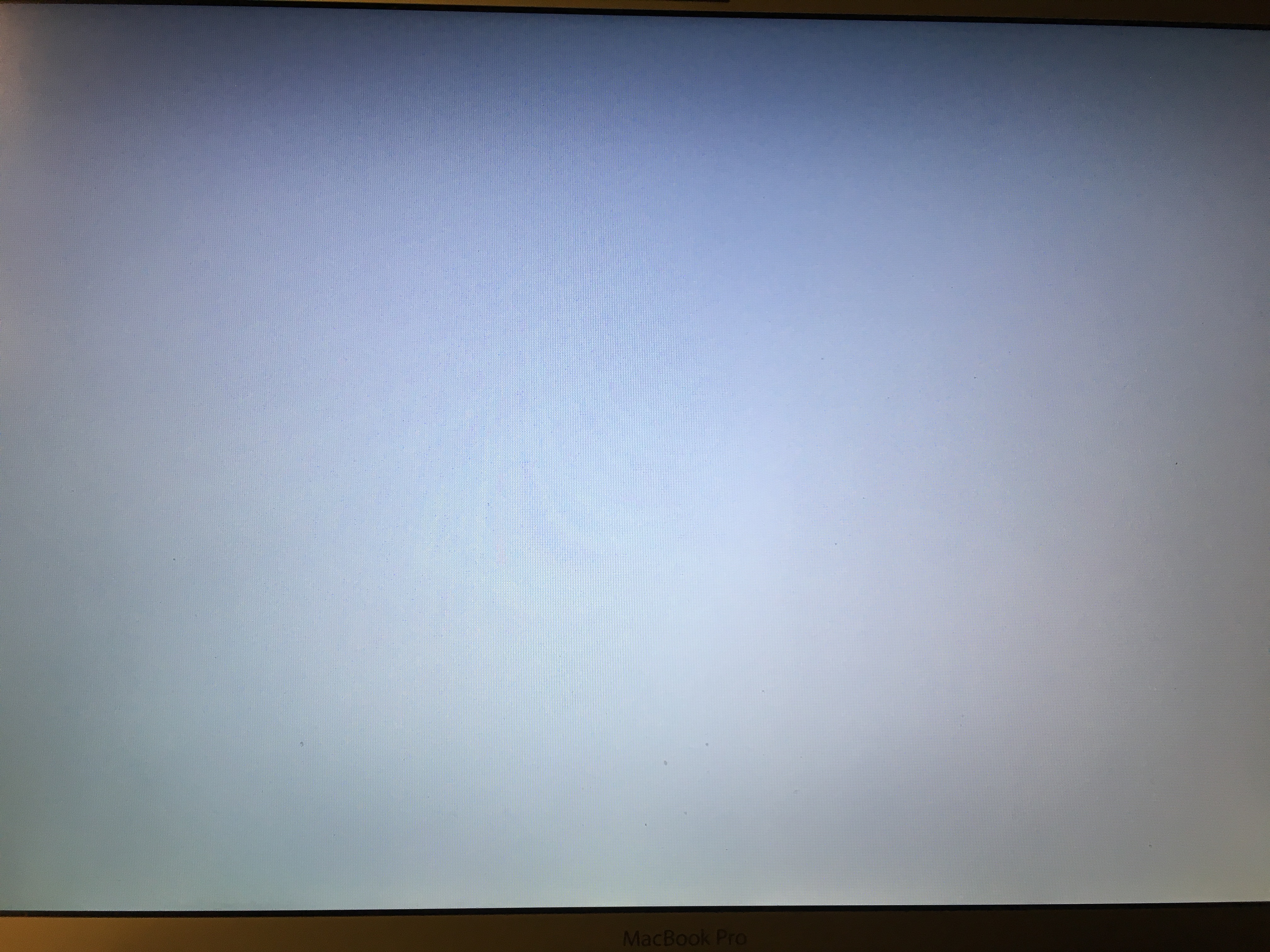

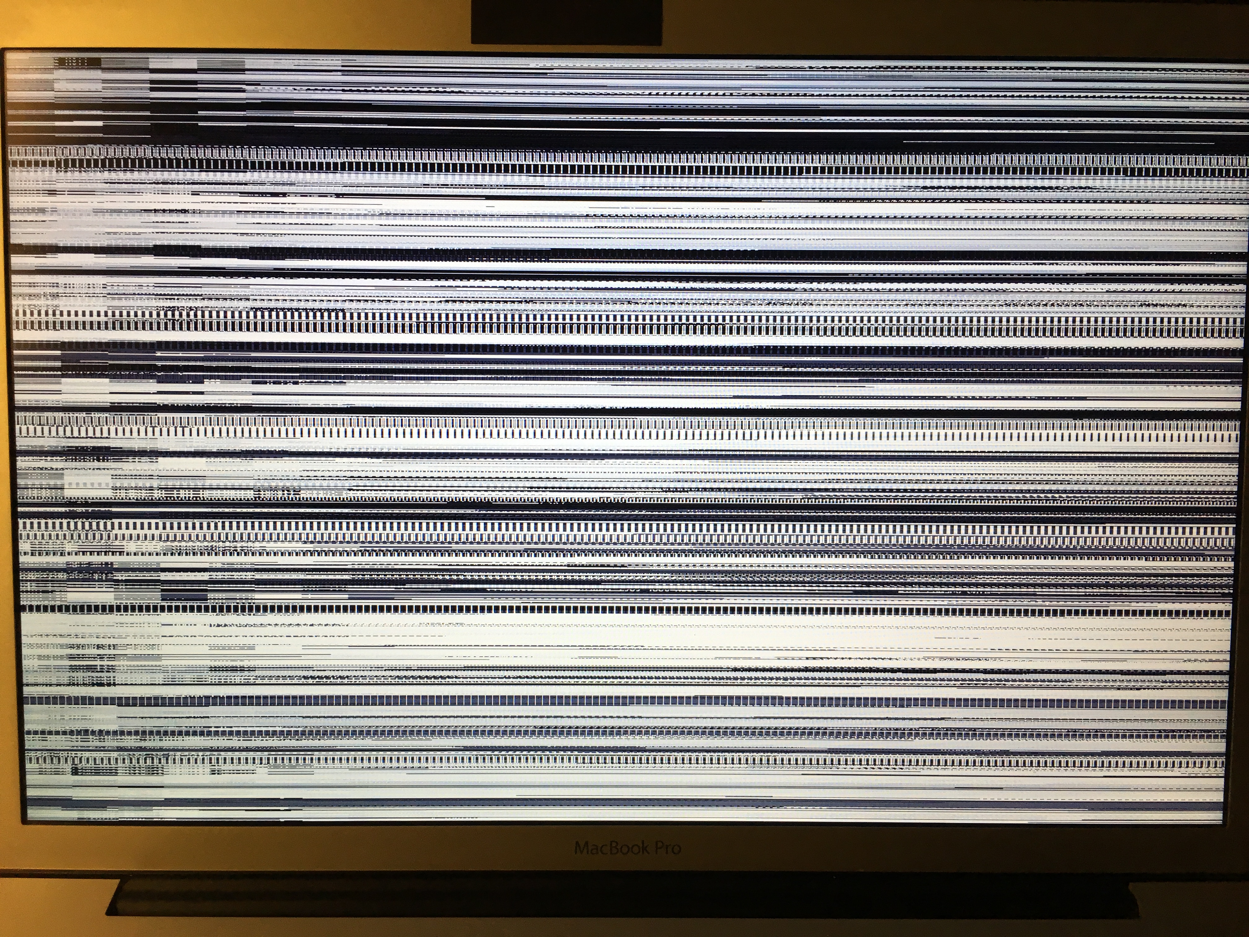

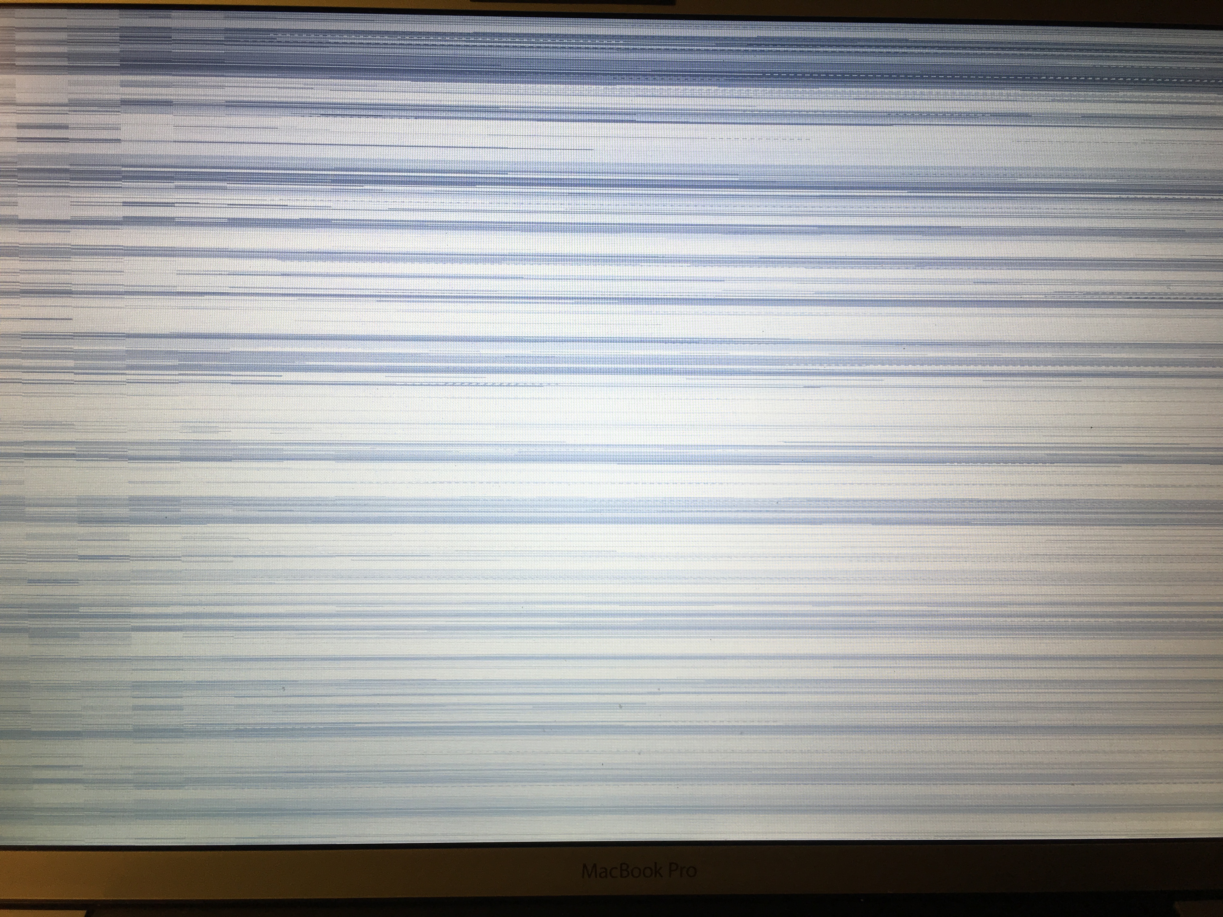

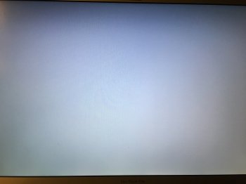

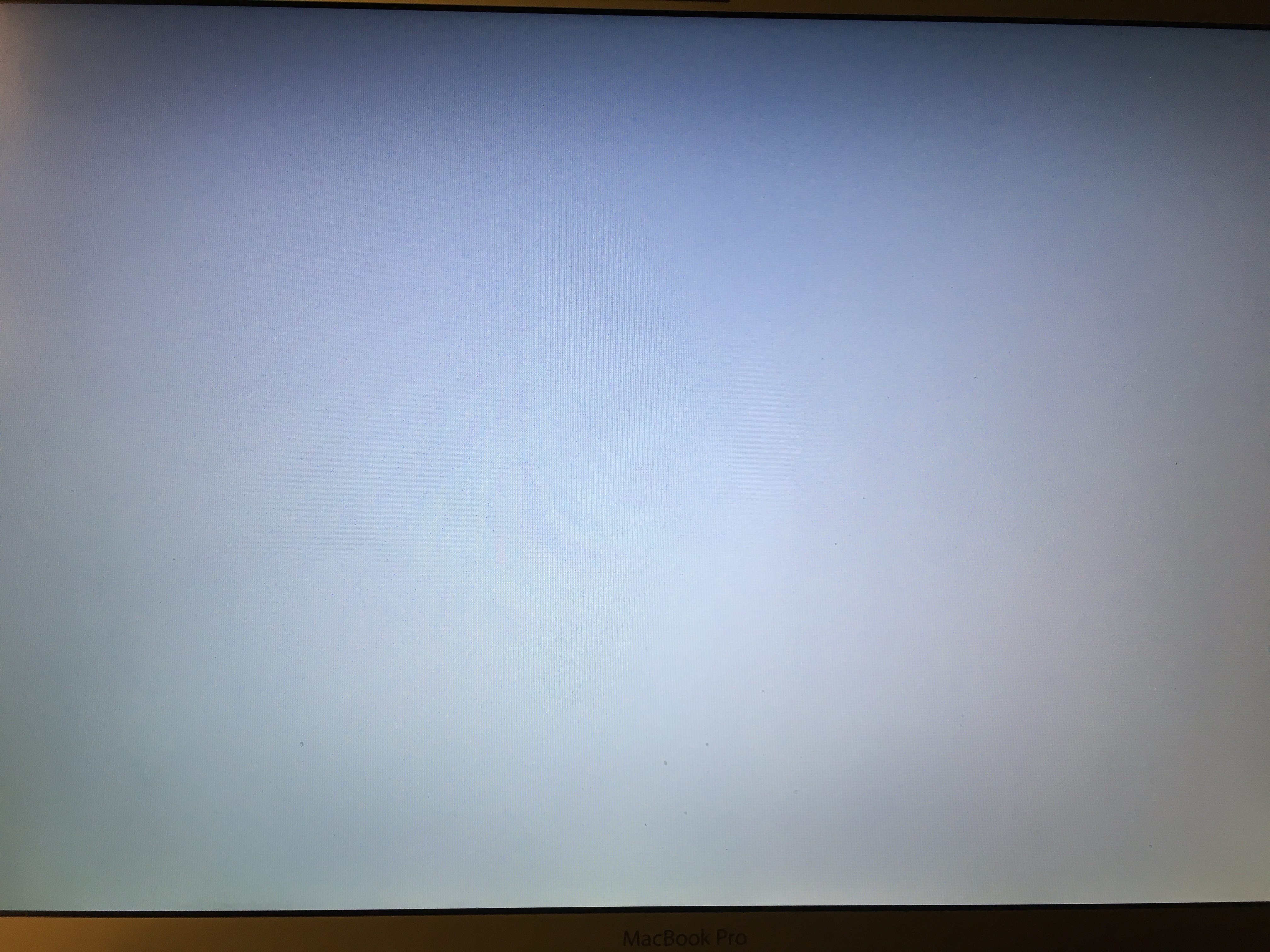

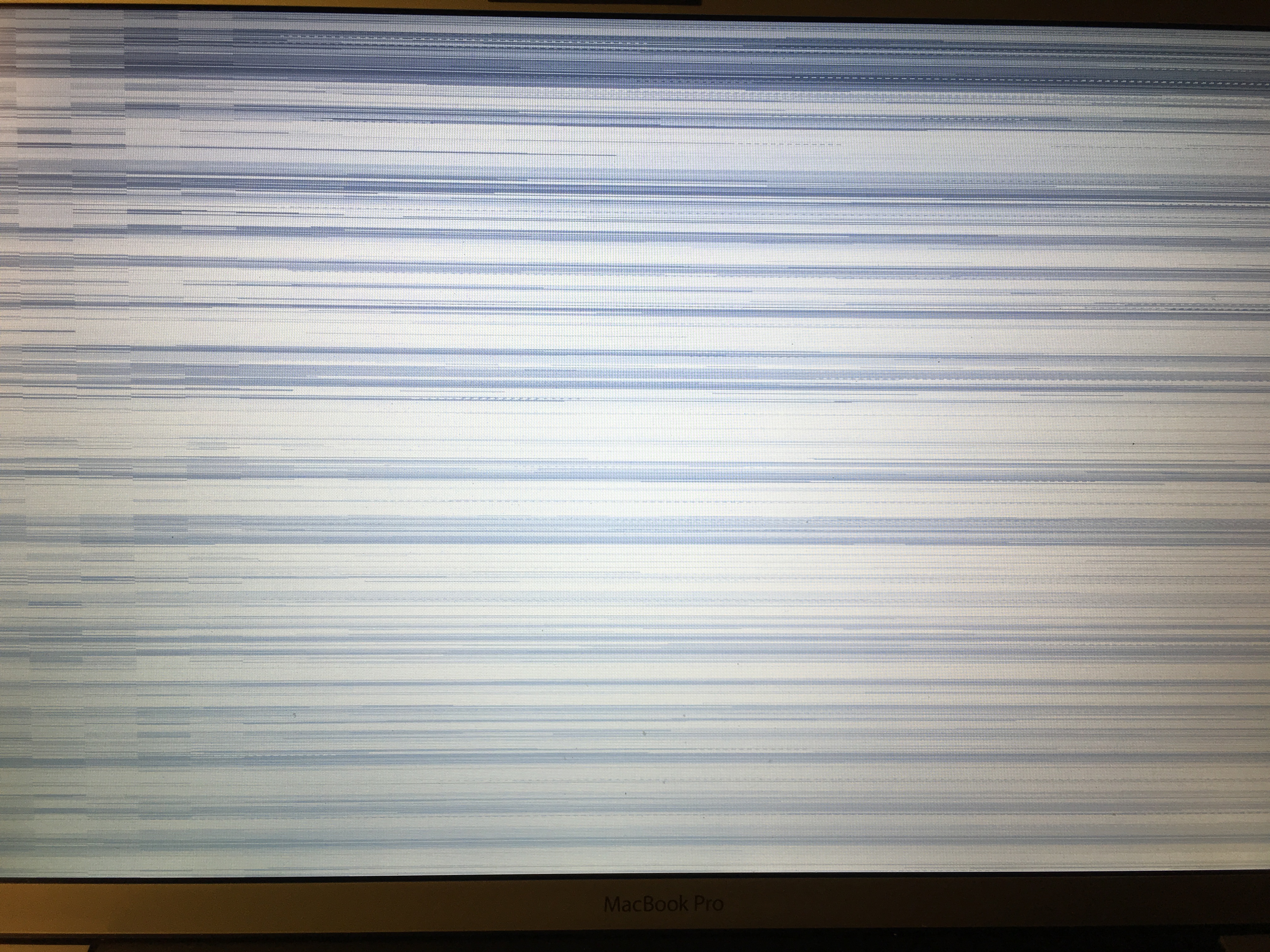

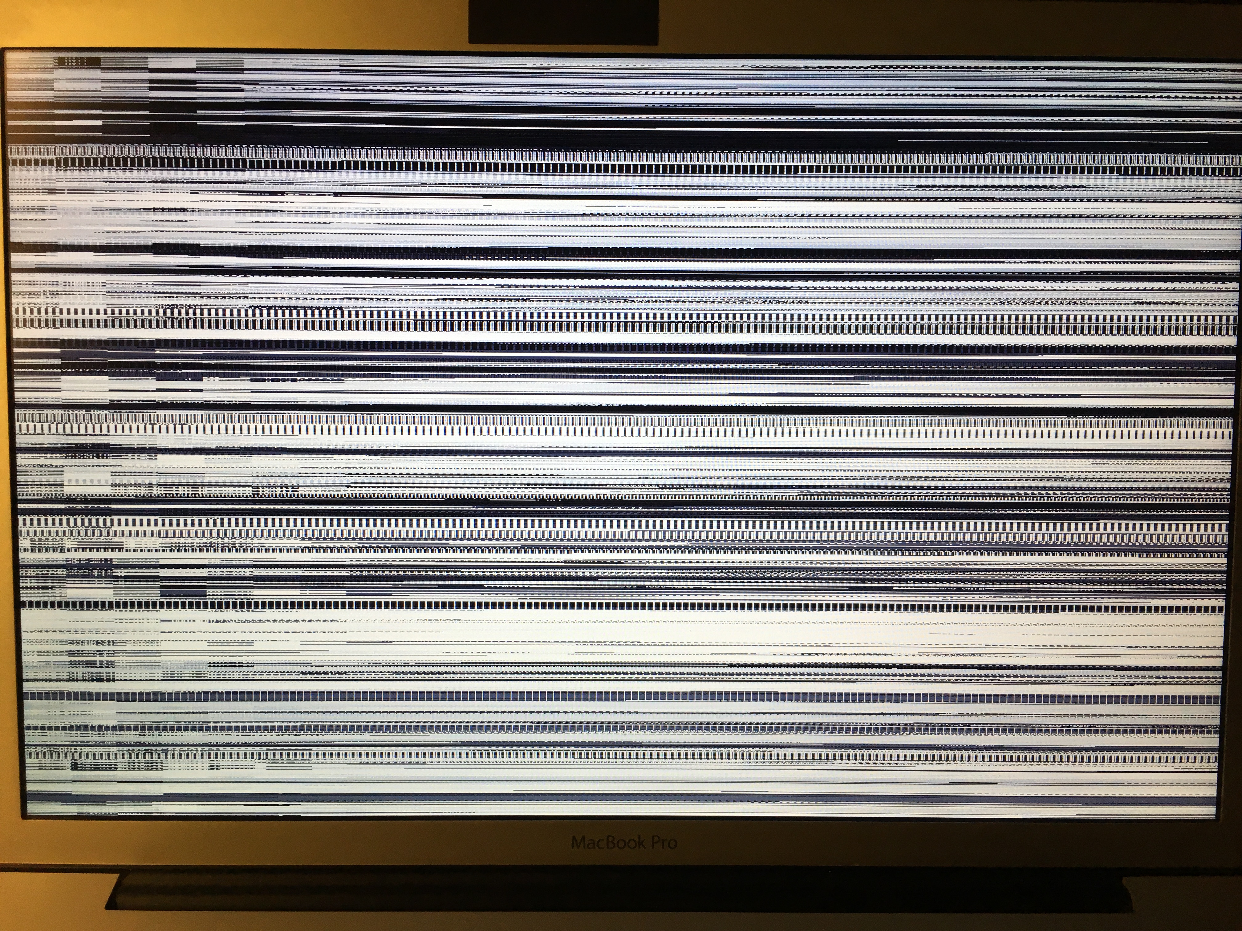

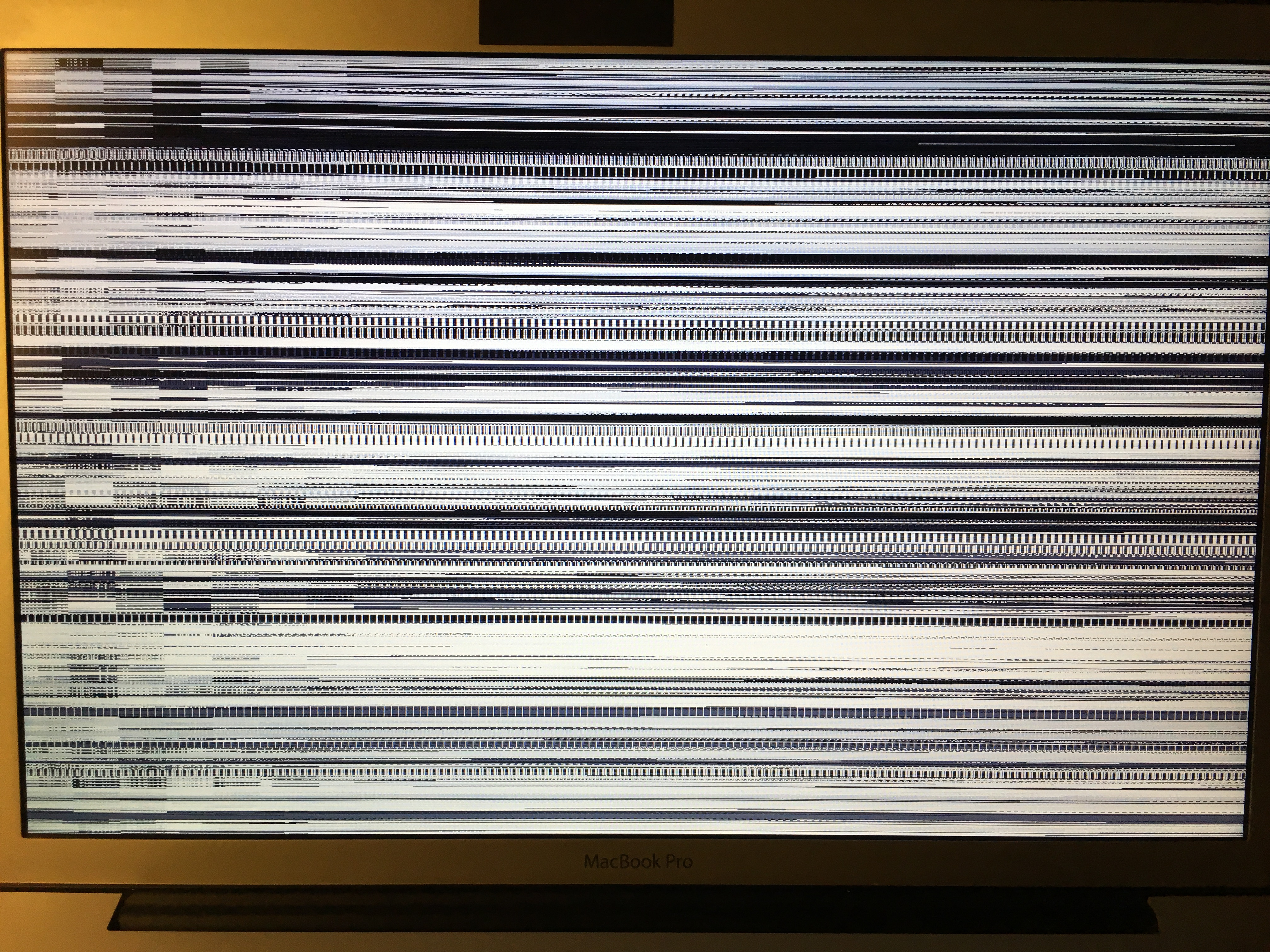

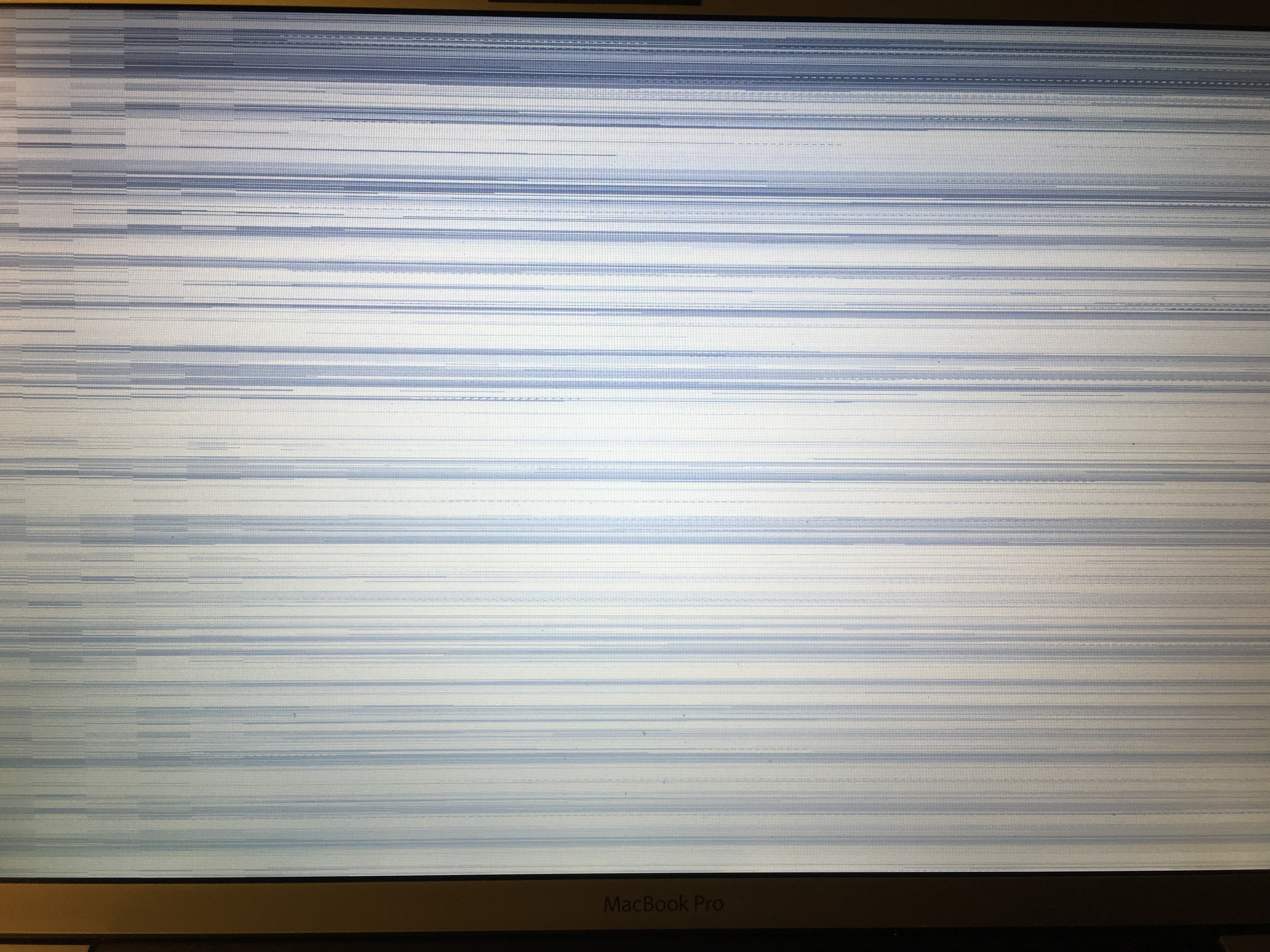

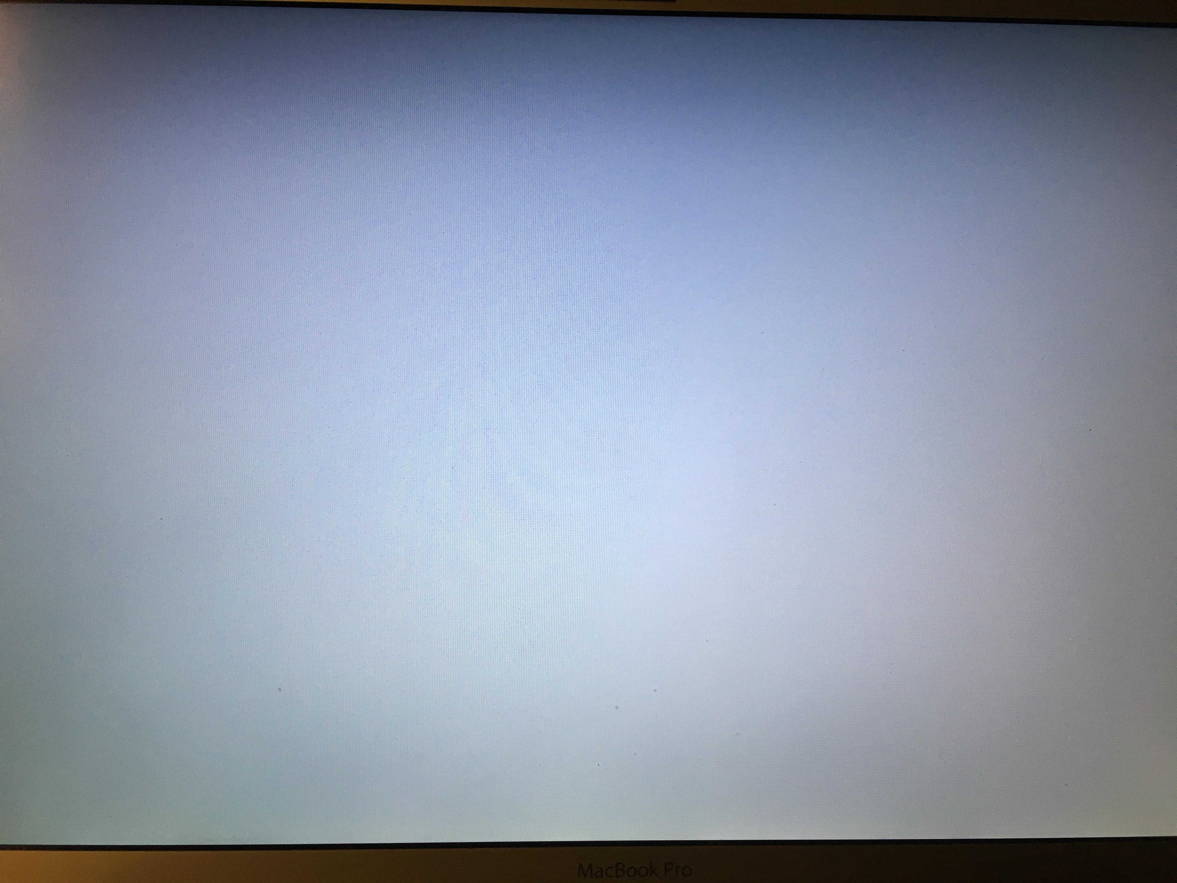

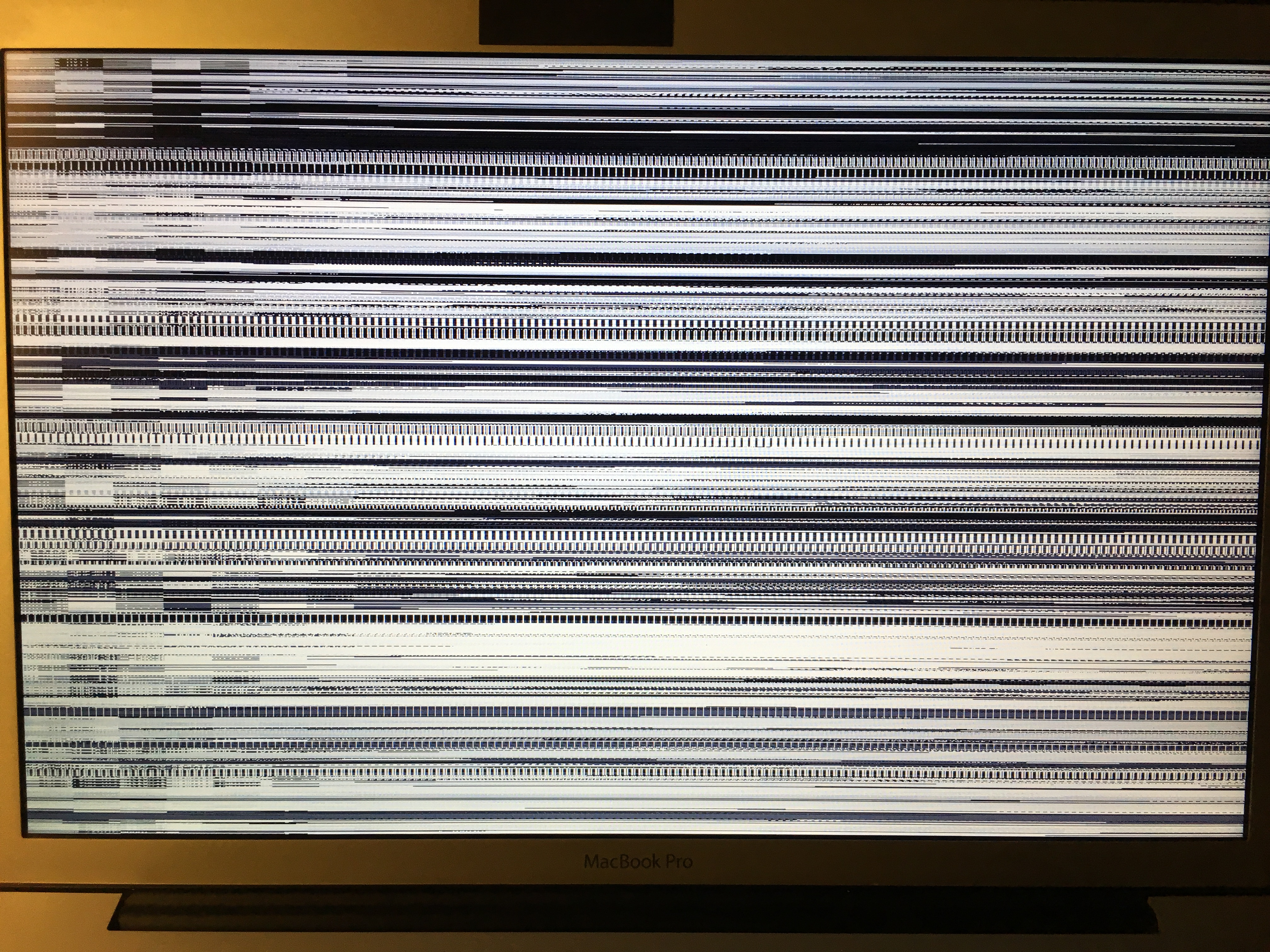

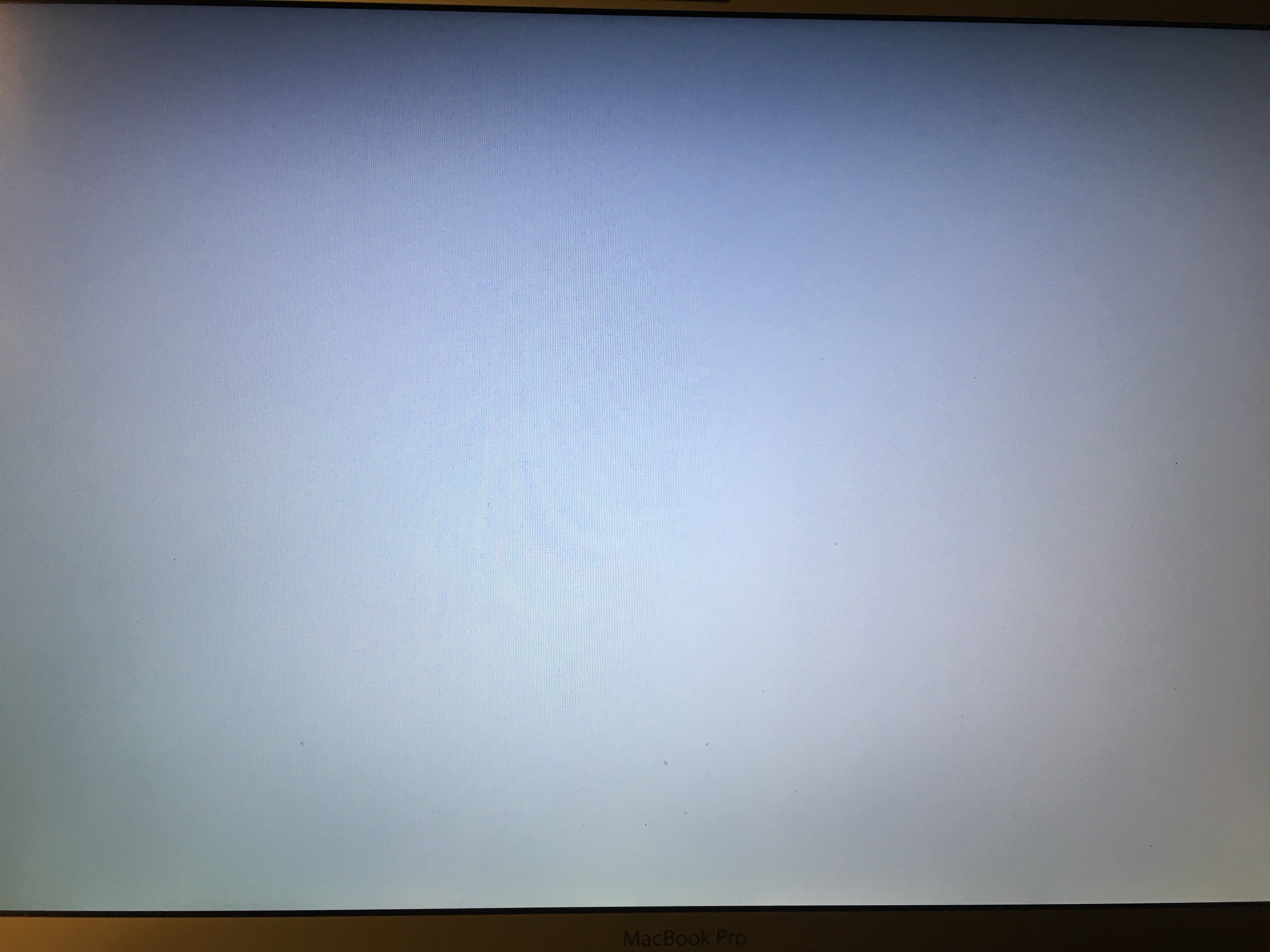

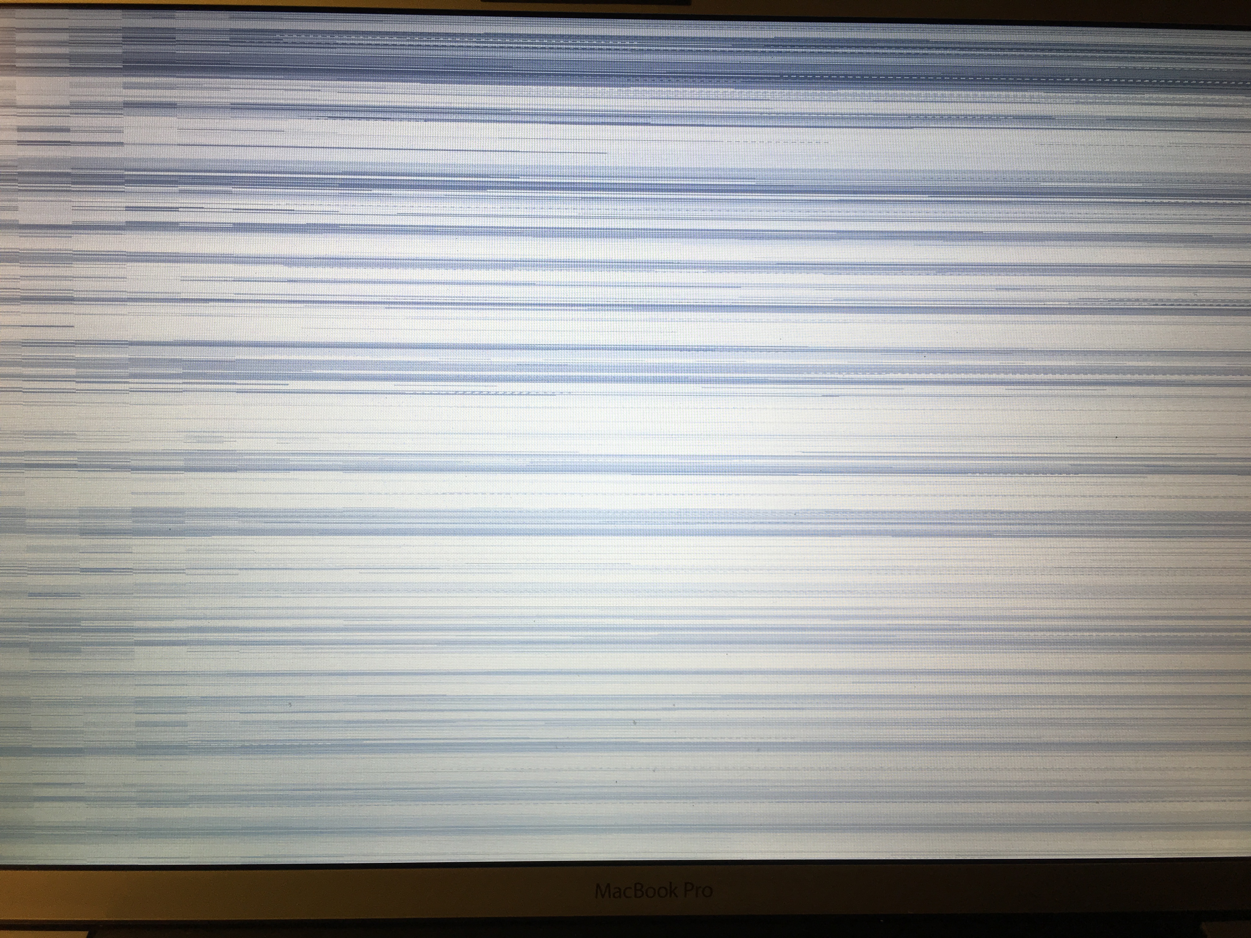

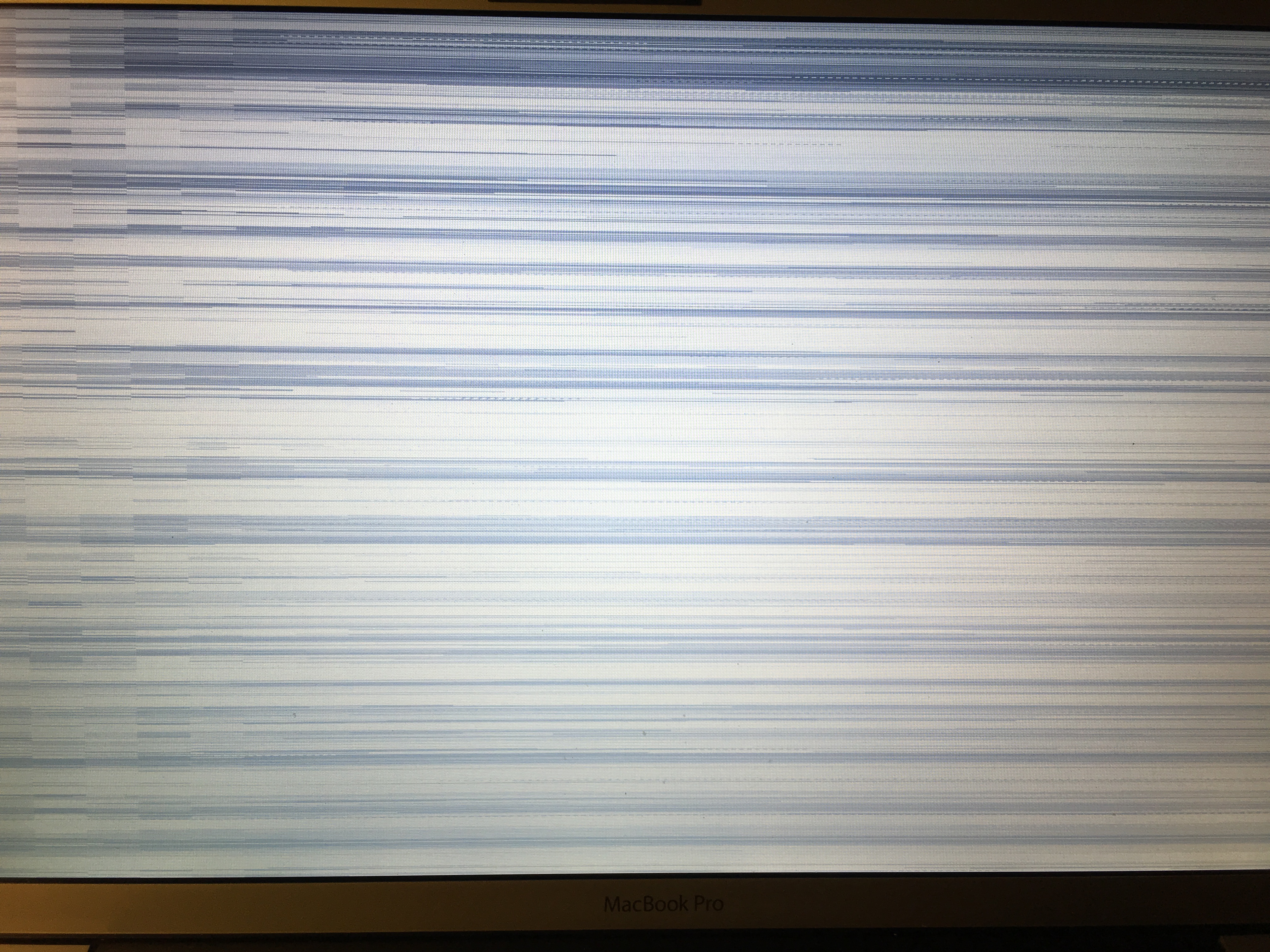

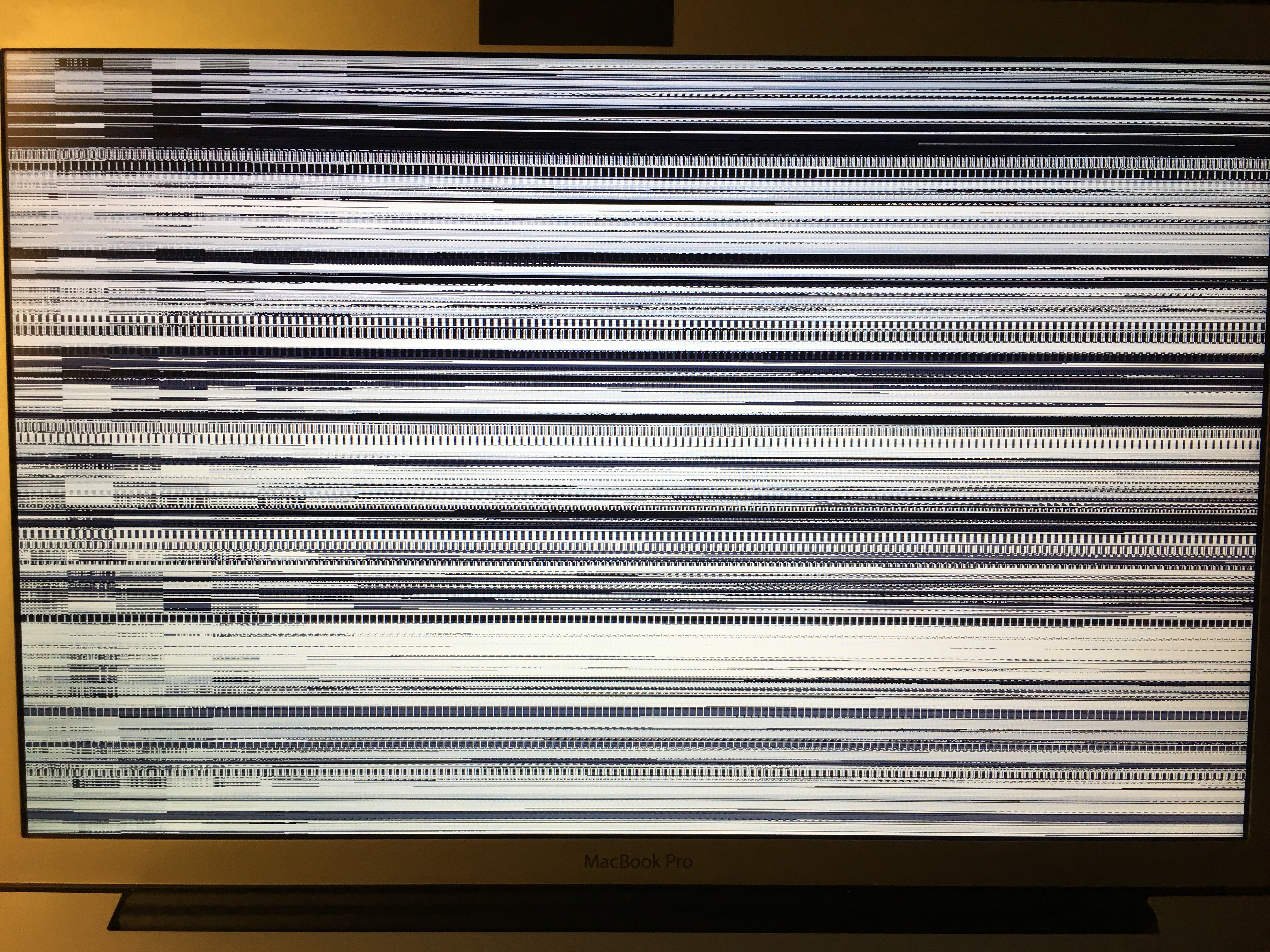

Wondering if someone can help me here. I'm using a early 2013 MBP that just had it's nvidia gpu die. I starting following the instructions on dosdude1's site but can't seem to open the application. My computer has stopped crashing after entering the nvram command in single user mode but I can't change my brightness. Are there any other steps I need to take to make this fix permanent? Is there a way to be able to change my brightness again??
GPU doesn't fail on that system, it's actually just bad solder joints on the GPU VCORE regulator IC (U8900 on the schematic). All you need to do is remove the IC, apply new solder, and solder the IC back on. Once done, the system will work perfectly. I show this repair in my video here, however the IC does not need to be replaced as I do in the video.
Thanks for the quick response!
Unfortunately I don't have any soldering experience or equipment. Is there a work around to get my brightness up until I can get it to someone who could fix it (I'm assuming it would be a cheap repair?)?

Prior to this I had the GPU professionally repaired twice, once by apple and it still failed. Time will tell how this fix goes, today is day 2 but I just did the kext return deal. I just wanted to say Thank you to all on the forum for your info!

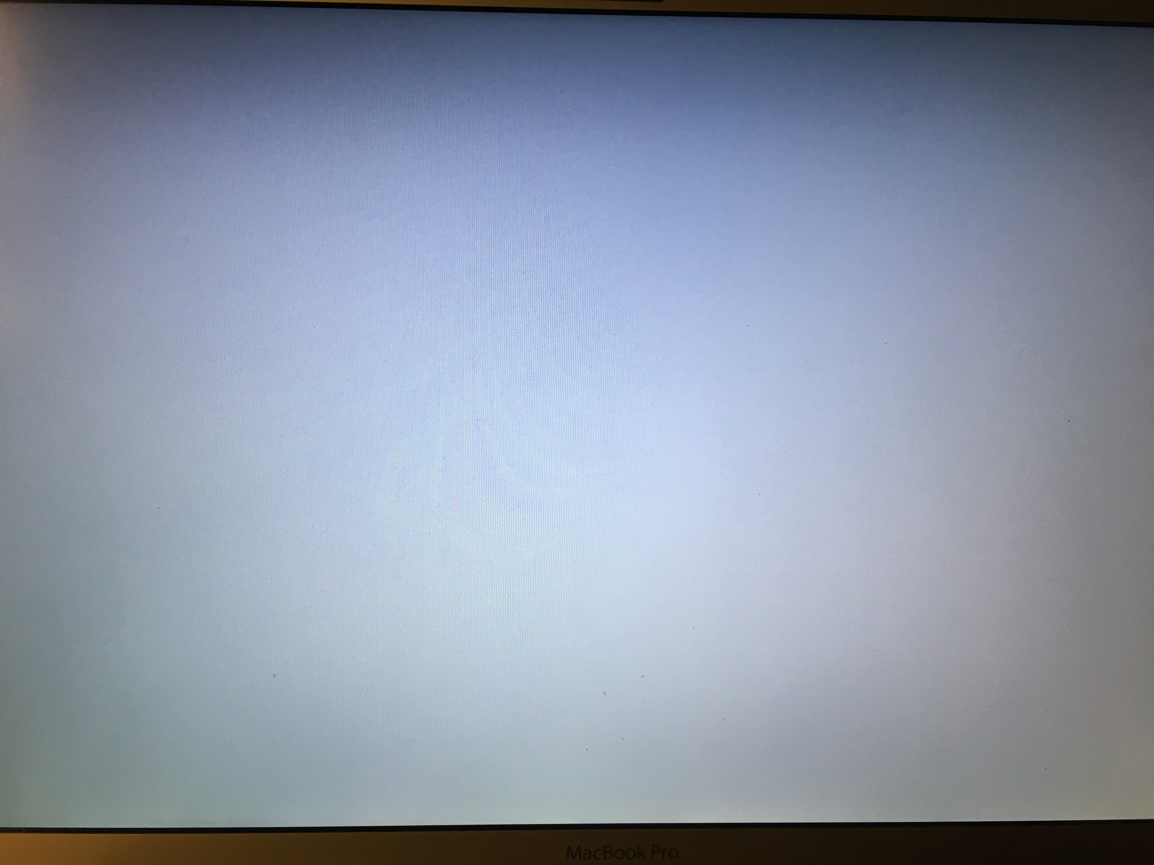

[B][U]Update 2 - Shutdown or Restart Macbook Pro - avoid black screen freeze:[/U][/B]
Is there any solution to when I already have this black screen freeze? My late 2011 has Sierra installed and a month ago I followed instructions from the very first post (i.e. "100% WORKING SOLUTION") and it worked - I could not believe it. But until the first restart. This first restart brought black screen freeze. One of the consequent restarts was successful and I thought it's somehow fixed itself, so I used my laptop without shutting it down until I had to (after a security update). Then I saw black screen again and could not do anything. I tried restarting several times: sometimes it was silent black screen, sometimes it was a recurrent chimes sound, but I could not make it start. But once when I wanted to boot up from that Linux flash somehow it booted up and I was very happy again... until today. Today I installed another security update and after it I have frozen black screen that I can't bypass this time :( I have already tried resetting NVRAM, SMC, trying all possible key combinations during boot - no luck. The only thing that changes is that right after I reset SMC (or simply disconnect the battery for few seconds) it's recurrent-chimes-sound-frozen-black-screen, but all reboots after that - a silent one. Looks like my issue is similar to what user with name "1024KB" described here few pages ago here.
Do you guys know if there is a way to revive it? I regret that I saw the link for avoiding black screen freeze too late :( Thank you in advance!
You could try booting into safe mode to start with by pressing shift while booting so that you at least gain access to your files etc...I'm in the same boat as you I'm afraid so way to reboot into integrated graphics mode - YMMV.

Looks like it gotten worse :( While I left my laptop in Recovery Console mode and was looking for a solution of absence of 'sudo', it slept and when I got back, got frozen. After I restarted it, I never was able to see a normal boot anymore :( It now looks like my integrated GPU is screwed as well, because it looks like computer is loading, but screen blinks like this:
I tried resetting SMC, then NVRAM, no luck - same thing. Although, even by this screen I can tell that it's not a static image and something is loading because it blinks differently:
UPDATE: I left it like this for 15 minutes and at some point screen became all-gray (like a healthy laptop when it reboots):
It stayed like that for about 15 minutes, then rebooted by itself and started this (together with chimes):
After another 3 minutes it got tot the same grey screen, no mouse, no nothing. I left it like this, will give it an hour to do its thing. But I'm almost hopeless now... Looks like for some reason I don't have iGPU either :( It maybe a result of my continuous turning off/on/discharging, etc...
