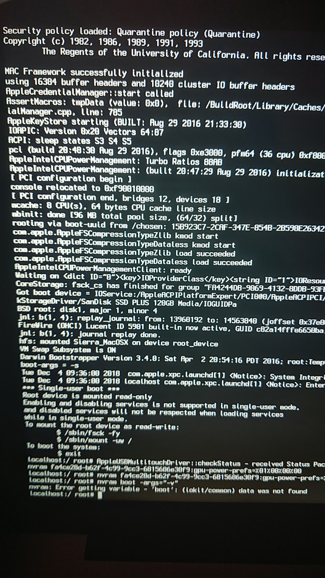

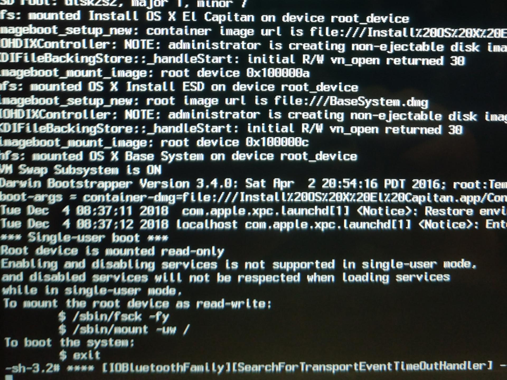

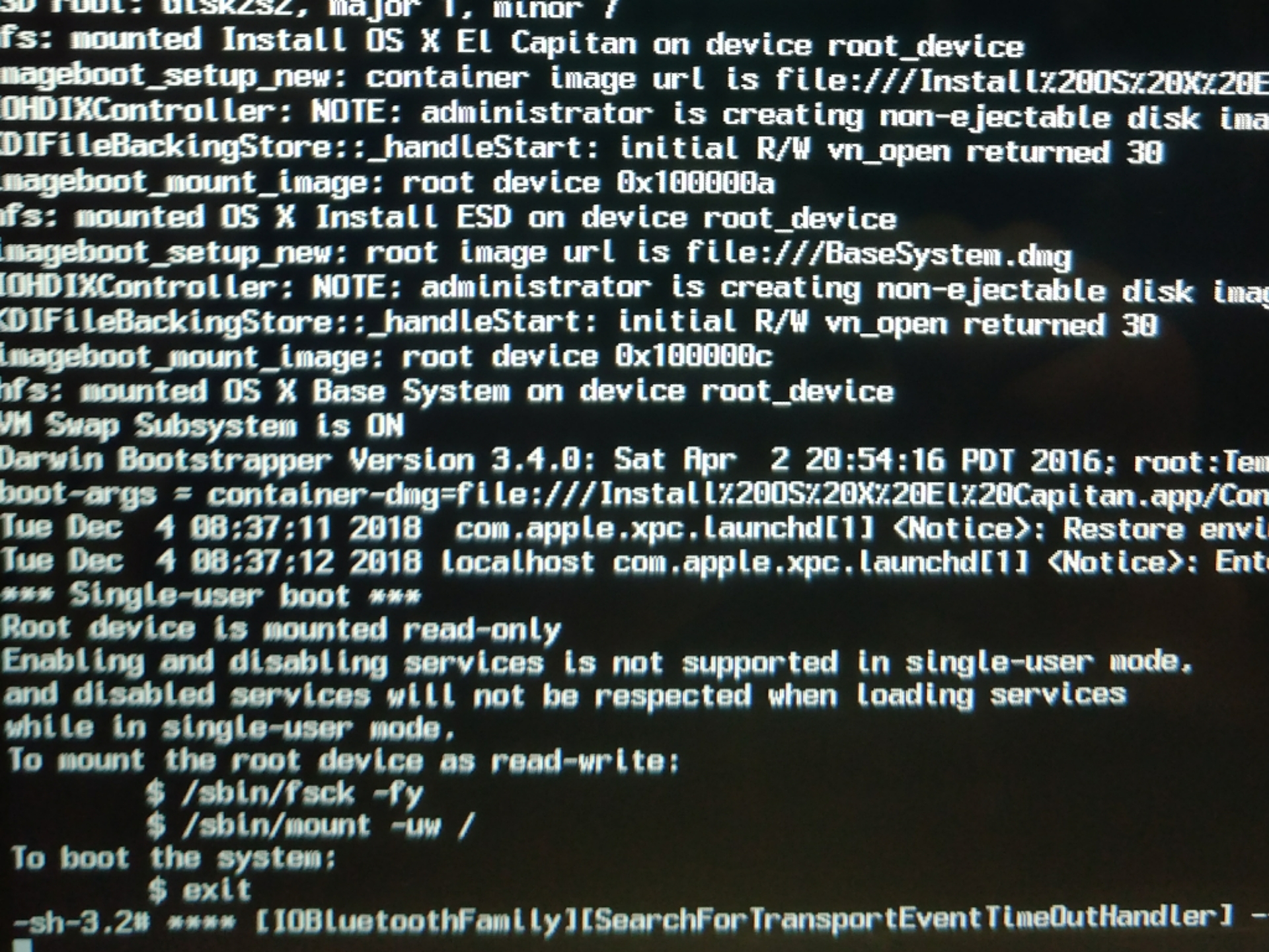

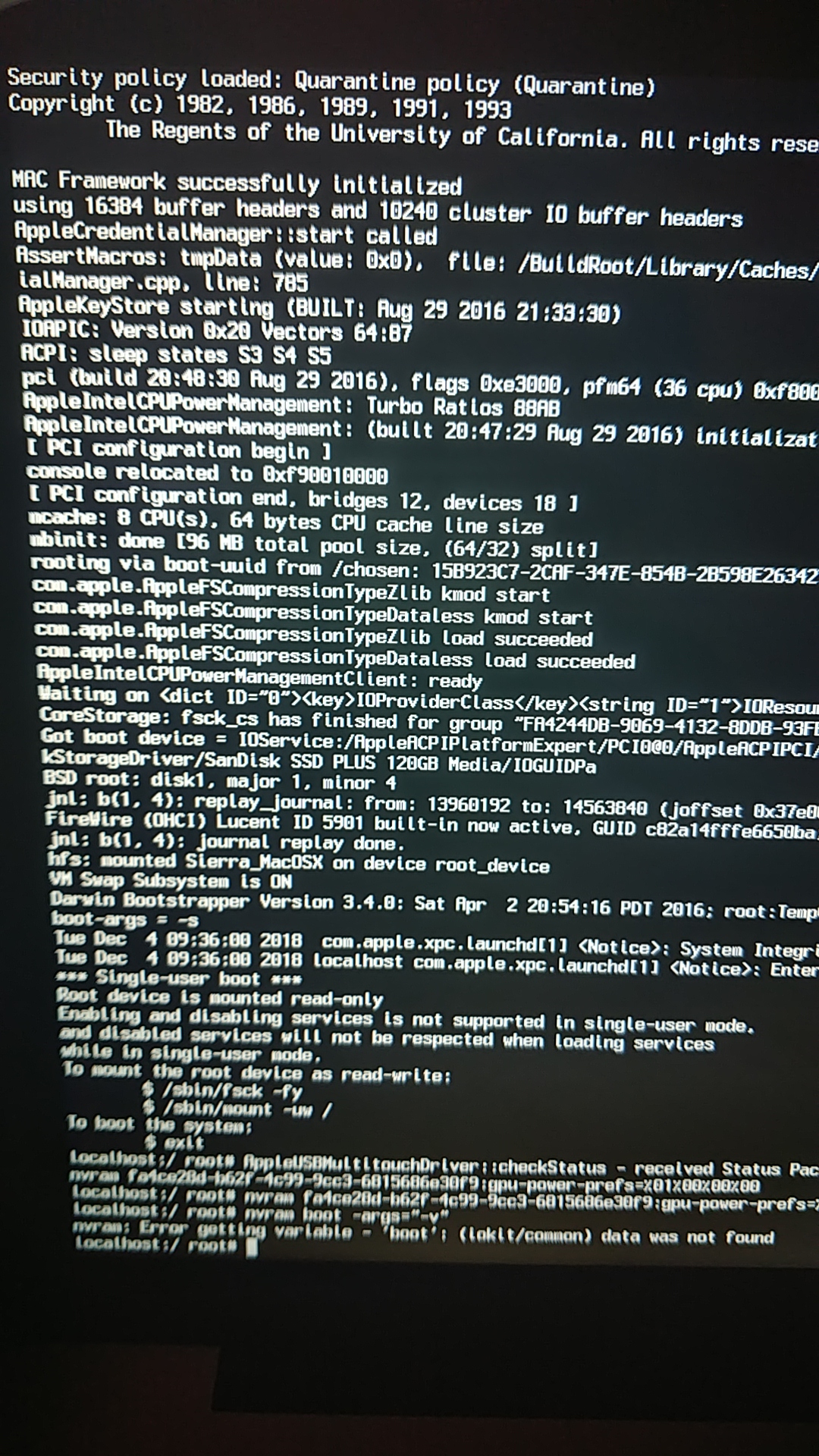

Hello, I try to fix my MacBook Pro I tried Archlinux Live USB when I reboot the process bar stops at 70% and I am not able to boot into OS and remove the kexts. 2nd I try to do the MikeyN fix but I cannot boot into recovery even after I installed the OSX. Only time I was able to boot into Recovery <Cmd>+<r>+<s> was after first using Archlinux Live USB in order to create a gpu-power-prefs and then try the MikeyN fix but even then I have no idea what to do in the environment I "post image" in order to complete the steps. please help me.
[doublepost=1543945484][/doublepost]
Also I get error when I do this on Single user mode.(picture no2)
