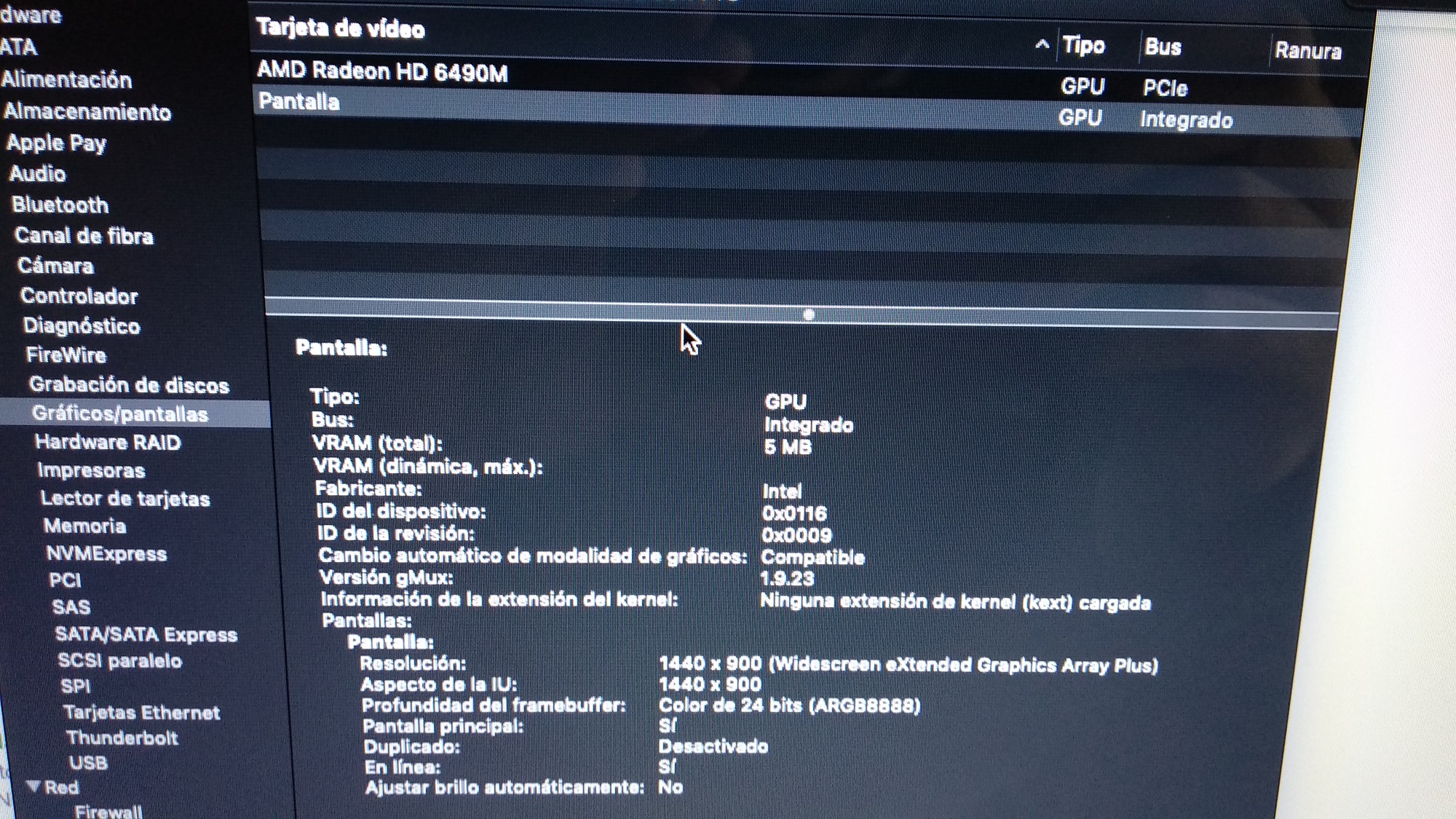

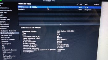

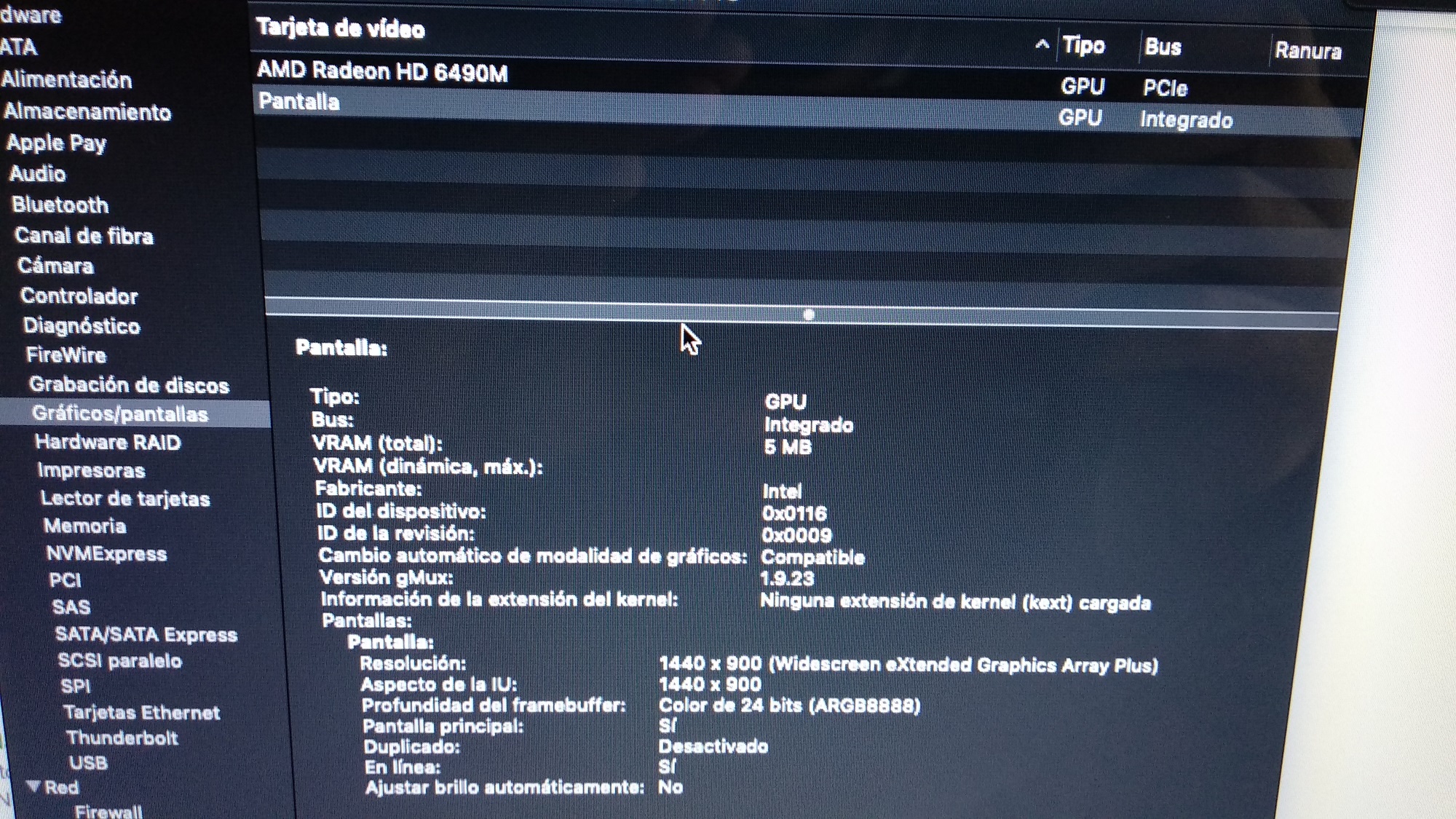

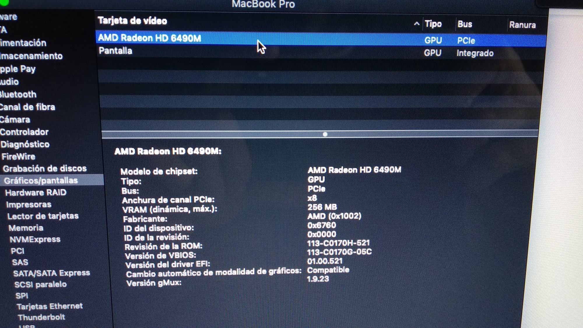

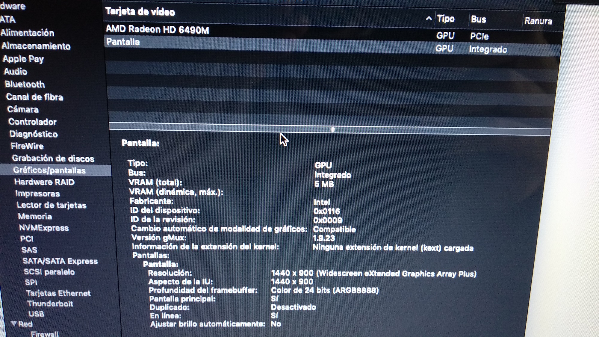

Hi.
I apologize for the delay, and as always, thanks for the help!
Yesterday I received an SSD, with which, I decided to start a new installation from 0.
Chosen the S.O. Mojave (being the most recent and I had before)

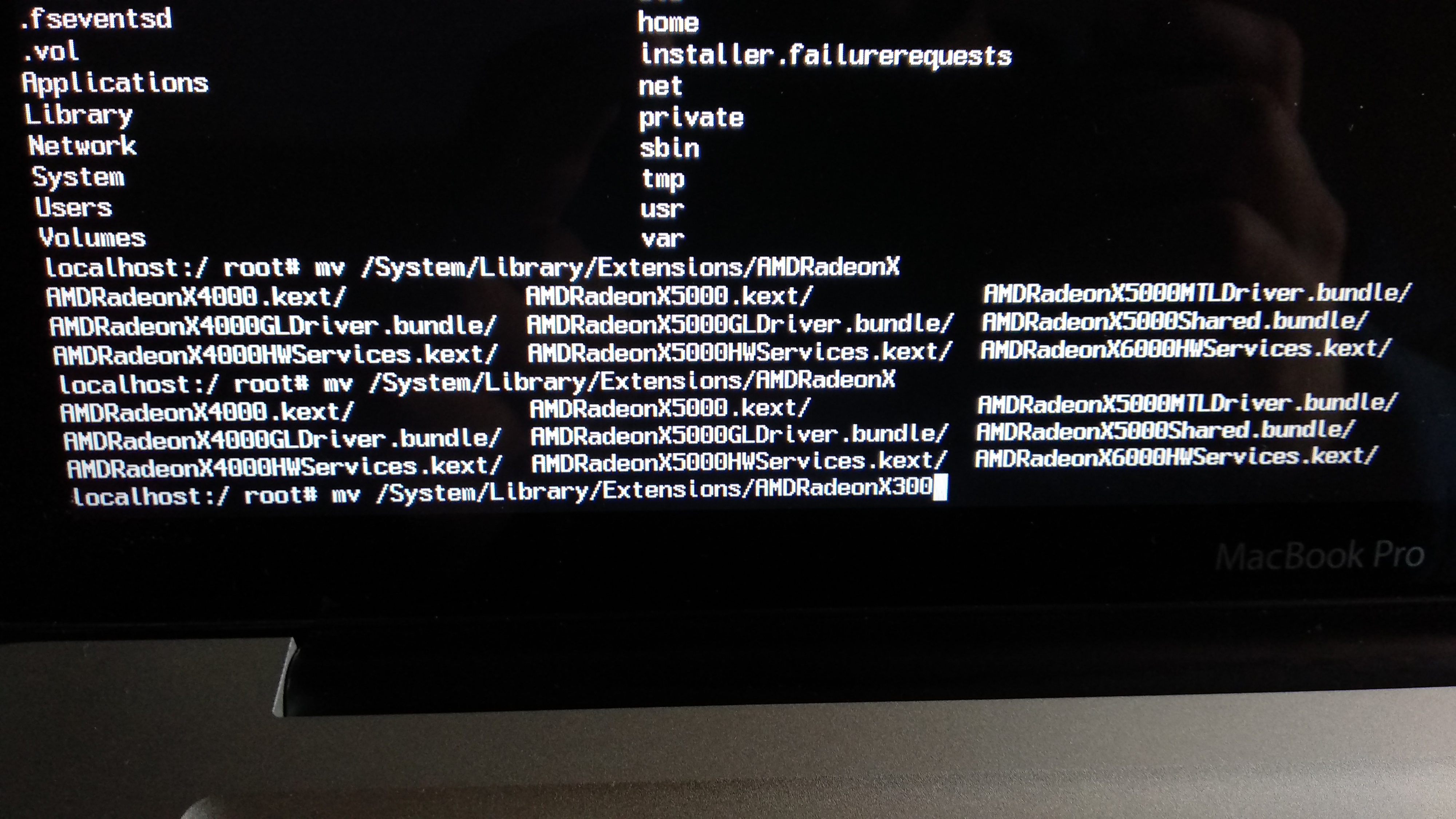

I do the "csrutil disable" process but in my case, I do not have the AMD kext3000.
How can I get it? It does not work for me to raise / lower brightness, nor does it suspend the system.
I do not know what to do to be able to do the whole Kext process, recover those functions and not overheat.
Thank you again. a greeting!

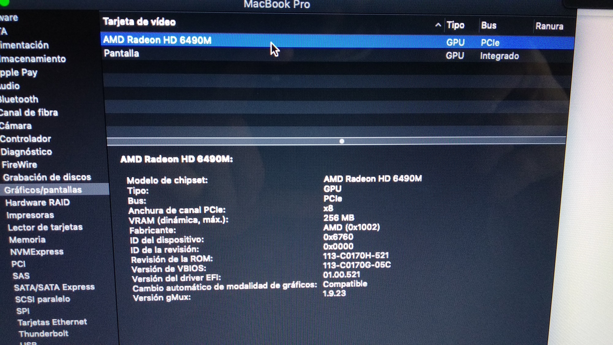

PD: I attach my photos
in fact, I do not know why I now detect the screen as an external monitor, it had never happened

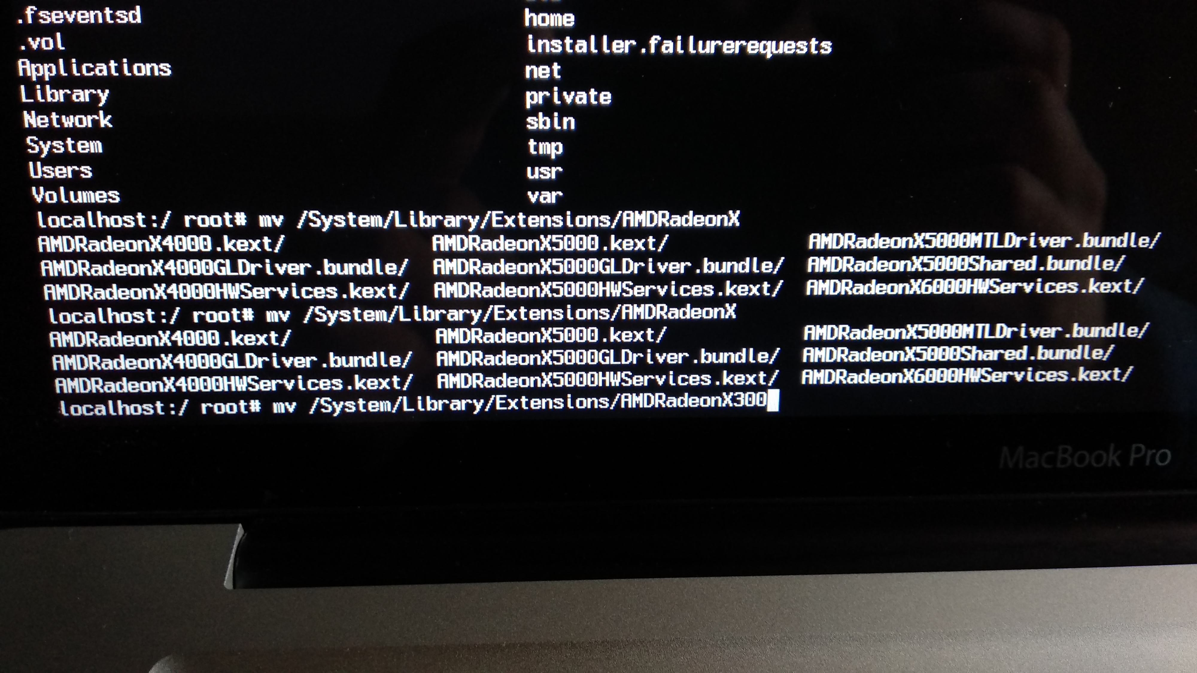

Or try the simplest way - No needed ArchLinux - Only MacOS:
1 - Boot Single User (press Command + S) at boot (If you have MacOS installed on your hard drive).
2 - If you have a blank HD, then use the USB stick/Pendrive with the MacOS installer (El Capitan, Sierra or HighSierra).
2.1 - Press Option key at boot, Position the mouse on the MacOS installer icon.
2.2 - Press Command + S and keep holding these two keys.
2.3 - Click the MacOS installer icon -> continue holding the Command + S keys until you finish the MacOS installer Single User boot .
Enter these commands (change gpu-power-prefs to Intel GPU and boot verbose):
Code:
nvram fa4ce28d-b62f-4c99-9cc3-6815686e30f9:gpu-power-prefs=%01%00%00%00
nvram boot-args="-v"
reboot

1) fsck -fy (to check a disk)
2) mount -uw / (mount a root filesystem with read/write permissions)
3) sudo mkdir /AMD_Kexts/ (make a directory to store the AMD drivers in case you'll need them in future)
4) sudo mv /System/Library/Extensions/AMD*.* /AMD_Kexts/ (move the AMD drivers)
5) sudo rm -rf /System/Library/Caches/com.apple.kext.caches/ (remove the AMD drivers cache)
6) sudo mkdir /System/Library/Caches/com.apple.kext.caches/ (just in case OS X will be dumb and will not recreate this directory, I am creating it for OS X)
7) sudo touch /System/Library/Extensions/ (to update the timestamps so that new driver caches - without AMD drivers - will be definitely rebuilt)
8) sudo umount / (umount a partition to guarantee that your changes are flushed to it)
9) sudo reboot

Follow the MikeyN Guide - page 35 - #875 - to move the AMDRadeonX3000.kext from the /System/Library/Extensions directory and do not freeze Macbook Pro (at 75% progress bar or "IOConsoleUsers: gIOScreenLockState 3" message).
Rename old AMDRadeonX3000.kext and move new AMDRadeonX3000.kext after update - Page 57 - #1425
Shutdown or Restart Macbook Pro - avoid black screen freeze - Update 2 - Page 57 - #1425
Close the Lid - Sleep - Waking - Page 43 #1066 - Page 50 #1243

Thanks again everyone! I think mine is fixed now. After booting from single user mode and applying the nvram patch, I downloaded a High Sierra Installer and made a small bootable partition. I then restarted in single user, reapplied the patch, then rebooted directly from single user holding down Option, then selected the Installer as boot drive. Once loaded, I could access terminal tool and disable SIP. Then I went back, rebooted in single user and applied all the patches.
There is one piece of the puzzle I'm still not clear on.
I followed the advice of user MikeyN Force 2011 MacBook Pro 8,2 with failed AMD GPU to ALWAYS use Intel integrated GPU (EFI variable fix)
and created a LoginHook to reload the AMD3000X kext after login, but I'm not sure if this is necessary or not. (Or even advisable?) Does this now mean that applications can invoke the dGPU - leading to a failure? Is it better to not reload the AMD3000X kext after boot?
Regardless, the system appears stable, and I can now reboot if needed too! Cheers! What an amazing solution and community! 🙂

=== 100% WORKING SOLUTION
=== Force your MBP to ALWAYS use Intel integrated GPU (EFI variable fix)
=== to make it great again ! 😉
Code:
reboot
