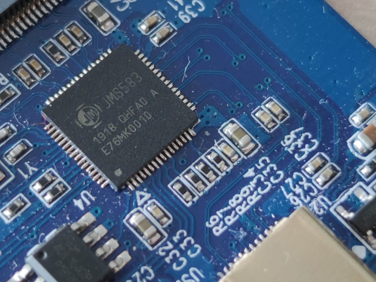

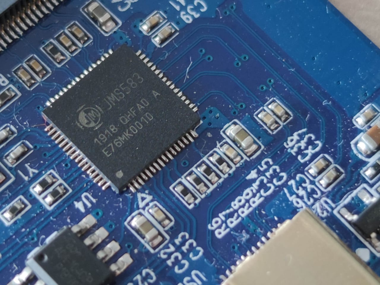

They are mostly capacitors and 1/2 resistors
Thanks for the information..got two questions: )...so do you think that model of adapter is safer then the popular one that most of the people using atm...and is it possible The capacitors or resistors which coded such as c1 c2 c3 ..are about sleep comment/signal ?
[/QUOTE]
A1708 model doesnt have issue with sleep, but it has issue with power management when using NVME, and those capacitors and resistors might actually help.
here's sample from my NVME to USB C board, and those resistors capacitors are common thing to be found WhatsApp Image 2020-10-20 at 11.18.44.jpeg
here's sample from my NVME to USB C board, and those resistors capacitors are common thing to be foundView attachment 969546

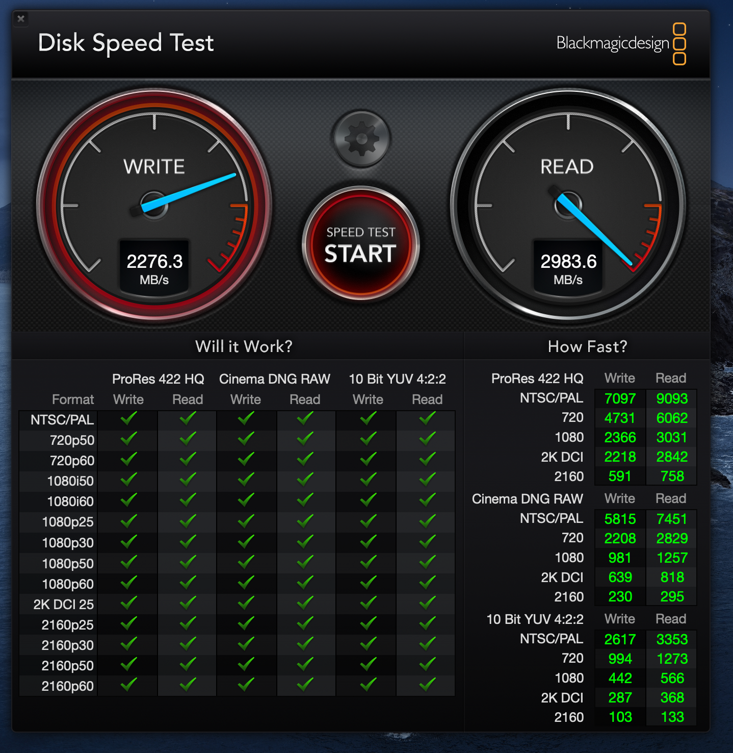

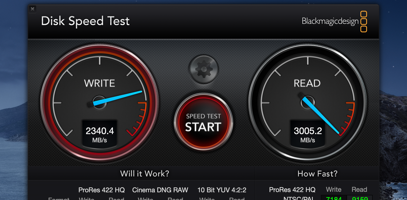

Hallo people. I got a couple NFHK adapters from aliexpress, the one with over 500 orders already. Then I had here a couple samsung 970 EVO NOT PLUS, just the good old regular 970 evo, period, no plus version...
Got over 3000mb/s in read sometimes, and in write 2300mb/s
The problem: it doesnt stand flat when the cover is re installed... shame... Gonna have to get one of those Sabrent little ssd cards, right? unless you guys stuur me to another model, let me know, thanks!!!
