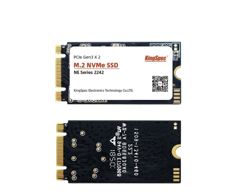

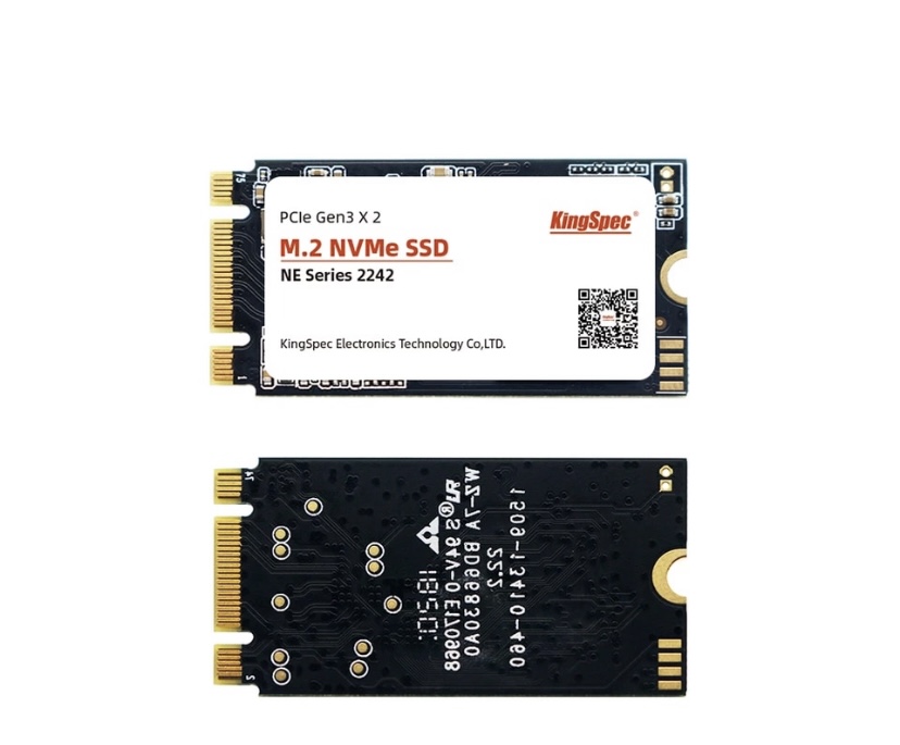

View attachment 961187 Good evening, I'm new in the forum, congratulations on the discussion... Do you think this ssd can be good for the NFHK adapter? Thank you in advance
It will work. Although you need to be careful with kingspec, some of it shipped with a chipstar controller who tend to die without any warning. Better get SN520 from WD or use long SSD instead.
