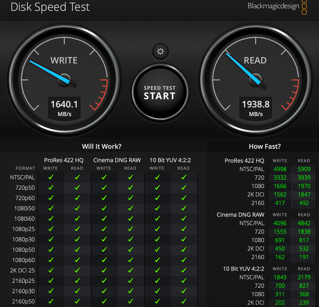

Hello. So after a while, i decided to share my impressions with you. I have a Macbook Pro 2017 an decided to give the NVMe M.2 NGFF SSD Adapter from ebay
a try and i also ordered the Sabrent rocket 1 TB 2242 SSD. Waiting for the Adapter, i watched the video at the beginning of this thread and was prepared to install the new SSD. After doing this, i recognized a wobbling backcover. It maked a knocking noise when lifting it up with my hands on the backcover. The reason was the strip that covers the battery connection. I hadn't fixed it right back so it didn't stop the pressure on the backcover when you lift it up and so the noise was created. After putting it right back over the battery connection it doesn't make the noise anymore.
After starting the Macbook, i could install MacOS with an USB-Installer.
1. First formated the new SSD as journald-Format, so the SSD was recognized as a install Partition.
2. After installing, everything went fine. But the writing speed was not better then the original apple SSD (about 600 mb/s) but after indexing and let the Macbook "work" with the new files, the speed is now about 1500 mb/s, so everything is fine.
But i have recognized a hughe battery drain (around 1,25 % per hour when the lid is closed). I have read a lot through the diffrent forums an learned, that it has to do something with the power management. I have tried a lot of commands putting them into the terminal but nothing helped.
Now, after still reading this thread i have used the command from #119 in this thread (thx to Darktidor).
sudo pmset -b sleep 10 disksleep 5 hibernatemode 25 autopoweroff 0 standbydelaylow 300 standbydelayhigh 300
After restarting my Macbook and doing a SMC reset, now the Macbook lost about 2% over night when the lid is closed. It has to do something with the hibernatemode 25. The Macbook need some seconds more to wake up because of the "extrem" hibernatemode, but is ok and tolerable because of the better battery standby-time.
I hope i could help some people out there and after all i can said, that the SSD upgrade was successfully installed.

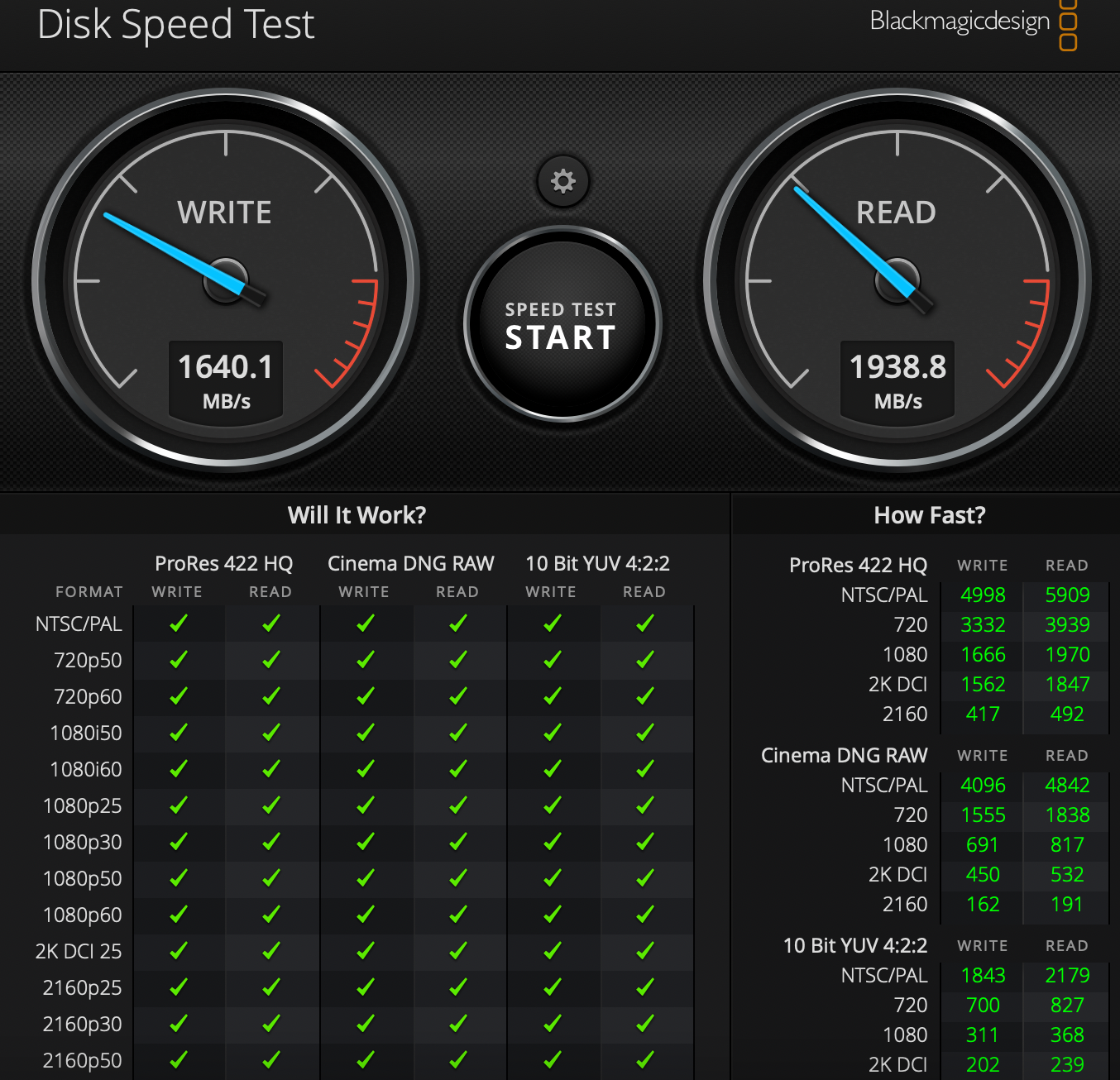

Only thing thats not working out of the box was the hibernate problem which was fixed with the command before and the smc reset.
