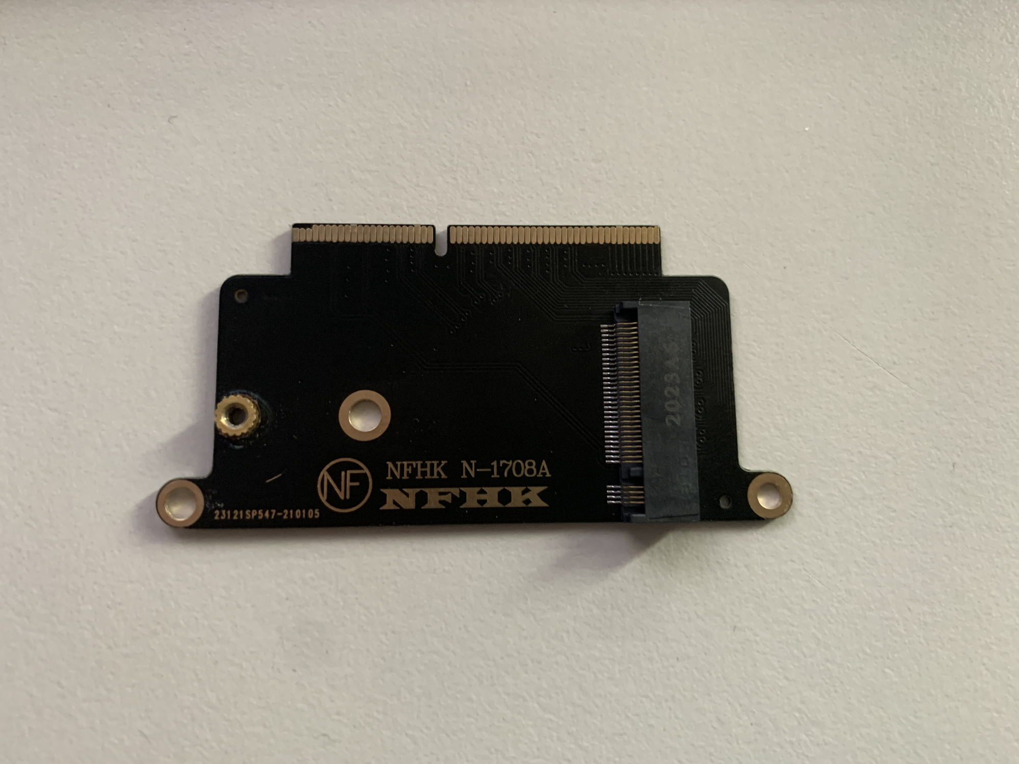

I installed Bootcamp + Windows 10 on the Hynix and sleep when running Windows works properly.
My guess is that either the Hynix BC511 or the NFHK adaptor is not 100% compatible with the 2016 Macbook Pro. I've read elsewhere that some original Apple SSDs are only compatible with 2017 Macbook Pro models.

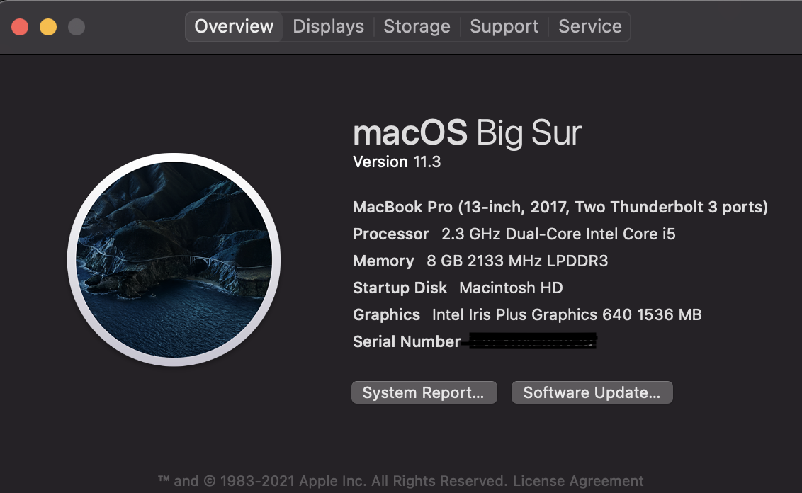

Hi guys, after struggling with all the trial, i've finally made it running smoothly and solve the ac plug start issue.
here's the update for you guys,

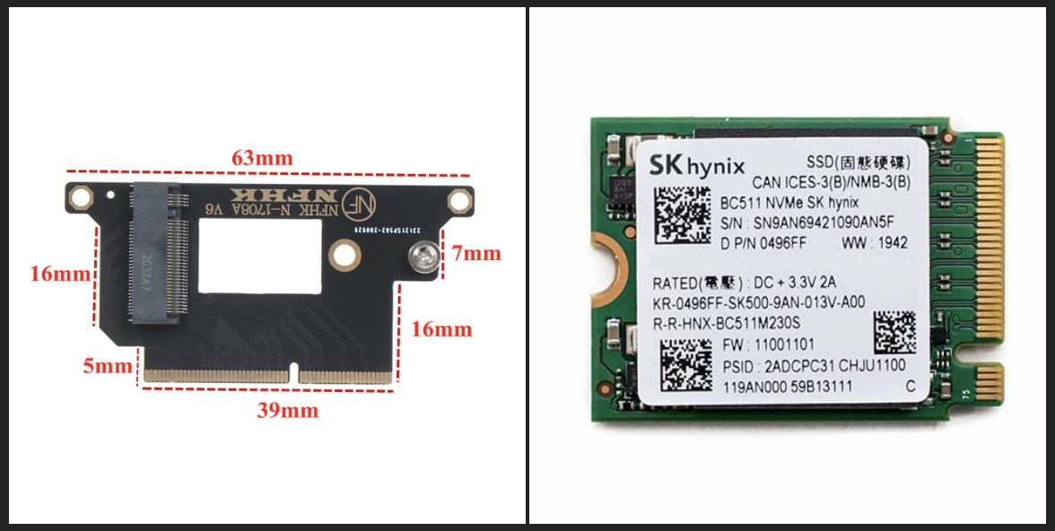

1. Adaptor: NFHK, V6
2. SSD: Hynix BC511 PCIe Nvme 2230, 512gb
3. Model: Macbook Pro 13" A1708,256gb None touch bar 2017
4. Boot rom (system firmware version: 429.80.1.0.0
Originally i was using the WD, SN530 PCIe Nvme 2230, 512gb. installed and back up under the previous Mac OS, Big Sur 11.2.3 20D91 ver. (Nvmefix.kext was also installed under the path ~/library/extensions)

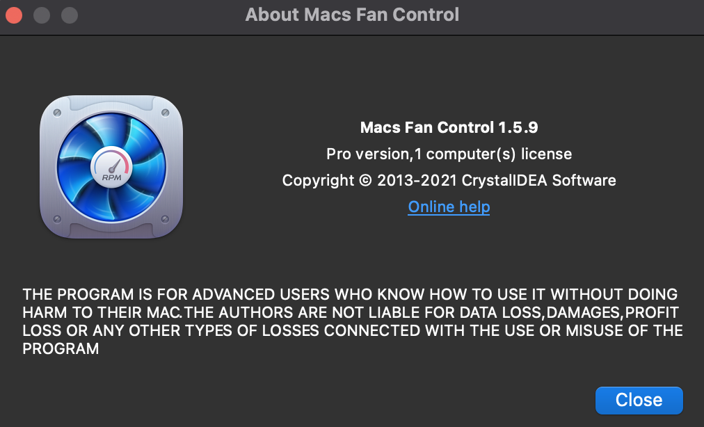

i've also installed the SMC fan control, any of them seems working okie at least you can custom control the fan speed.

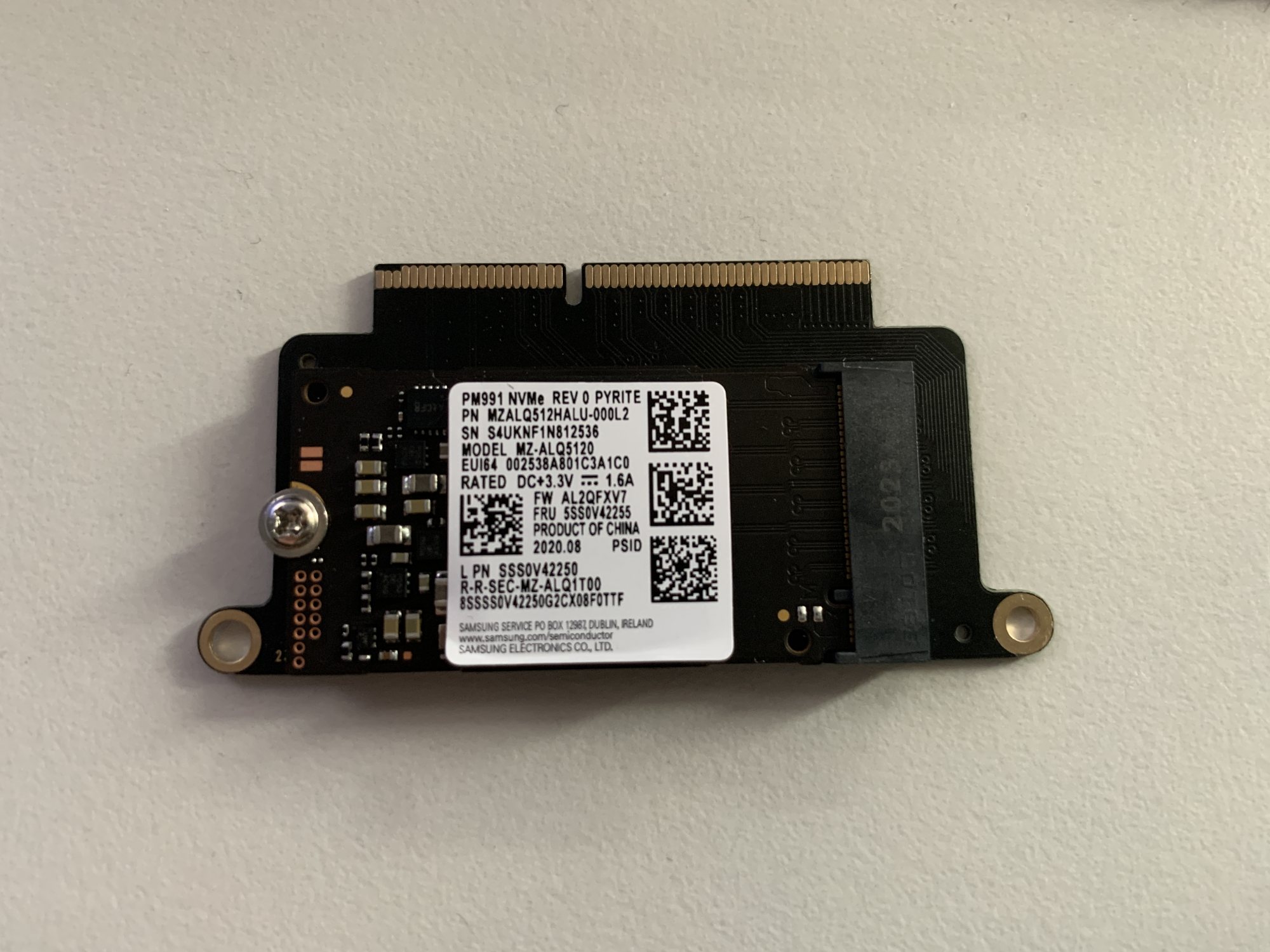

To enhance more about the stability and 100% replaceable SSD upgrade, i purchased the Hynix BC551 PCIe Nvme 2230 512gb SSD. same steps, time machine back up the the updated Mac OS Big Sur 11.3, installed the SSD.
run the installation a brand new Mac OS Big Sur 11.3, then using the Migration assistant to replace back all the data.
it's working like charm. no AC/cord plugin start up issue, heating issue is also acceptable, running with around 35-45 °C

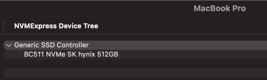

but one thing i notice, what does the trick is the Phison controller, during the brand new OS installation, it popped out the "Phison driver"(assuming it's the SSD controller to interact with Mac SMC) installation window (which is not happening on the previous SSD installation, assuming the WD, SN530 is using the incompatible controller to what Mac can recognize)
what i notice, is that the "NVMexperess Device Tree" appears "Generic SSD Controller, which didn't appear on the previous WD, SN530 SSD. This Generric SSD Controller can be high percentage related to "Phison driver"
i'm a daily user, not IT, so this is just to save some buck and enjoy the upgrade process.

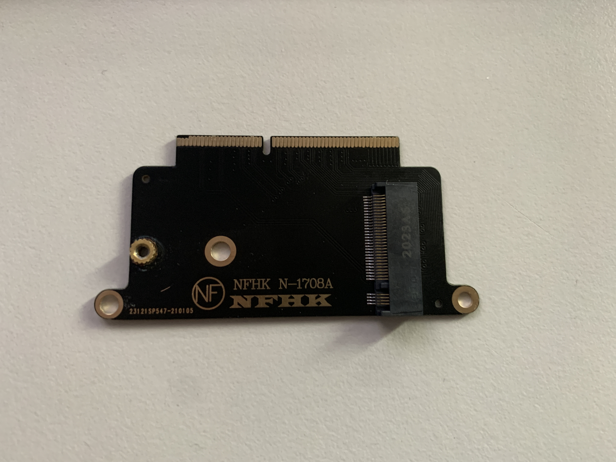

So now my setup is: NFHK Adapter (V6, with cutouts) and Netac SSD. And it works much better than sabrent, even tho its x2, not x4. Writing/reading speed is about 1450/1700, no heating (feels like even less than with original Apple SSD), sleep issue was solved with terminal command mentioned here.

I ordered another adapter - that one with resistors. Maybe it will help.

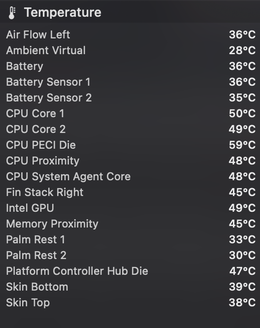

after 2 days trials, working with the computer after 100% full battery life, i experienced around estimated 5hrs operating time, including downloading, mails, using chrome for web browsing, messaging and etc. it will have around 20% battery left.
operating temperature is good, fan is not over exhausting (installed the Macs Fan control using with automatic) can refer the attached files for the working temp°. although SsdPmEnabler not showing A1708 is compatible, but it proves that it's working fine and have no issue with Big Sur 11.3

i didn't have the change to try the adapter with capacitors on it, perhaps it's more stable with PM controlling.

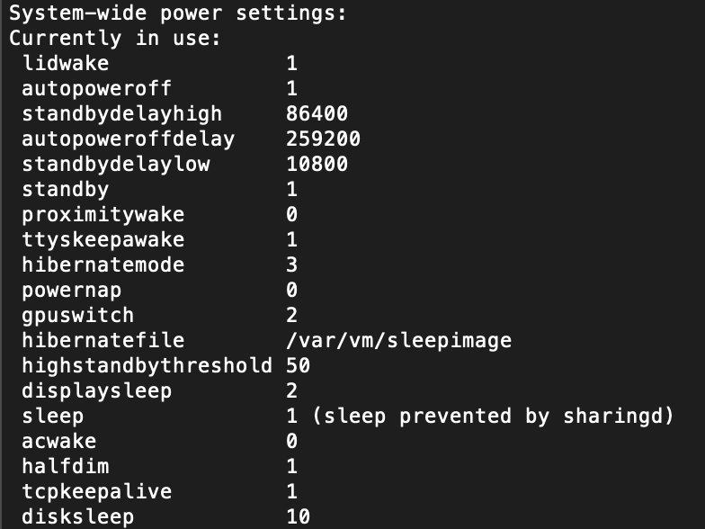

The Mac is having hibernation issues but still going back to sleep afterwards
I am using those settings :
Rich (BB code):
Battery Power:
 lidwake              1
 autopoweroff         1
 standbydelayhigh     86400
 autopoweroffdelay    259200
 standbydelaylow      10800
 standby              1
 proximitywake        0
 ttyskeepawake        1
 hibernatemode        3
 gpuswitch            2
 powernap             0
 hibernatefile        /var/vm/sleepimage
 highstandbythreshold 50
 displaysleep         2
 sleep                1
 acwake               0
 halfdim              1
 tcpkeepalive         1
 lessbright           0
 disksleep            10
AC Power:
 lidwake              1
 autopoweroff         1
 autopoweroffdelay    28800
 proximitywake        1
 standby              1
 standbydelaylow      0
 ttyskeepawake        1
 hibernatemode        3
 powernap             1
 gpuswitch            2
 womp                 1
 displaysleep         0
 networkoversleep     0
 sleep                0
 tcpkeepalive         1
 halfdim              1
 acwake               0
 disksleep            0
Reactions: Jabo
Rich (BB code):
Battery Power:
lidwake              1
autopoweroff         1
standby              1
proximitywake        0
ttyskeepawake        1
hibernatemode        3
gpuswitch            2
powernap             0
displaysleep         2
sleep                1
acwake               0
halfdim              1
tcpkeepalive         1
lessbright           0
disksleep            10
AC Power:
lidwake              1
autopoweroff         1
proximitywake        1
standby              1
standbydelaylow      0
ttyskeepawake        1
hibernatemode        3
powernap             1
gpuswitch            2
womp                 1
displaysleep         0
networkoversleep     0
sleep                0
tcpkeepalive         1
halfdim              1
acwake               0
disksleep            0

here's my "pmset due status", finding no hibernate error and sleeping issue.
nvmefix.kext, SsdPmEnabler.kext really does the job.
I don't have these HibernateError messages. "pmset -g log" doesn't have any errors which must be good.

Here's my pmset:
Currently in use:
lidwake 0
autopoweroff 1
standbydelayhigh 1
standbydelaylow 1
standby 0
proximitywake 0
ttyskeepawake 0
hibernatemode 25
gpuswitch 2
powernap 0
displaysleep 2
sleep 0
acwake 0
halfdim 1
tcpkeepalive 1
disksleep 0

As many of you have concluded, the NFHK and the SK Hynix 2230 is the best working solution (if I haven't misunderstood), however the Hynix is very rare and difficult to find. When finding (Amazon, eBay etc) the price is very high let alone the SSD is pre-owned/used and all of a sudden this solution is not as cost-effective.
My question would be: has anyone tried any other SSD with the NFHK?
Is there any other SSD that you'd recommend? I'm looking for 2242 with DRAM for better heat dissipation and speeds!
Appreciate your input!
Hi guys,
Thank you all for your valuable input in regard to the upgrade matter.
Hi , SK Hynix is rare for sure, for the others, you might need to find whether the controller is compatible with Mac.
as i noticed earlier, Phison controller is compatible with A1708, so perhaps if the SSD is running with Phison controller, it might not having AC cord plugin start up issue, and hibernate issue.

Hello!
This is my first post on the forum. I bought used MacBook Pro 13' 128 GB about a year ago. I thought that 128 GB will be plenty for college work, but oh boy I was wrong. I have 20 GB left and I'm planning to replace my SSD.
I read that whole thread, and made purchases.
Adaptor: NFHK
SSD: SK Hynix BC511, 2230, 512 GB.
I still have some questions (they might be stupid because I know next to nothing about IT).
Can I replace the drive without making a bootable MacOS image? I saw on one of YT videos that a guy simply reinstalled MacOS from internet during setup after replacing the drive. Is it okay? It seemed the simplest to me.
So my plan of action looks like this:
- Copy all my files from Mac to external HDD drive
- Open up my Mac, disconnect the battery and remove SSD
- Mount new SSD
- Close up everything
- Boot up Mac
- Open Disc Utility from menu, erase the new SSD
- Click Reinstall MacOS, and proceed the installation
- Move all copied files back onto Mac
Am I thinking right?
Cheers!
BTW I'm on Big Sur 11.3.1
well if all the Ssd data are important you should use the time machine to back up, mine is for business purpose so i use the time machine to back up some use the carbon copy the entire ssd into the new one, for more secure issue, time machine is still the best choice.
i use the USB bootable disk to boot up and run the disk utility then use the back up restore from time machine to restore all. else u can just install the brand new OS then run the migration assistant to migrate back from your time machine backup
both way are workable for me i am using it daily no issues.
installing directly from internet is also fine theologically but it takes much longer time consuming then installing the new OS.
since u have already taken part worth trying ur own method. Good luck
Thanks for the response!
And to be completely clear, If something goes wrong I can always pop out that new SSD, insert old one, and everything will be up and running right?
yes indeed as long as you don't format the original one,
That’s great. I’m waiting for the adaptor.
If anything goes wrong, I’m willing to sell that “rare” Hynix 512GB SSD. That was a bargain, I paid around 60 bucks for it, when Sabrent one would cost me 95!
