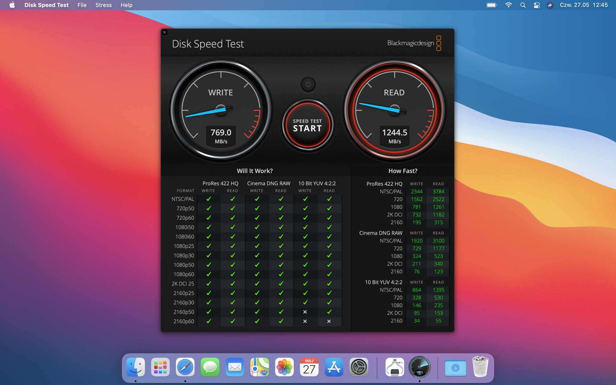

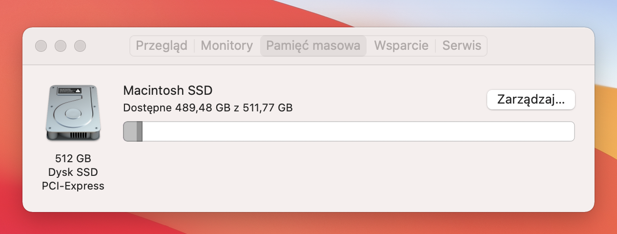

Hello!
I received an adaptor today's morning and installed the SSD.
When it comes to replacement itself, the hardest thing for me was removing lower case. I just couldn't figure out how much force I have to apply to remove it. When it came off, everything went smooth as butter: NFHK adaptor with BC511 in 2242 size fits perfectly.
I erased the drive and installed fresh Big Sur on it. Everything went just fine. There is no problem with sleep/wake. No problem with booting up with AC cord in aswell. I attach some screenshots.
If you have any questions, feel free to ask me, just remember I'm no IT guy myself :D
Will be back in a week to share info about battery life.
Cheers!

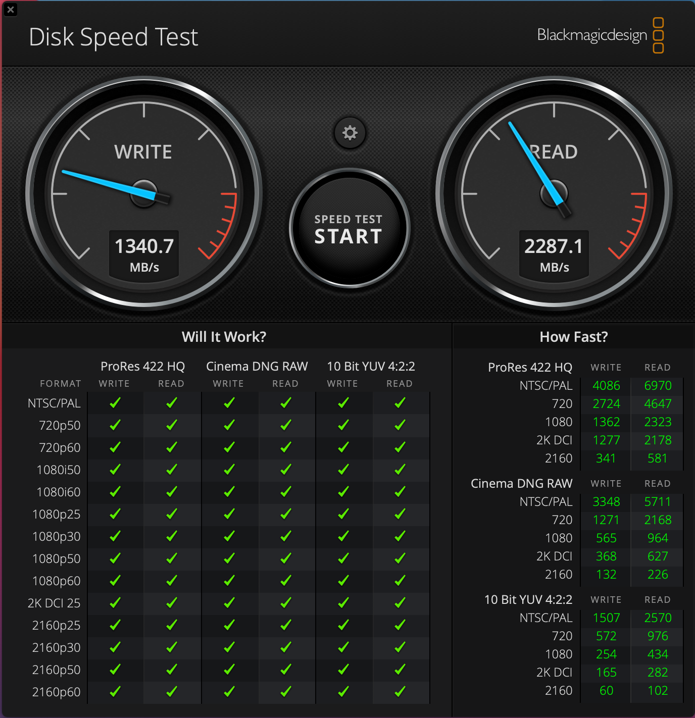

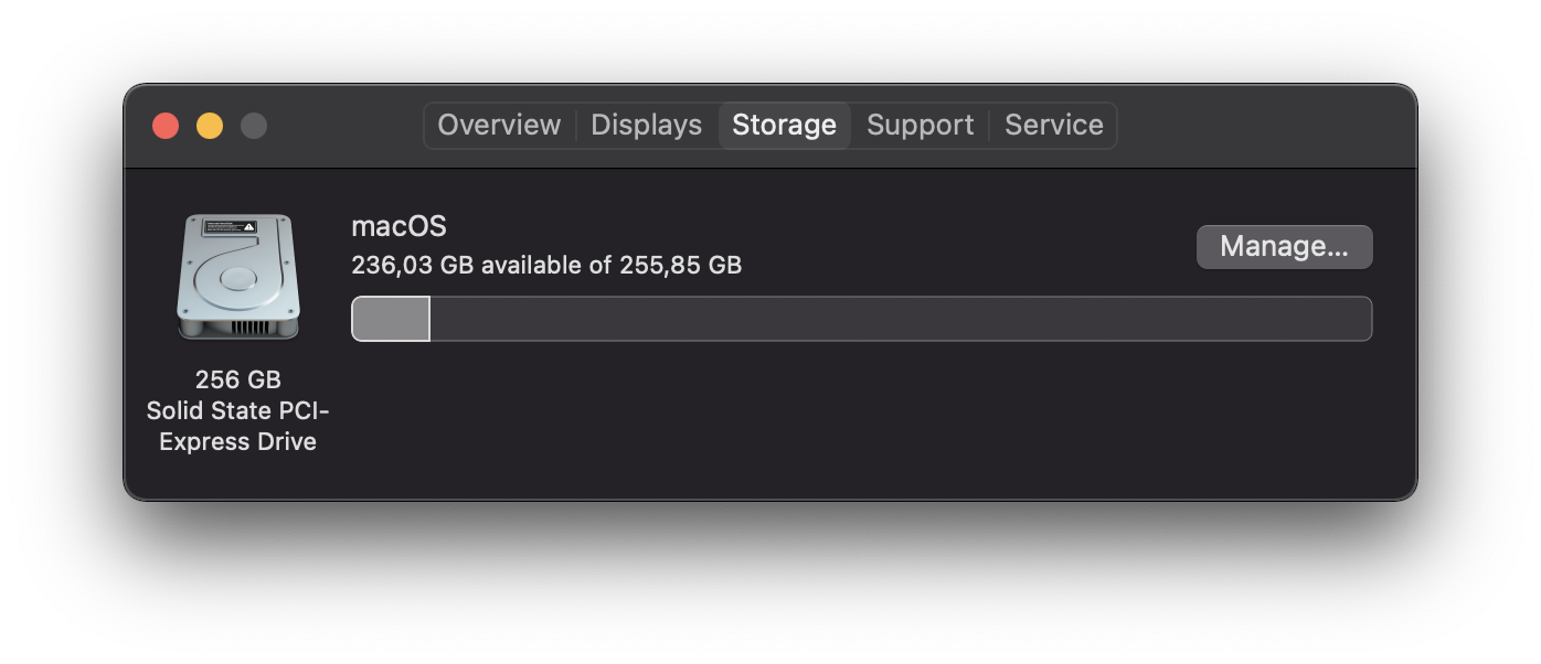

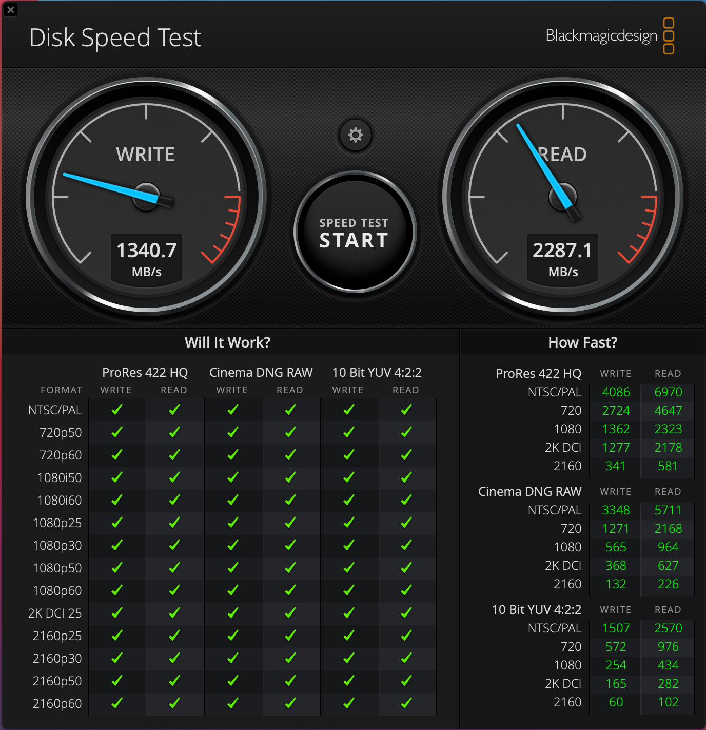

Hi guys! I'm new to the forums.
I just wanted to share my experience with you.
So I'm using NFHK adaptor (v5 printed on the board), and a SK hynix BC511 NVMe M.2 256GB 2242 PCIe Gen3.
Everything went great on installing, I formatted the drive and fresh installed Big Sur.
I'm not experiencing any problems, slight slower reading time but faster writing, I feel the Mac is more responsive.
I have no hibernation errors (using the terminal command) and no power cord errors. Running smoothly without any hassle.
I can't confirm about battery drain because my battery was already not that good and I use my Mac plugged almost 99.9% of the time.
Thanks for all the info shared on this topic.

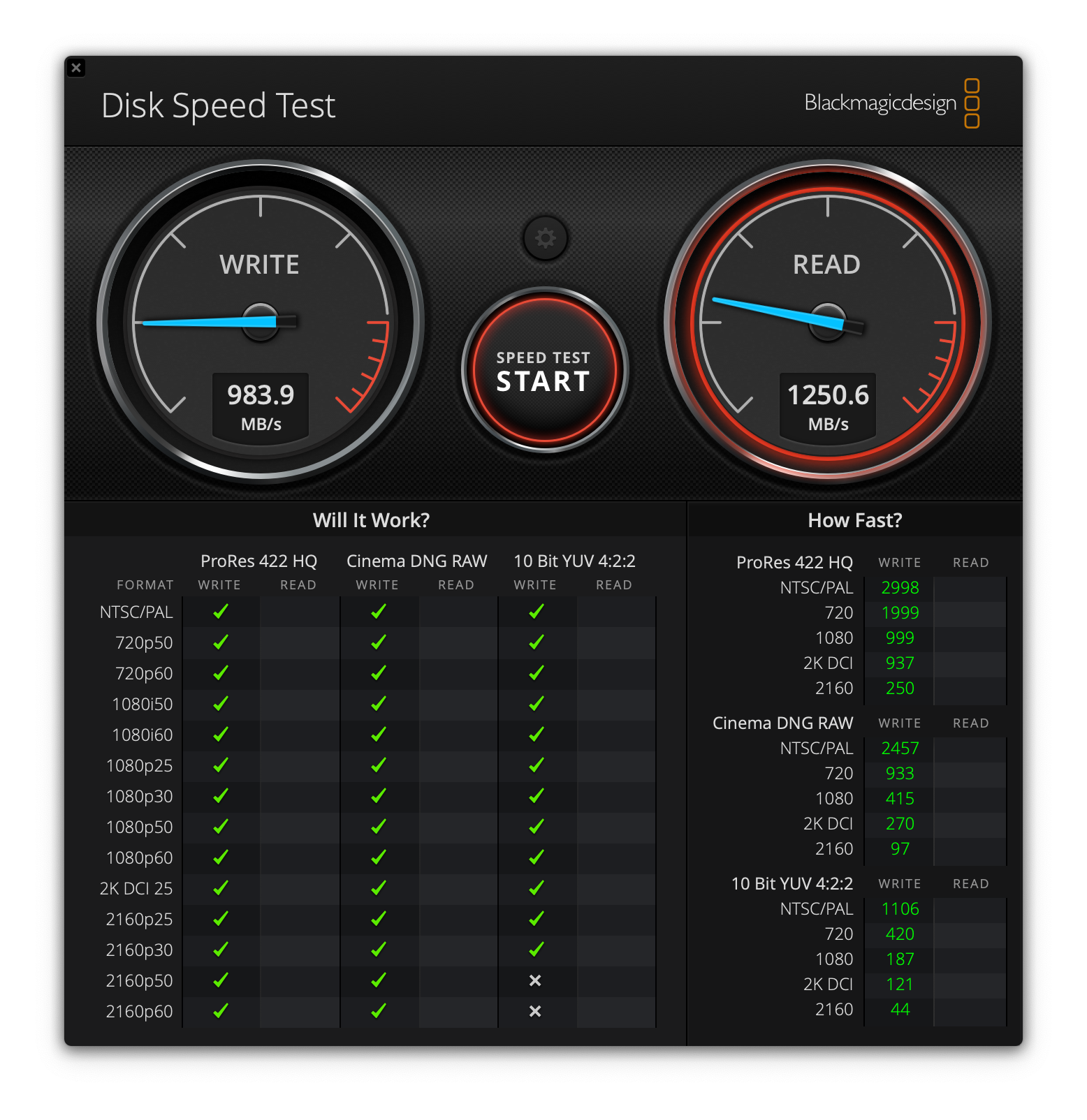

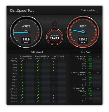

Hi guys,
I thought I'd give you a quick update.
I have now tried the following: https://beetstech.com/product/macbook-pro-13-inch-a1708-ssd-replacement-kit
I have also attached a print screen from Blackmagic where I've tested the r/w speeds. I can confirm that this solution, even though a bit more expensive than the ones provided here, is the best!
No issues with hibernation/sleep modes, no issues with having it plugged in, no ?-ssd related problems. All is working fine.
I'd highly recommend this method/ssd upgrade kit.
