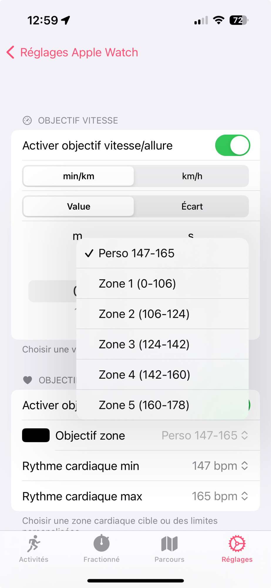

You can see the values when setting up a target:

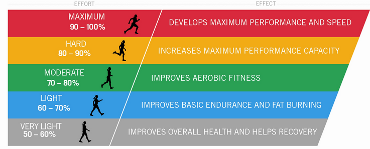

I should have been more precise. In screen configuration for the watch, there is an option to choose "Heart Zones" which has blocks per zone.. How are heart zones mapped to actual heart rate ?
It's not customizable (except max heart rate).
Zones are set according the most common definition:
