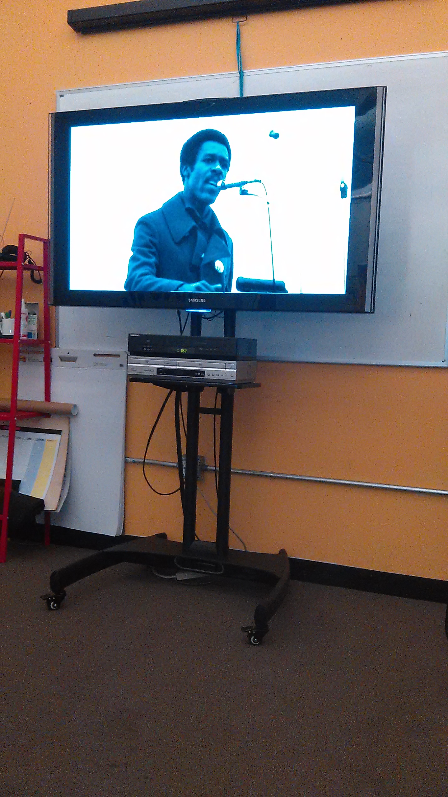

I have a Mac Pro 1,1 that I'm setting up for a non profit organizations. I'm using a Nvidia GT 240 1024 mb with 10.10.5 installed plus the updates, and all working fine, except for having a problem installing Nvidia Web Drivers.
Thanks for any help with this problem
Chuck
The built-in drivers are probably better for your scenario. Using the web drivers would be an ongoing maintenance issue for the non-profit you want to give this computer to.
Cool! Nice to know. It appears to be working fine. I'm adding this to a 52" Samsung TV and roll around stand and mount MP to the base of the wheels. That will make everything self contaned, Show their videos, Websites and PowerPoint presentations
cool to see some one helping a non profit ^^ you may be able to get audio via hdmi if you want https://forums.macrumors.com/threads/guide-hdmi-audio.1499797/
not shore if your card supports it but if it dose it can be handy
Thank you, Thank you, Thank you, so much orph, this is what I wanted to use, but I would not get any audio from HDMI, so I was having to go with VGA and the audio plug. The Samsung TV would shut down so fast if it did not pick-up the signal during boot up. The TV I pick-up for $25 plus taxes and the capacitors for $13 and I made the repairs. The TV stand I pick-up for $120 at Fry's
Chuck
If the 1,1 doesn't already have WiFi, that would be a nice and cheap feature to add so it can be a mobile streaming platform. Non-profits and government entities post a lot of their informational and educational content to YouTube these days for easy access and consumption. Internal 802.11n cards (i.e. The Apple OEM cards) that fit the motherboard mPCIE slot are dirt cheap these days.
I was fortunate enough this Mac Pro has both Wi-Fi and Bluetooth. I did not want to use cat5, plus a wire Mouse / Keyboard. The easier the better. I have an old Mac Bluetooth Keyboard to add to it
