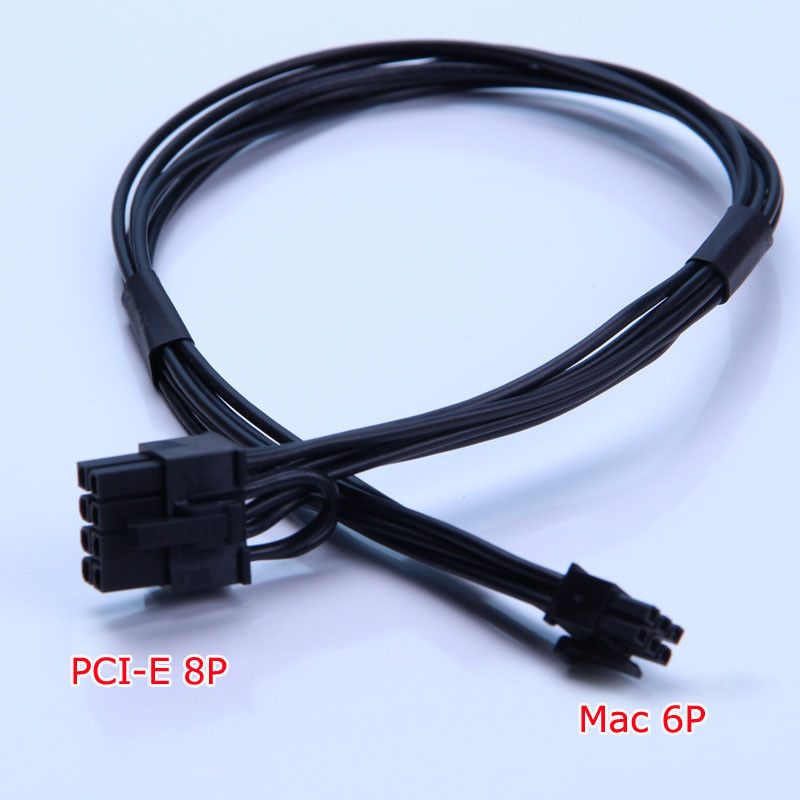

Hello! Help me please. I have mac pro 5.1 mid 2010, in stock (2x2.93/Radeon5770). I need change video card on 1080ti Asus STRIX. If i use 2x this cable, this don't have trouble for power or...? THX!!!

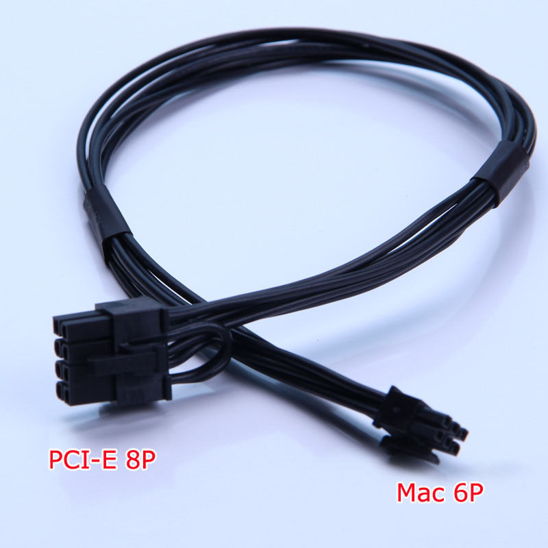

Most likely it will trigger the self shutdown protection if you use this cable for a STRIX 1080Ti.
How to connect, which cable should I use?
ASUS ROG Strix 1080Ti shows as having 2x 8-pin connectors, so use:
- 2x Mini 6-pin to PCI 6-pin connector cable
- 1x dual 6-pin to PCI 8-pin connector cable
- 2x SATA to PCI 6-pin connector cable
Take SATA power from HDD bays 3 & 4. You may need to break some plastic off the SATA plug to fit the Mac Pro plug as they often have tabs that foul the SATA data connector on the logic board.
This should cover you; it's how I power my 980 Ti.
