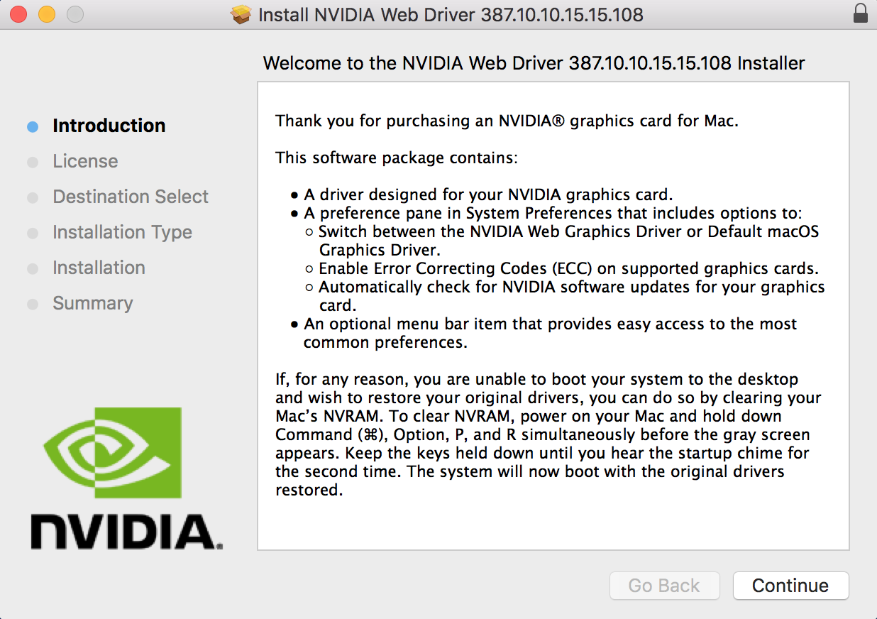

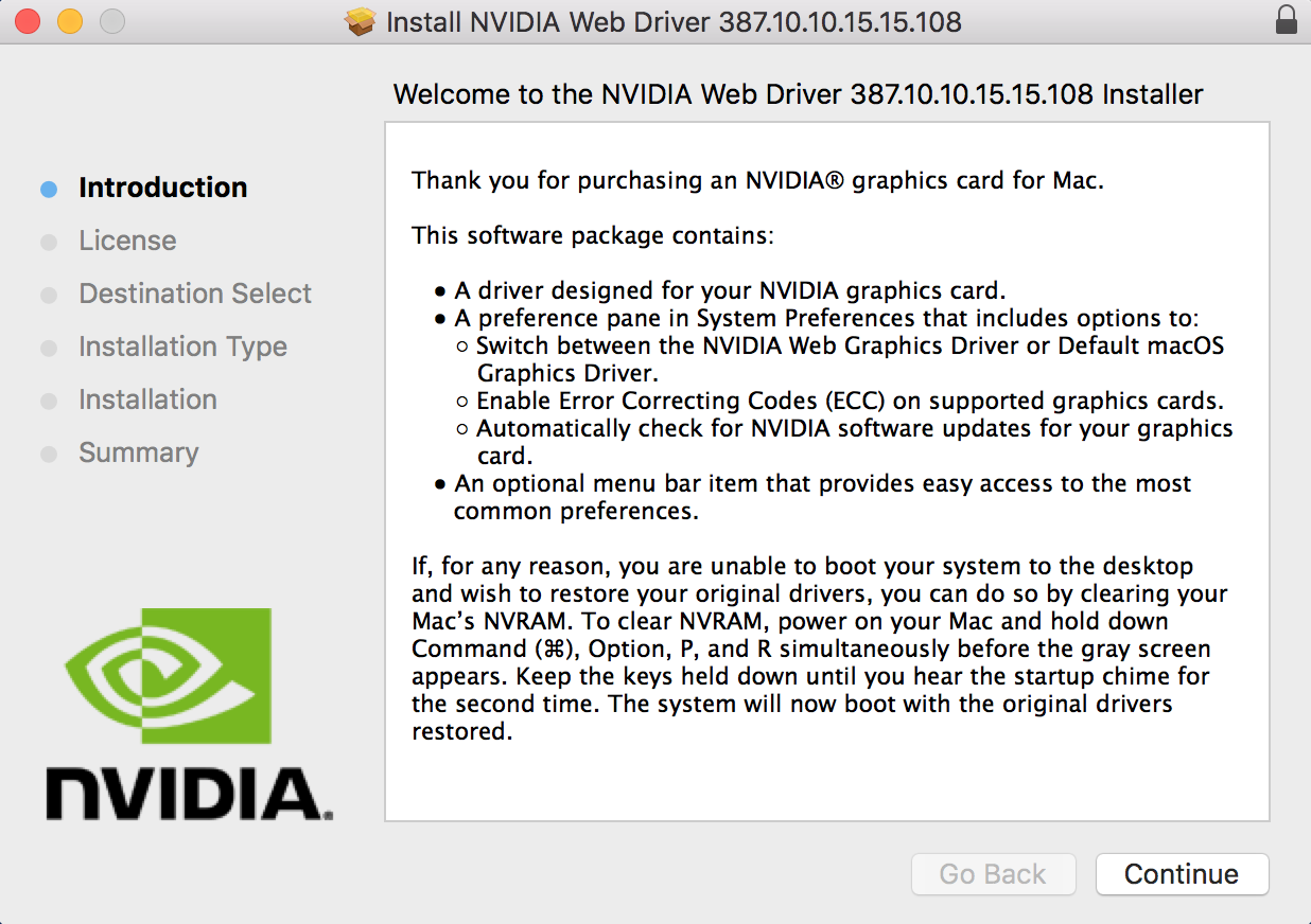

Hi i just found this forum. I have a late 2013 iMac and have had problems with the cuda install since i upgraded to high sierra, saying it needs updating when i have the updated version already installed. Along with random restarts after i put it to sleep and 30 seconds start up from sleep instead of instant.
So i decided to install gain the web driver which there was a new version out. I usually just click on use default mac os graphics driver and use that. I have a geforce 755m which is pretty rubbish anyway.
I installed the new version fine then it said to check for updates, which i did and it said there was a newer version. So i installed that as far as the pop up to go to security, as soon as i clicked to open system preferences the mac shut down and tried to restart. it got 3/4 and got stuck with the cog going round and the status bar stopped. i tried a smc reset with no luck, i then clicked shift and got in using safe mode to find neither drivers had installed, i then tried installing the first driver i found myself which had been fine, it restarted and got stuck again.
The only way i could get into my mac was to use alt-cmd-p-r and keep holding it down until the 2nd chime, then it started fine. This may help assoc get his machine started.
I have managed to install the driver i found and clicked on nvidia web driver to use. But i see no difference. I have only tired it in P.S. CC where i was having trouble with brush stokes, that is still the same. I havn't tried it in WOW yet. The reason i found this forum is i was trying to find what my mac os graphics card actually is ( i know nothing about graphics cards) but in the system report under software/disabled software i found
6KR3T733EC - com.nvidia.web.NVDAGV100HalWeb: which led me here. So i guess my nvidia card isn't even working, is that correct? So should i go back to the mac os graphics card or just leave it. or even try and fix it some more? not knowing graphics cards, i have no idea what i am doing here :(
Anytime you use the default macOS graphics driver, CUDA will NOT be enabled. You MUST use the NVIDIA Web Driver for CUDA on Mac to activate. CUDA must also be installed separately. That is directly from NVIDIA support almost a year ago when asking about the driver and CUDA performance on a GTX 680 (Mac Version) and on MBP with GeForce GT 750M.

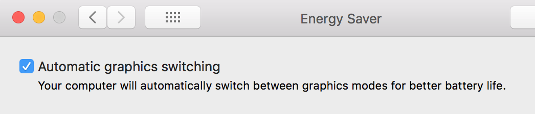

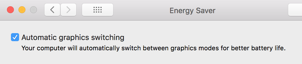

I have no firm idea if the 2013 iMac has only an NVIDIA GPU or if it is a hybrid/dual GPU (like the late 2013 Mac Book Pro) that contains both an NVIDIA GPU and an Intel. The late 2013 MBP has a hybrid/dual GPU with an Intel Iris Pro and GeForce GT 750M. To exclusively use the NVIDIA GPU, you need to select it in System Preferences > Energy Saver and disable automatic graphics switching.
This is what it looks like on the MBP:

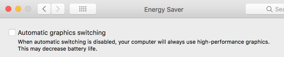

Just an FYI, this is a Mac Pro forum. You MIGHT be better off posting this in an iMac forum for more help.
[doublepost=1535662141][/doublepost]
If you are POSITIVE the EFI GPU is installed correctly, with the correct power cable, seated correctly, and with only 1 monitor connected, then you should try an NVRAM reset first. You can see the instructions in the installer:

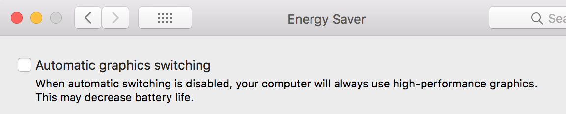

Thank you, sorry didn't realise this was MacBook, didnt realise there was so much difference. Looks like my crappy graphics card is from a laptop anyway lol.
It dosn't look like the iMac's have automatic graphics switching.

Thanks Bsbeamer i will try again although those are the ones i have installed now. it's the one that you posted earlier: GPU Driver Version: 387.10.10.15.15.108 that is giving me the headache, i can't get it to go to system preferences to allow it to install without it shutting my machine down. Thats the version i get when i check for new updates...guess i will have to stick with it being a problem for now. Just a pain when things are glitchy, checked WOW and P.S. CC, both glitchy. But at least i can get into my machine, guess it will do for now, thanks for all your help :)

Thank you! You are a star! That worked! I switched off both. Now my web driver and CUDA have no error messages, my machine wakes from sleep straight away, not had chance to test the random restarting yet. I can only use it when clicked on nvidia web drivers. If i try default mac os graphics drivers, the web driver is fine and updated with new version, but they CUDA is saying the web driver isnt updated, even though it is installed. My WOW and P.S.CC are still glitchy and laggy and freezing, but i'm hoping they will come up with a fix for it. If not i may have to roll back. But atm i'm just happy it's slightly better then before lol...Thank you! :)

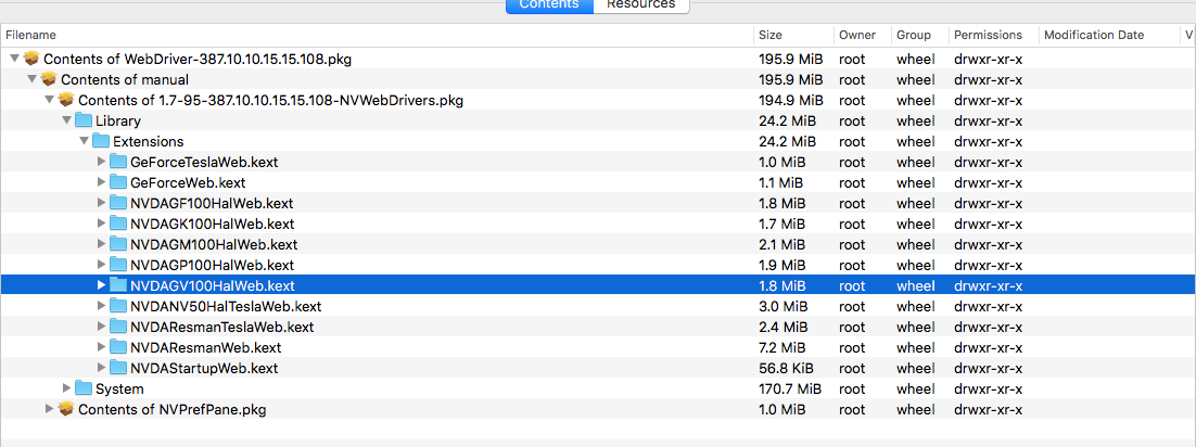

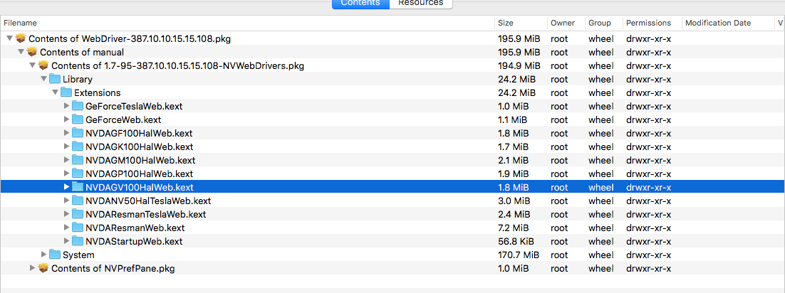

but the latest web driver update seems to bring Volta support...
Yes, noted that a few posts back. Think it's why so many people had install issues with this time since the added driver extension needed to be confirmed to the startup. Straight version updates do not seem to cause this issue.
