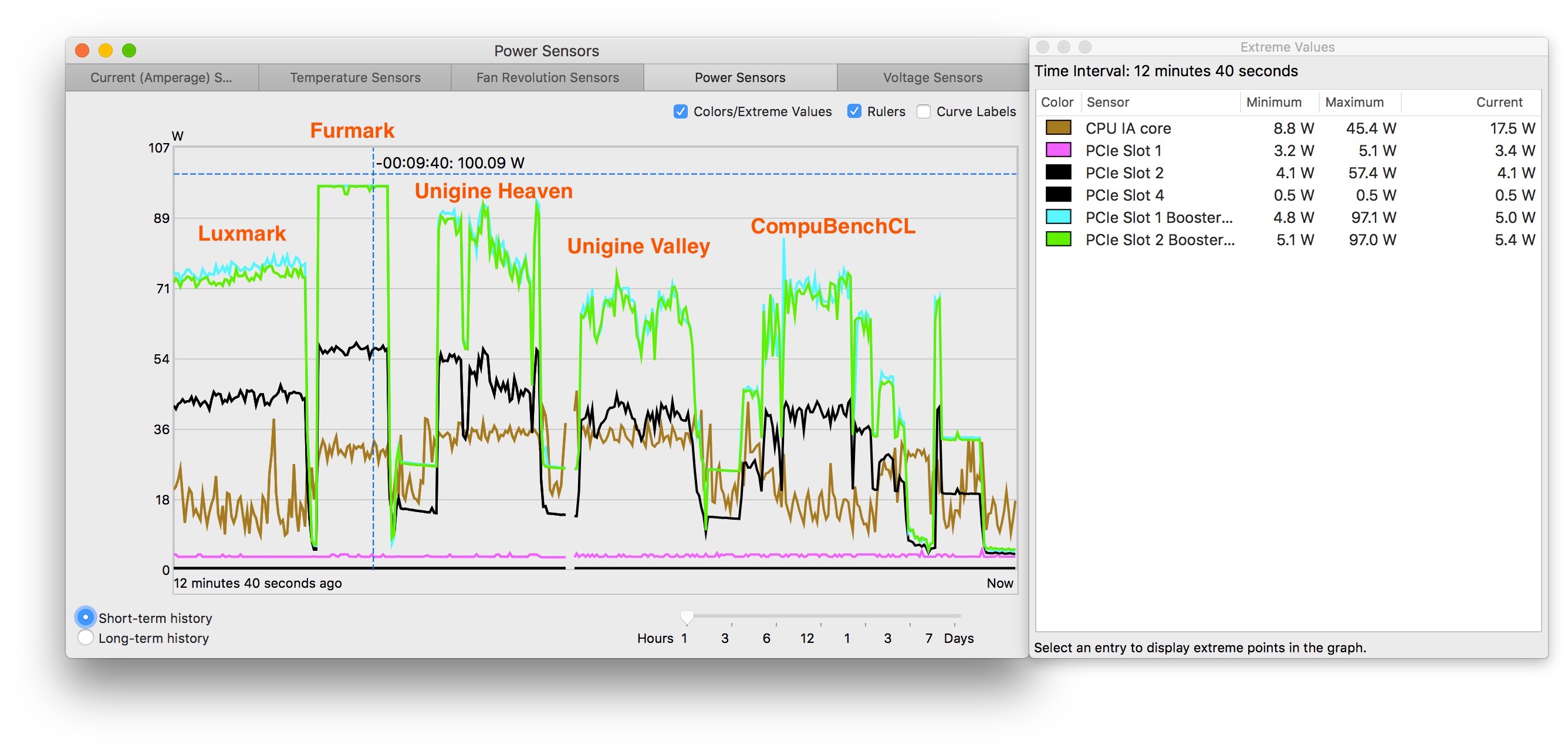

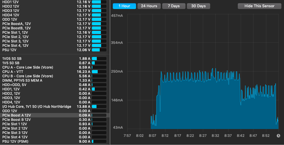

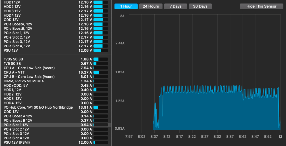

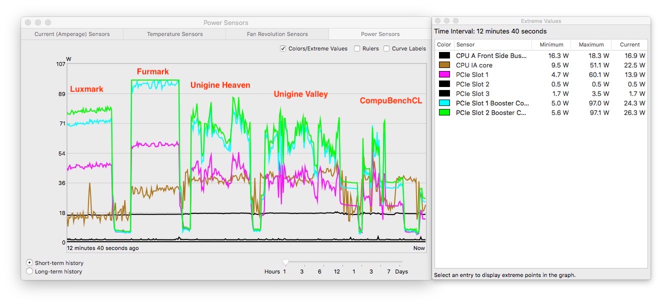

I got my Powerlink installed earlier this week and am absolutely satisfied with it's results in stabilizing, but I was expecting a full 50/50 split. It sits 70/30 at idle and on draw 60/40-but like I said spikes have been stabilized to mole hills and I presume the unevenness is related to the 770 and the 6+8 combo?
There is an up to ~10W difference of power draw between Boost A and B when the card is installed in slot 1.
But if you install the card in slot 2. The difference will be pretty much disappear.
Never dig deep into the why. But it seems Boost B include some slot 1 power draw.
