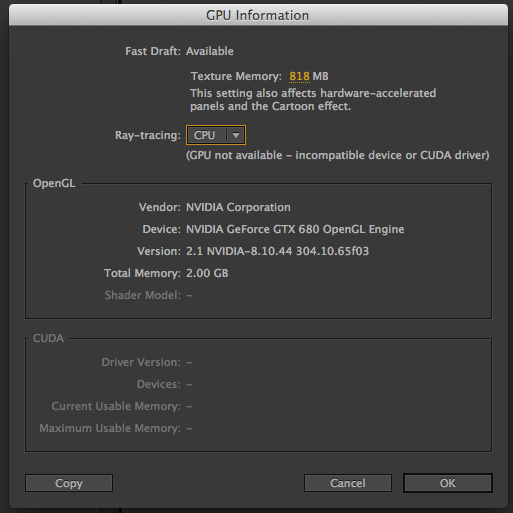

CUDA seems to be broken in AE after the 10.8.3 update. After Effects does not recognize the card for CUDA acceleration.
standard of practice - always have a working clone of your system drive before performing any updates... or multiple versions backdating even further. then, if there's an issue, you can quickly get back up and running while a solution is worked on and figured out.
that being said, hard to get any help without knowing which card you are using, what drivers you've installed, what the machine specs are, and what version of AE you are using.
assume so, but does AE still function and perform tasks otherwise? do you need to add the card back to the text list? did you perform other work arounds to get it working initially?

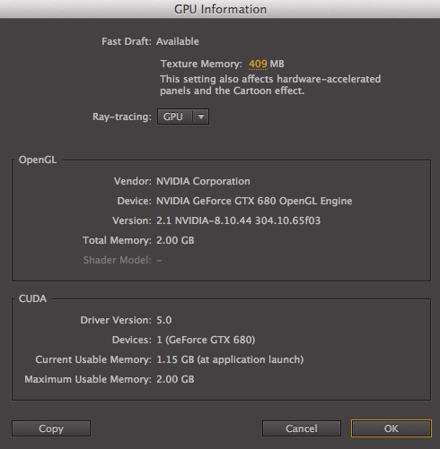

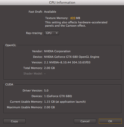

This here from AE 10.0.2.11, OSX 10.8.3, using the reference driver on my GTX680. I don't know what it looked like before, but assume this is working...
Duh, sorry guys. I'm running a GTX 680 in a 5,1 Mac Pro. Is there something else I need to do after the 10.8.3 update to enable the card?
Edit- Weird, Premiere see the card for Mercury Playback. Must be something up with AE.
Did you juice the card with 1 or 2 PCIe power cables?
Never mind, I added the card to raytracer_supported_cards.txt in the AE app package and now it is recognized. I did not have to do this previously with 10.8.2 and the downloaded Nvidia driver.
