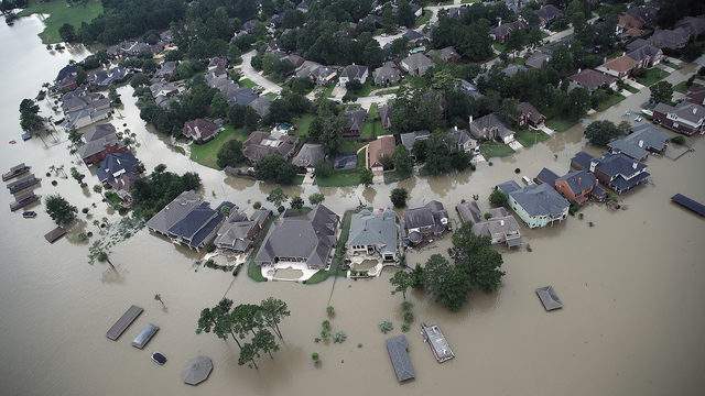

Things to remember living in a hurricane zone. If you are in a flood prone area the generator will need to be elevated. Remember gas lines can possibly go down, and if running propane those tanks can be damaged as well. A whole home solution is the best idea but it is pricey. The electrical will need to be upgraded to accommodate a whole home tranfser switch. The good thing is they switch automatically.
Huntn
macrumors Core
May 5, 2008
23,968
27,052
The Misty Mountains
Harvey was the flood test, yet some houses 1 mile away recently flooded (inches) during a thunderstorm, due to construction and neighborhood drainage being obstructed somehow. Anyway I got flood insurance after that. And if I installed a house wired generator, I would elevate it several feet.

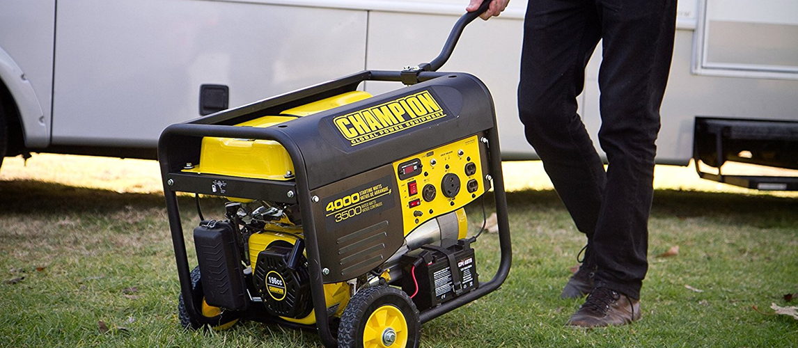

I’m looking at a Westinghouse portable generator that is dual gasoline or propane. Has anyone used propane, I assume at $15-30 a bottle (?) that it is expensive. How long would a typical bottle you might buy to run the grill last running a generator?
I’d stuck with gas. In an outage you don’t know how many propane refilling stations are open. You can always find a gas station with power.
I was thinking of the small bottles used for a grill. I can’t imagine one of those lasting very long.
