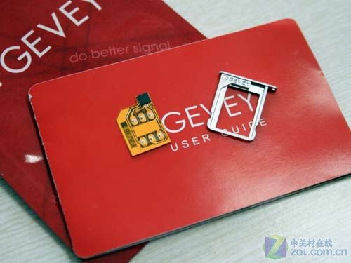

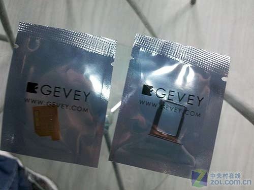

I don't know what the difference is between the non-Pro and Pro.
This is the original Gevey SIM, not my own pics but from Chinese site.
Thats an older model Gevey sim ( not the Gevey Pro)
got mine from www.unlockaniphone.org wich is a genuine pro.
they get them directly from the original factory.
Ill try to post some pics later so you can identify ( the pro has a larger chip) & it works a lot better on my 4.3.3 baseband 4.10.01
