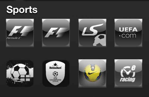

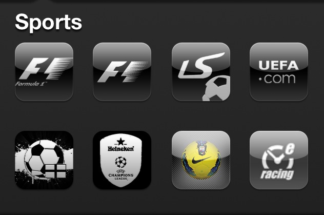

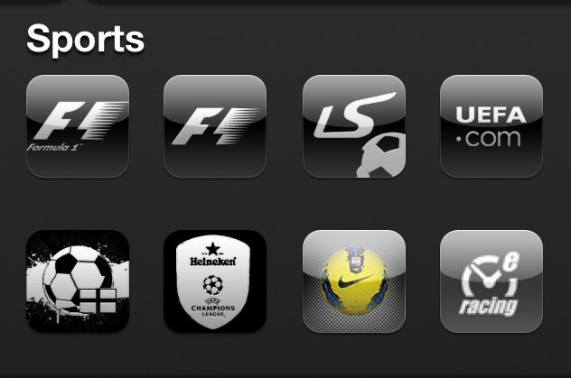

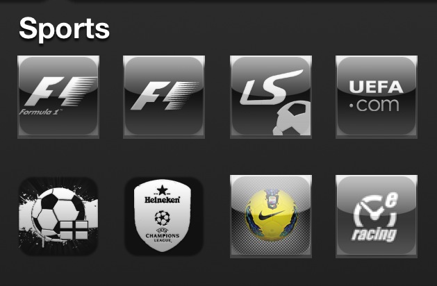

Can someone please convert the following icons from the App Store.
Thanks
Not sure how this soccer ball will look live. Try it and let me know if it doesnt look right.
Definitely passable.
Why does it have a black background? Did you forget to rename the mask file mentioned at the very first post on this thread?
This happens when the mask file gets renamed. Some icons remain the same whereas others have a border around them.
The borders around is expected on non-converted icons but all the Glasklart icons should have looked transparent. That's a weird behavior. Not sure if you have other themes that are interfering.
