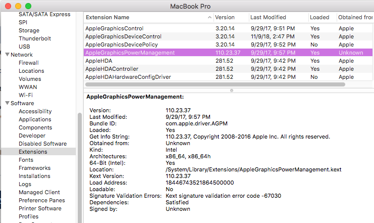

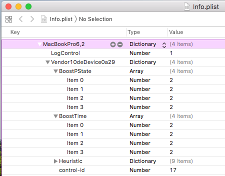

So glad I found this thread. I have started having crashes at least once a day. Fingers crossed this works! I ran the utility as directed. I see that the AppleGraphicsPowerManagement.kext info.plist file has been updated to run at speed 2 only.

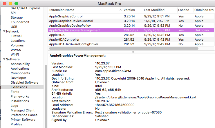

I did reenable SIP after running the utility. The kext still loads. It just fails validation.
Thanks for the tip! I also reenabled the SIP and it still works!
(though, will have to disable it every time apple sends a system update, but the extra effort is still worth the extra layer of SIP security)
Cheers!
Cheers!
Unfortunately, with SIP enabled lately my MBP again started having crashes.
I had to do the whole procedure again (with SIP disabled) and now its working fine again.
I don't think it is possible to have both - a modified kext and SIP enabled at the same time!
