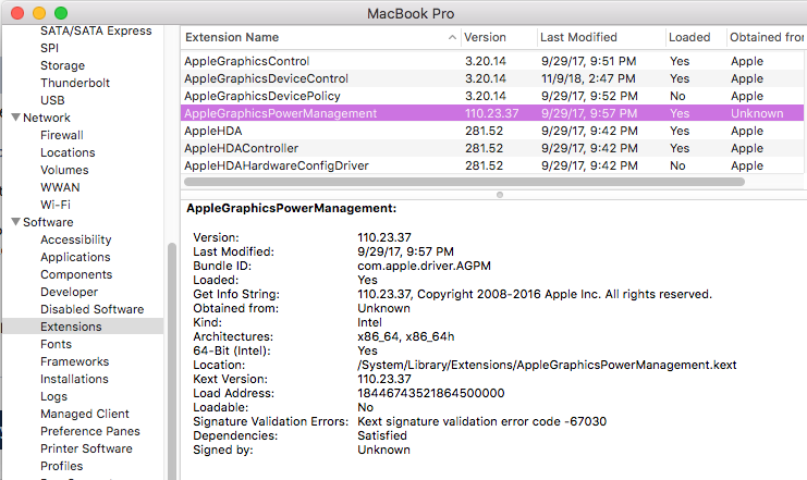

So glad I found this thread. I have started having crashes at least once a day. Fingers crossed this works! I ran the utility as directed. I see that the AppleGraphicsPowerManagement.kext info.plist file has been updated to run at speed 2 only.
I did reenable SIP after running the utility. The kext still loads. It just fails validation.
I will report back in a few days or weeks whether I have had any crashes, and if there have been any issues related to SIP and the modified kext.
Great.
If you want to enable SIP, the correct one is: csrutil enable --without kext
(Enable SIP and enable the installation of unsigned kernel extensions)
Great.
I recommend `csrutil enable ` after making the fix. It should be fully enabled for security. It only needs to be disabled temporarily while we make the change.

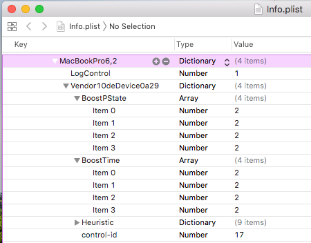

I've just applied v1.4, and before restarting I thought I'd just check the newly created Info.plist for my own sanity.
Please forgive the question, I'm not familiar with how kexts process their plists, but you seem to have changed a simple list array:
<key>MacBookPro6,2</key>
<dict>
<key>LogControl</key>
<integer>0</integer>
<key>Vendor10deDevice0a29</key>
<dict>
<key>BoostPState</key>
<array>
<integer>1</integer>
<integer>2</integer>
<integer>3</integer>
</array>
... into a hash with key-value pairs instead:
<dict>
<dict>
<dict>
<key>0</key>
<key>1</key>
<key>2</key>
<key>3</key>
</dict>
This change of how the integer values were originally presented in the plist occurs for BoostPState, BoostTime, Threshold_High, Threshold_High_v, Threshold_Low and Threshold_Low_v in your modified file.
Having noticed this, I reverted to my original copy before restarting to avoid any potential issues.
I'm primarily a Perl programmer, so - to me - there's a fundamental difference between a list and a hash, so unless there's some underlying cleverness (that I don't know about) in the way the plist is being interpreted by the system it feels like this isn't going to work.
Would your new version have worked correctly?
Cheers
Simon

My mistake. I sent my test file.
Coming home I send the correct one. Thank you
Fixed with the new version.

Closer :) But still one issue. In your original post in this thread, these are the values you give for the Heuristic key:
<key>ID</key>
<key>IdleInterval</key>
<integer>10</integer>
<key>SensorOption</key>
<key>SensorSampleRate</key>
<integer>10000</integer>
<key>TargetCount</key>
In v1.5, these are what those values are set to:
<key>ID</key>
... so it looks like you've got IdleInterval and SensorSampleRate the wrong way around.
Everything else looks OK apart from this.
Cheers
Simon
Reactions: fabioroberto
Cheers
Simon
Hi, thanks for posting.
Do not worry, it's not a mistake. This apparent "inversion" corrected a KP using virtual machine (Win10) with photoshop.
Soon, I'll update my first post.
If you (or someone else) get KP with this change, please let me know.
Cheers!
