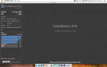

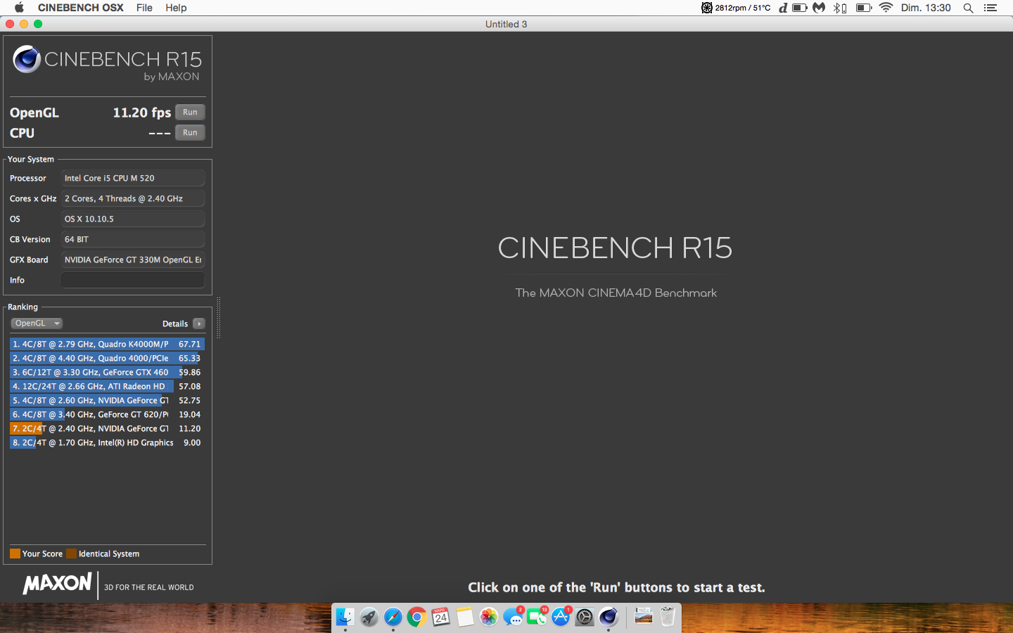

It worked perfectly till High Sierra installation at end of sept 2017. I had then between 3 and 10 GPU kernel panics a day. I had begun to have a look to replace it by a new machine.
I arrived on this site one week ago and read the two-last-year inputs in this topic.
I apply today the fix. It seems that it works :
- AppleGraphicsPowerManagement is now signed by unknown
- Cinebench test run perfectly : 10.62 fps
I hope that this nightmare is behind me.
Thanks a lot to every one.

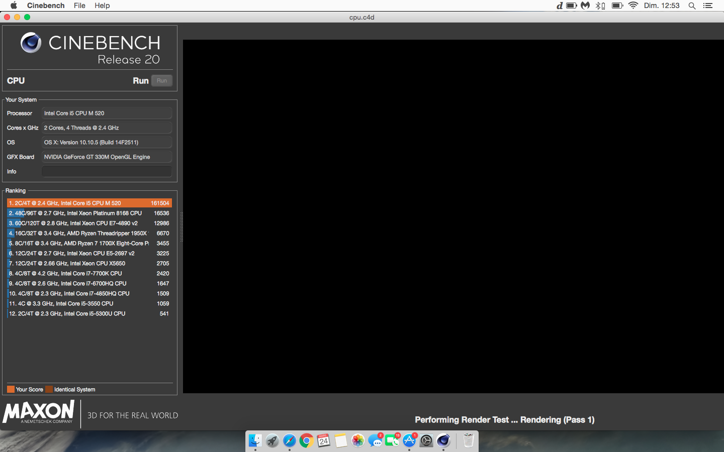

But won't running the benchmark stress the GPU / capacitor ?
Yes, that is the point of the test to see if it panics under stress. If it panics under stress, using any program that causes the Mac to switch to nVidia graphics will cause a kernel panic which, in turn, can severely limit the graphics capability of the MacBook.
ok thanks, i never ran GPU tests on my MacBooks.
I juste ran it 2 times but basically, it only goes to "preparing object" then to "rendering Pass 1". But it only displays a black square on a grey background. I will be including a few screenshots here :
I'm not sure how to interpret this, i do get a result but it is displayed next to CPU as in : CPU = 161415 cb.
I tried to press the "run all selected test" in case i was missing something and i did get a different CB result of : 162946

i just ran the cinebench test and got those results.
I didn't have any reboot or screen crashes

Were you running the Fabioroberto's graphics patch? If yes, try running it without the patch.
My MBP would panic if the patch was not applied before running the test. Eventually, the patch would not work for me and I went with a capacitor replacement to prevent patches and get better graphics performance.
I did try to install the patch by simply running the App, but as i was not able to comprehend how to enter the code before using the mbpgpufix app, i had a "failed to install patch replace capacitor" message being displayed. So indeed i was not running the patch when i ran the test.
I think the computer wasn't used long enough to tax the capacitor. Its has only 4 months of HDD usage on the original ( drive )and the original battery seems to last about 5 hours. But i do want to try to prevent it from developing the GPU failures.

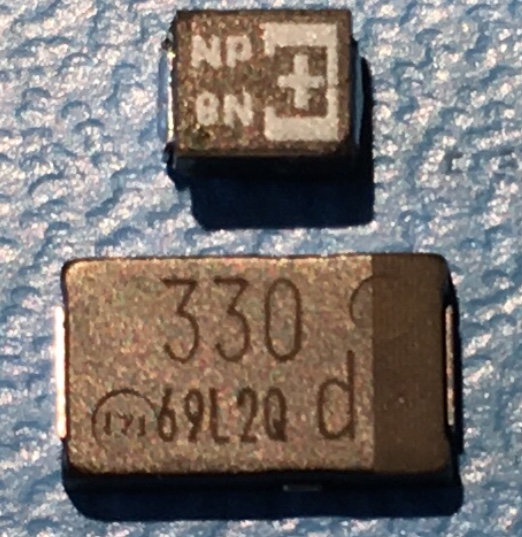

Hi Marco,
The last batch I ordered from Amazon, the exact 'name' was EEFLT0D331R !
The company (Home-Ideas) I got it from is located in GB, so I don't know if that is an option for you...
For sure you should be able to get it at all bigger electronic part vendors.
The cap is bigger than the original one, so you'll have to scratch some space free for the new one to fit.
That's in fact the most thrilling part... The picture below shows both the old and the new cap.
