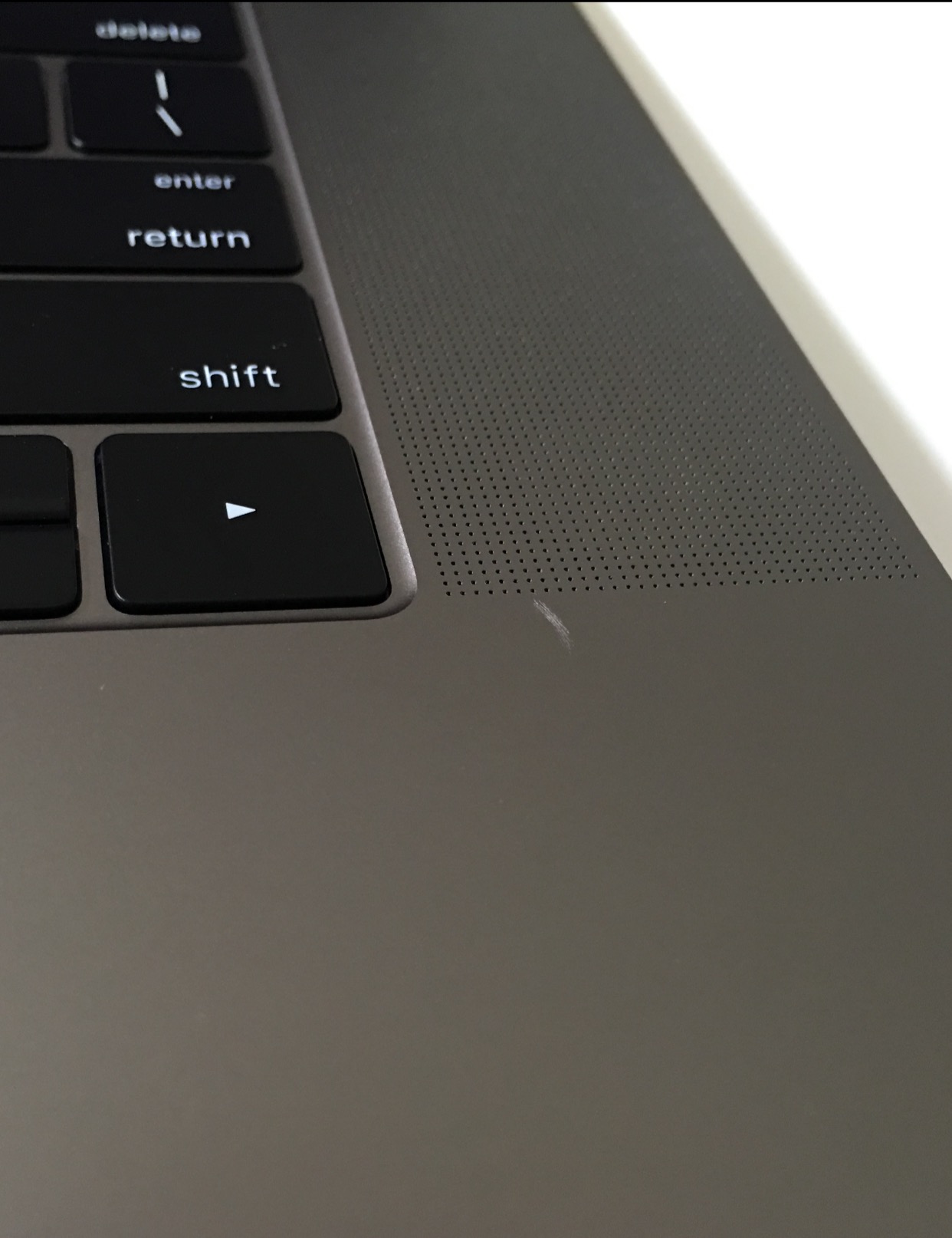

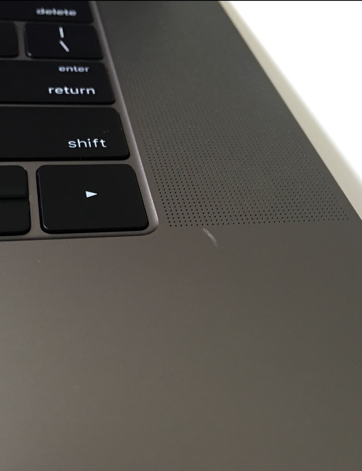

anyone's BTO 15" MBP TB have scratches on the finish straight out of the box? lol, I haven't even checked for possible Radeon 460 issues because I am requesting a replacement for the factory scratch. IMG_6630.JPG
