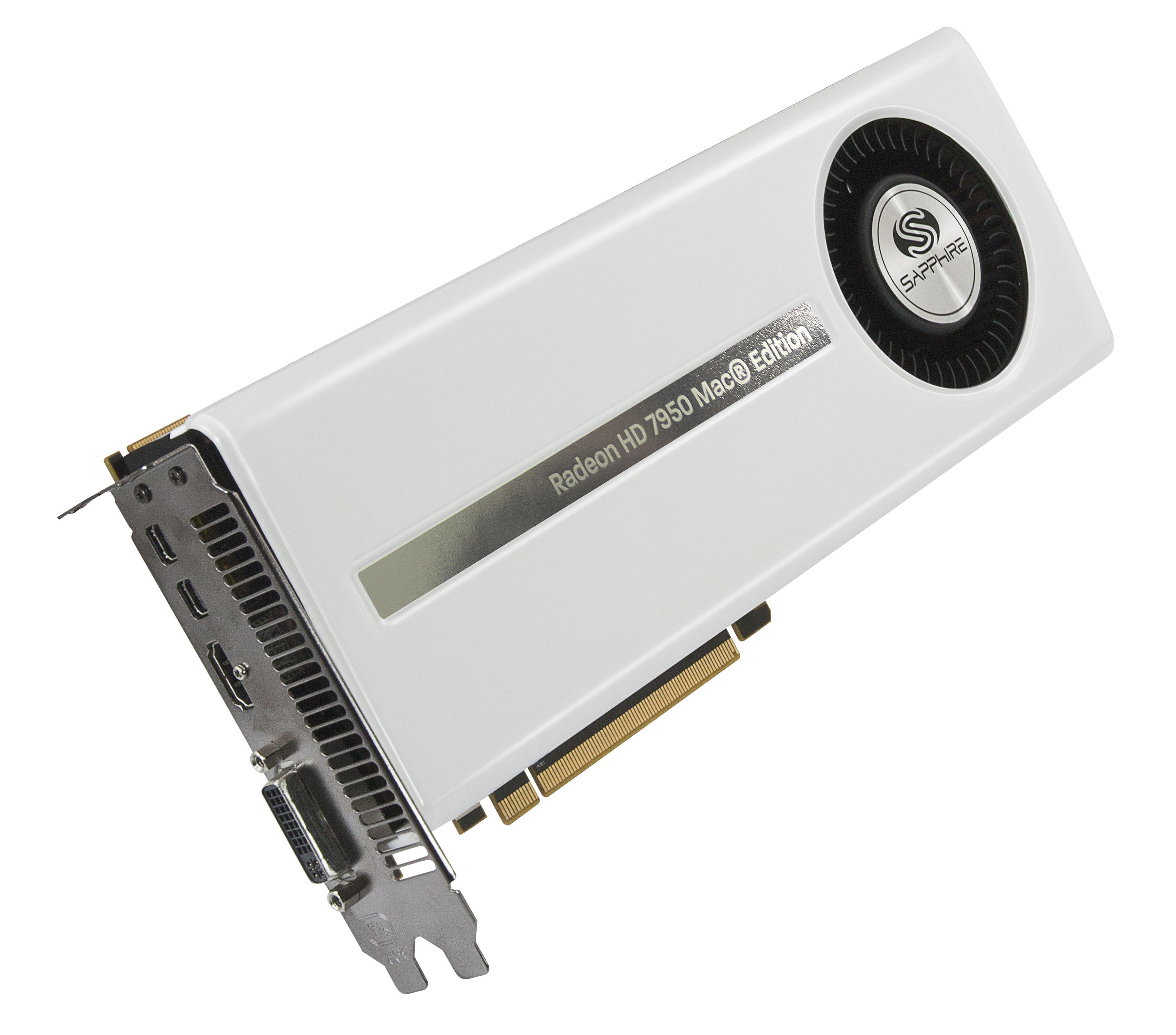

Can anyone confirm if they've got audio through HDMI working on OS X 10.10.5? My 2012 5.1 Mac Pro has been outputting audio on 10.9.5 just fine. So I took the plunge, reformatted and loaded 10.10.5 (no audio). Reformatted again and installed 10.10.2, still no audio. Card is the AMD radeon sapphire 7950 MP edition.
It should work with ur card. Check your midi setup in launch pad

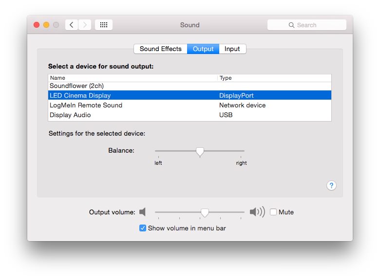

Same here, 10.10.5 breaks the setup. I can install the HDMI Audio kext without any problem.
System info shows driver is installed properly.
Audio preference allow me to choose Audio output via display port.

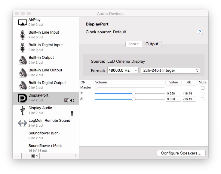

MIDI setup confirms that the option is available and the speakers volume will react with my input accordingly.
However, no sound coming out from the speaker.
Same here, 10.10.5 breaks the setup [...] no sound coming out from the speaker.

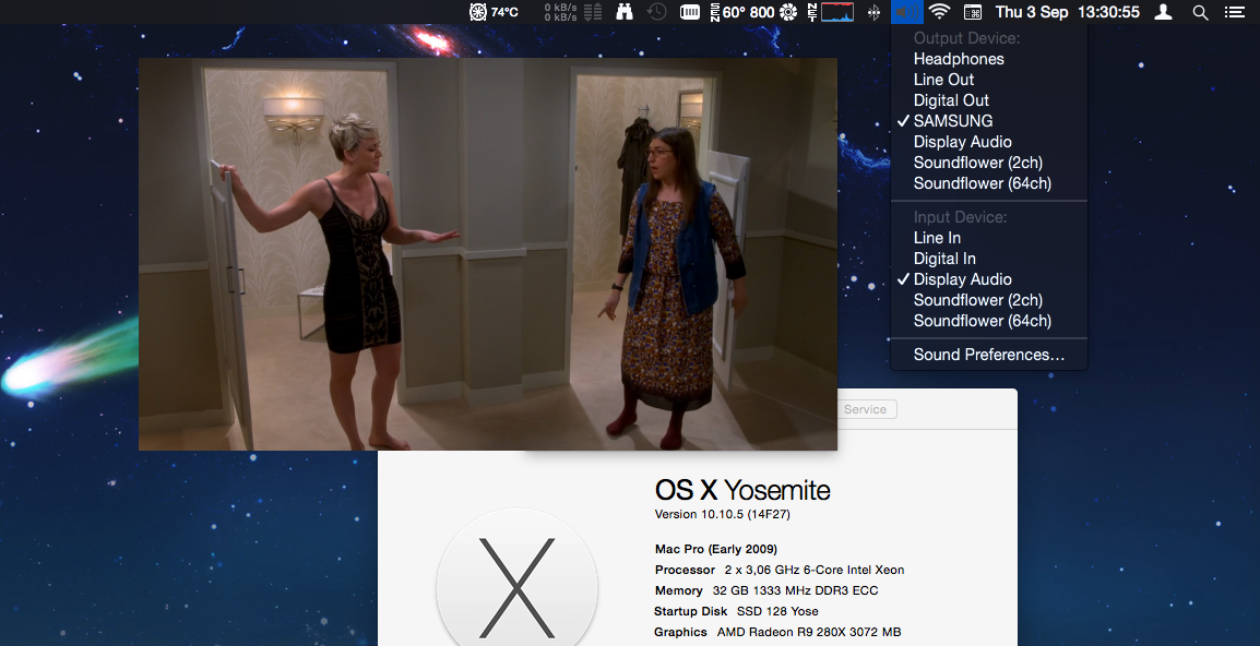

It's still working here on two different 10.10.5 installations. Thats a TV via HDMI in the image below, and it does playback sound just fine with v1.1 and an AMD card.
Zorn is right in #376, don't give up and try again.

Thanks for the info, will keep trying.
I am quite sure it's software issue for me. I have 2 graphic cards, I've tried both display port and HDMI port. And all the cables and cards works well in Windows. So, it should be just the software. Hopefully I can sort it out.
Have you tried with just one in as a test to see if it's not a conflict?
Just install 10.11 GM, the HDMIAudio 1.1 works well after "csrutil disable". And then I try again to install it in my daily use 10.10.5 partition. Only one re-installation, it works flawlessly now, dual card supported. Really happy about it :D, thanks for all the info and support!

Yes, one of the easiest option is the reference 7950. It's almost fool proof if you want to flash it by yourself (dual ROM design). Dual 6 pin, native driver support, very straight forward.
Is there a way to tell if the card is a reference design ?
