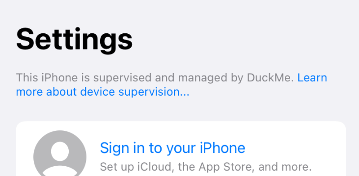

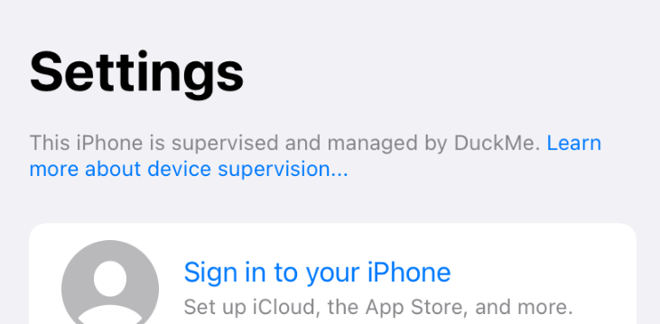

PUT IPHONE IN SUPERVISED MODE
This step assumes that you have prepared two profiles.
The delayed OTA profile we made works only in supervision mode. this mode is provided by Apple to organizations to strengthen the organization's control over the Apple products they own. many advanced controls on the iPhone can be activated in this mode, one of which is the delayed update we use, which allows organizations to update to a version of firmware 90 days after Apple no longer signs it, or for organizations, they get an additional 90-day signature period.
To put an iPhone into supervised mode, there are three popular software that can do it, you can choose the one that suits you:
- Apple Configurator 2
Apple Configurator 2 is officially provided by Apple, it is free and recommended, but the software can only be used on macOS.
- iMazing
iMazing is paid software and you can use it on Windows and macOS.
- iBackupBot from supervise me
iBackupBot, the software reported by other members in this thread (#30), is free and works on Windows and may only run on older versions of macOS.
When putting your iPhone into supervised mode using Apple Configurator 2 or iMazing you will be asked to erase all data on the iPhone, this is because only brand new devices can join the organization, make a backup before that. Note: If you are using eSIM, please make sure that you use a computer to back up your iPhone before erasing it. After erasing your iPhone with a computer, it will be completely erased, and your eSIM profile will also be deleted, but you can restore your eSIM profile from local backup (not iCloud). If you are unable to retrieve your eSIM after restoring, you must contact your carrier to find out how to re-add your number to your phone.
iBackupBot uses a special method to put your device into supervised mode without erasing your iPhone, it requires you to restore a specially edited backup into the iPhone, a member of this thread reported that this operation has the potential to cause data loss (#39), so make a backup before you do.

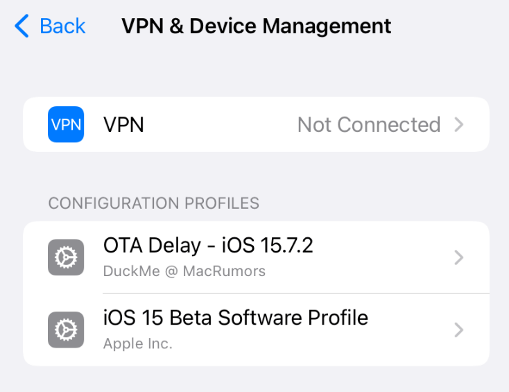

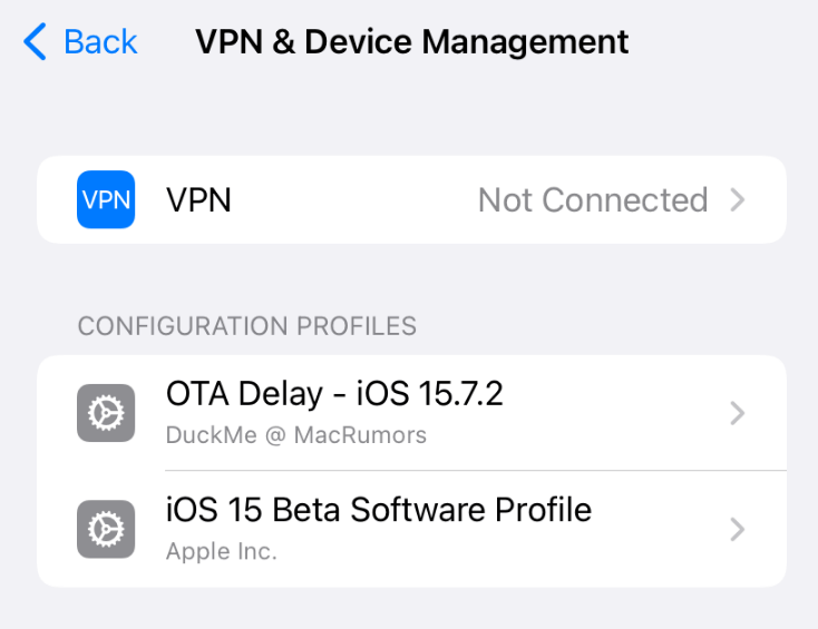

- Install Configuration profiles
Go to iPhone's Settings App, go to "General > VPN and Device Management" to enable your profiles one by one.

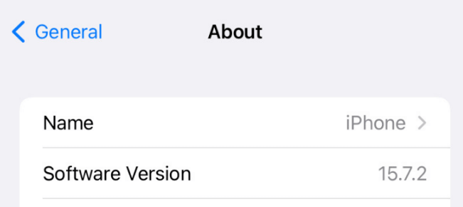

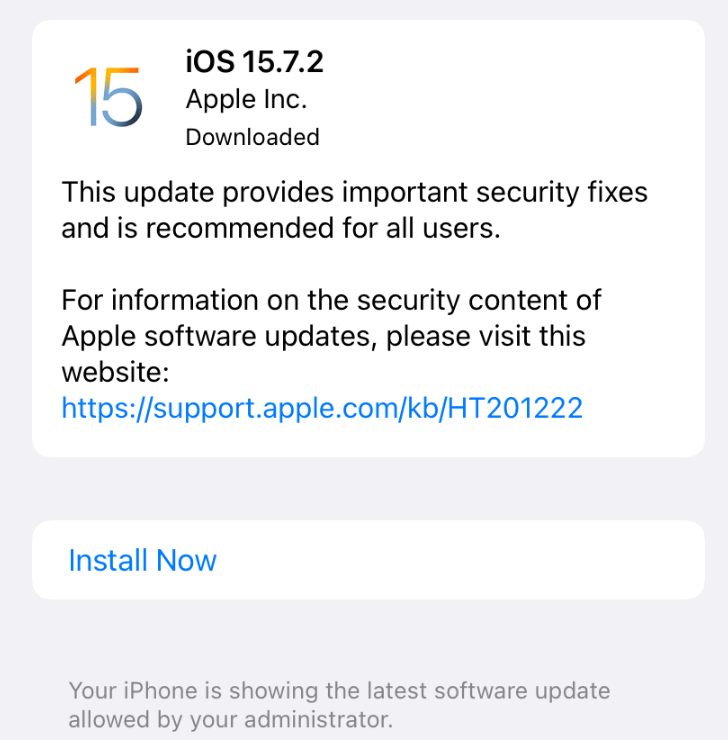

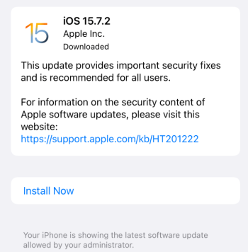

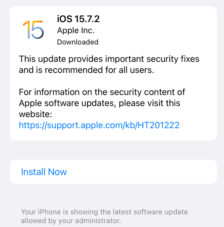

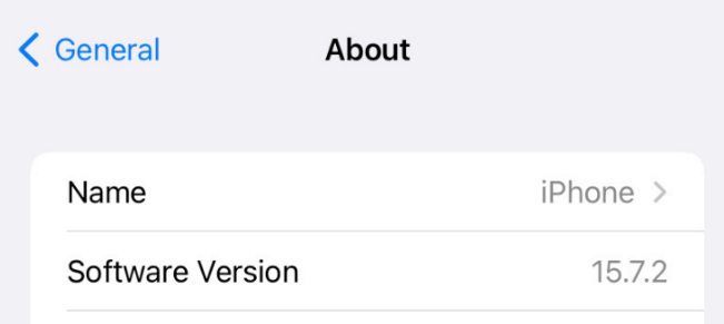

Finally you can check for updates at "General > Software Update" and you should receive the update for iOS 15.7.2 and it will install normally.
After the update, if you put your iPhone in supervised mode using Apple Configurator 2 or iMazing, you will need to erase your iPhone to exit supervised mode. the way is: open the iPhone's Settings app, go to "General > Transfer or Reset iPhone", then tap "Erase All Content and Settings", after erasing, you can restore your iPhone using the backup you created earlier.
I haven't used iBackupBot, but members have reported that after the update, supervision mode is automatically exited, and all profiles are automatically deleted, but your app data and settings are preserved.
At this point, this guide is COMPLETE for you. Enjoy the holidays with your iPhone on iOS 15.7.2 🥳
If your upgrade succeeded or failed, you can reply to this thread to let us know or help you. please let us know your pre-upgrade iOS version and the model you are using when replying.

For iOS 15.7.2 (build number 19H218) there is no difference, they are the same files, just released on different channels.
Apple will first release the firmware in the beta channel to ensure that there are no known problems, and then push it to all users in the public channel.
And 15.7.2 RC (19H218) was not pushed in the public channel (or only for a few hours), but in the beta channel with a longer signature period, that's why we got it from the beta channel. For firmware obtained from the beta channel, we are used to calling it RC, although in some cases they are exactly the same as the public channel release.
The build number is an easy way to verify that they are the same.
I am getting a "Unable to Verify Update, iOS 15.7.2 failed verification because you are no longer connected to the Internet" error when installing this update, what should I do?
Check that you installed TWO profiles correctly?
Check if you put your iPhone in supervised mode correctly?
Check if this guide is expired?
If all is correct then reply with more details so I can help you.

How do I not have to erase my iPhone in the process?
You don't have to erase your iPhone when using iBackupBot to enter supervisor mode.

@TheNukie, shared a new way to put the iPhone in supervised mode.

iosgino
macrumors newbie
Mar 4, 2018
5
21
Maryland, USA
Hi, I am getting an error when trying to install the delay.mobileconfig file. Via email it's just a generic "Profile Error Invalid Profile", while getting this error if I try to install it via Apple Configurator: "This profile is invalid or missing required values. [ConfigurationUtilityKit.error – 0x6 (6)]". Since today's date is Dec. 17, I entered in "9" as the modification. Can you let me know what I can be doing wrong?
EDIT 1: I've figured it out. I needed to create and save an empty .txt file first, then copy/paste the code into that .txt. All good now. Waiting for the update to download to see if it is successful!
EDIT 2: SUCCESS!!! After redoing the delay.mobileconfig file, it all worked flawlessly!! Also, in leu of emailing the configs, installing them via the Apple Configurator works as well!! Hope this helps anyone else that may/would have any issues!
And thanks @DuckMe for this awesome work around!!!!
Reactions: DuckMe
DuckMe
macrumors member
Dec 14, 2022
70
39
Forgive my writing, obviously there are some grammatical and wording mistakes, I noticed them, but it shouldn't affect the reading.
Since I'm new to this forum, any changes to this thread will inevitably cause this thread to temporarily enter a state requiring moderator review, and I don't want it to be invisible for a while, so I won't update the grammatical and wording mistakes in it.
Also, discussing anything about the beta profile may break the forum rules. discussions about it in this thread have been deleted or edited by moderators. so don't ask me that question, I don't want to make trouble.
ANOTHER VERY IMPORTANT THING, I just noticed is that upgrading to iOS 15.7.2 may expire earlier than March 2023, that is because the beta profile may expire sooner, and the beta profile I have is valid until January 31, 2023, which probably means you won't be able to get the OTA update to 15.7.2 RC after January 31, 2023.
This is over a month earlier than I expected because my expectations were based on the 90 days of the Delayed OTA and ignored the beta expiration date.
I won't correct the mention of the expiration date in the main thread, but you should know that by now.
The guide does work for iPhone SE 2, SE 3, I forgot to mention them in the main thread.
This guide works at this moment, if you succeed or fail, share your experience, of course you need to follow the forum rules.
Do let us know what device you are using and what version of iOS you were on before upgrading.

I'm stuck at importing the delayed profile. The iPhone XS is supervised and I've sent the delay.mobileconfig profile via stock Mail app. When I tap the attachment I get 'Profile Error' The profile version is not supported. This happens for a delayed profile that I created in Apple Configurator 2, and edited the integer to 9 using Finder.
I also created another delayed profile using the code from this thread: I copied from this thread and edited integer to 9. I initially saved an empty file in the TextEdit software as text. Then I added the content and modified the ending to delay.mobileconfig. When I try to import it via stock Mail app I get 'Profile Error. Invalid Profile.'
Any ideas? I'm using iPhone XS on 15.6 RC and macOS 13.1.
Please add the file in your reply so I can check if your profile is correct, I think you may have copied the wrong line.
Or use the file I made for you below, it has 10 days delay and will only be available on December 18th, tomorrow you will have to modify the date in it. (Due to forum restrictions, you must remove ".txt" from the filename)
EDIT: Removed obsolete attachment.

There is no need to keep all those keys, you only need forceDelayedSoftwareUpdates and enforcedSoftwareUpdateDelay

DuckMe
macrumors member
Dec 14, 2022
70
39

You always get those keys when creating with Apple's program, I never figured out if they were necessary, but I think you're right, you don't need them, thanks.

Has your iPhone been supervised by other organization?
If your iPhone is already supervised by another organization, such as a company or school, then there is nothing I can do, contacting your IT and asking them to make and push a Delayed OTA profile for you is the only way.
Or are you signing up for MDM?
To use Apple Configurator, you don't need to log into your Apple ID, nor do you need to register any account.
But you do need to fill in an organization information yourself, but this information is local and can be filled in at will.
vladstarr
macrumors newbie
Mar 27, 2021
12
23
I can't get the phone into Supervised mode; Configurator says "cannot access Apple School Manager or Apple Business Manager. Please contact your organization's administrators".
What am I missing here - is this thread only for people belonging to an organization?
You just need to click Skip button on sign in step. Stuck for a while same as you, until i figured it out haha
Reactions: DuckMe
DuckMe
macrumors member
Dec 14, 2022
70
39
Thanks for your help and clarification.

cchase887543
macrumors newbie
May 12, 2022
11
6
Would anyone have a working profile? I’m supervised. But can’t make a profile as I have windows.
DuckMe
macrumors member
Dec 14, 2022
70
39
Yeah, I didn't get a Skip button the first time I tried it, just a "Next". I did after I restarted though. 🤷‍♂️
So my next question is.. how on earth do I update an iPhone SE (2020) that's currently on iOS 13? No matter what day value I use in the delay.mobileconfig profile, I wind up with some version of iOS 16 in Software Update. 16.0 was released 98 days ago which apparently is longer than the allowed amount of delay.
I've been on the ipsw.me site but there is literally no version of iOS 15 that isn't shown as Unsigned. I do not see a 19G69.
I explained the steps in your original post, you need to upgrade to 15.6 RC first to get this OTA.
This is because the optional upgrade function is only added in iOS 14.5, and versions before 14.5 can only see the latest version and cannot see other optional versions.
Also, I won't trust ipsw me anymore, the site has lost credibility over and over again, it never lists beta ipsws, even when iOS 15.7 final restore ipsw is available, I seriously doubt it has been bought by Apple , they now, like Apple, only allow you to update to the latest version.
Search for "iPhone12,8_15.6_19G69_Restore.ipsw", this is the ipsw available for your model at the moment.
DuckMe
macrumors member
Dec 14, 2022
70
39
Why can't you do this? I'm pretty sure even a Windows 95 text editor would do the job.
You just need to copy the content of the original post into empty text and modify the date, then save.
However, I'm now recommending the content of #8 because it's simpler.
EDIT:
Well, I made you a Delayed OTA profile for today (Dec 19th, it has an 11 day delay), you need to remove the .txt from the filename before sending to the iPhone.
But, anyone should do it themselves, just copy, edit, save, because this file needs to modify the date in it every day, i can't always help.
EDIT2: Removed obsolete attachment.
cchase887543
macrumors newbie
May 12, 2022
11
6
I copied it, but it’s only giving me the option for 15.7.1
DuckMe
macrumors member
Dec 14, 2022
70
39
That's because that date is incorrect. #8 only applies to yesterday.
You need to edit the date between <integer>10</integer>, that is, the time difference between today and December 8th, and today should be 11.
Anyway, I edited my original reply at #20 to make a profile for you that works for today. Using that should get you iOS 15.7.2 today.
let us know if you are successful.
cchase887543
macrumors newbie
May 12, 2022
11
6
Unfortunately still only gives me 15.7.1. They might have fixed it.
DuckMe
macrumors member
Dec 14, 2022
70
39
Are you sure you have two profiles ready?
One is Delayed OTA, which lets you go back in time and get the OTA updates that were available that day.
One is the beta profile, since the only 15.7.2 available that day is the RC release, which is only available to members of the beta program.
In order to get a beta profile, you'll have to figure it out yourself, and it might be against the forum rules to discuss it.
I recommend you read the original thread carefully, as it explains in detail how to modify the delayed OTA and why I can't distribute the beta profile.
cchase887543
macrumors newbie
May 12, 2022
11
6
In order to get a beta profile, you'll have to figure it out yourself, and it might be against the forum rules to discuss it, but the Google "iOS 15 beta profiles" is a good place to start.
Ohhh. I didn’t read that. I’m so dumb. I didn’t realize I needed both.
