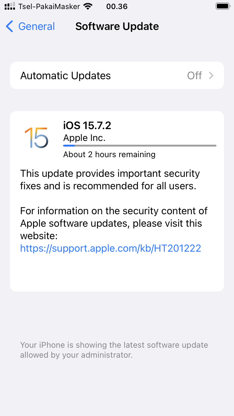

I found out the reason:
- I have just loaded the profiles to phone, but not yet install them.
So now after installing one by one, back to Update software... 15.7.2 is available to upgrade
Thank you

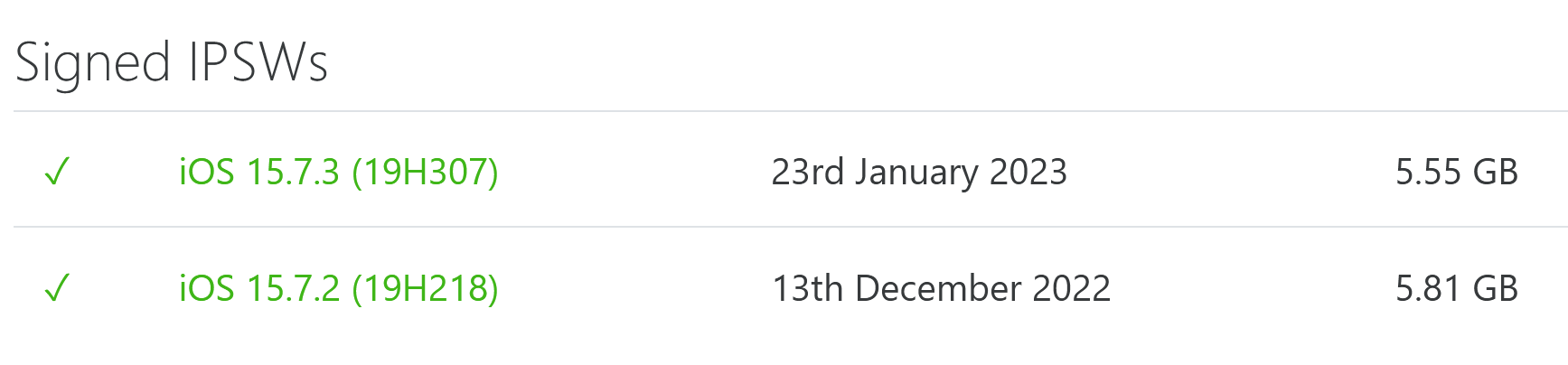

iOS 15.6 RC1 (19G69) which still was signed today, January 20, 2023
Thanks for letting us know about this
maybe then Apple will finally remember they left an old version signed.
Still don't know for what reason they are still signing 15.6 RC1 🤷‍♂️
Glad you got 15.7.2.

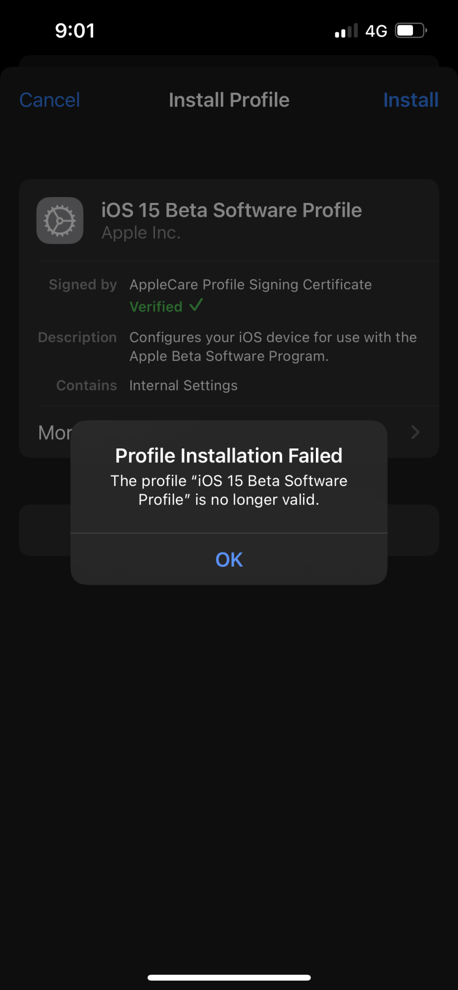

I woke up to my phone mysteriously turned off with more than 50% battery and the beta profile missing. I'm guessing it expired.
I didn't expect it to be automatically deleted.
Ya! Mine to while installing 15 beta profile it says no longer valid.
Yes, the beta profile for iOS 15 expired on January 31, as expected.
Currently there is no way to upgrade to 15.7.2 for iPhone 8 and later models.
