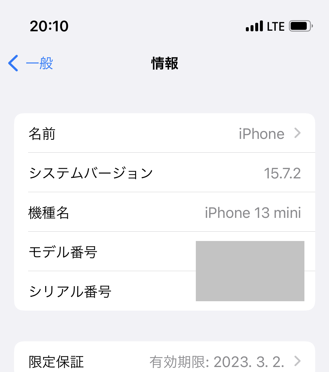

After some time I’ve finally tried this method, I’ve used iBackupPro on Windows and worked flawless, or well it asked to update to 16.2 but turned off the modem and was okay. I’ve get the iPhone XS to supervise mode and installed the two profiles. Now it’s installing 15.7.2. I’ll update when it’s done ;)
VAR_123
macrumors newbie
Nov 29, 2022
12
15
First of all, thanks to @DuckMe . I have an iPhone 13 with iOS 16.2, which I downgraded to 15.6 RC, and I have successfully updated to 15.7.2 RC.
I bought an iPhone because of its great software and battery backup, but iOS 16 changed that. I waited until 16.1.2 and upgraded from 15.7 to 16.1.2 and 16.2. Battery backup on 16.2 is not good. Even in idle condition at night, it drops to 6% (now my 15.7.2 drops to only 1%), and while using the 16.2 battery, it is not as good. So I finally decided to downgrade from 16.2 to 15.7.2.
I successfully downgraded from 16.2 to 15.6RC for the second time (the first time stuck at the Apple logo) using an ipsw file.
I have been stuck at 15.6RC for 4 days searching for how to update from 15.6 to 15.7.2, because in updates it is only showing 16.2, and I finally found your article about how to update from 15.6 to 15.7.2.
First, I downloaded your delay profile and followed your instructions, and I found the iOS 15 beta profile somewhere on another website and installed it.
Second, I went to settings and updates, where I found 15.7.2 and downloaded it.
Thirdly, when I try to instal 15.7.2, it says to check your Internet connection and fails to install.
Fourth, I missed making supervised mode, so I downloaded iBackupPro on Windows and tried to make it, but I couldn’t understand how to make it, so I went to YouTube and saw some videos about how to make supervised mode on the iPhone.
Finally, I made my iPhone supervised, and I went to Updates and installed 15.7.2, which I previously downloaded. It went smoothly, and I skipped entering my Apple ID after installing 15.7.2.
Lastly, I again cleaned the installation by erasing all content and settings. (General settings—transfer or reset iPhone)
Now I entered my Apple ID, and the same as when I first bought my iPhone, it downloaded all my iCloud photos and everything else it synced to iCloud.
