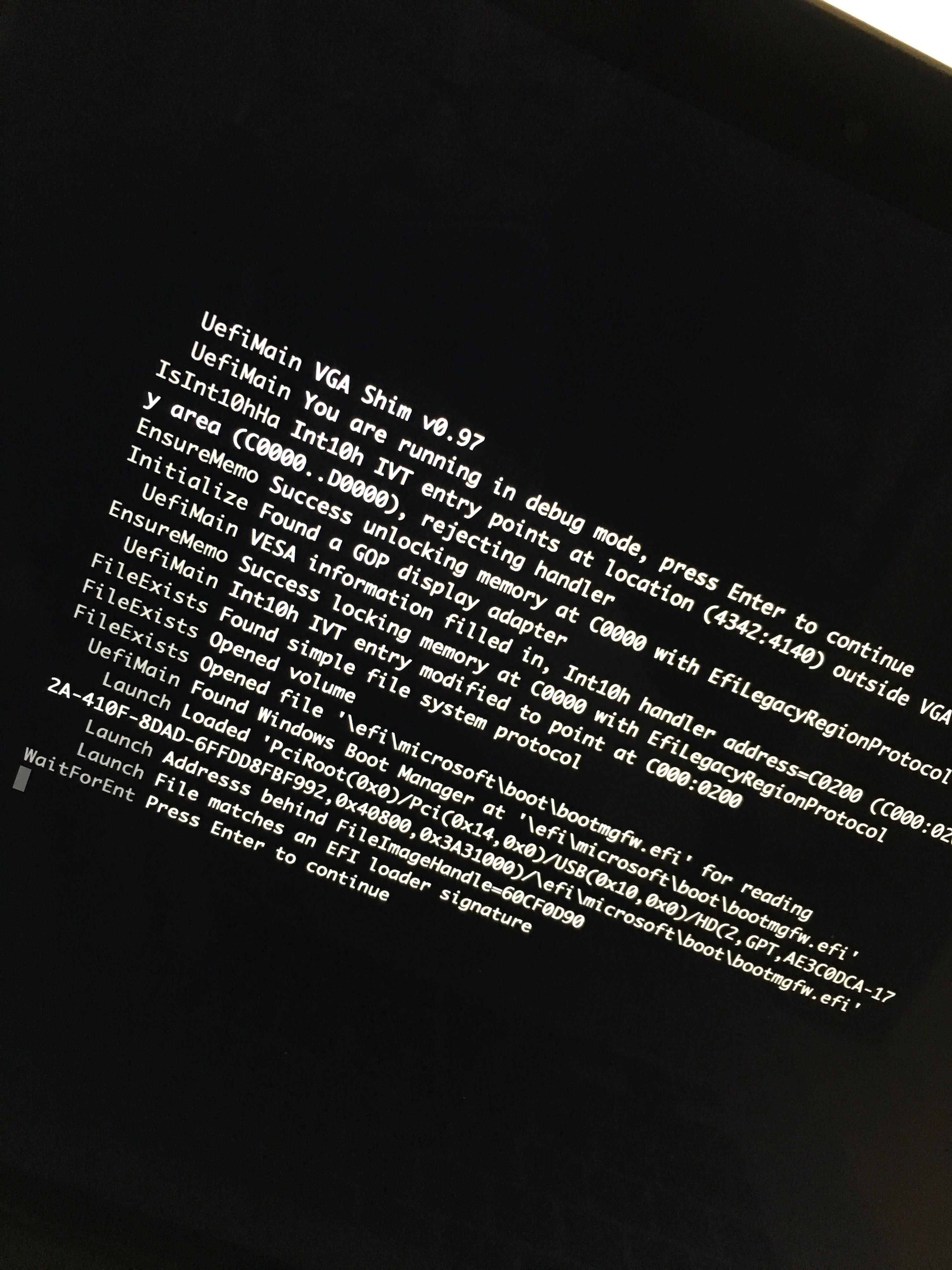

Hi,
Unfortunately on my mac 16.1 (late 2015) have failed to install win7.
The first problem is presented during the installation of windows, in fact inserting the USB pendrive (following the guide) appears only the windows logo.
I then decided to try to do the installation via the windows 10 cd, the cd boot is successful, shift + 10 and install Windows 7 via USB pendrive.
The installation is performed without problems - then I install El capitan - and I install vgashim in osx.
On restart run VGA Shim - but also leaving the mac for an hour remains the windows logo and does not boot in windows 7.
Could you please help me, let me know what you need.
I also tried with Davidcie but did not work :(
Thanks,
Marco

Hi Tom,
Wait actually I only want to install Windows 7, I can remove Windows 10, then I have a clone for safety.
But I have the same problem as AmethystZhou:
(I followed your guide and created the installer USB drive, but when I try to boot from the USB drive, it hangs on this screen: https://i.imgur.com/3kLSG7j.jpg I let the computer run for a few minutes, nothing changes and the fans starts to run at very high speed so I shut it down.)
It is a strange situation, I do not know what I can do :(
Thanks,
Marco
[doublepost=1475732773][/doublepost]Hi Tom,
I am trying to install Windows 7 for several months, then I left to go to Windows 10, but now I would like to try it again.

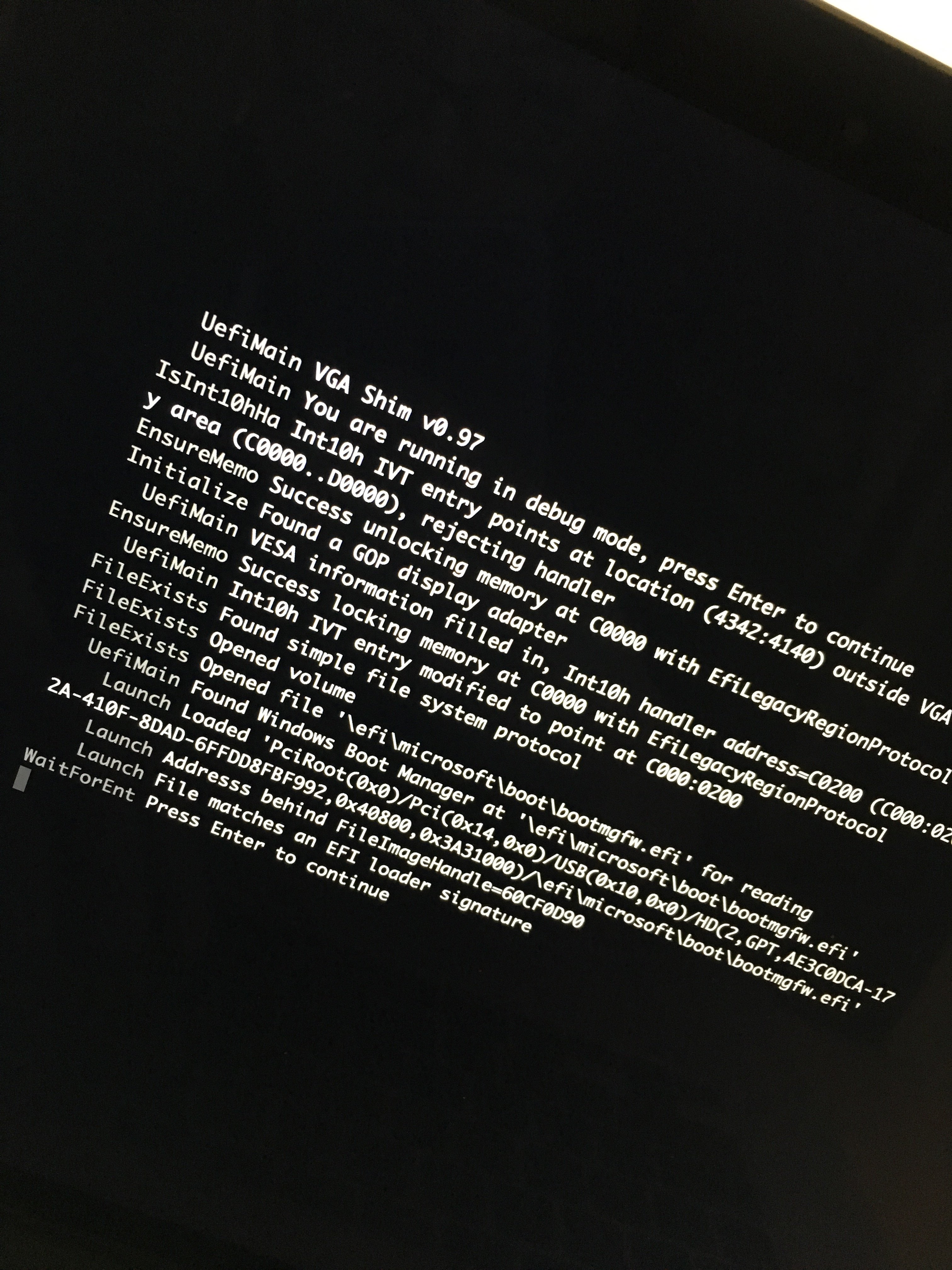

These are some screen sent to DavidCie a couple of months ago:
Safe Boot windows 7: http://s28.postimg.org/niokqujwd/Boot_Manager.jpg
Yes, F8 works
Vga Shim: http://postimg.org/image/8jdrus89t/
Yes, F8 works
Hi Marco
Since F8 works, try the "disable driver signature enforcement". And if that fails, try the link of my ISO with removed install.wim (copy yours into it because it's too large to upload).
Your sincerely
Tom
Hi Tom,
Yes also "disable driver signature enforcement" fails.

Hi tl166115,
I 've try your guide but stuck at Booting Windows installation , after the progress , the computer freeze at "Windows is loading files..." . I used macbook 15' M370x version. Is that this GPU make situation worse? Could you give me some advice? Many thanks.
BTW , I am sure I've do all thing above.
Hi tl166115,
Hi Umi
Yes, GPU is the part that messed up. I wouldn't even do a GPU driver embedding since there has been case that was experiencing a lot of failures; try not to use GPU driver. And based on your description, you didn't configure the EFI correctly. There should not be "Windows is loading files" screen at all. Unfortunately, I am not sure which part wasn't quite right because I have never seen that before. Did you format your USB disk with GUID mode and apply all of the EFI files we generated? Those vital steps must be exactly copied with no omit or alteration to make a successful installation.
Hi Umi
Yes , I am very sure that I omit nothing and create an EFI boot successfully because I could enter avidcie's DEBUG mode and then it find bootmgfw.efi.
No , there is just bootx64.bmp with bootx64.efi in efi\boot , no more .bmp file in efi\microsoft\boot\
