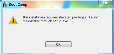

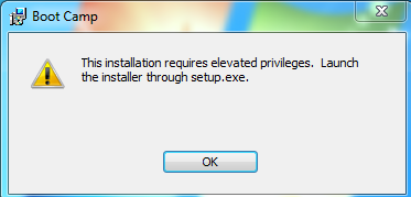

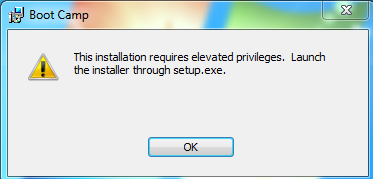

How to disable Driver Signature Enforcement? I cant open Bootcamp.msi :( PLEASE HELP

Right click and choose “run as administrator”

Hi Tom,
I can't still open the Bootcamp.msi, there is no Run as administrator when right clicked..
[doublepost=1516790767][/doublepost]i really can't install bootcamp.msi :(

Hi Tom,
Do you have administrative privilege? Try install using the real Administrator account or SYSTEM account if that’s an issue. I strongly doubt if you can use setup.exe because it threw me an error.
Here how to enable the “real Administrator”:
Press Command + R to to open “run” window, type in “lusrmgr.msc” and then press enter
Navigate to “Users/Administrator”. Double click it and uncheck “account is disabled.”
Log out of your current account and log into Administrator
Do the same installation again
It Works! :) Thanks a lot.. Another problem though, i still dont have bluetooth driver even i installed it:(
