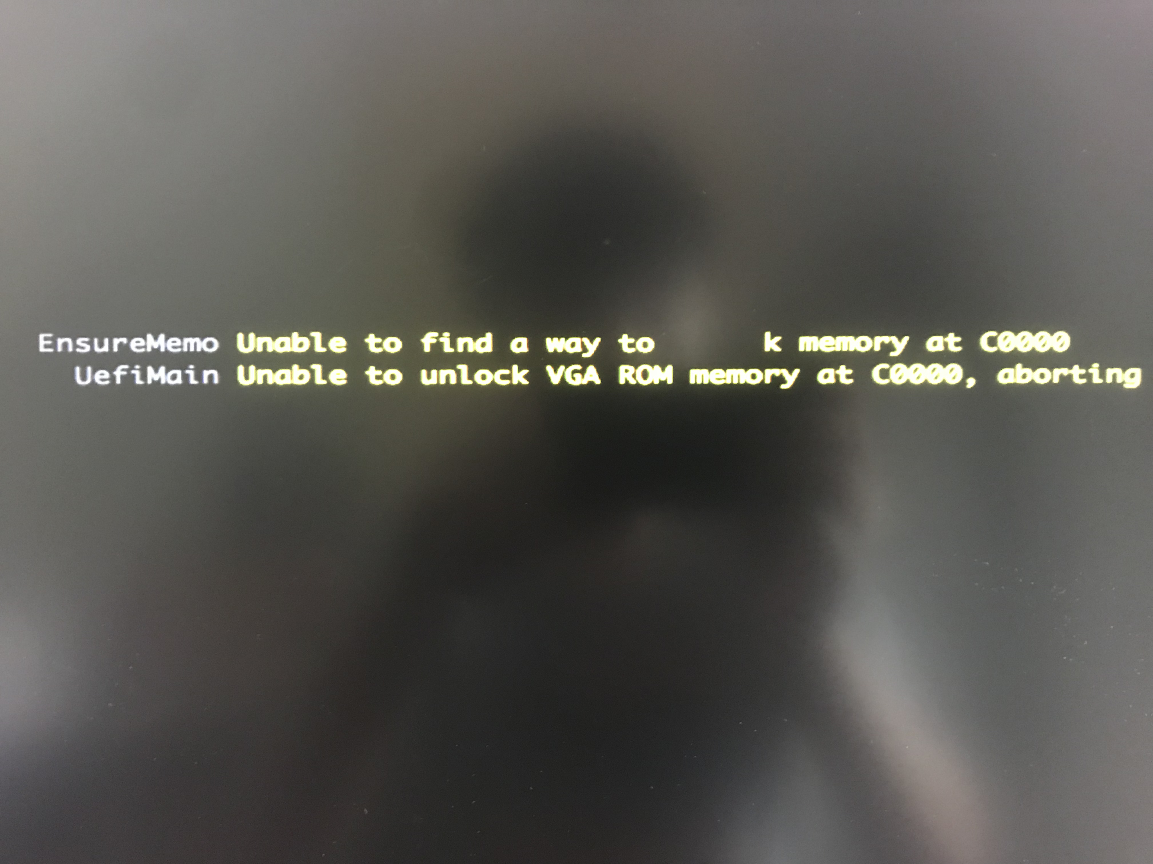

Failed to install windows 7 on Mac Pro 2013 late .
Causes MP don’t have intel Graphics in
Xeon cpus . And amd gpu driver can’t add to boot.wim & install.wim .
After boot in win7 usb,is some error message with black screens.

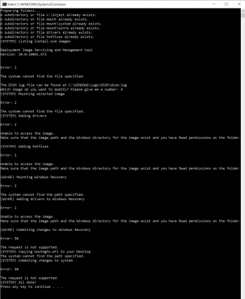

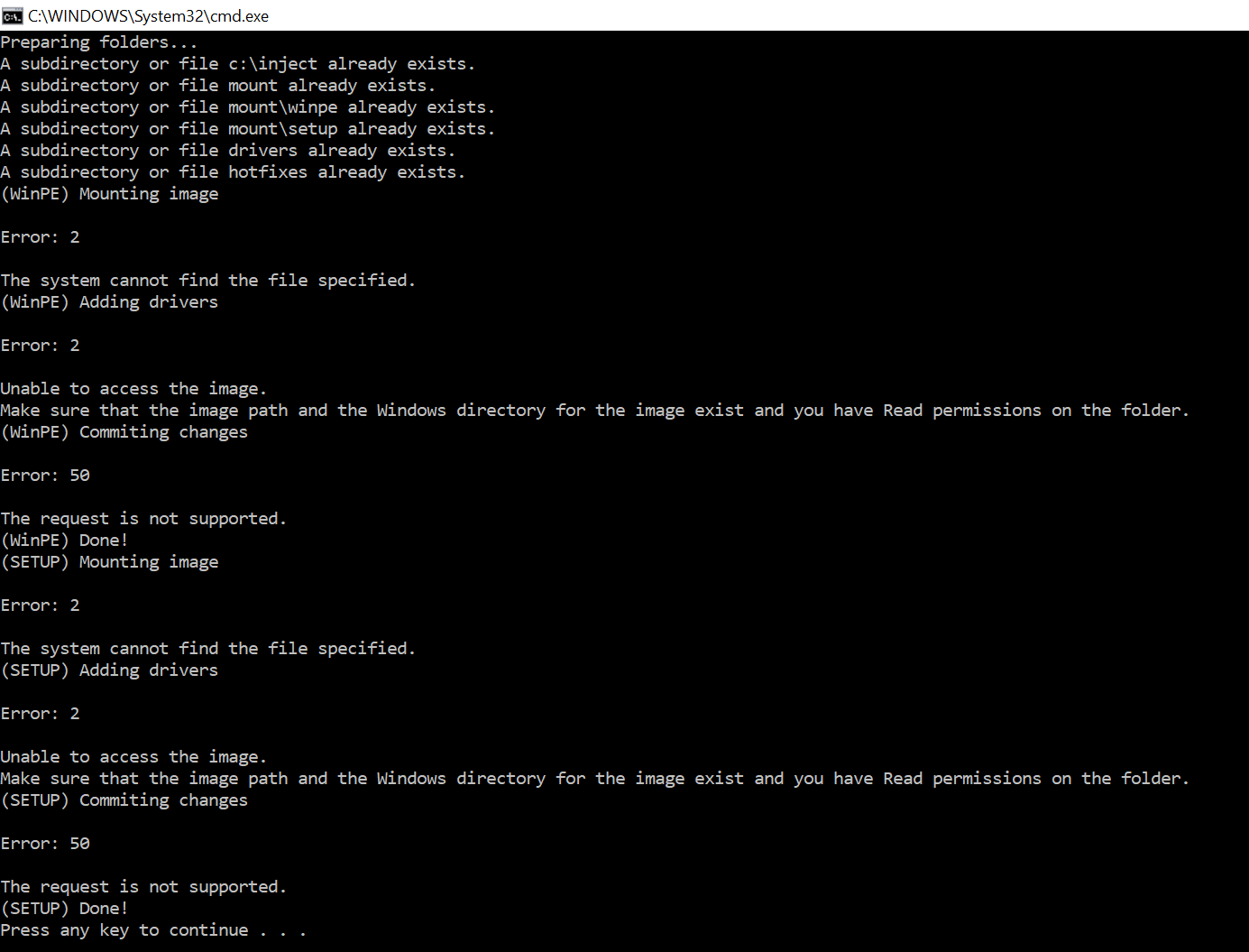

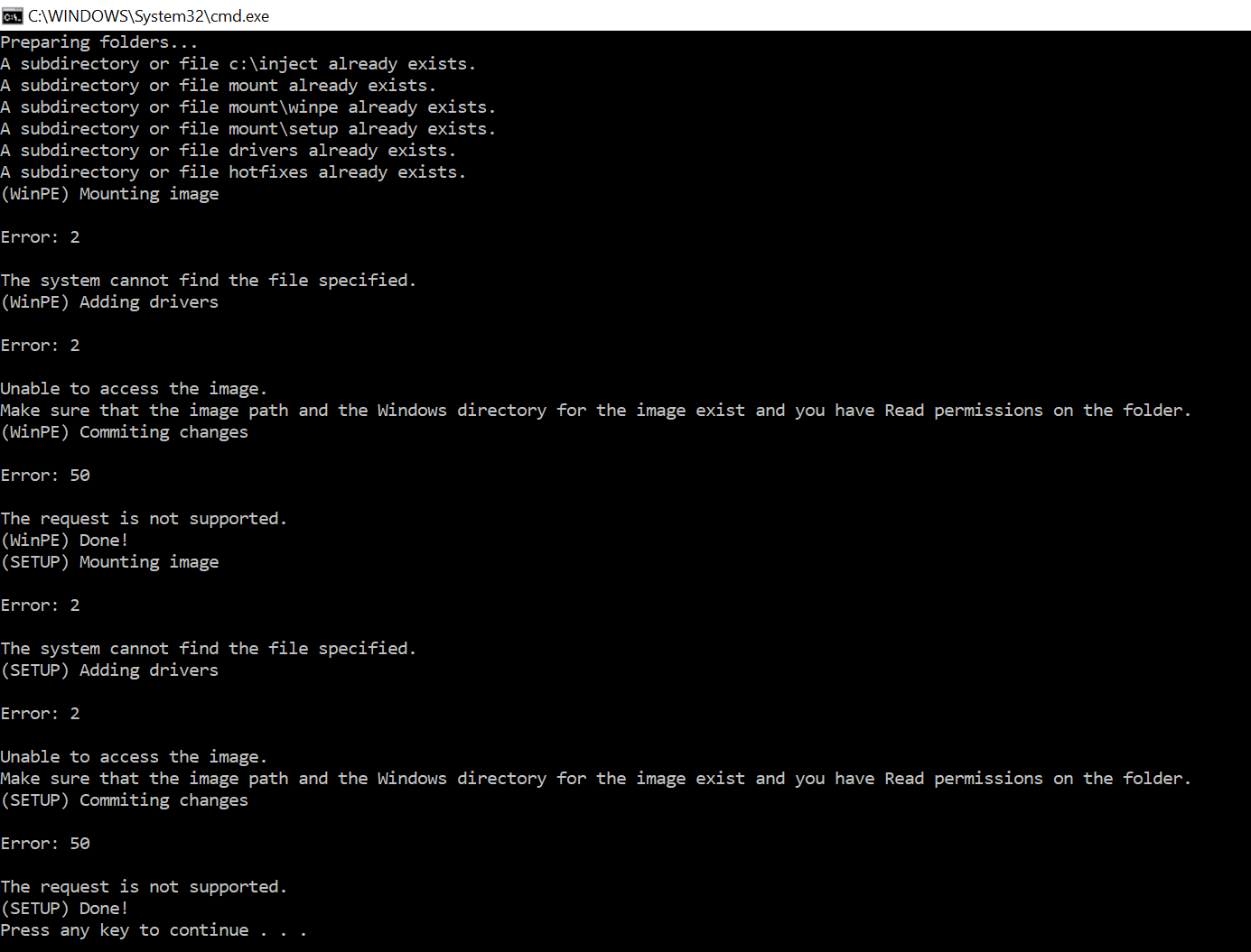

When I try to do Boot.wim.bat it gives this error, any suggestions?
UPDATE: I just realized was it C:/ on the USB or C:/ on the MBP?
Is anyone there? I really need help.

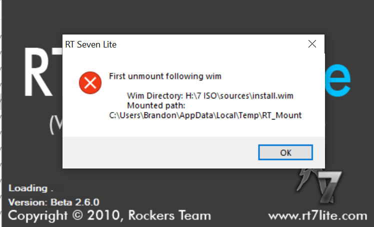

I’m still alive. Don’t worry. Instead of using the bat file, try RT7Lite’s driver integration and pick the .inf file from each of the driver folder (including the AMD one). DO NOT check either “boot.wim only” or “install.wim only.” That is, you leave either option unchecked. It should do the same thing and allows you to integrate all drivers rather than the batch.

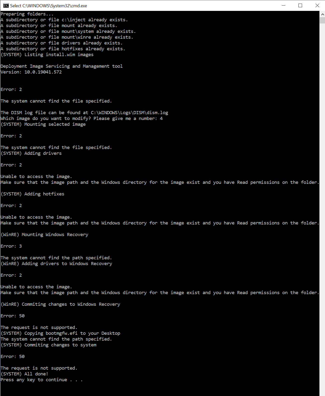

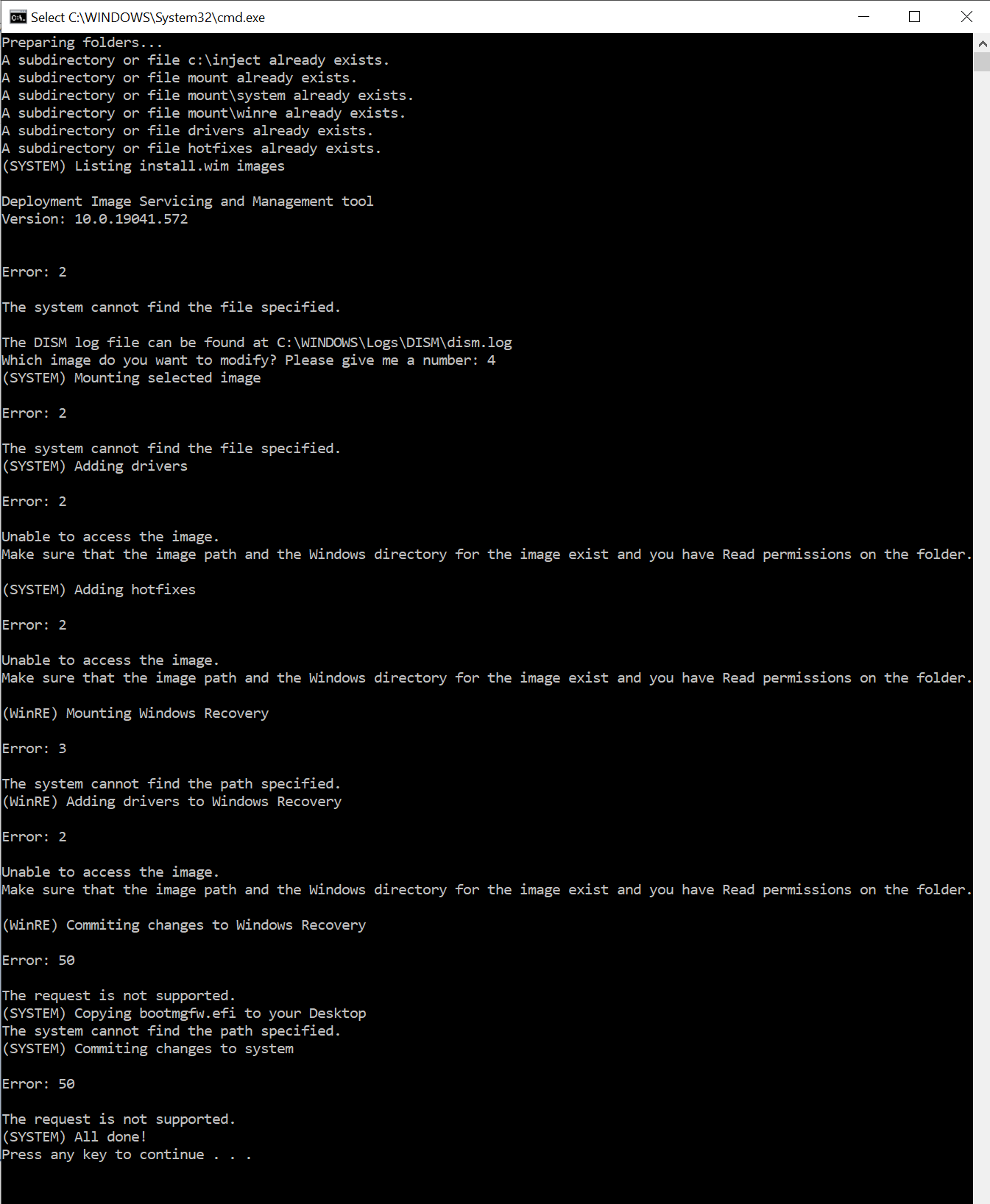

also when I do install.wim.bat, it does this. (If someone completed this, and still has their MBP early 2015 can they make a vid? Plzzzzzzzzzzzzz)
Yes. You integrate the hot fix and you rebuild all images. I cannot make videos since I’ve sold mine.
Thx! I also wanna say how much I appreciate your work, but also when I do the install.wim bat it fails, can u help me with this? :)
As I’ve said, you use RT7Lite to replace *both* the batches not just the boot.wim. You don’t check any additional restrictions in the software for the same reason.
Okay, that worked. This is what I did, correct me if im wrong. I copied the installer files to my USB. Then I did select OS path and selected the USB. Then I pressed cancel and it started loading the image. When it finished loading I went to tasks and then checked integration. Then I went to integration and added the hotfix. Then I went to drivers and added all the .inf files. Then I pressed apply. Then I left it on Rebuild all images. Finally I pressed commit.
It should work (although AMD GPUs..... you’ll never know). If not, please try working on an ISO file directly and set a temporary decompressing folder that has ~10GB of space. If that still fails, try an external monitor. If that still fails, inject only the AMD driver and use an external monitor. If that still fails, then I would succumb to my defeat since my model uses Intel GPUs.
