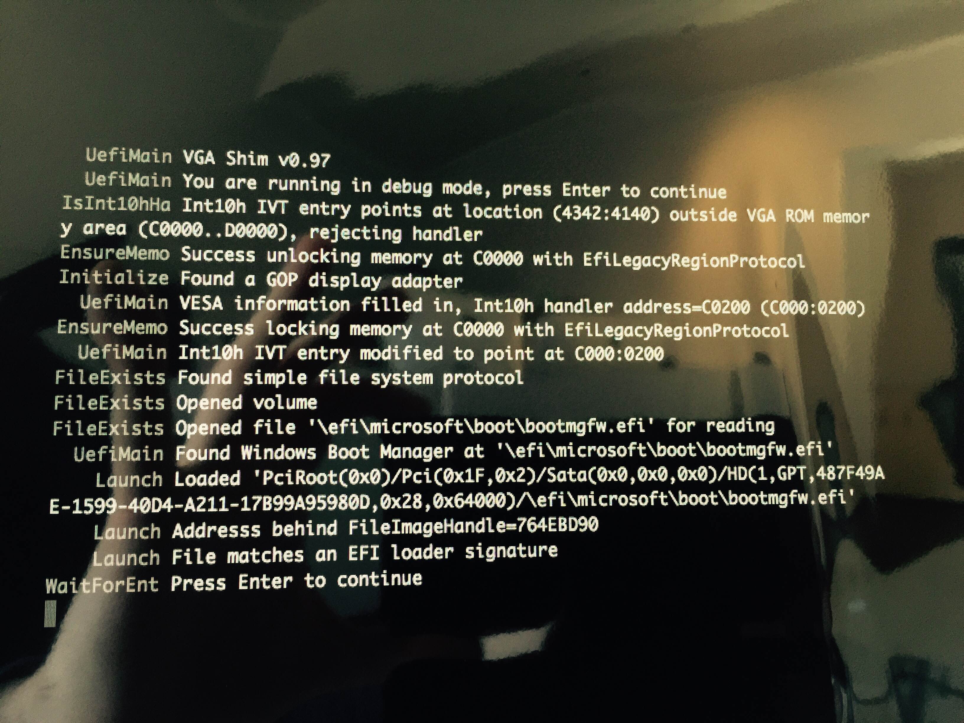

I wrote a little app that:
  1. Pretends to Windows 7 the initialization stuff it wants to do gets done.
  2. Responds to Windows 7's legacy queries about video mode enabling it to draw stuff on screen.
  3. Displays Windows boot animation.
For a more technical explanation see the GitHub repo.

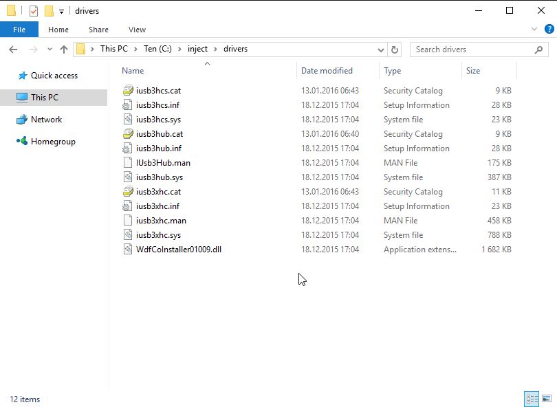

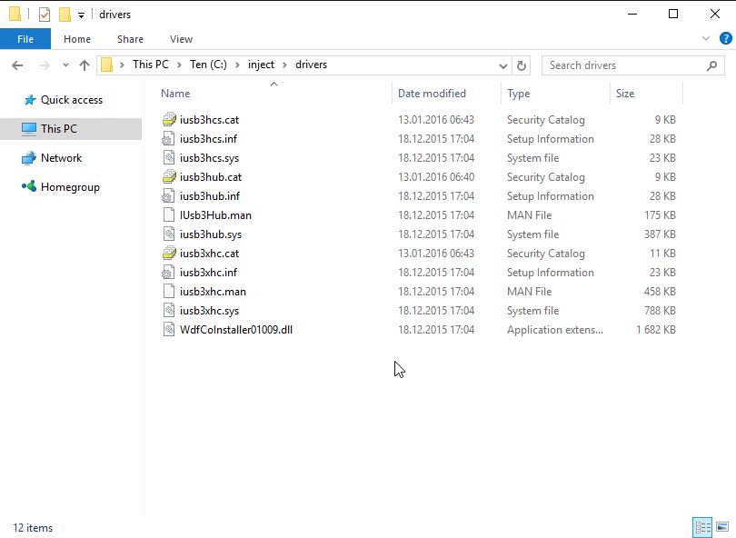

  2. Prepare folders and files for integrating USB 3.0 drivers and the above hotfix into Windows 7:

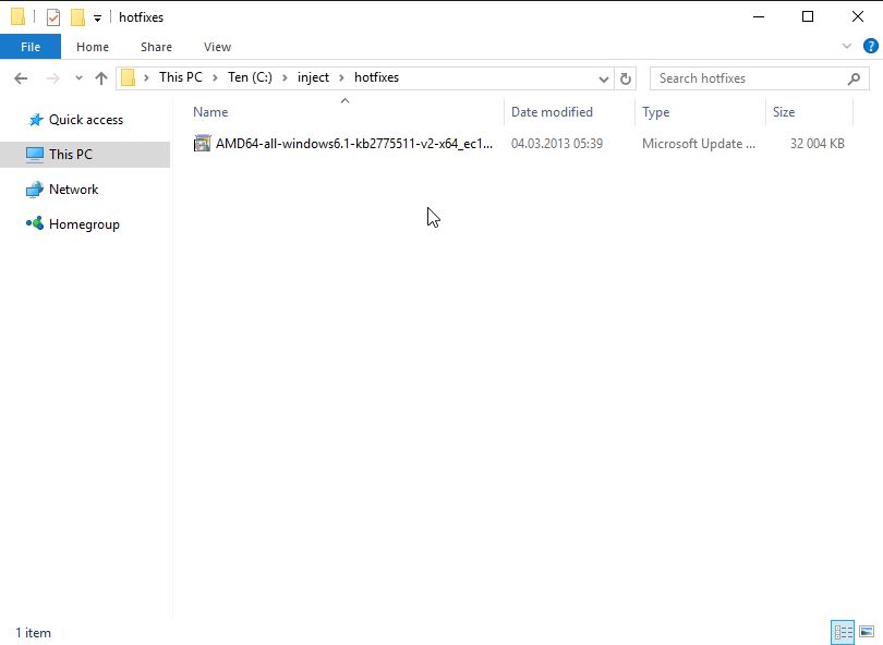

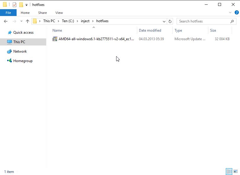

    1. Create a C:\inject, C:\inject\drivers and C:\inject\hotfixes folders.
    2. Copy AMD64-all-windows6.1-kb2775511-v2-x64_ec18cc10e27faf443c17e7a8073c9eba773eb13e.msu to C:\inject\hotfixes.
    3. Unzip USB 3.0 drivers somewhere and copy contents of Drivers\HCSwitch\x64 and Drivers\Win7\x64 to C:\inject\drivers.
    4. Copy sources\boot.wim and sources\install.wim from your Windows 7 SP1 x64 CD or ISO to C:\inject.
    5. Copy do_boot.wim.bat and do_install.wim.bat to C:\inject.
    6. Your C:\inject folder structure should now look like in the screenshots.

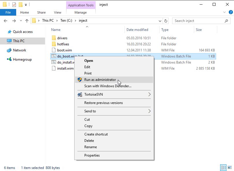

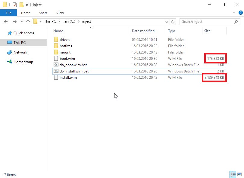

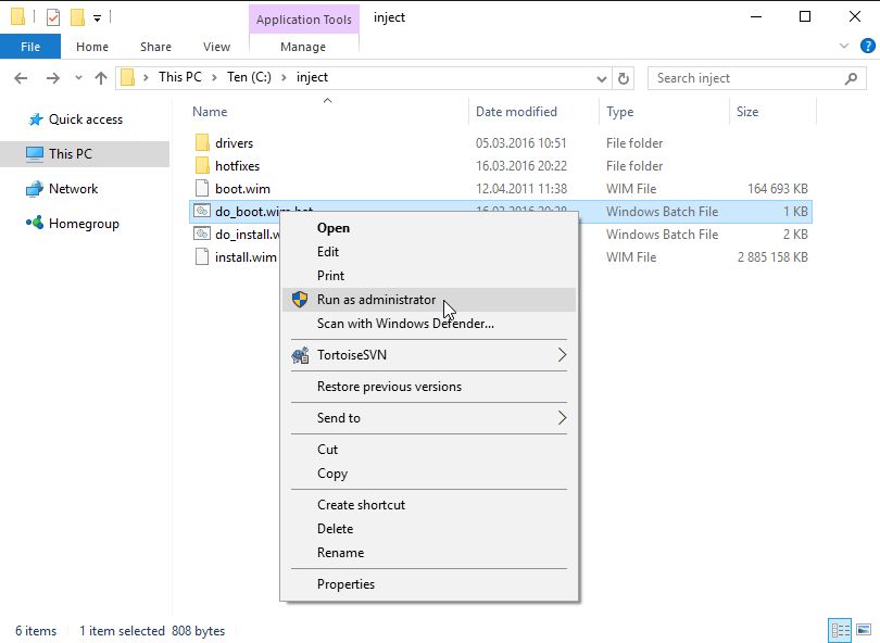

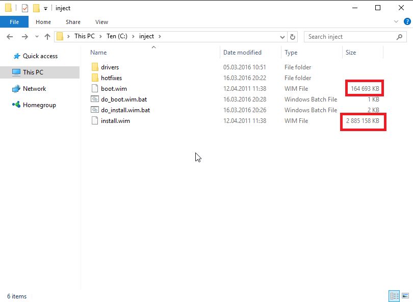

  3. Perform actual integration:

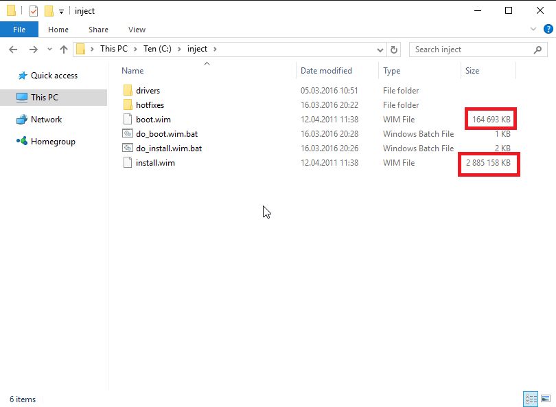

    1. Make note of the size of your boot.wim and install.wim files.
    2. Right click do_boot.wim.bat and run it as administrator.
    3. Right click do_install.wim.bat and run it as administrator. You will be asked which of the Windows 7 install images (Home, Professional, etc) stored inside install.wim you want to modify. The script will also try to copy bootmgfw.efi to your desktop which you will need later.
    4. Make sure the size of boot.wim increased by about 10MB and that of install.wim by about 250MB.

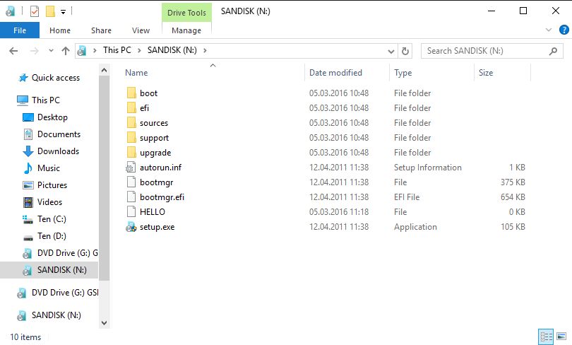

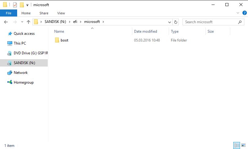

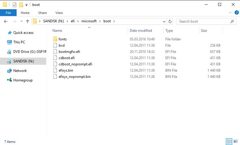

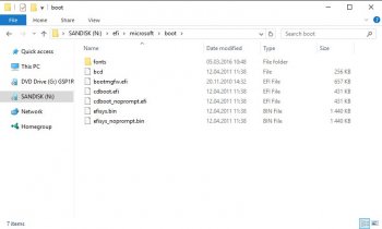

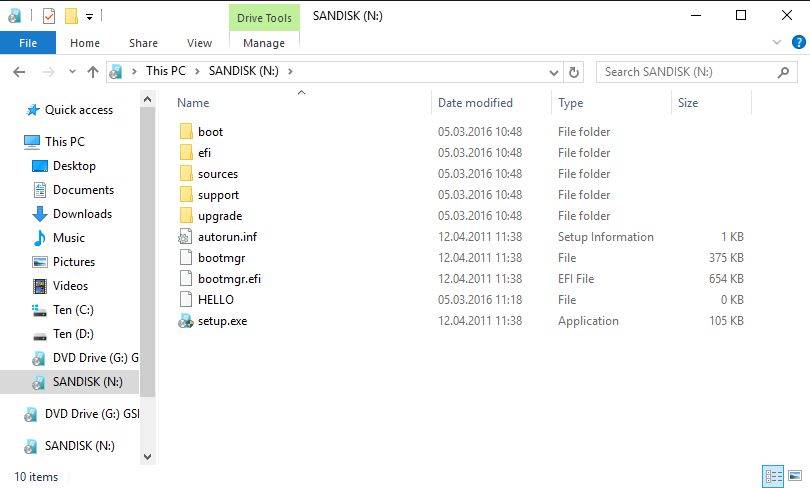

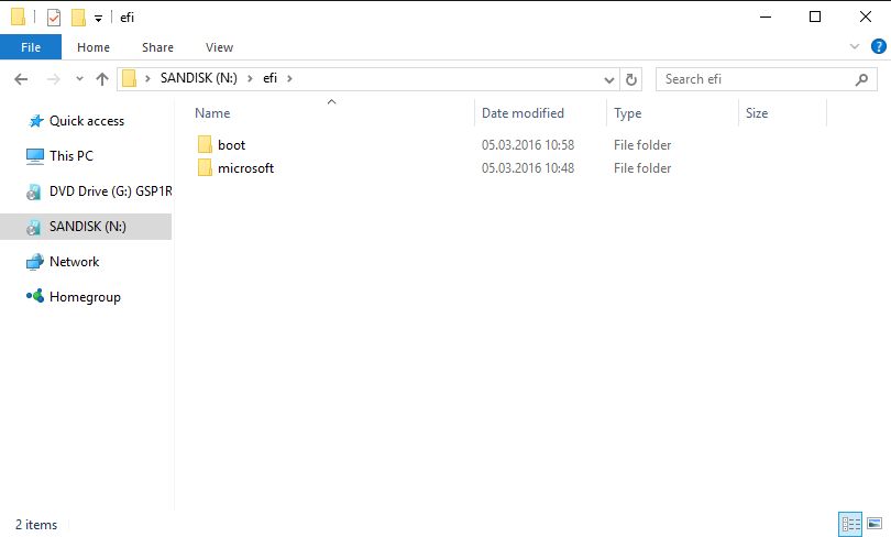

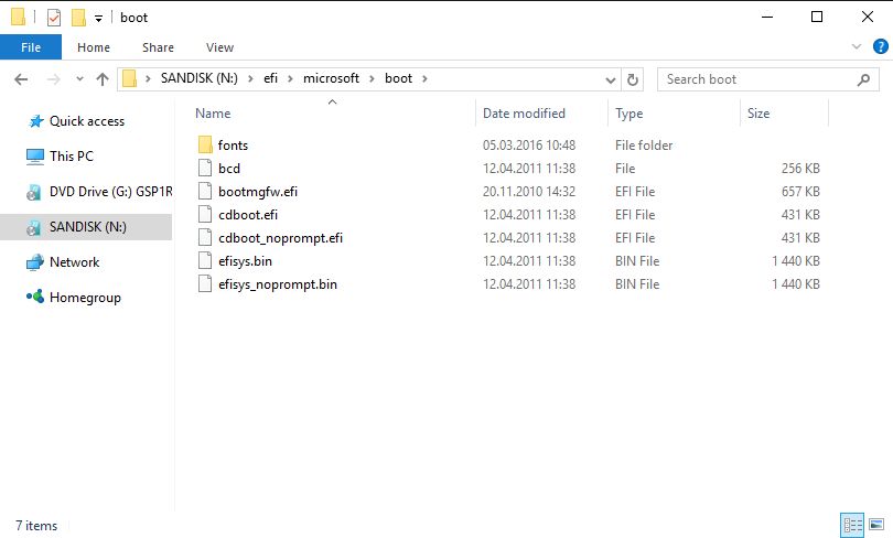

  5. (Finally!) Copy the right files on your pendrive:
    1. The entire contents of your Windows 7 CD with the exception of sources\boot.wim and sources\install.wim.
    2. C:\inject\boot.wim and C:\inject\install.wim to sources.

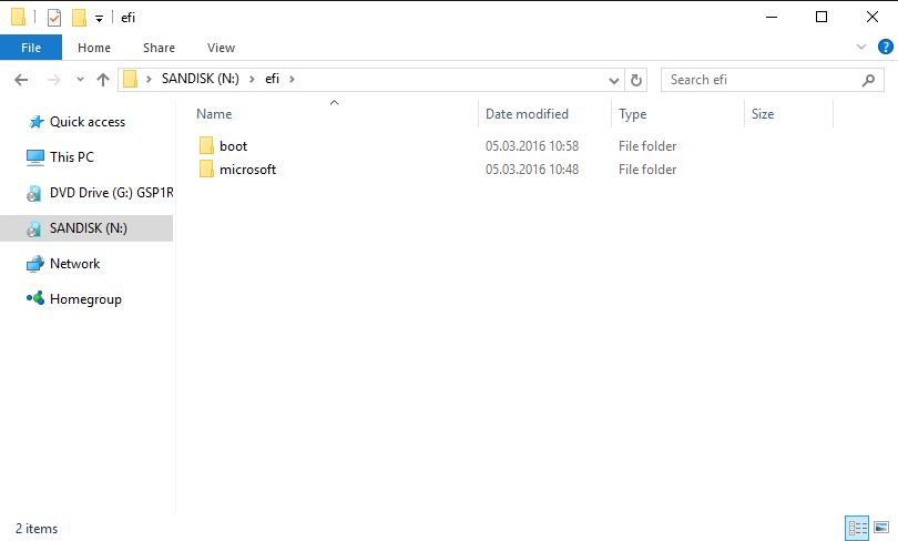

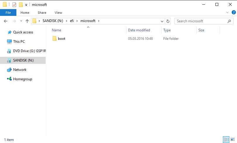

    3. Copy bootmgfw.efi from your desktop to efi\microsoft\boot.

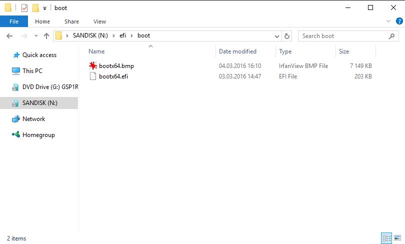

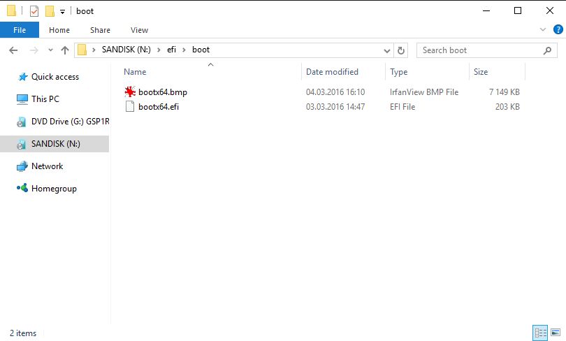

    4. Rename VgaShim.efi to bootx64.efi, VgaShim.bmp to bootx64.bmp and copy both files to efi\boot (you will need to create this folder).
    5. Create an empty file or copy a small file of a known name to the root of your pendrive. It is there only so that you can easily recognize your pendrive just by looking at a file listing. (I created a file named HELLO.)

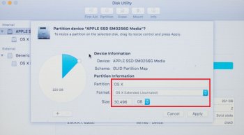

Disable OS X System Integrity Protection
May not be necessary but this is what I did at the very beginning. Follow any of the many guides on the web; I used this one.

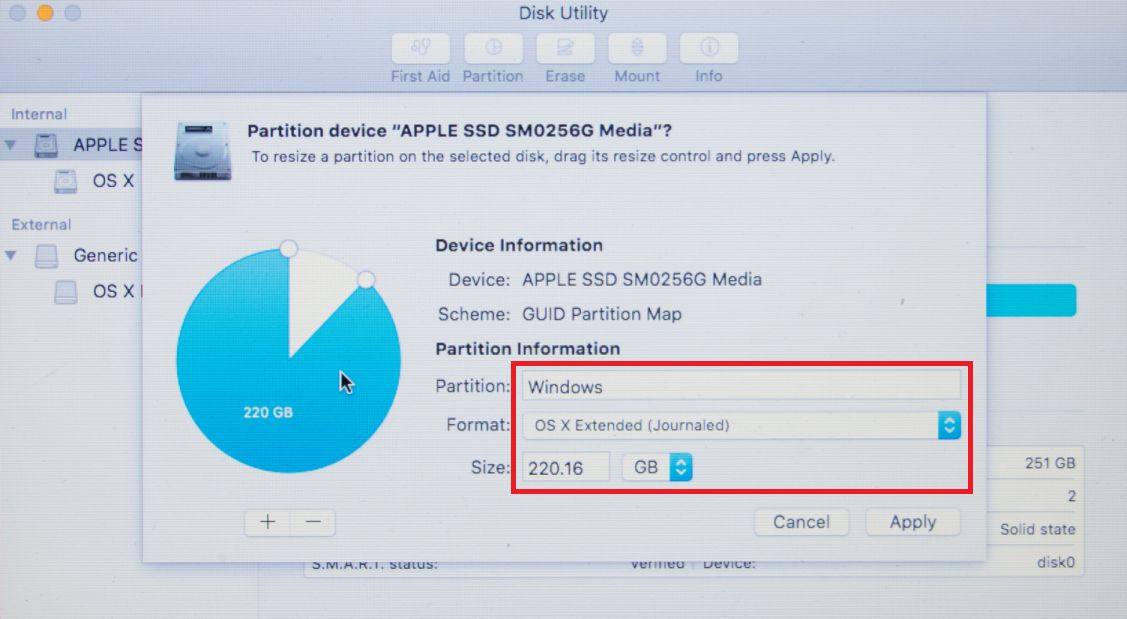

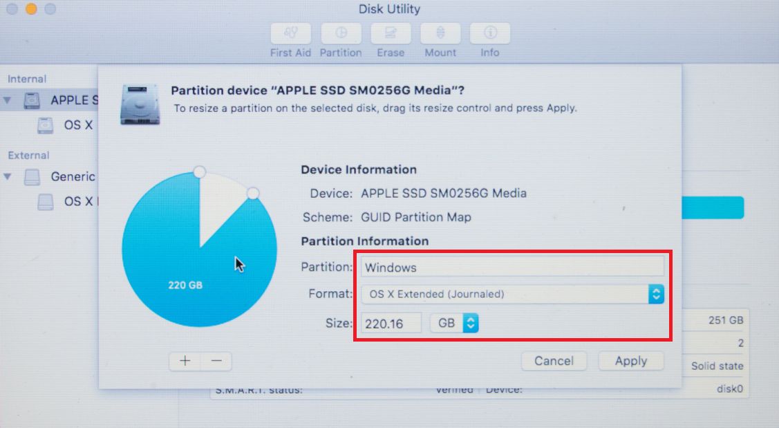

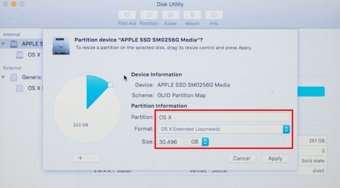

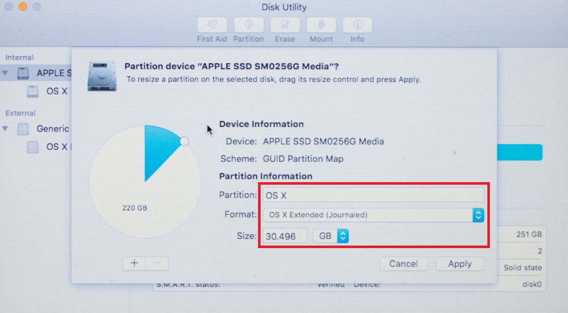

Partition Mac Hard Drive
  1. Make sure you've backed up all your data on the target MacBook.

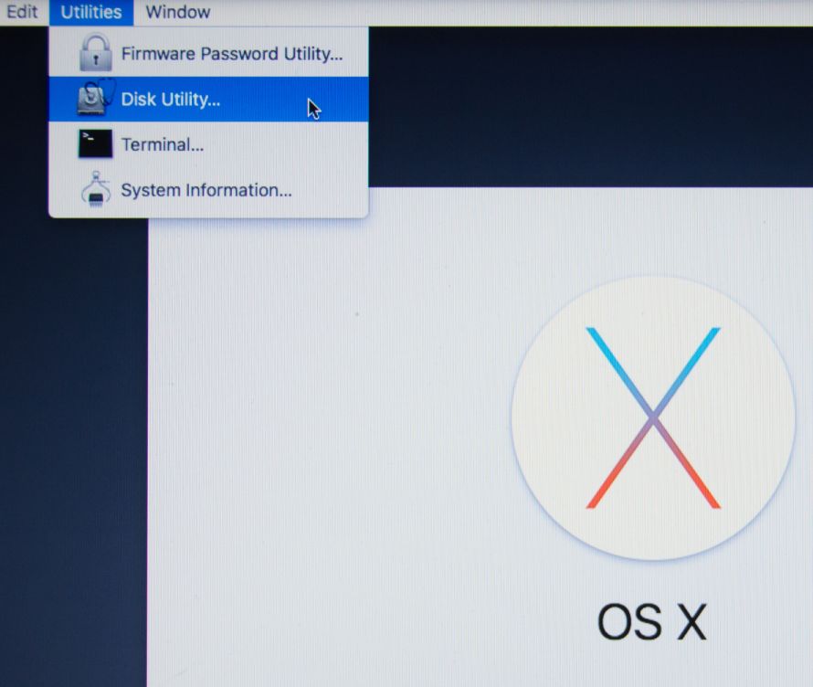

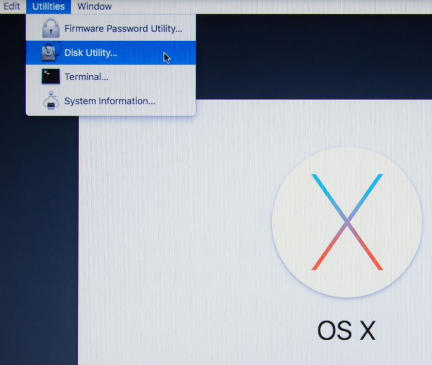

  2. Boot from your OS X install media.

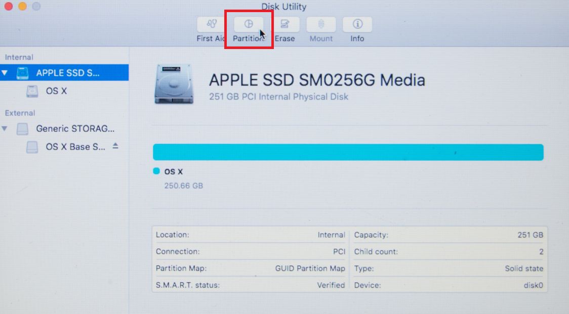

  3. Run Utilities > Disk Utility.
  4. Click Partition.
  5. Configure your drive to have two partitions: one for OS X, formatted as "OS X Extended (Journaled)", and one for Windows also formatted "OS X Extened (Journaled)". This is important because if you format it as FAT32, Disk Utility will create a hybrid MBR and Windows 7 will refuse to install on a non-pure-GPT. (See screenshots.)

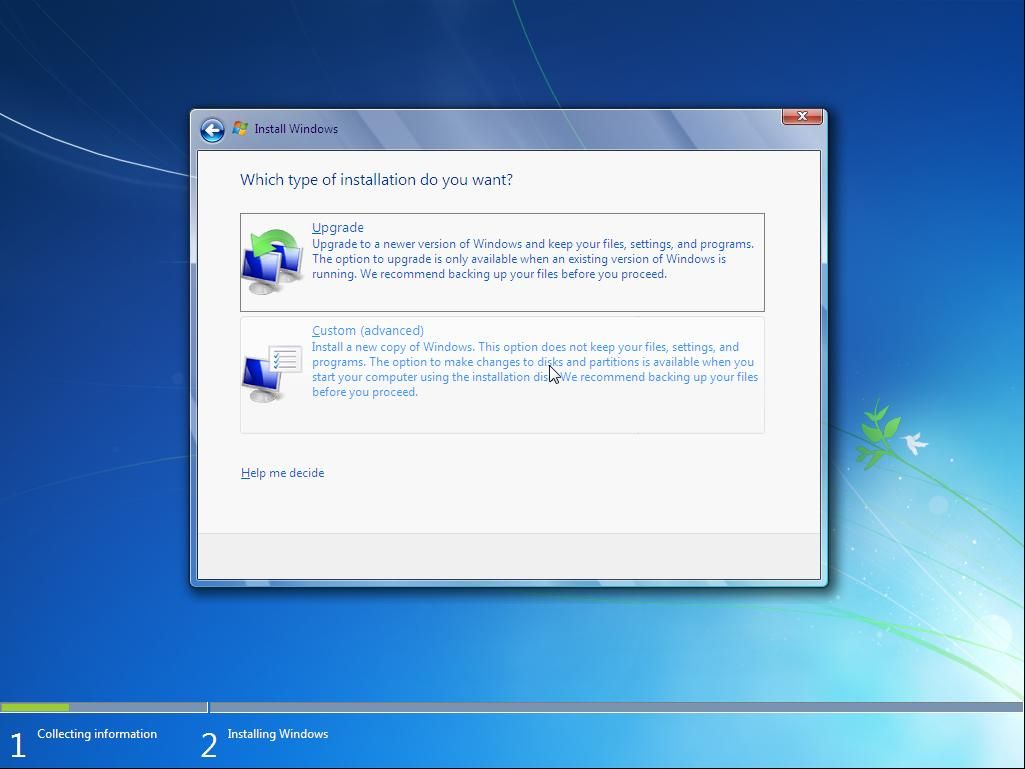

  1. Boot from your Windows 7 install media.
  2. It will show a blank screen for the first 30 seconds as it loads the WindowsPE environment but should then display the familiar setup welcome screen.
  3. If your touchpad or keyboard do not work you did not integrate USB 3.0 drivers correctly — both devices are internally sitting on the USB bus.

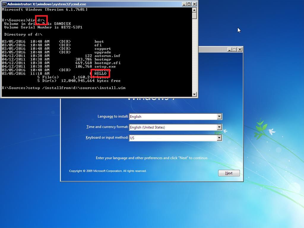

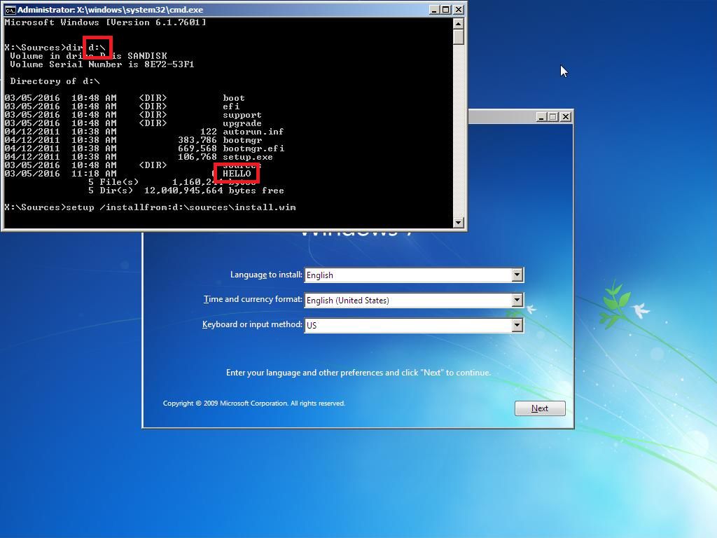

  4. Do not press any installer buttons but Shift+F10 to bring up a command line window. We will need to tell setup where your install.wim file is located because otherwise it complains about not being able to find it; this is where the empty HELLO file will come in handy.
  5. Run dir c: to list files on this volume. If you do not see your magic file, try dir d:. If that does not work you can run diskpart and then list volume to list all available letters.

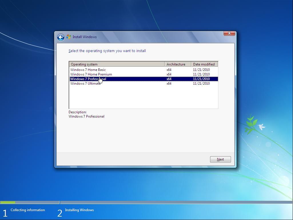

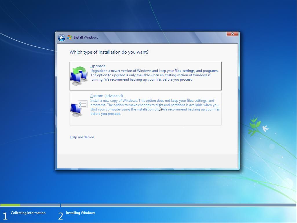

  6. Run setup /installfrom:<your letter>:\sources\install.wim

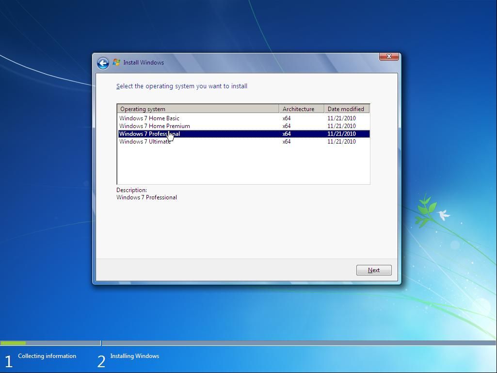

  7. Choose your language, accept license, select Windows version you want to install and then Custom (advanced) to access disk partitioning.
  8. Select the Windows partition you created earlier using Disk Utility.
  9. Click Drive options (advanced) to see all options and then Format the partition.
  10. Click Next and watch Windows copy and unpack files.

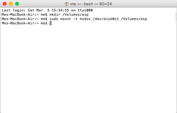

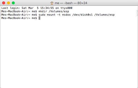

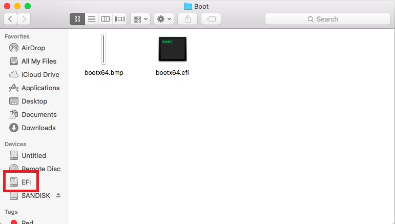

  2. Open Terminal and mount the hidden ESP partition which holds the boot loader:
    1. mkdir /Volumes/esp
    2. sudo mount -t msdos /dev/disk0s1 /Volumes/esp
  3. Plug your Windows 7 install media.
  4. In Finder copy the efi\boot folder from Windows 7 install media to the EFI folder on the ESP volume you just mounted.
  5. In the Terminal window run sudo bless --mount /Volumes/esp --setBoot

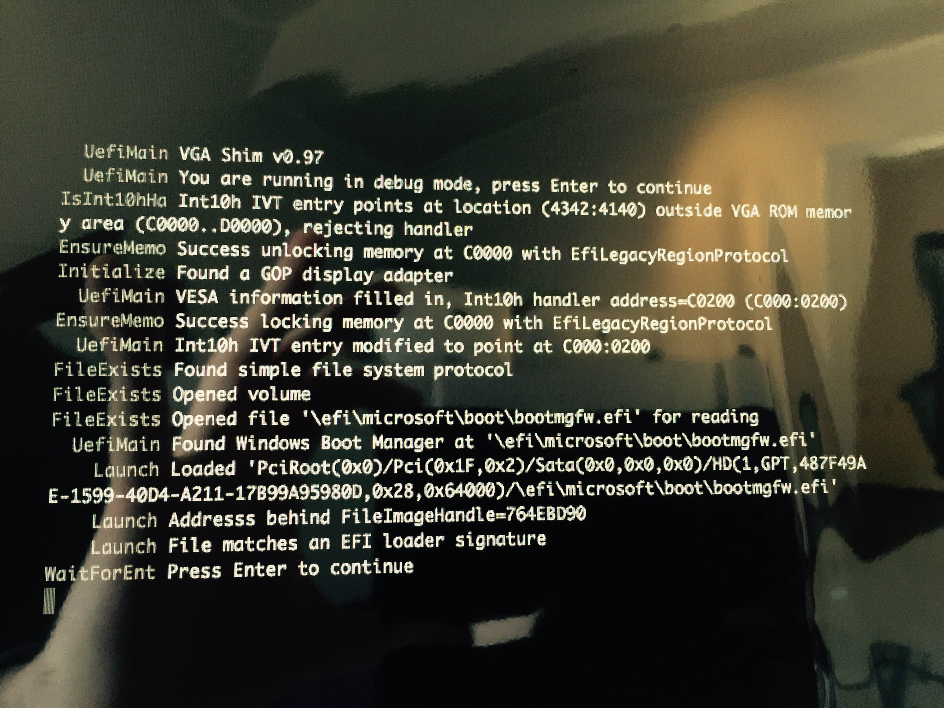

  • Debug mode. If you keep 'v' (for 'VGA Shim') pressed during boot, you will enter debug mode that will tell you what the program is doing. Can be useful if it does not seem to work correctly or when we try to make it work on machines other than MacBook Air Early 2015.

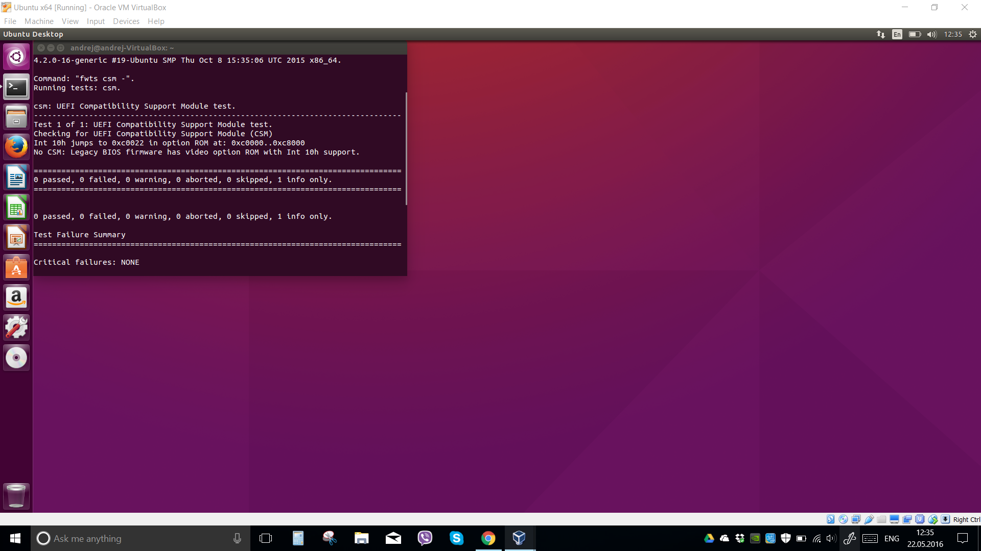

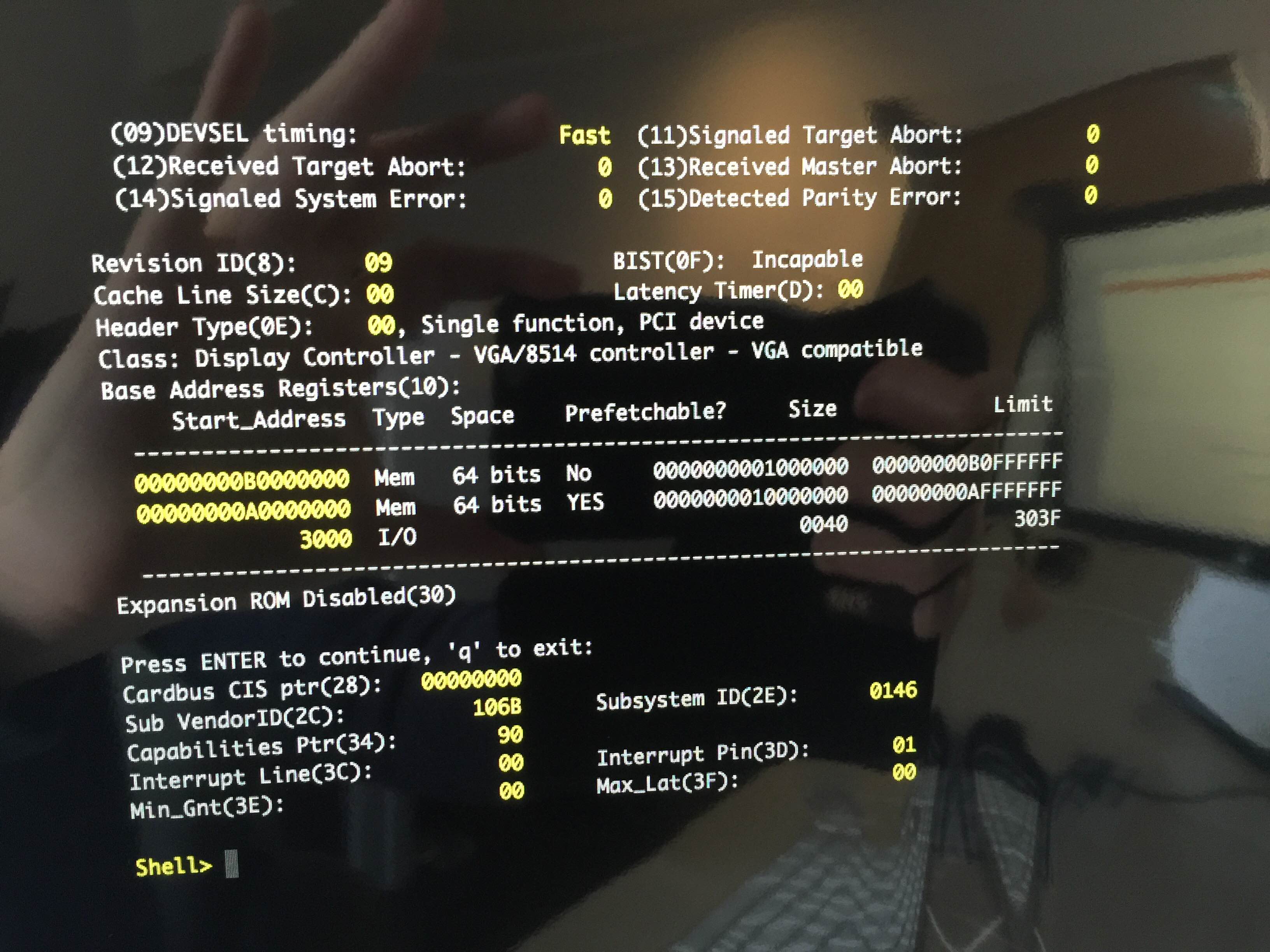

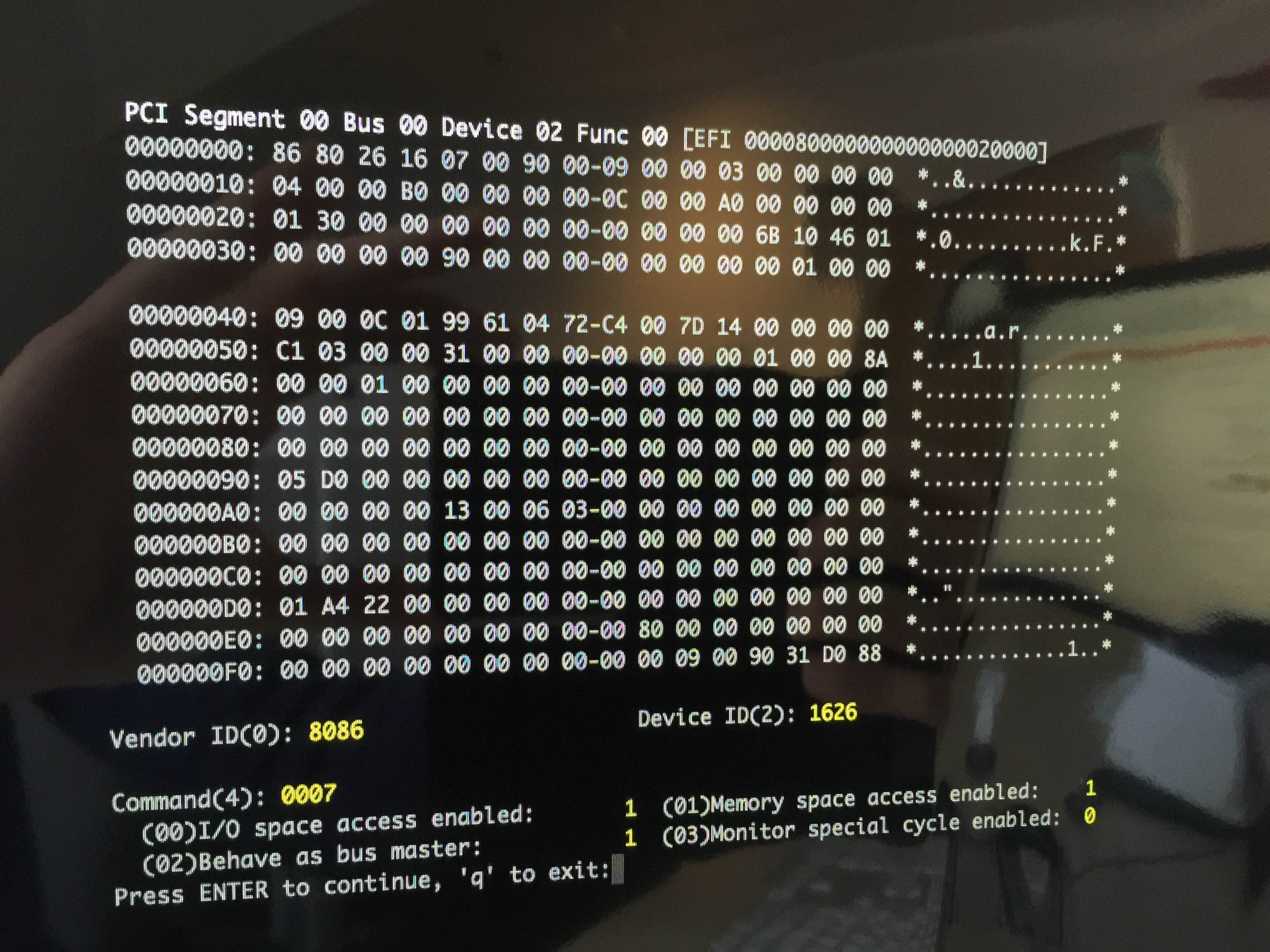

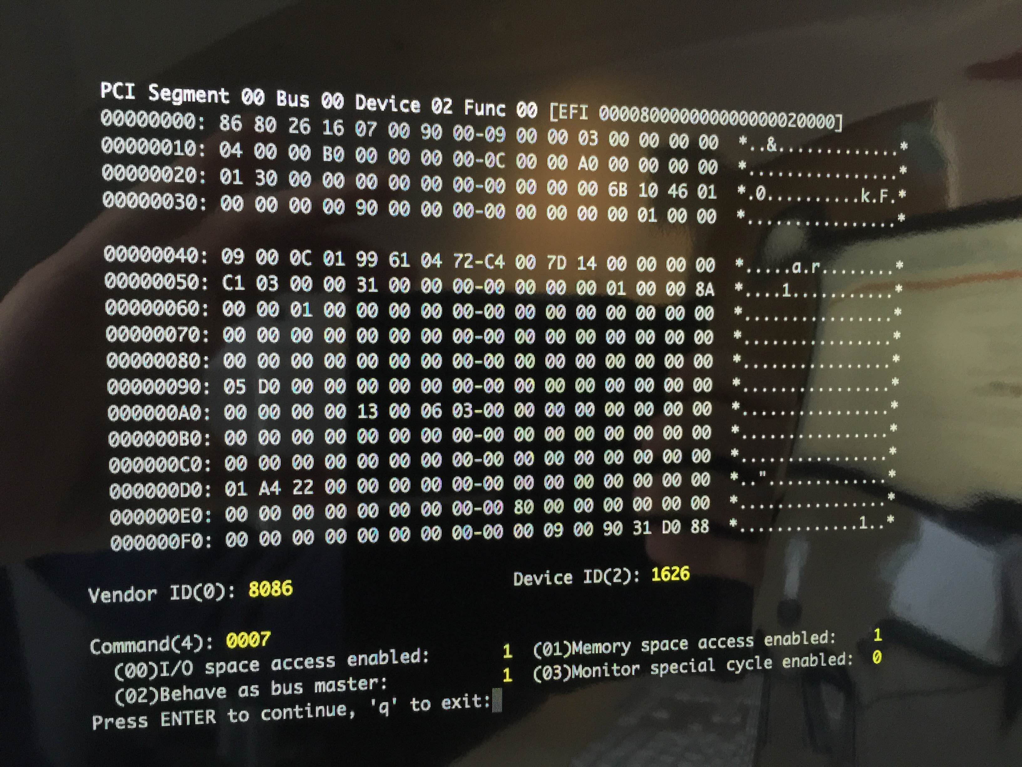

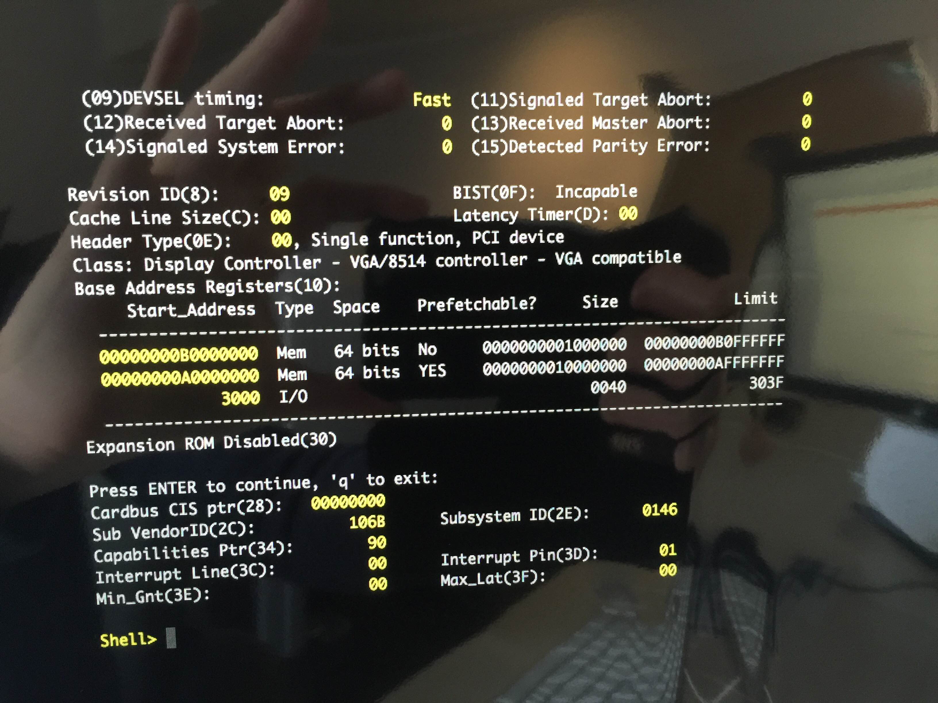

Appendix A: What Did Not Work
Thought I'd share my failures too so that others do not waste their time in the future trying to go down the same paths.
  1. At first I assumed it is winload.efi that is causing problems. Tried replacing it with one from Windows 8, 8.1 or 10 to little success. (It later turned out winload.efi is surprisingly fine and does detect modern EFI-style graphics.)
  2. When that failed, I took to the EFI firmware to see if perhaps the boot manager is the one preventing legacy systems from loading. That is, that legacy loader that emulates BIOS with all its legacy calls is still present in the firmware as it has been since MacBook1,1 — just hidden away by Apple. Having dumped EFI firmware using flashrom and unpacked using UEFITool, it unfortunately turned out no legacy loader was included in EFI firmware.
  3. I tried massaging Windows into not doing any legacy stuff. I turned on quietboot in BCDEdit so that bootvid:InbvEnableBootDriver would set InbvDisplayState to INBV_DISPLAY_STATE_DISABLED (preventing some accesses), hex edited bootvid:VidInitialize to always return false (preventing other accesses), hex edited hal:HalpBiosDisplayReset not to do the int10h call, and wrote simple dummy VGA save miniport (vga.sys replacement), miniport (vgapnp.sys replacement) and display (vga.dll replacement) drivers that did nothing at all other than report 'all cool'. Still no joy which probably meant I missed an int10h call somewhere. Decided to look elsewhere as I also felt this solution was not very elegant.

Hi Davidcie,
Thanks for your interest in the project.
Unfortunately on my mac 16.1 (late 2015) have failed to install win7.
The first problem is presented during the installation of windows, in fact inserting the USB pendrive (following the guide) appears only the windows logo.
I then decided to try to do the installation via the windows 10 cd, the cd boot is successful, shift + 10 and install Windows 7 via USB pendrive.
The installation is performed without problems - then I install El capitan - and I install vgashim in osx.
On restart run VGA Shim - but also leaving the mac for an hour remains the windows logo and does not boot in windows 7.
Please see attached screenshot Debug Mode VGA Shim
Could you please help me, let me know what you need.
Thanks,
Marco

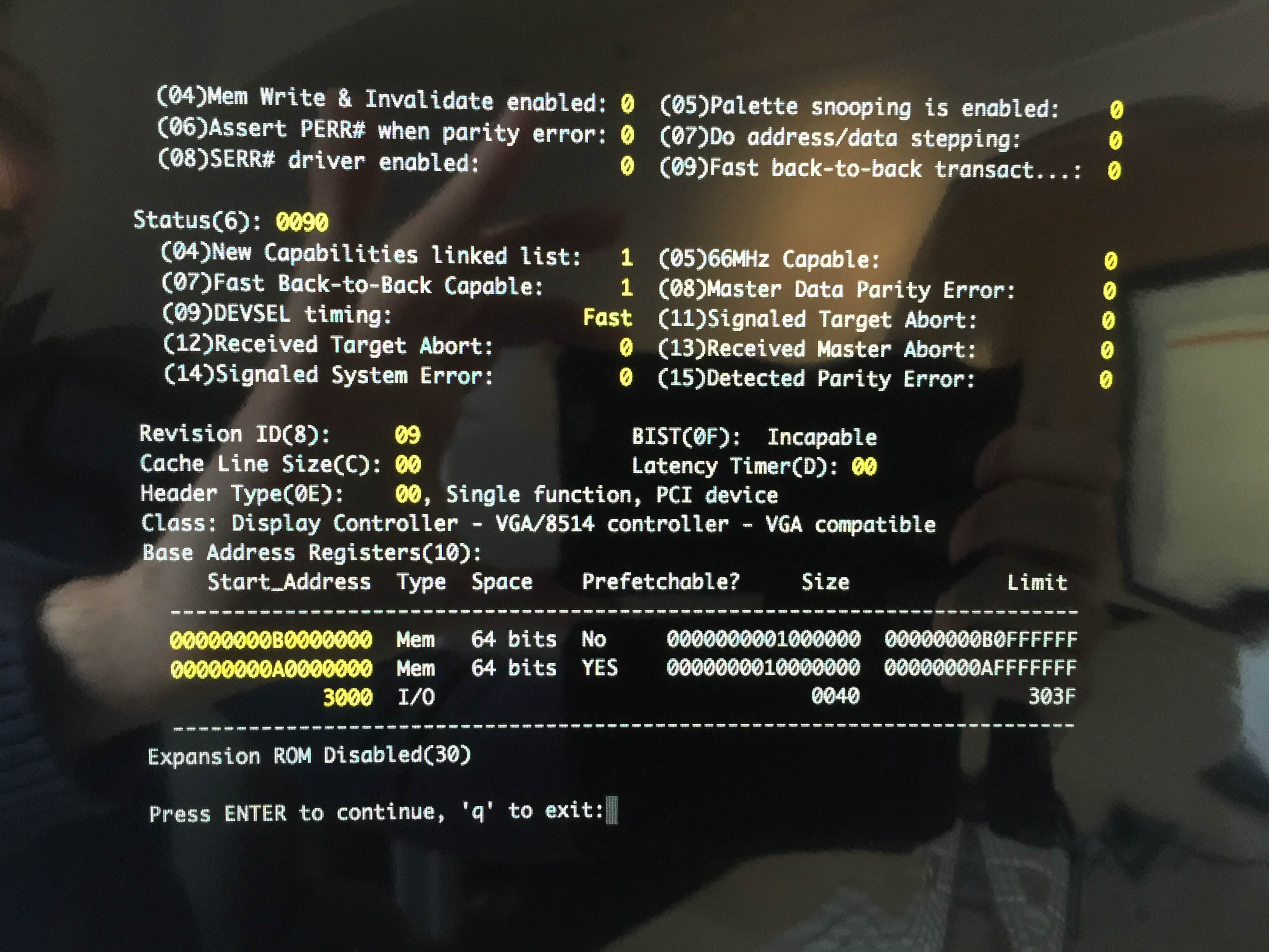

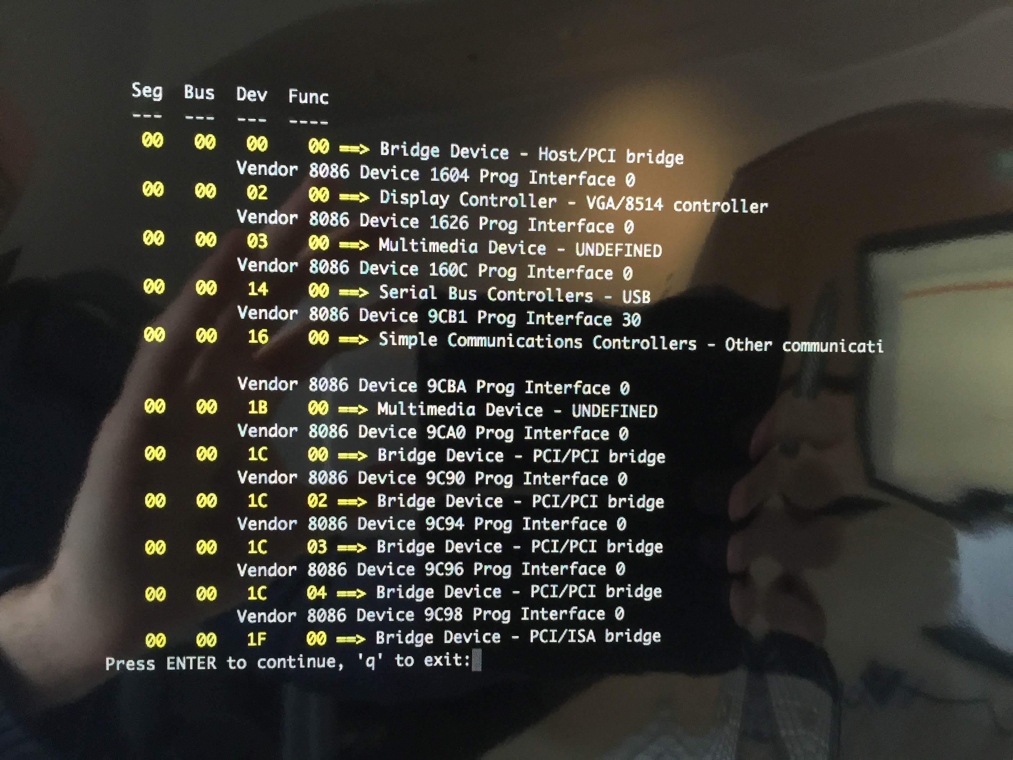

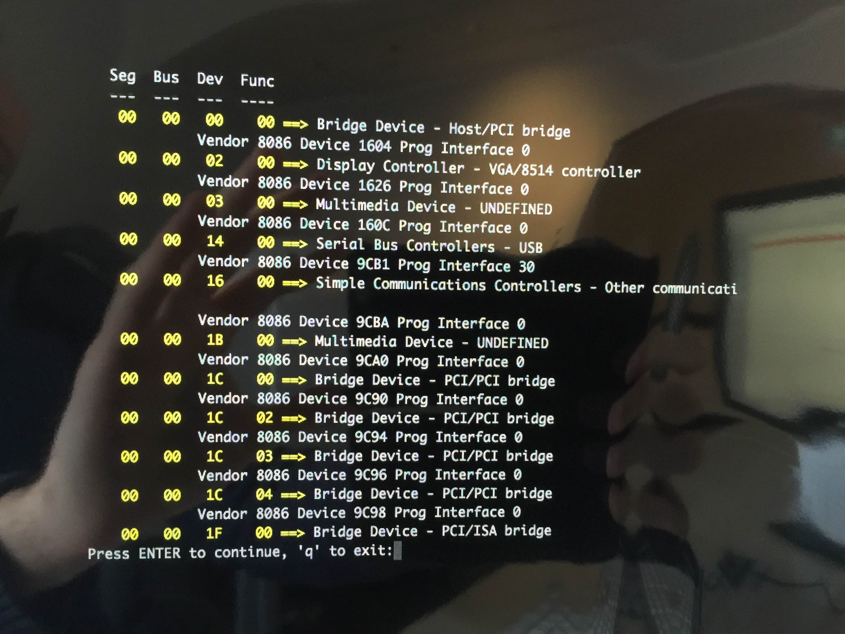

@marco271093, is that an iMac16,1 (there's no such thing as Mac16,1)? Looking it up on EveryMac I can see that it's also got an Intel HD 6000 card and no other, so theoretically VGA Shim should also be able to help. What's suspicious is that you are unable to run pure Windows 7 setup. All I can think of for the time being is PCI registers, so either bus master, I/O space access, memory space access or VGA enable (VGAE) bits are not set. You can establish that running EFI shell and first making sure what your card's bus/device/function numbers are with pci -b (on the Air it was 00/02/00, respectively) and then running pci -i <bus> <device> <function> -b Look carefully at the output and you will have all that information presented.
It's not easy to find EFI 1.0 shell binaries as most are from the EDK2 project and do not run on Apple EFI 1.10 implementation; you can use the one attached, just remove the .txt extension.
(Easiest way to run the EFI shell at this point would be to rename it to bootx64.efi and replace it for VGA Shim in the EFI\Boot folder on the ESP partition.)

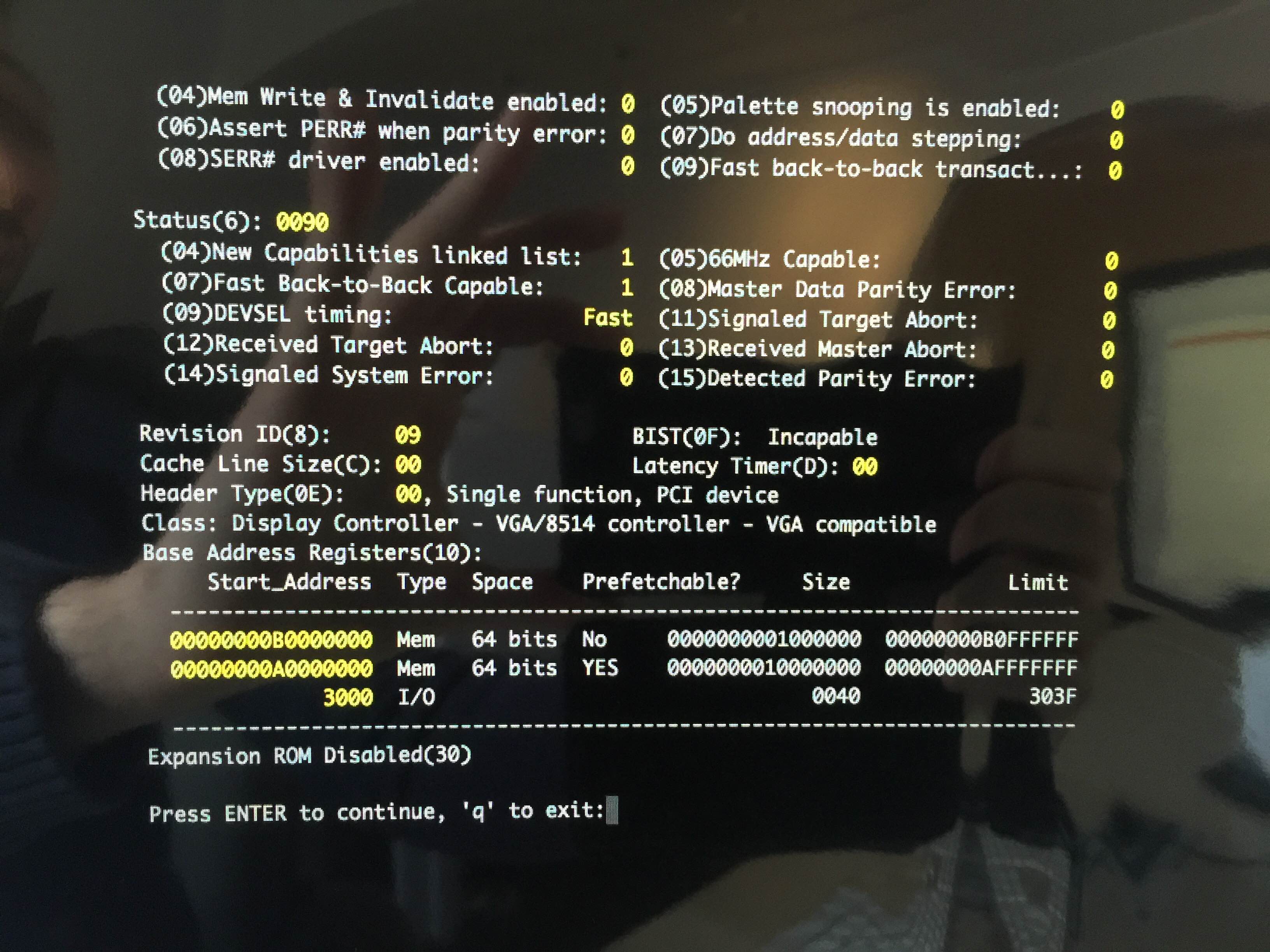

Hi Davidcie,
Thanks for your quick response.
It seems that everything is ok, please see attached image.
Thanks,
Marco

@marco271093 congrats on making it this far and general computer skills 🙂
If nothing is drawn on screen despite PCI registers being set correctly then perhaps it is the framebuffer/resolution info that is incorrectly detected and/or not liked by Windows (it is these calculations that enable Windows to draw on screen in addition to "not hang"). Will try to implement printing additional info that would help us see what is going on later today.

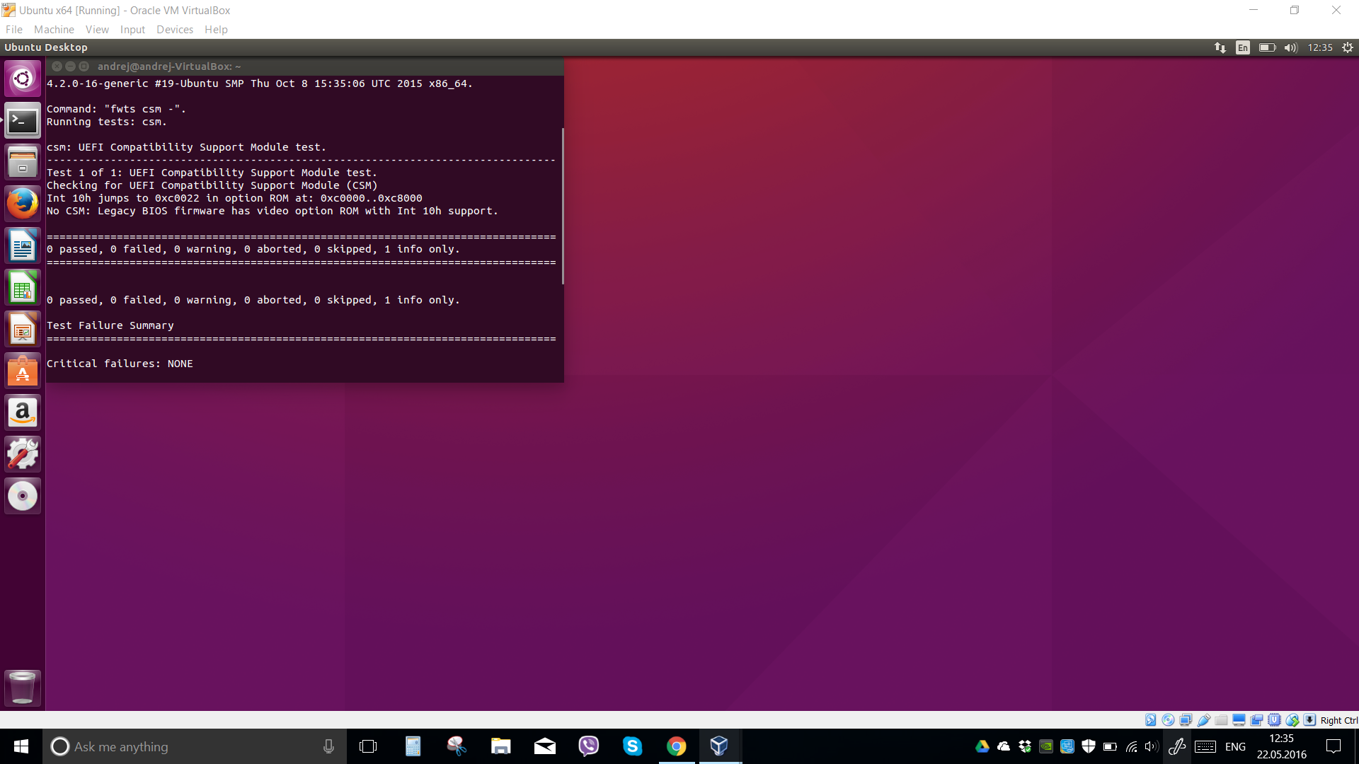

Hello there,
Recently I found about this workaround for booting Windows 7 together with GOP. But there's one problem, I really don't have Mac Air 2015 or any other Mac product, I have Acer E5-573G, but most important part is that I have dual graphics, one Intel HD 5500 and other Nvidia 940M.
Since there is no other place where to write an input, I didn't have any other choice than to post here (sorry again that I don't have Mac 😛 )
I tried this vgaShim but I've ran into trouble with it, I'll preview my issue in the debug pciture:
I've checked in AIDA 64 and I can confirm that VBIOS (but it's NVIDIA's one since Legacy Boot switches to that one) should be present in C0000...
Even tried to change the address in the source and compile, still same issue.
Any solutions if possible, I can use Legacy Boot but I'm really fed up from formatting my drive from GPT to MBR and vice versa, if not I'll just continue using Windows 10.
EDIT: Additional info (picture) attached, hope it helps.
