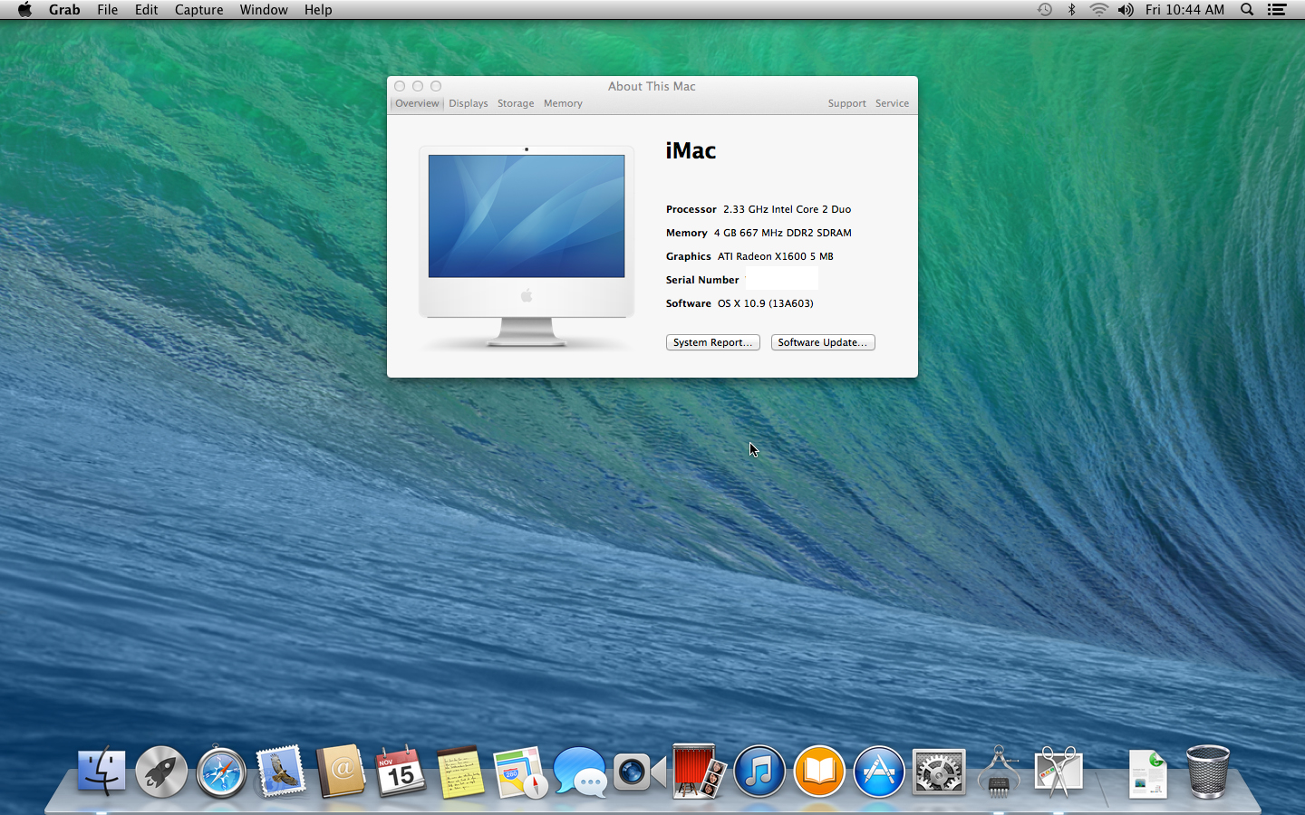

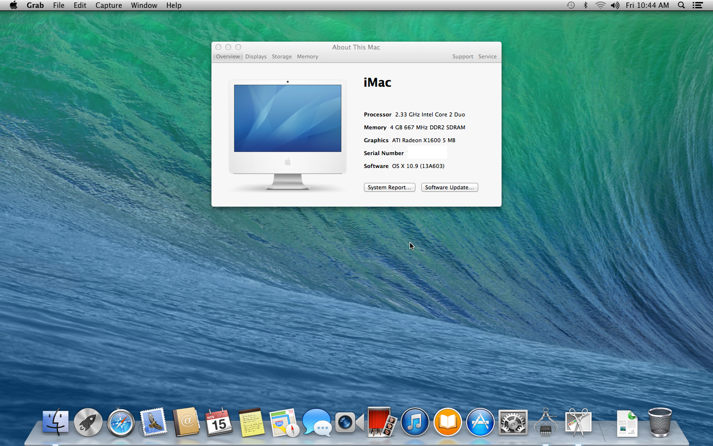

As it has been pointed out/strongly reinforced, despite what is actually achieved, the OS is barely usable if at all. Heck given my curiosity as to what is actually new about it, I basically used a year and half old guide (google dead.xx 10.8) files and all almost verbatim that I know from memory at this point (the exceptions being an additional edit to the "InstallableMachines.plist" and the VoodooHDA.kext for sound/audio) and I easily was able to get to a desktop of Mavericks on an iMac with ATI X1600 inboard graphics (don't let the 2.33 GHz fool ya...merely a CPU upgrade on the 17" 2006 that I was able to do for dirt cheap) with hardly any effort whatsoever:

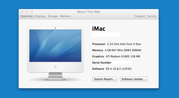

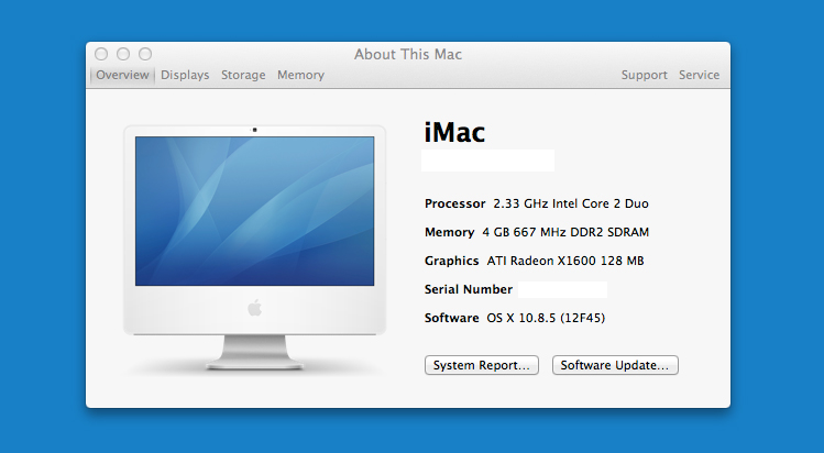

The best 10.8 hack for the iMac with ATI X1600 graphics that I have found currently is the utilization of the appropriate OS X 10.7.5 ATI kexts coupled with both the patched GL/CL frameworks. This set up provides a OS X 10.8.5 non "MLPF" 64 bit system that I would estimate @ 99.8 % full functionality. Repairing permissions, Little Snitch, graphic acceleration, are among several key components that fully operate in this set-up. And while nvram is not supported on this system, I have found that porting over an account from an OS X 10.7.5 Lion system coupled with the addition of the "PlatformUUID.kext" gets FaceTime/iCloud (though still no iMessages) to work.
I had been running the same system save with OS X 10.8.4 up until several weeks ago when Rastafabi, whom I have communicated/collaborated with on these topics now for some time informed me that the same set-up could be easily applied when upgrading to OS X 10.8.5 which I have since done.
