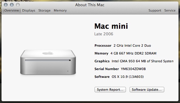

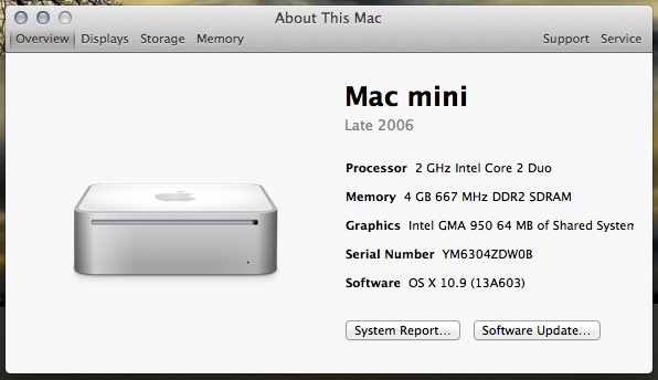

Early 2006 Mini 1,1 working.
Ok, I got Mavericks running on Early 2006 MacMini1,1 flashed to MacMini2,1 and C2D upgrade. I've been reading this forum for 2 days on this, this is my first post. Here is what I found.
Got audio Working. Used kexts from earlier post for macpro. Works great. Also used the same file for the 32bit boot.efi.
Wifi works. I copied my kexts from a 10.8.4 MLPostFacto install, Although it will not join any network that is encrypted, it only works with open networks.
GMA 950 works with 64bit drivers from Snow Leopard. Although there is no QE/CI, but the driver does load, and works very well aside from OpenGL.
I do have to hold OPTION key and select hard drive to boot, as it doesn't like to bless the 32bit boot.efi for some reason.
I do think there is great potential here with the GMA 950. Its not sluggish at all, other than the fact QE/CI won't turn on.
EDIT: Holding down OPTION key is fixed for 32bit boot.efi. Zapped PRAM, and it works without issue now. COMMAND+OPTION+P+R after boot chime.

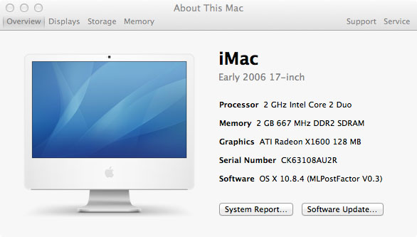

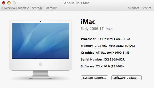

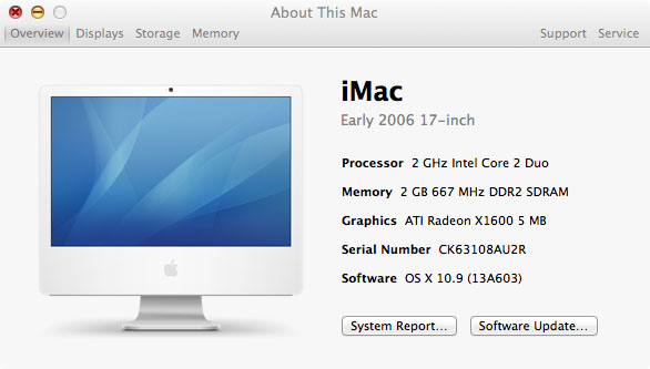

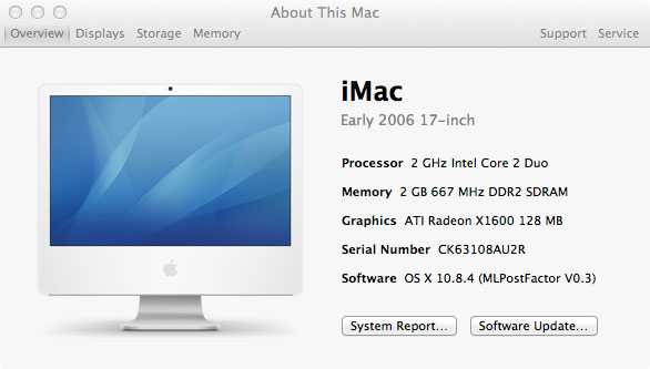

Hey I just want to thank you guys for getting OS X 10.8&10.9 to work on unsupported macintoshes 🙂 I hope for more development in getting 10.9 working properly on X1600 macs (i have a cople of shots of my imac running 10.8.4(MLpostfactor its my main OS and 10.9 on a USB drive for testing installed using the mac pro guide with modifide boot.efi etc i tride installing the gpu kexts from ML to mavricks but it dident work for me if some one can provide the needed kexts and how to install em then i will be very happy indeed 😛 ) MLpostfactor works perfect for me havent ran into a singel isue and much better then loin and i cant wate for macpostfactor 😎

I will always hold out hope that a boot loader will be created to accomplish what none have done so far on our 2006 iMac.

How are things with Safari? What happens if you put the Mini to sleep and wake it?
I didn't try the sleep/wake, as it stays running all the time for the house's cameras. I didn't try Safari, I'm running Firefox, which works without issue, other than Flash bc of OpenGL of course.
EDIT: For the time being, I went back to 10.8.4 until some more work is done on it. But I think Mavericks has great potential on older machines.
I have the exact same Mac Mini and I've done the exact same modifications. I'd love to know how you managed to get 10.9 running on that machine.
